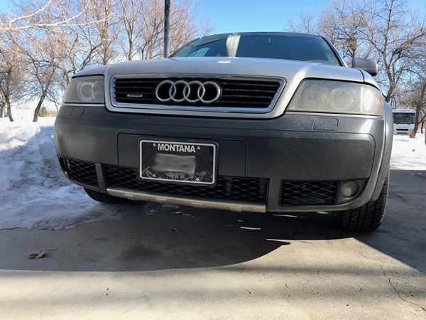

All three center grills repaired and installed:
