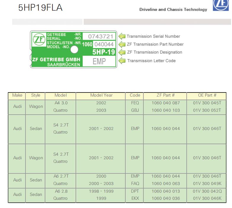

check the trans code, if you end up needing one i know of one with 56k on it and a TC, came off of a 2.7t may be of some use to ya.
Re: 2001 Allroad Rehab
kompressorgolf wrote:check the trans code, if you end up needing one i know of one with 56k on it and a TC, came off of a 2.7t may be of some use to ya.
What year Allroad is it out of?
This on is a ZF 5HP-19, trans code is an EYK.
I'm pretty certain the trans OK, but was ran low on fluid so the possibility is higher that it may be damaged. Apparently almost all the TC's in the 2001-2002 Allroads eventually fail, and there's an updated TC with an updated and better seal available.
Just out of curiosity, I'm looking at $300 for a TC. If the trans code it matches up, and I could pick it up cheap enough, I may consider picking it up.
this one is code FAQ its from a 2001 S4 worth a shot! usually when the TC shits the bed it sends bad shit through the clutch packs in the trans.... could be problematic for ya :/ this one came out of a swap to a manual trans. it drove from houston to bozeman no hiccups, but dont know if you could do any swapping, im guessing the diff is a different ratio.
Is that a 5 or six speed tip?
Seems like it may work. I don't see the Allroad on the chart, but the 2.7T Wagon/Sedan compatibility looks OK. What happens with the TCU if it sees a different trans code? Gear ratios different?
