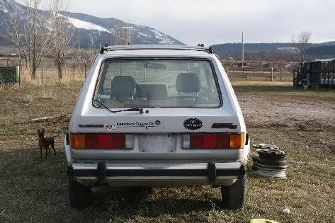

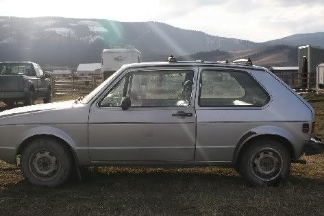

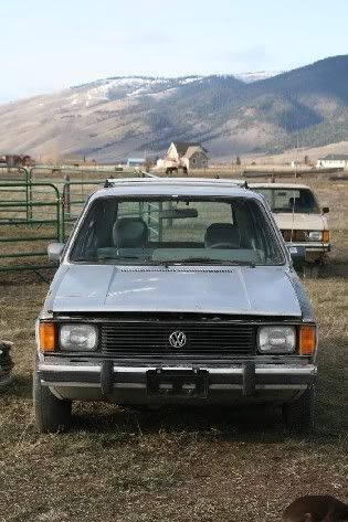

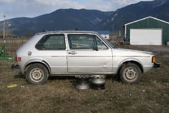

Okay, here you go, the silver one is the latest one. I'm not too worried about the dents, and yes, the hood does close, I have no idea why my wife didn't bother to close it before she took the pictures. As far as rust, it's completely clean both on the body and underneath, but the paint is shot. It almost looks like somebody tried to buff it with a piece of steel wool. She does eventually want the body work done, but for now, her biggest concern is that I get the motor done so that she can park her truck and save $100 /week or so.Post some photos homie!

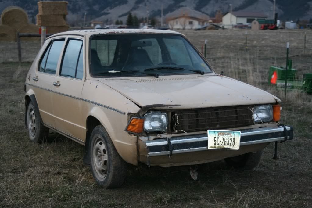

The tan one, on the other hand, is the first one we bought from Helena. The interior in it looks like the day it left the showroom, but I have no clue what the guy did to the body. There's really no rot on it, but the front end is pretty bad, I measured across the fenders at the shock towers, and it's 4 inches wider than it should be from the front being pushed back and the fenders buckling, and that rust you see above the windshield is actually where it looks like someone took a hammer and beat on the roof. Needless to say, we gave up hoping to fix up this one, but the interior will be going to good use, and if the guy that had the silver one crashed the pistons into the valves, as I suspect, then the motor will be going to good use also.
