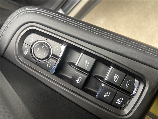

  • Replace the drivers window switch assembly (ordered) -- how do I remove this? Does it simply pop up and out?
  • Upgrade infotainment PCM3.1 (add on the Carplay "kit" most likely)
  • Different wheels - don't like the 19" gloss black OEM, prefer something in gunmetal or silver, 20"
Switches work, but buttons are a bit busted up so it's getting replaced:

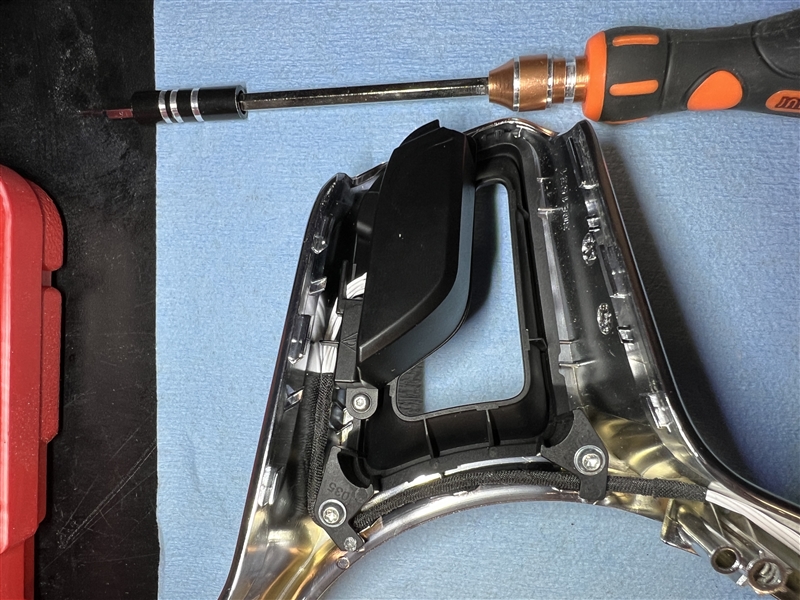

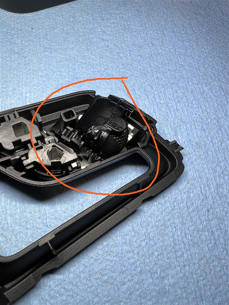

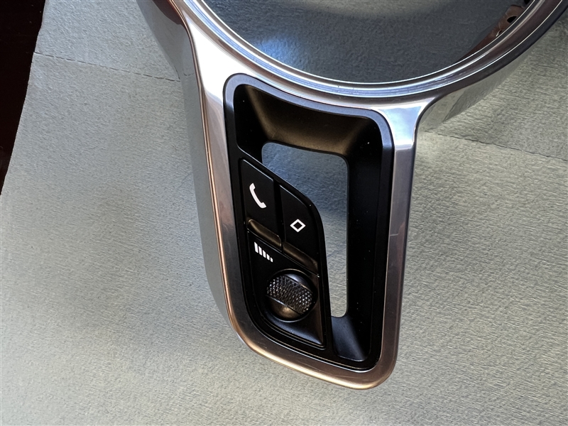

One issue I came up on was the volume button on the steering wheel. The PO has mashed it and had apparently broken it to a point where the roller ball began to not function, so I figured I would go ahead and pull it, and find the issue.
Anyone with the same or similar issue and looking for the answer, here's how I solved my problem.
I ended up pulling the wheel, wanting to just take a look and get a visual on what the problem was so I could order a new part or whatever I needed.
The wheel needs to come off and you'll need to fully disassemble the inner controls that sit in the inner chrome assembly. Then take the back off the volume controls and buttons.

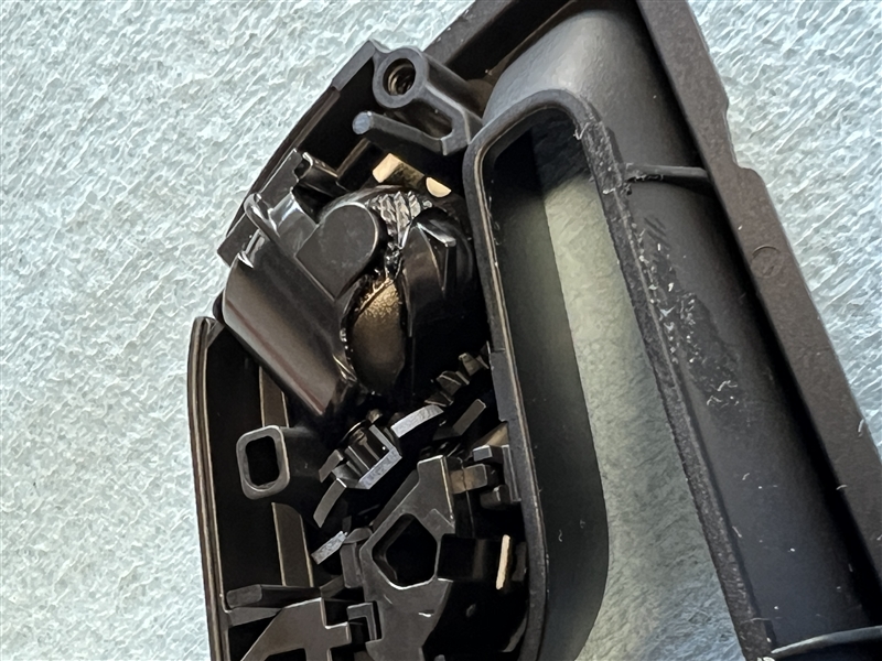

After getting the wheel off and disassembling it down to the controls, I found the issue. It appears the PO smashed the roller down so hard it broke the cup in the roller assembly.
Remove the control assembly from the wheel, it's easier to access the inside with it out.

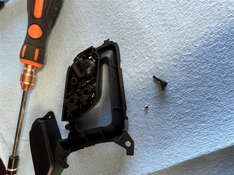

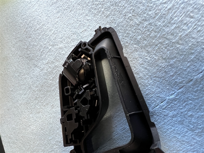

Taking off the back I found that there's a small cup that cradles the roller ball, and mine was apparently cracked, which was causing the issues I was having.
The little white nub is the "rivet" of the outer cover, it's also broken. Easy enough, I simply used a little bit of the super glue and set it back in place
Gently, I was able to remove the roller ball and all the rest of the controls. They are plastic, so I was very careful...so, with that discovery, I figured I would at least give a repair a shot.
I found the best product to try was a super glue, this one I used the Loctite Pro Series super glue, just picked it up from Lowes.
Basically I simply glued the two pieces back together, waited for a few minutes until the glue dried and reassembled.
Put it all pack together and it works like it should! :thumbsup: :thumbsup: :thumbsup:
