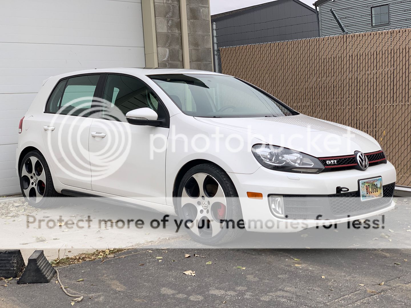

I'm sure someone saw this on craigslist. Scooped it up on the cheap with a timingchain failure. Im working on finding a longblock. With 180k on the car, I'm just going drop a lower mile motor in.

Overdue for an update here. Been a busy summer.
Im going to let the photos do most of the talking but in a nutshell:
Ebay motor from an EOS with 90k arrived in good condion. Changed out rear main before install. Motor bolted in fine. Took a break to put a heater core in the sportwagen. First start attempt yielded about a gillion codes and no start. Turns out EOSs have a siemens ECU instead of bosch. Had to re-pin the harness by tracing and comparing wires on the original harness. There were a few that needed soldering because of guage changes.
After running the car for a while, it got new plugs, new battery, upgraded coils, PCV, new replica Audi wheels, timing chains, intake carbon cleaning and APR software. I had European Performance in Billings do the cleaning, chains and APR (good dudes).
Frisky Felix is a happy critter :beer: :cool: Cheers!!
