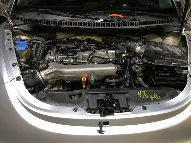

So, I picked this little Beetle up when it was super cold here in Billings, and was finally able to get it back about a week or so ago when the cold snap finally lifted a little. Here's some pictures:

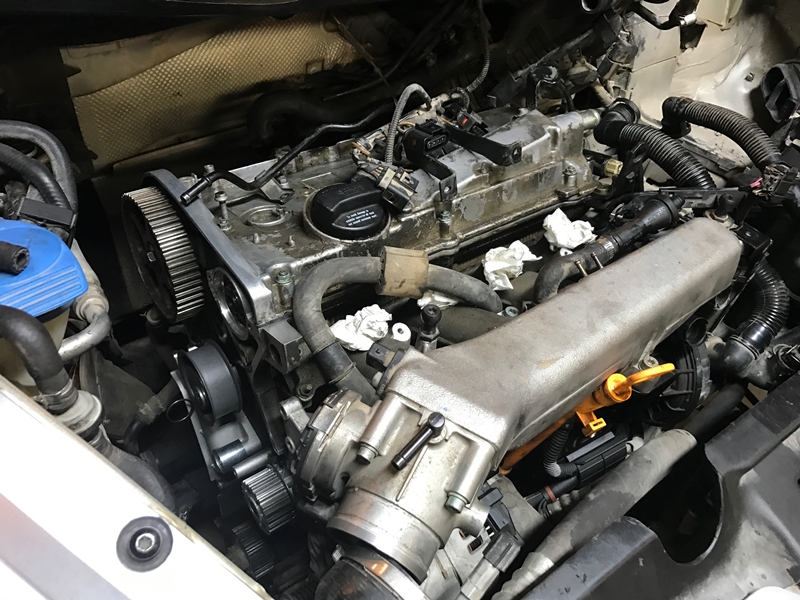

After getting it in the garage and putting it on the charger, it was evident that when turning it over there was some timing issues. After pulling the upper cover we found some intermittent slack in the belt. That means a tensioner or roller has failed. Knowing that, I was set to pull the head and inspect the damage.
More pictures of the interior, it's got some bio that needs cleaned up and the door panels need some serious help.
Here's when I started to pull the head. Basically support the motor, this time from the bottom, and then begin to remove the right side motor mounts. From there a full belt and timing inspection can be done.

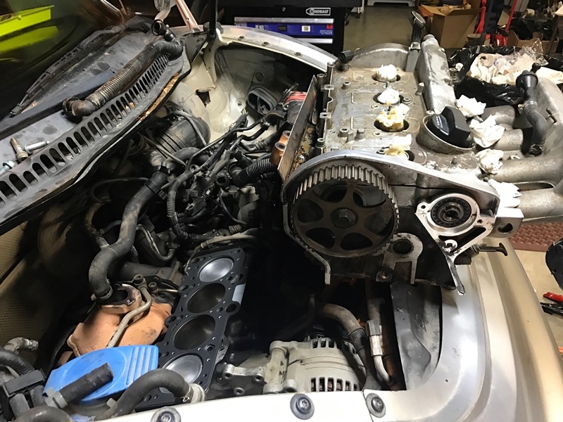

So let's remove the head! Valve cover removed, and remove the head bolts.
Pulled the spark plugs, and they are probably some of the worst I've seen. And yes, they are Autolites - that's a damn crying shame to see in a VW... :crybaby:
Ribe M10 for the head bolts, just for reference

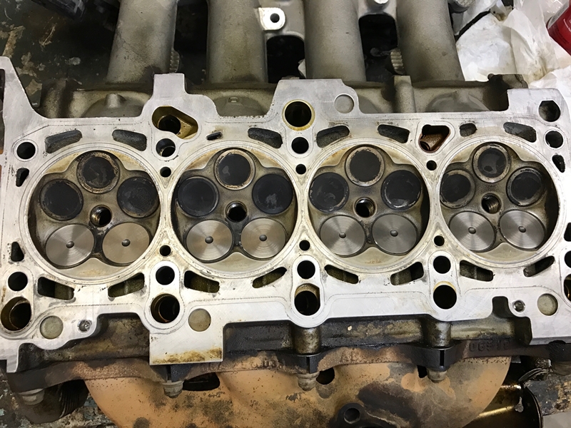

And removed. Few pictures of the damage

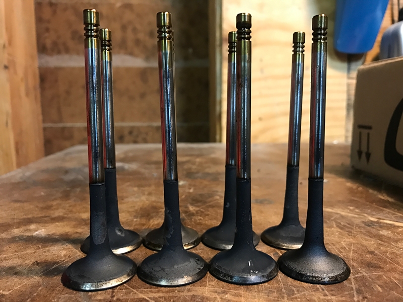

All 4 cylinders with exhaust valve strikes
Eh, not too bad...?
Valves actually look OK - WES!! What are your thoughts, are these valves OK?

had some that looked fine, and they weren't. at least its only 8, I would sand the rough edges on the pistons, the impacts don't seem too bad, make sure no sharp edges and roll it.
Re: 2001 New Beetle Busted Up
kompressorgolf wrote:had some that looked fine, and they weren't. at least its only 8, I would sand the rough edges on the pistons, the impacts don't seem too bad, make sure no sharp edges and roll it.
Good input, thanks Brandon. I agree with you on the pistons - I'm more concerned about the valves being just ever so slightly bent, which would cause a failure down the road.
Since it's hard to determine that with the valves installed, I decided to buy a valve spring compressor and keeper remover/installer. That should show up this weekend. I was planning on taking it into a local shop, but I figured for the cost of doing that vs. buying the tools, I figure I will do it myself and save money while learning. I'll pull and inspect, and if everything looks good and straight, I'll lap the valves and reinstall.
I wouldn't even use the valves that touched the pistons. They aren't designed to be slammed into a piston. It took a lot of force to make those indentations on them. Even if they seem perfectly straight, they might have micro cracks you won't be able to see. Few heat cycles down the road and the end of your valve breaks off and destroys the whole motor. Plus.. valves are cheap. :|
Roadhog wrote:I wouldn't even use the valves that touched the pistons. They aren't designed to be slammed into a piston. It took a lot of force to make those indentations on them. Even if they seem perfectly straight, they might have micro cracks you won't be able to see. Few heat cycles down the road and the end of your valve breaks off and destroys the whole motor. Plus.. valves are cheap. :|
Good point for sure. I should probably get all new exhaust valves then. What about the seats and guides and seals?

grab some valves, I use an old socket and an 8 inch harbor freight c-clamp. some lapping compound and tool, lap em in and check the seats. Seats will probably be fine, I bent 6 intake valves waaaay bad once and the seats were ok.
Mike I have a press if you need to do valve seats. I also have lap compound for the valves.
Sent from my XT1650 using Tapatalk
Ok, I pulled the trigger on new exhaust valves and seals, plus a couple of other things like a coolant flange that need to be taken care of.
FYI, valves are about $10 each at the cheapest (Rein brand), plus seals that are $2 each...that's pretty cheap insurance in the long run.

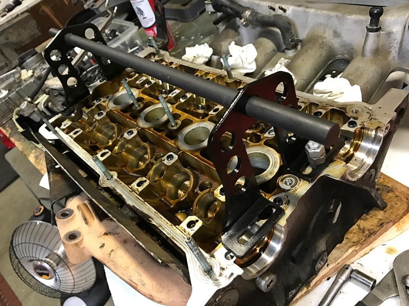

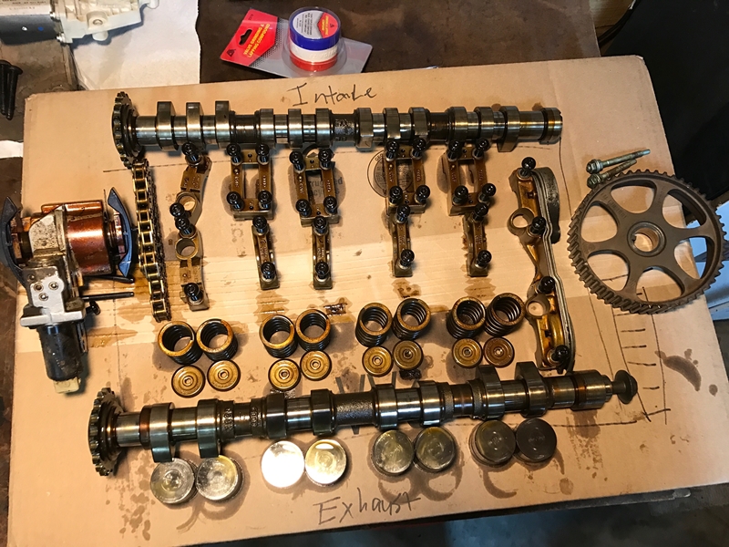

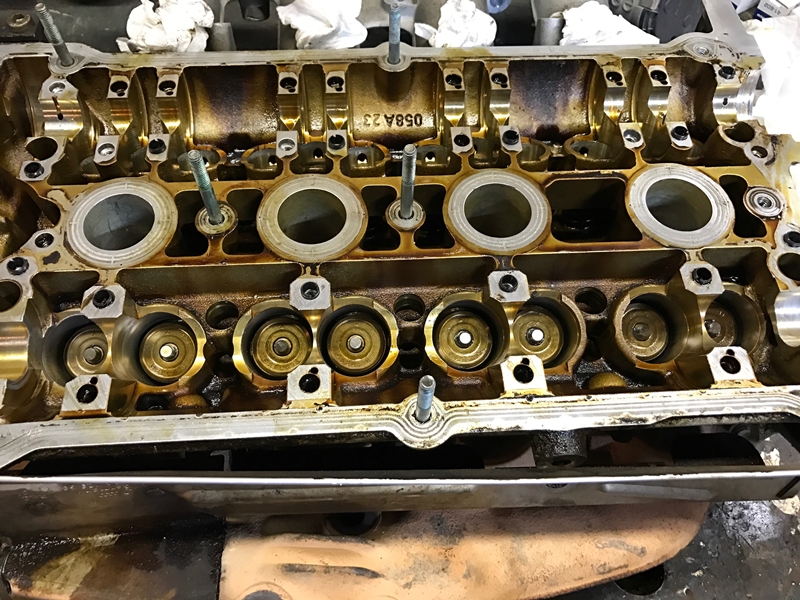

I also ended up pulling the head and began to break it down and disassemble it to pull the exhaust valves, replace the guides, valves and seals, and put it all back together again.
Here's a few bent exhaust valves

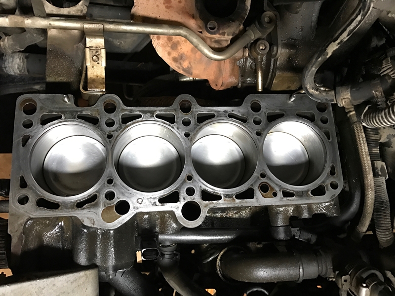

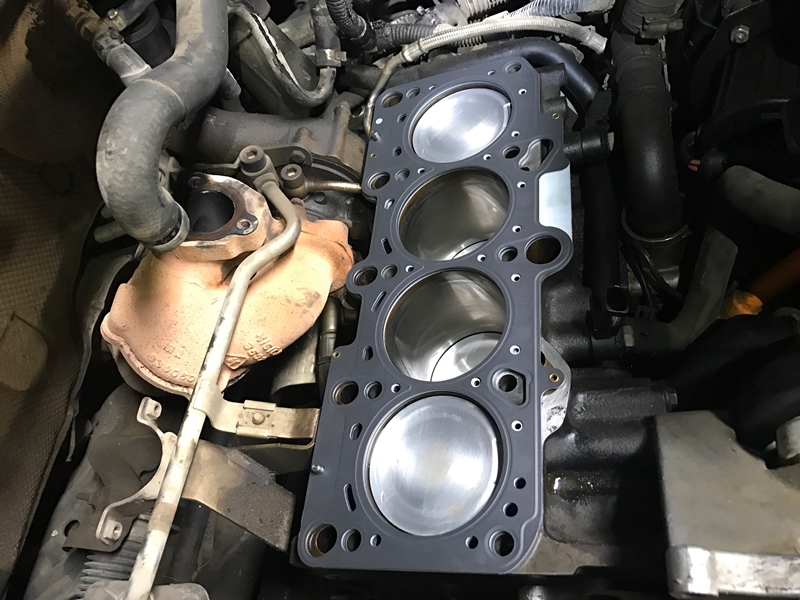

Cleaned up the top of the pistons and cleaned up and prepped the block for a new head gasket

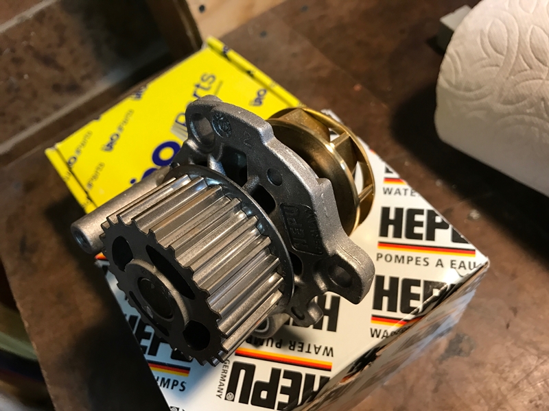

Installed a new Hepu metal impeller water pump

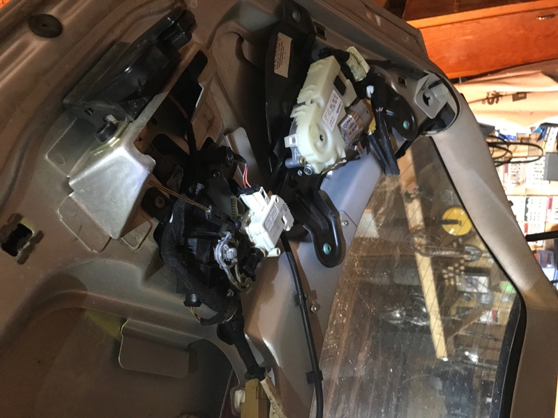

Fixed the rear hatch release, and replaced all the pneumatic support struts in the hatch and hood

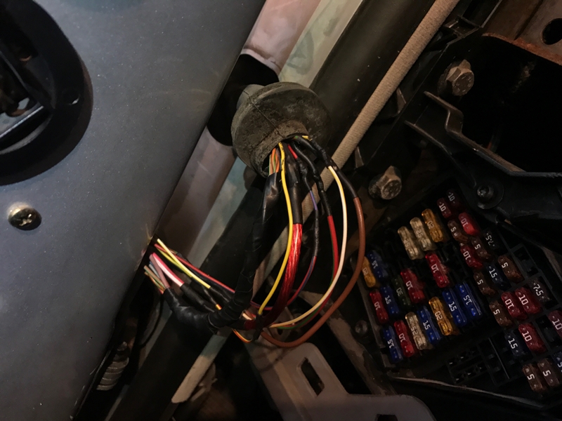

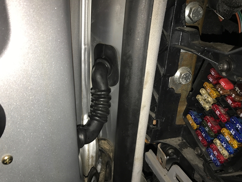

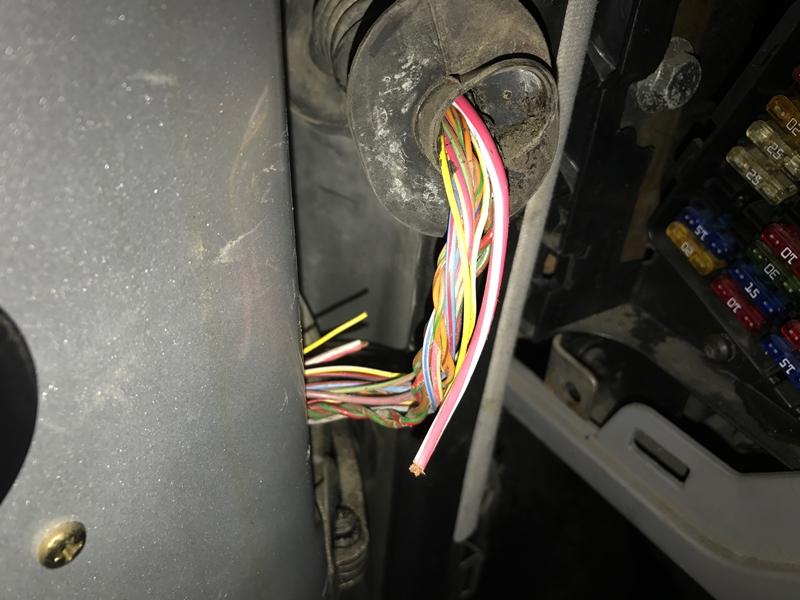

Drivers window would not roll up, so I found and repaired a few wires in the door

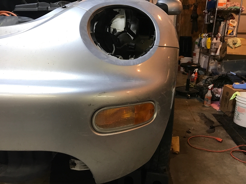

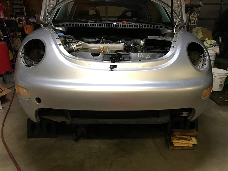

Replaced the front left blinker assembly
Here's the head after new exhaust guides, valves and seals were installed, the springs, retainers, keepers and lifters were all put back in place
Lifters had not been installed yet...
New metal head gasket
Just before head install

Now it's time to button everything back up and begin to get the entire car cleaned up and back on the road
