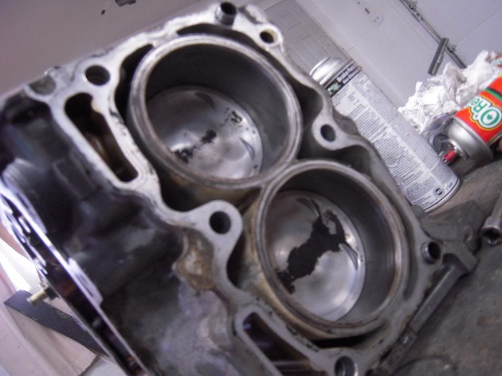

well last night it decided to spin a rod bearing.... thank god i just assembled my de-stroked 25 (now 2.35l)... so let the long block swap begin!
Re: i :heart: boxers
8.1:1 compression de-stroked 2.35L. BIG bore short stroke :)
