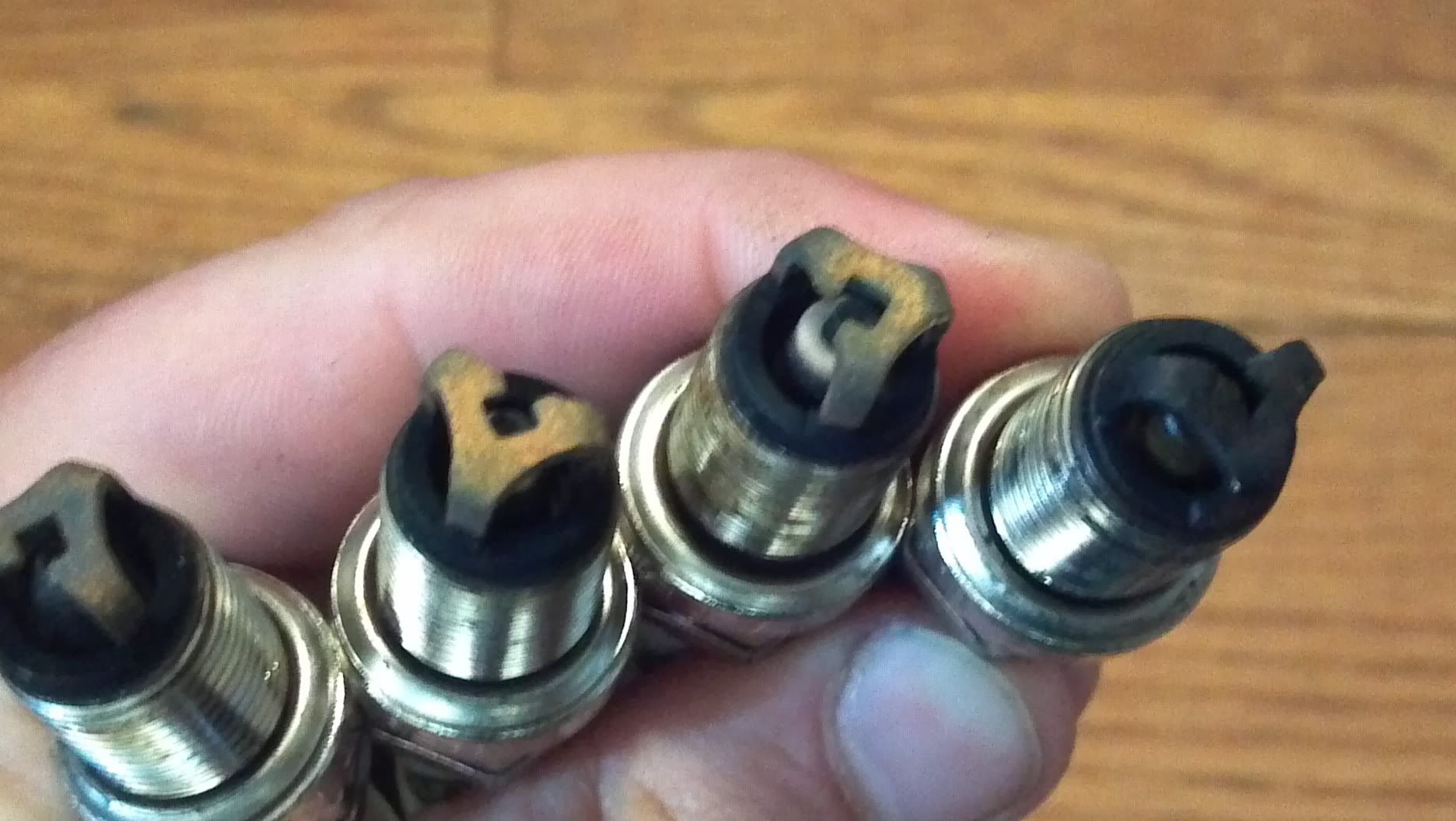

I don't feel like my plugs should look like this after 4K miles...

VW's don't like the fancy plugs. Use a stock plug. Just from experience.
Re: Oddest thing...
The two in the middle look like they may have been getting some coolant,maybe,had to say from the pic.Either that or they are running WAY too lean on those two cylinders.....
Re: Oddest thing...
Stock, single electrode plugs. No triples, no quads, no e3's.
Re: Oddest thing...
Don't get the Hitachi coils. There's a recall on the VAG coils and they will be replaced free of charge at the dealership. VW will replace them with the new revision "D" coil which is much more stout than any other revision out there. Optional, you can buy them, submit your receipt to VWOA with a letter too, I did that, and R&R'd my own, got a check from AOA.
Yeah, plugs - like everyone else said go with a basic plug, copper, not iridium or platinum, single electrode. Currently I run the BKR6E gapped to .030, no problems. If you are chipped, go to a step cooler plug and you'll decrease temps a bit. Those two in the center look like they were run pretty hot.

I guess I have never ran just a copper plug. I kept getting PFR6Q plugs and blowing them. I think stock my car came with the revision coils but maybe I'll just get them and some of those hold downs. Also always gapped to .032. You guys think that N75 is ok though? Or should I invest in a different valve?
Re: Oddest thing...
Yeah, my experience with platinum plugs has been less than ideal with my Audi and the 1.8T - I didn't like them in my 2.0 either. I found that the spark was not strong enough (especially with a tune), and I would get misfires. Coppers are fine, and cheap. I change them with every oil change, takes 5 extra minutes, and I have no problems with plugs or coils.
Unless you bought your car, or had it serviced from the dealer (or the OP had it dealer serviced) within a couple of years, you won't have the D coils. They are probably R's, which are OK too, but are superseded by D. Just look at the top part number of one coil and look for the last letter - that's the revision.
Coil hold downs are useless IMO, there's no reason your coils should be popping up out of the head. If they are, then your spark plugs are popping out too, and that's a problem. OEM coils are fine not bolted down.
Are you running a tune? It sounds like you are running stock.
Without a tune, an N75R will cause overboost and limp mode problems, so go back to the stock N75. Buy one used online or go to the junkyard. Maybe someone on here has one sitting around.

Thanks a lot for the help. I suppose I'll get the coils/plugs and a tune. I really wanted to do my exhaust first but I suppose APR says its fine to do it stock. And the only reason I want the APR is because of the options it has since 93 octane is pretty rare to come by between Montana and North Dakota. Think a tune will help with that overboost issue though?
I used to have problems with the coils coming up and I just don't want that to happen again which is why I was going to the hold downs. I'll give it another go though.
As for my Jetta I just threw some autolites in it and its running just fine once again. 170k miles and running pretty.
