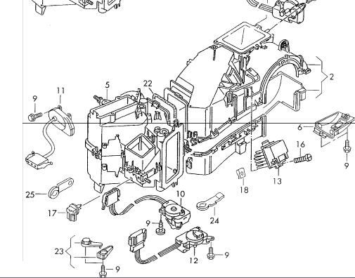

Im sure if you have climatronic that you have a dead servo on the heater blend flap. Usually you can remove the glove box and it's right there (you too Dave). If you can get it scanned with VCDS it should throw a code in the auto HVAC module, which would tell you exactly the problem and the servo to replace. They are usually about $100 or so, or you could find a used one online for cheaper.

If it is the servo, it's #10 in the illustration:
Part # 1J1 907 511 C
you can get it here for $135
Scan for codes first though - the system is smart enough to tell you pretty much exactly what is wrong - my thoughts are only guesstimates based on your description of the problem.

Thanks for the help Mike! So is the heater box and whatnot all under/ behind the glovebox or is it buried in the lower front dash behind the stereo and climatronic controls? Or are we talking two different things? In addition, there has been sort of a musty smell and little bits of foam coming from the vents albeit infrequent. Cabin filter was just changed.

It's hard to tell from the diagram how tucked under the center console the heat box is, but IIRC in my Jetta the blower fan was right above the passengers feet so the servos should be accessible by removing the glove box, which is about 8 screws.
