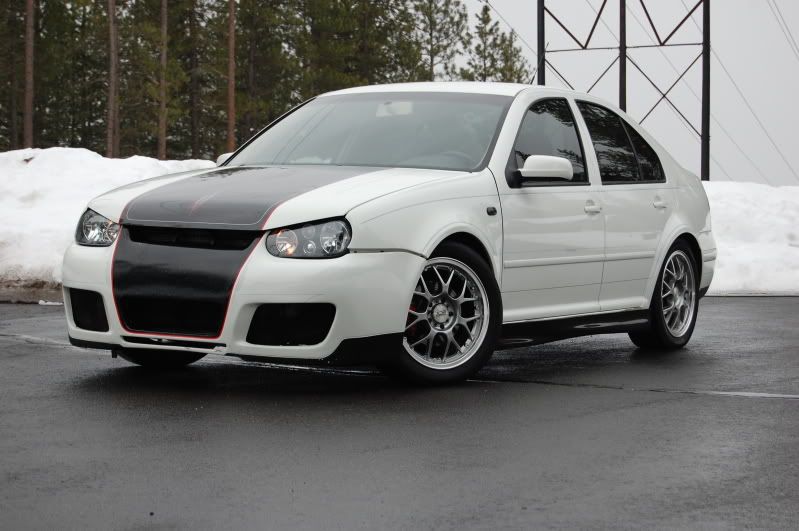

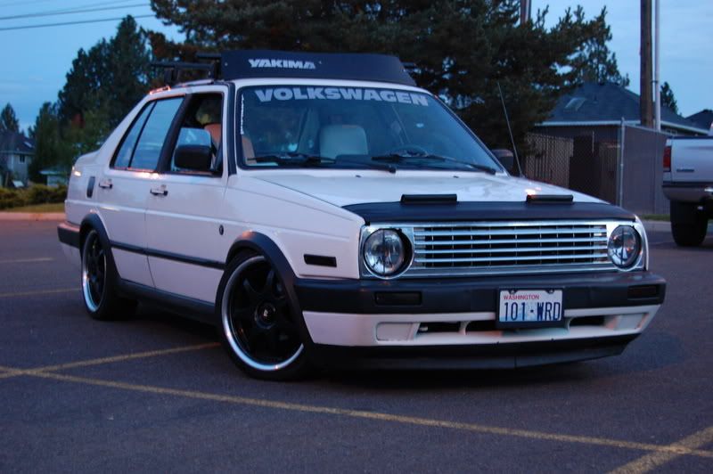

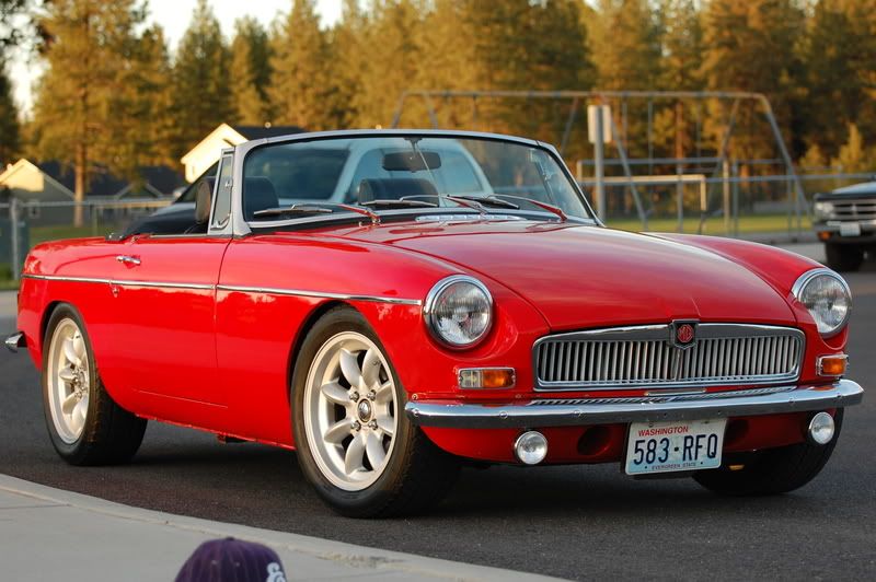

okay from the research i did i figured it was that or the master. So thats a big help, and man i love the dub sceen, but my oil pan aint shallow.
here are some of my past euros...
73 mgb roadster
91 wolfsburg
2002 jti
