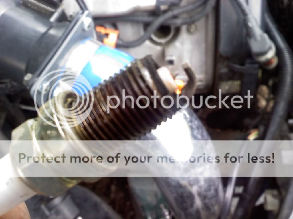

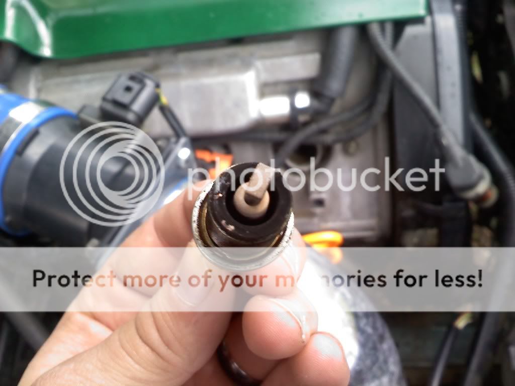

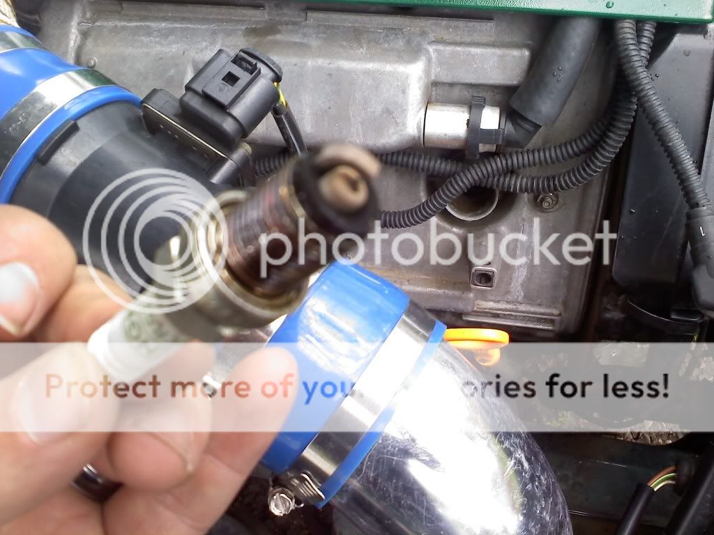

the plug was we an smelled a lil like fuel...

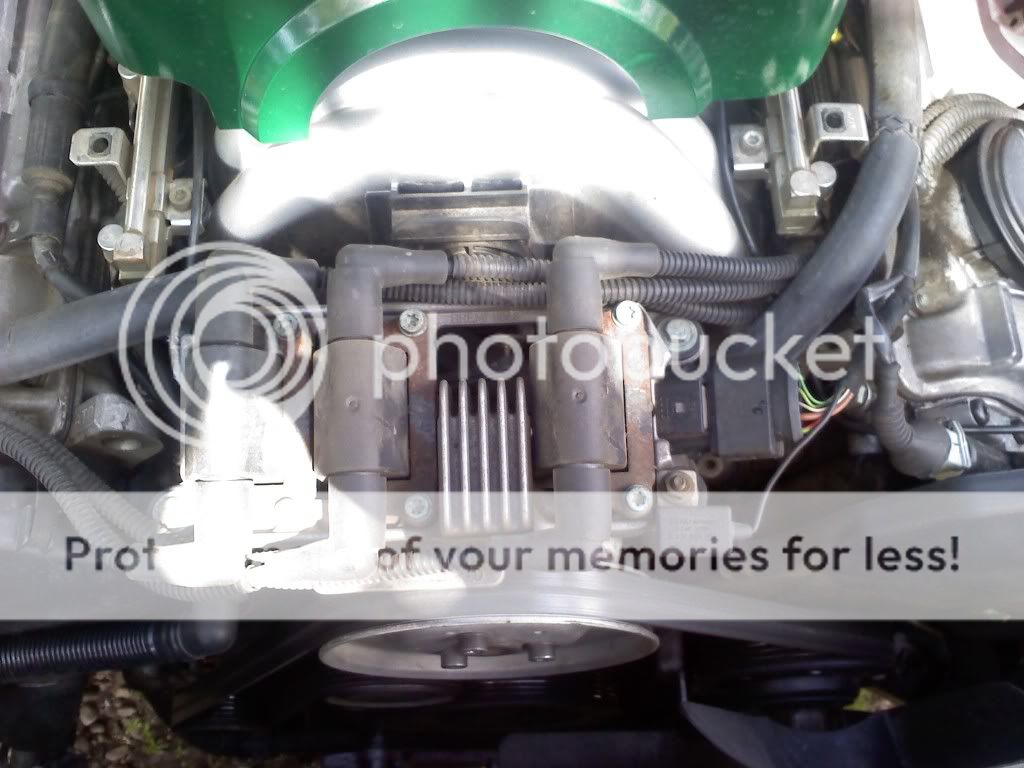

thats my coil a six pack the one far left is the one that goes to my plug 1

an i checked the gap an gap is still good....

Iridiums right? Well they are good for like 30k so I think you are good there, so it's gotta be the coil pack like Trev said.

yes Iridium NGks ummm thats what i figure an there is non in town from what i have called so far i am going to check an see if VW here has anything on it.... an go from there it started up to day an ran fine while i had it running but it warmed up here so i figure i would count that in an go from there but it seemed to still have a slight hesitaion or so. so im getting the coil back an go form there...

Usually the coil pack cracks and the spark arcs which causes a misfire. To test it get spray bottle with water and with the car running somewhere dark, like at night, spray the pack with a mist and if its cracked you will see the arc. If that's the case you can replace the entire pack, or I have seen guys coat the cracked area or the whole pack with JB weld. Hope that makes sense...just my .02, good luck.

welll the coil pack on the right side was gone a crack not a whole was there an seemed to still work when it was warm but i replaces it... i do advise tho when doing so replace the plug whires also i had to do it becasue the wires i had were still the OEM... but all good now an runs stronger too. thanks guys.
