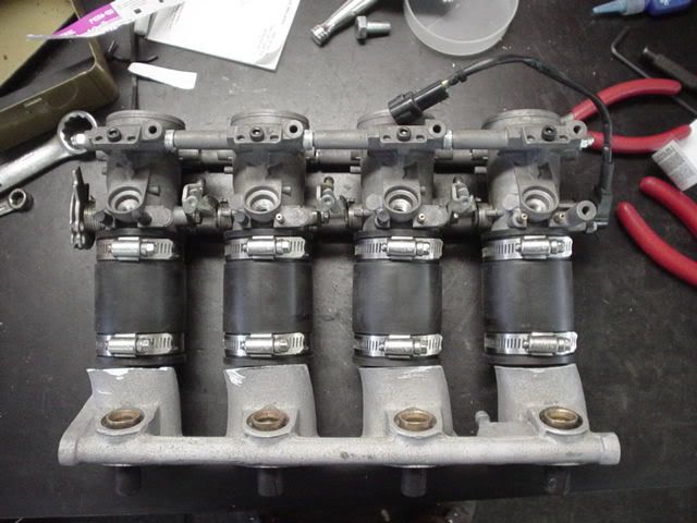

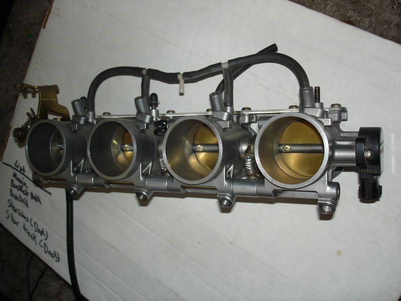

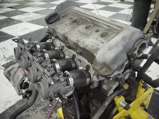

OHH! what are your ITBs from? I am using a set off a 2001 Suzuki GXSR 750. where did you get them? Also, you must be going standalone, so what are you going to use? I am going with a MegaSuirt system, not sure which on yet...
I'll post some pics of my ITB/intake manifold setup tomorrow.

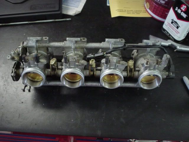

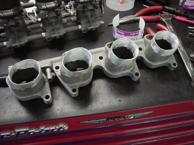

Rennwagen1 wrote:OHH! what are your ITBs from? I am using a set off a 2001 Suzuki GXSR 750. where did you get them? Also, you must be going standalone, so what are you going to use? I am going with a MegaSuirt system, not sure which on yet...
Who made your manifold?
I did!PoorHouse wrote:Who made your manifold?
Take one lower 16V mani and cut like so...
Port and polish, and somewhat knife-edge intake runners (early stages)
Source yourself some ITBs. Mine are form a GSXR 750, and are individual TBs, not two sets of two.
Hit up good 'ol Home Depot for some rubber tubes and hose clamps....
Get everything lined up and stick 'em together
Here they are on the (very dirty) motor
THere you go! If you were wondering I am using Mitsubishi Eclipse GS-T injectors. I figured why stop with Suzuki? Might as well put some Mitsu parts on it also......
