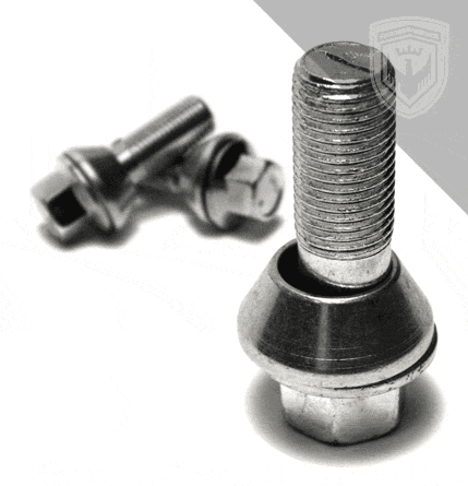

These are wobble bolts:
Picture courtesy of raderwerks.com
Technically, from what I read, any appropriate diameter wheel can fit any car with the correct modification/adapter, and these are legit in situations like mine. For adapting 5x112 to 5x114.3, I think it's the best option right now. If I run them with hubcentric rings I should have no vibration either. Thanks for the thoughts guys.

I'm sure they've tested them, and I can see how they'd work, but the engineer in me says no way I'd put those on my car. And if you get vibration after install, no one is going to buy your wheels with oval'd holes. If a standard bolt comes loose while driving, it has very little play and the wheel will have little to no vibration. If you get a few of these loose, you've got oval holes that allow movement. Movement on a rotating mass leads to vibration, enough vibration and your remaing bolts fail. Not a risk I'd take just to fit wheels.

Spence, yes i run spacers, but not to make a wheel fit, just to push them out. mike, i see your point now.
