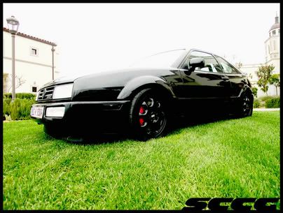

I'm going to paint them.
Going for this.

DO NOT bead or sand blast them. It will permanently pit the aluminum my friend.
Were you thinking of polishing them?
