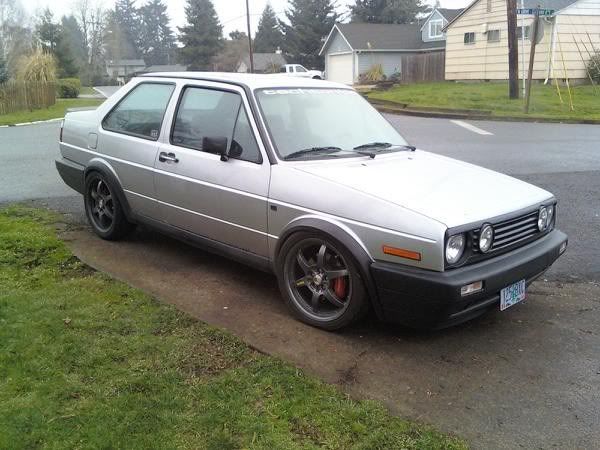

I guess its about time to quit junking up the ChitChat with my project photos and do a build thread. So here we go! I picked up an late 89 German made GLI (CE2 wiring) this last fall and dropped a valver (PL) in cause someone put a cam sprocket on backwards and mashed some valves. After painfully getting this beast running right, it starts puking oil into the air box and creating major problems. I'm over it! I remember a VR passat in Anaconda at the junk yard so I called to see if it was still there after several years and sure enough it was. With hard economic times it was had for a song and dance
