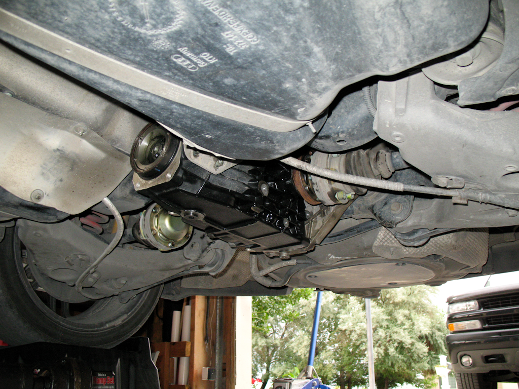

No pictures, but I have the rear diff in. I got the drive shaft installed and everything bolted up and every bolt in the rear is all torqued to spec.

Update, here's a pic of the rear diff, fluid leaking from the vent after I dropped it off the jack and it landed upside down...
