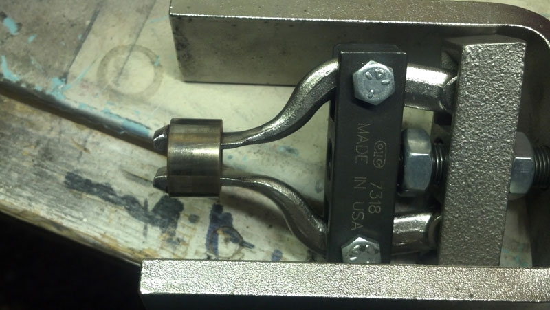

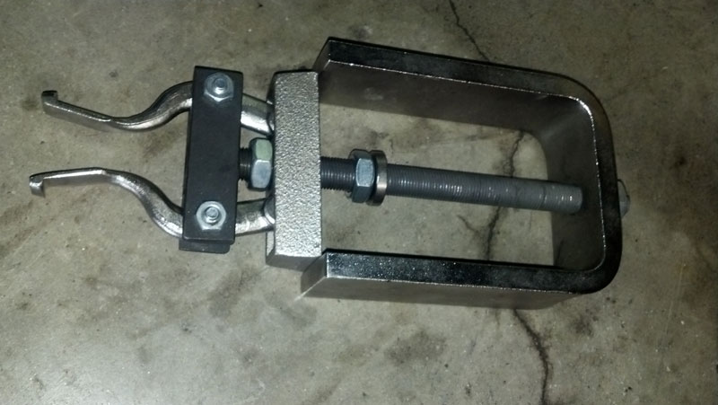

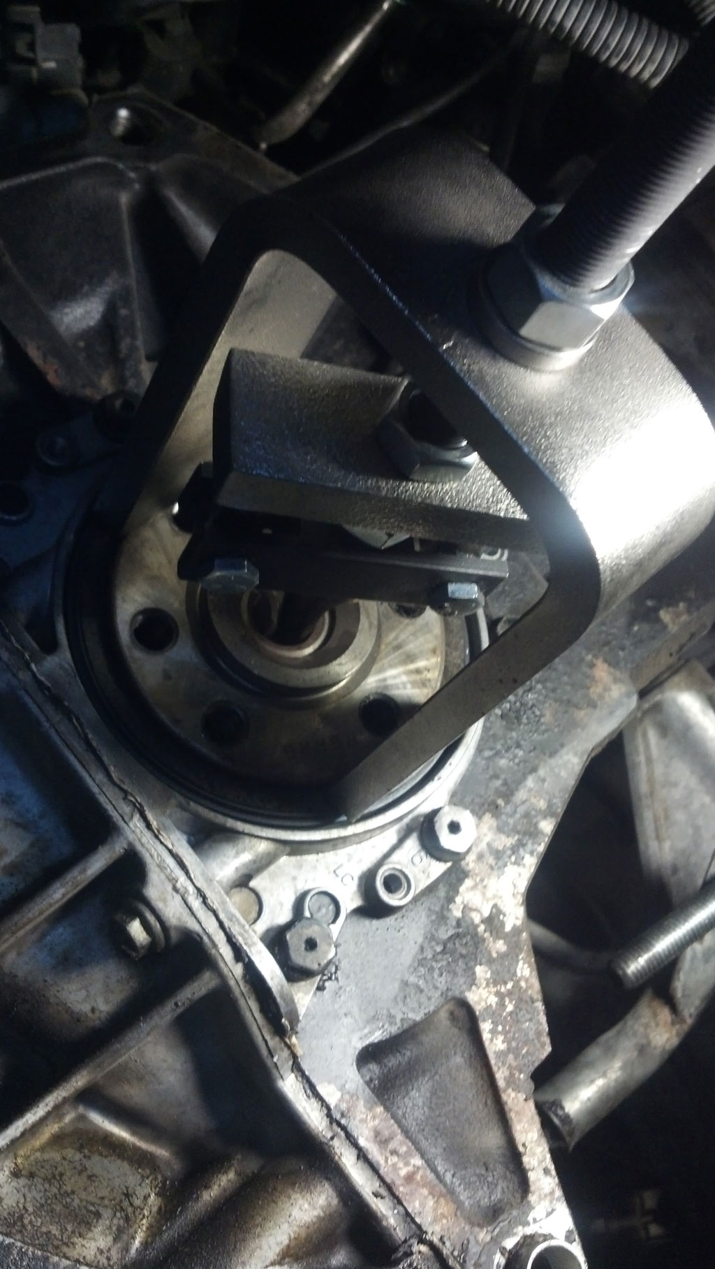

Had some time last night, an I was able to source a pilot bearing puller from a buddy I met who works at the Napa in Laurel. Great guy and he is a VW enthusiast and has spent some time in Vegas. If you need parts and are in Laurel, ask for Jake at the counter. :thumbsup: :beer:

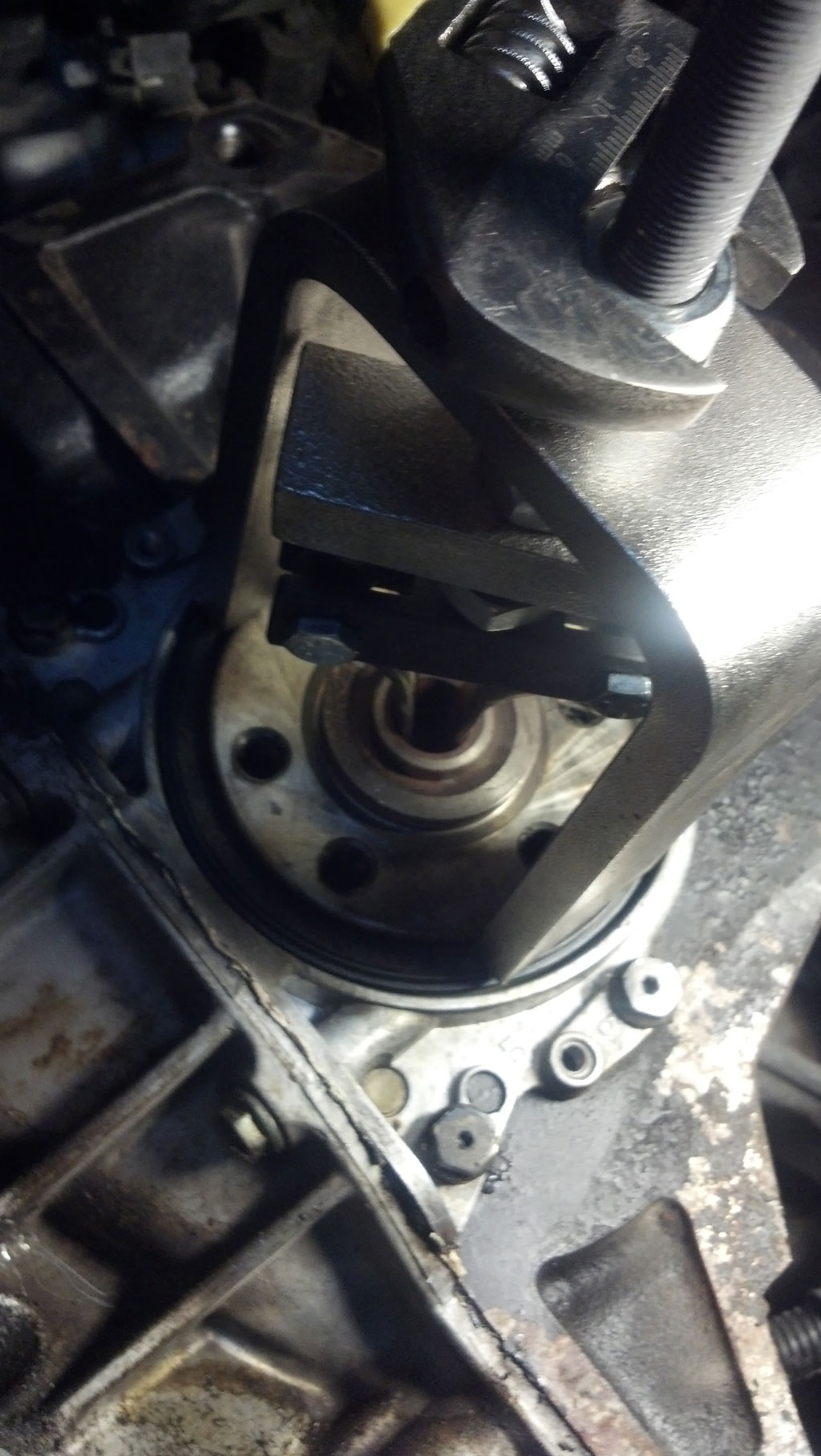

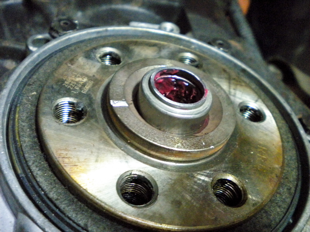

He lent me this specialty tool from his own personal tool chest:
I was expecting the bushing to be somewhat easy to pull, but his was kind of a pain to pull an took some real effort. The tool made it a snap though:

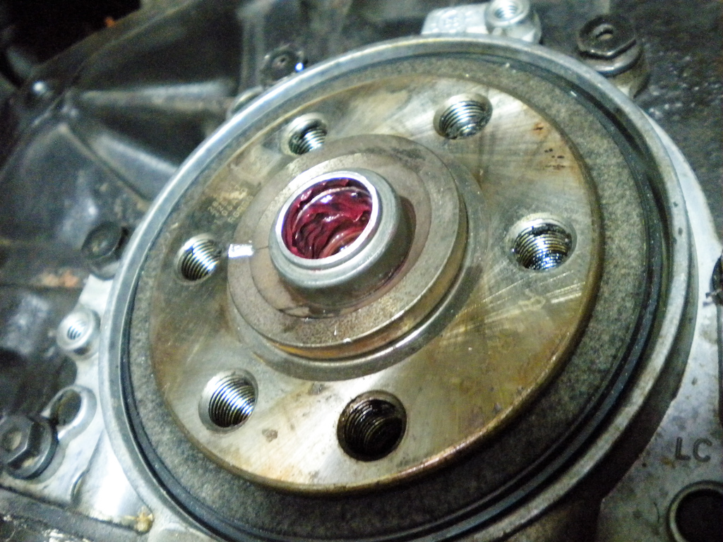

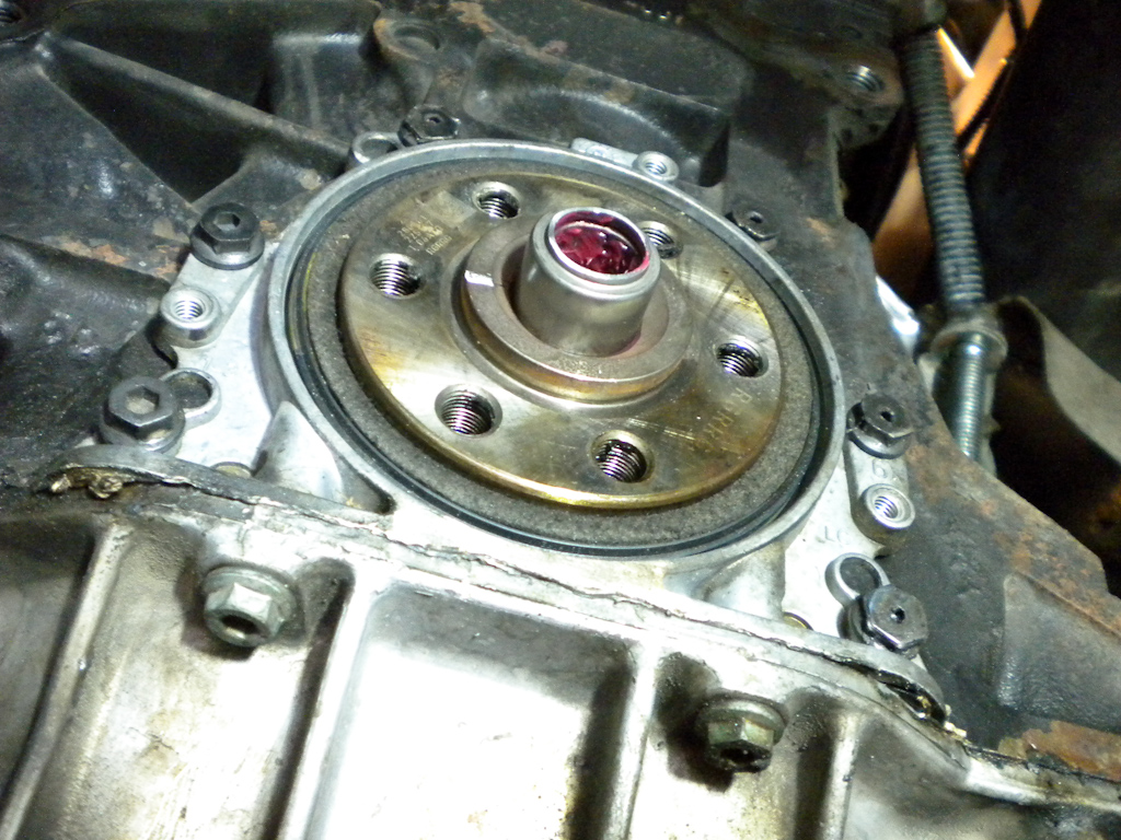

Empty, waiting for the new manual V6 pilot bearing:

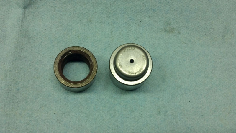

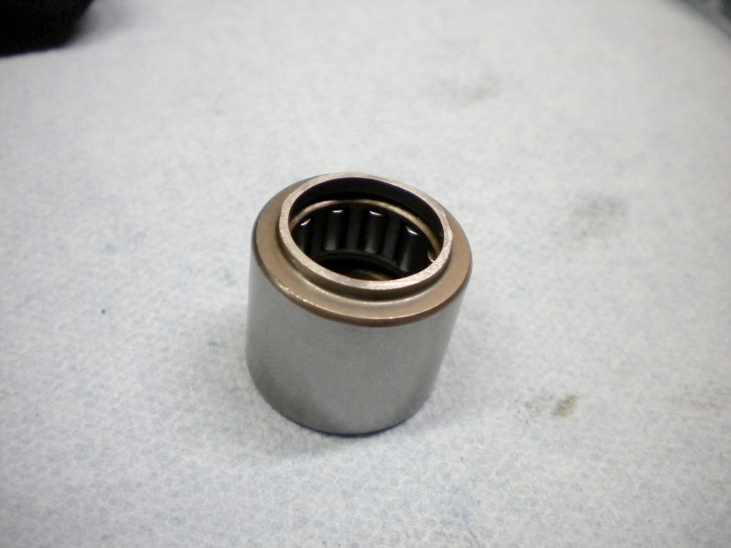

A comparison between the OEM auto pilot bushing vs. INA V6 pilot bearing:
Next up, pilot bearing install, then clutch and trans.

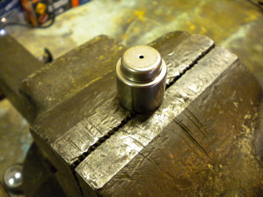

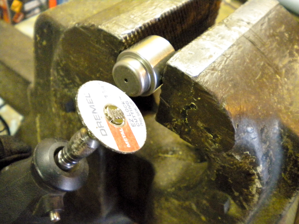

I did eventually get sometime Sunday night to work a bit. First thing was to get the pilot bearing squared away. First thing is to cut the back off:
I used a Dremel and a high speed metal cut off disk:
That's the finished product:
To insert it into the crank I used a 17mm socket, which fits nicely over the lip of the bearing, and a hammer to slowly tap it into place very slowly...
A bit more...
And...right about there should be good for clearance:

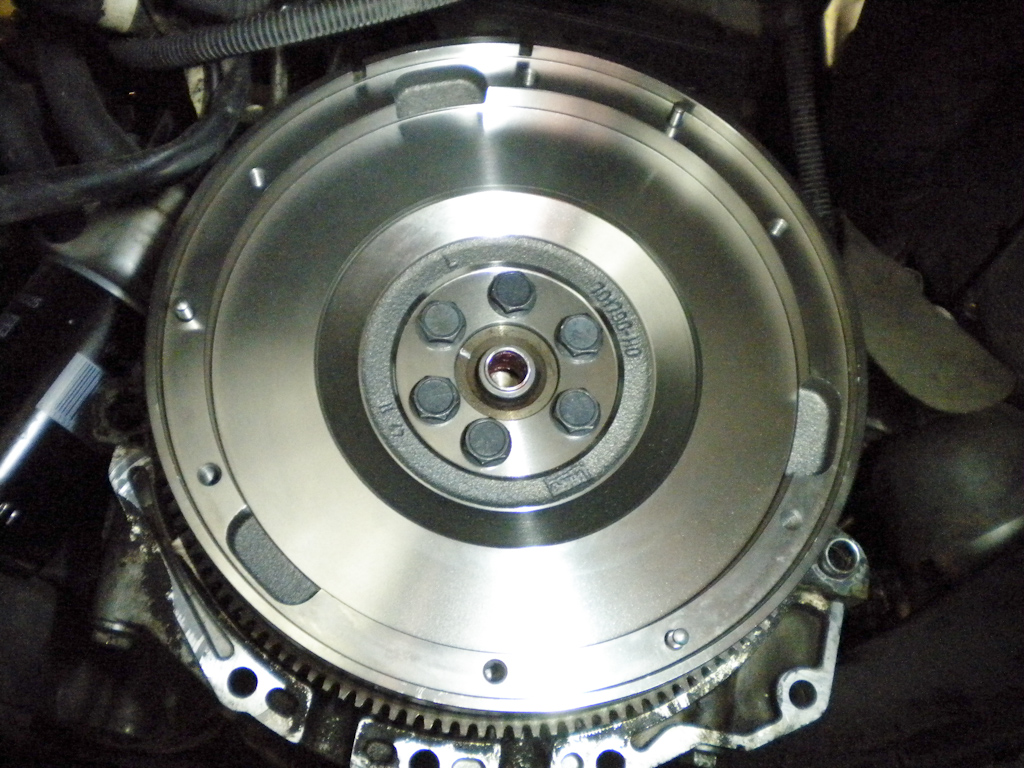

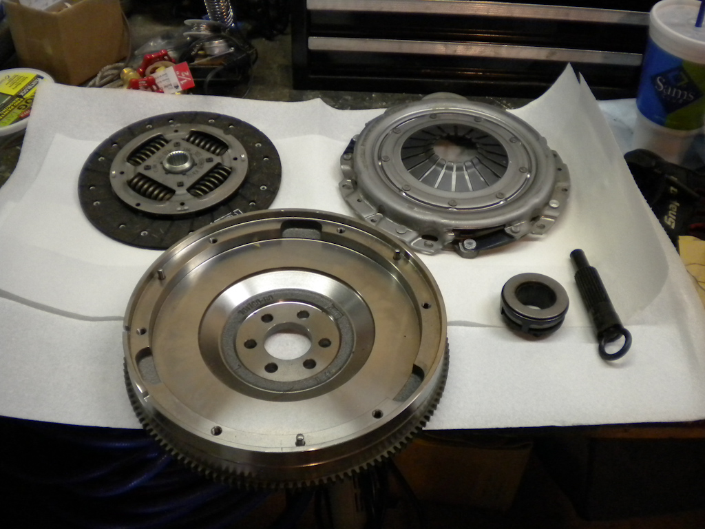

Next up is to install the Valeo HD clutch and SM flywheel I picked up from DBC Performance:
SMFW, PP, clutch disk, throwout bearing and the alignment tool:

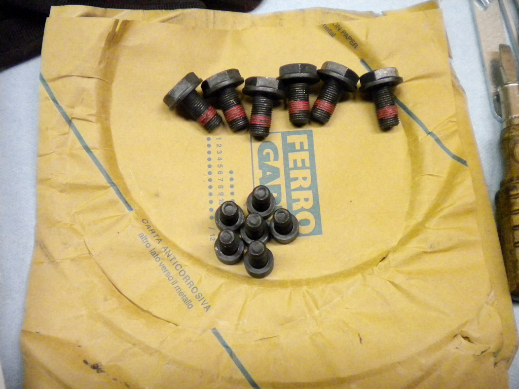

And all the appropriate hardware:
After cleaning both the flywheel and PP with a shop towel and some carb spray, I threw it up in the car:
This is just a quick pic to reference the pilot bearing and how far it sticks out from the crank:
Flywheel bolts torqued to 60NM + 90, clutch disk installed using the alignment tool, and PP with bolts torqued to 25NM, it's installed and ready:

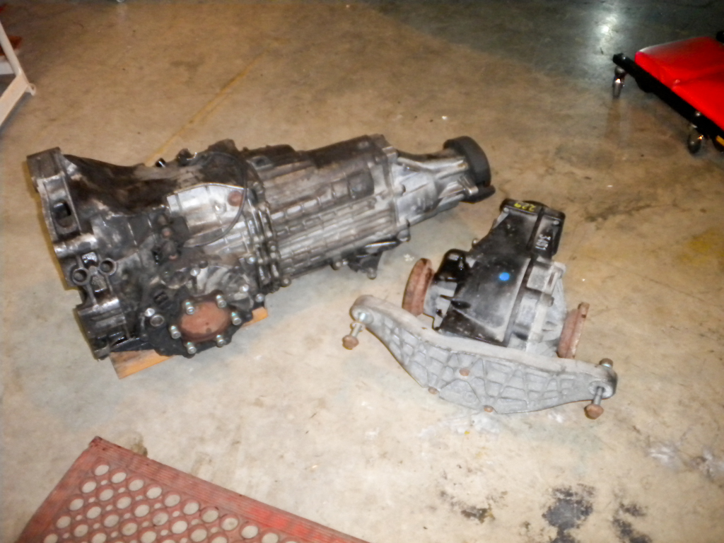

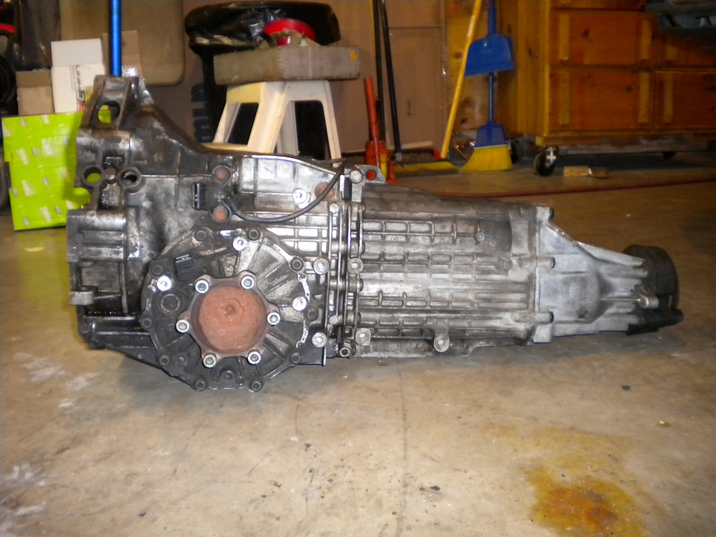

Prepping the trans by swapping in the B6 axle flanges. Pretty straight forward - use a long bolt and a prybar to press out the old B5 flanges. Put the B6 flanges in and I used a socket extension and a hammer to carefully tap them in:

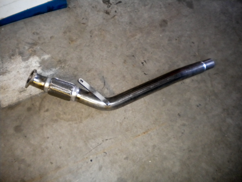

And this little gem from TT showed up yesterday:

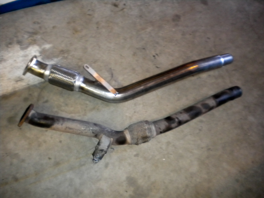

Compared to the auto DP:

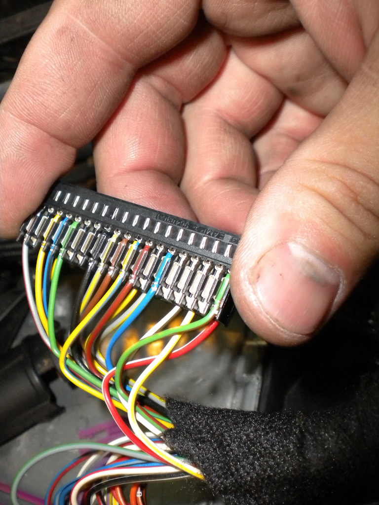

Took apart the ECU connector to fine pin #39 for my clutch switch - time to get some 20ga wire:

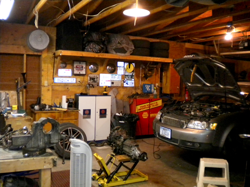

And I organized my workspace a little bit and cleaned up the cabinets I scored at the auction over the weekend, and hung some stuff on the wall:
Sorry about the blurry pics, I think I have a smudge on my lens. :retard:
