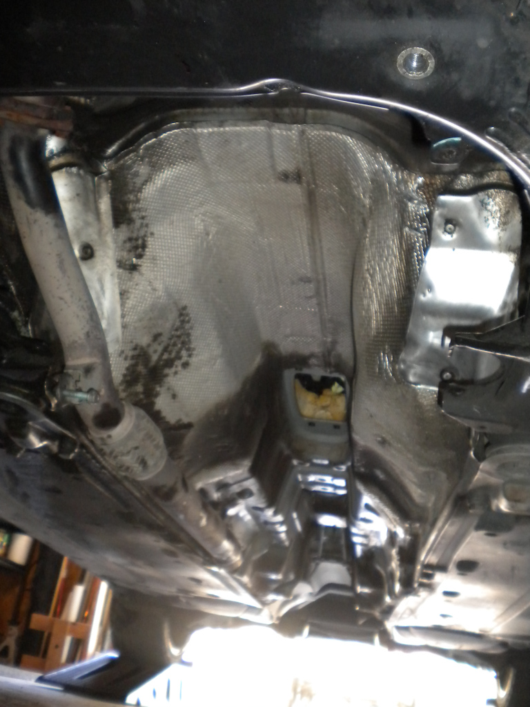

Here's how my garage has been for the last few days:

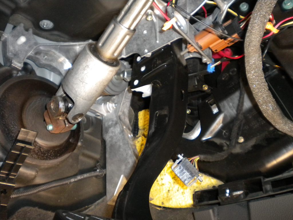

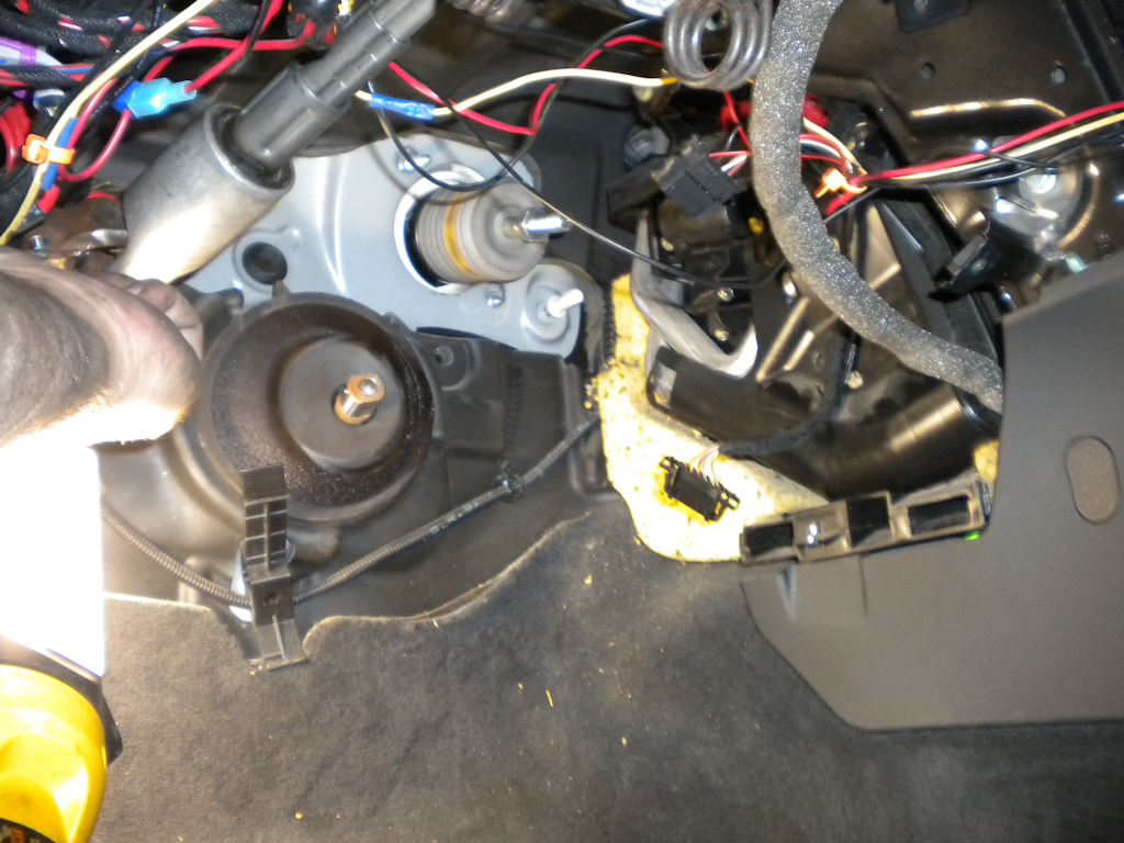

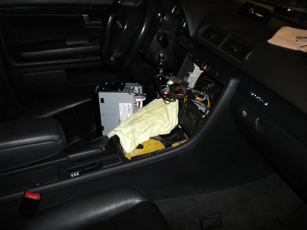

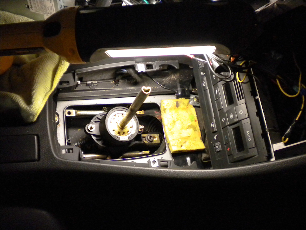

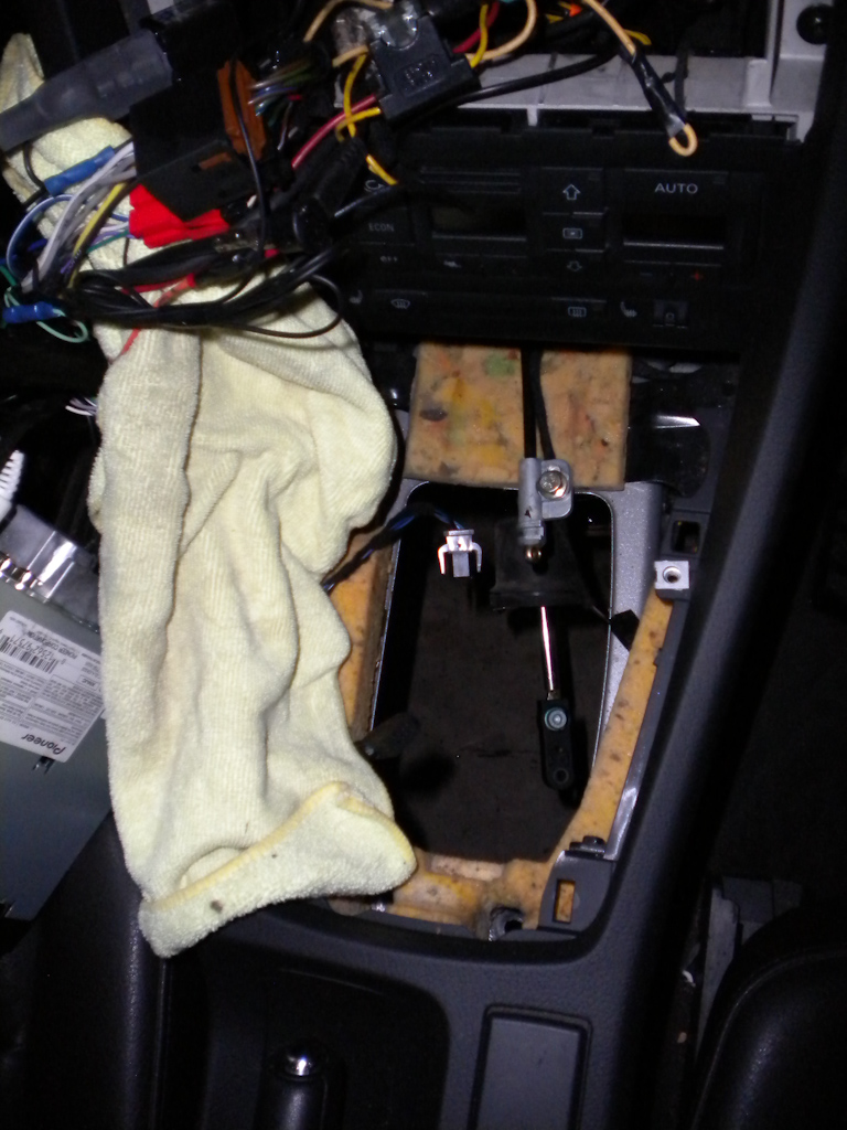

Had to remove the stereo and HVAC console to remove the shift assembly:
Ready for the manual shift assembly:

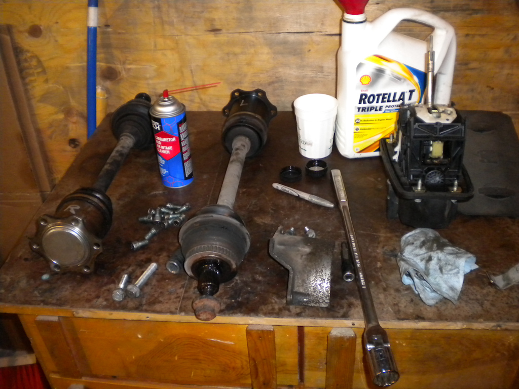

Removed both front axles:

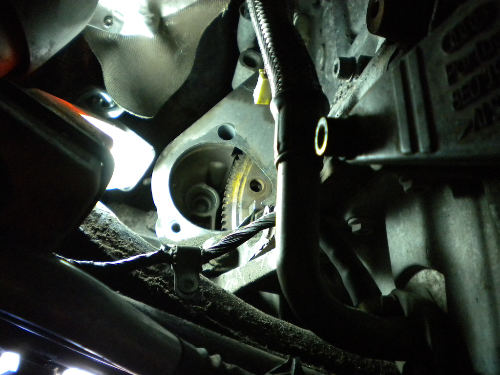

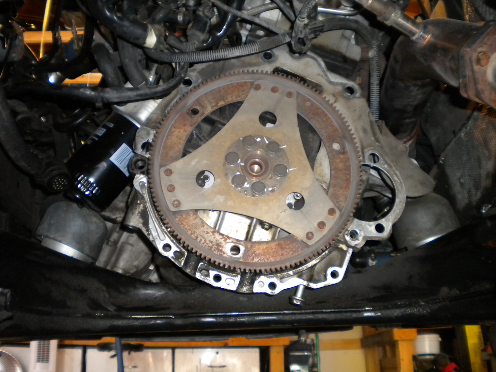

The torque converter has three bolts that need to be removed from the flex plate. Remove the starter, then roatate the crankshaft until each bolt (3x T55) can be removed:

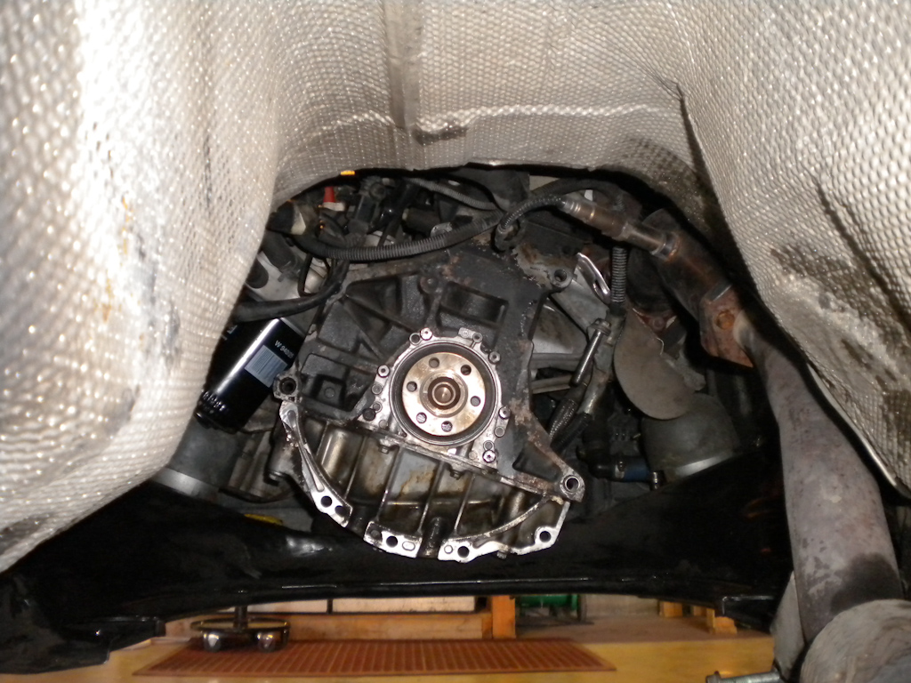

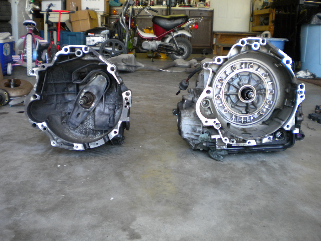

After removing the trans mounts there is enough room to separate the trans from the motor, and with my jack I moved the trans out and down. Then dragged out through the back of the car using the driveline tunnel because I didn't have enough room to clear the trans coming out the front or sides. It was a bit of work, but I got it out. Here's a comparision of the size between the auto (01V) and the manual (01A)

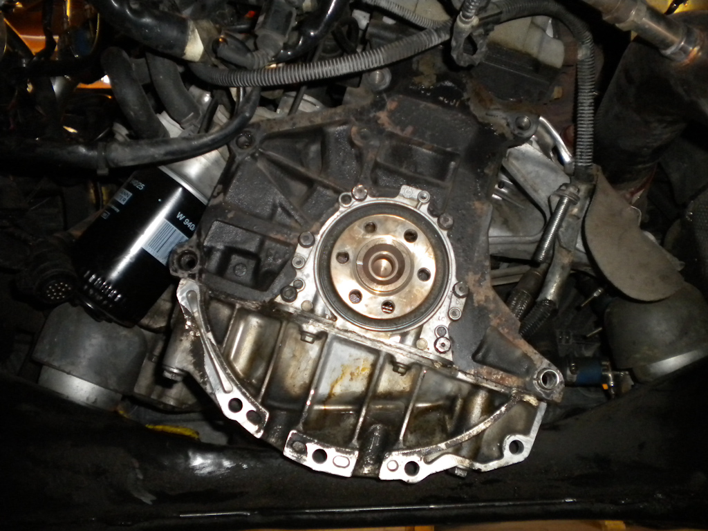

The flex plate:
Flex plate removed, view of the rear main:

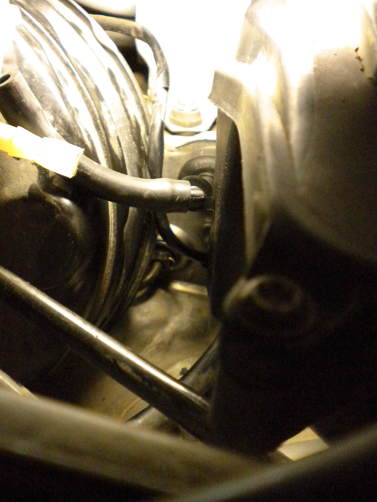

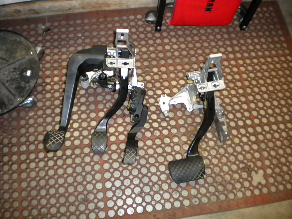

Next was to remove the pedal cluster. It wasn't too bad to remove, but there are two tough bolts to remove that hold the brake booster in the engine bay:
Accel pedal swapped to the new pedal cluster:

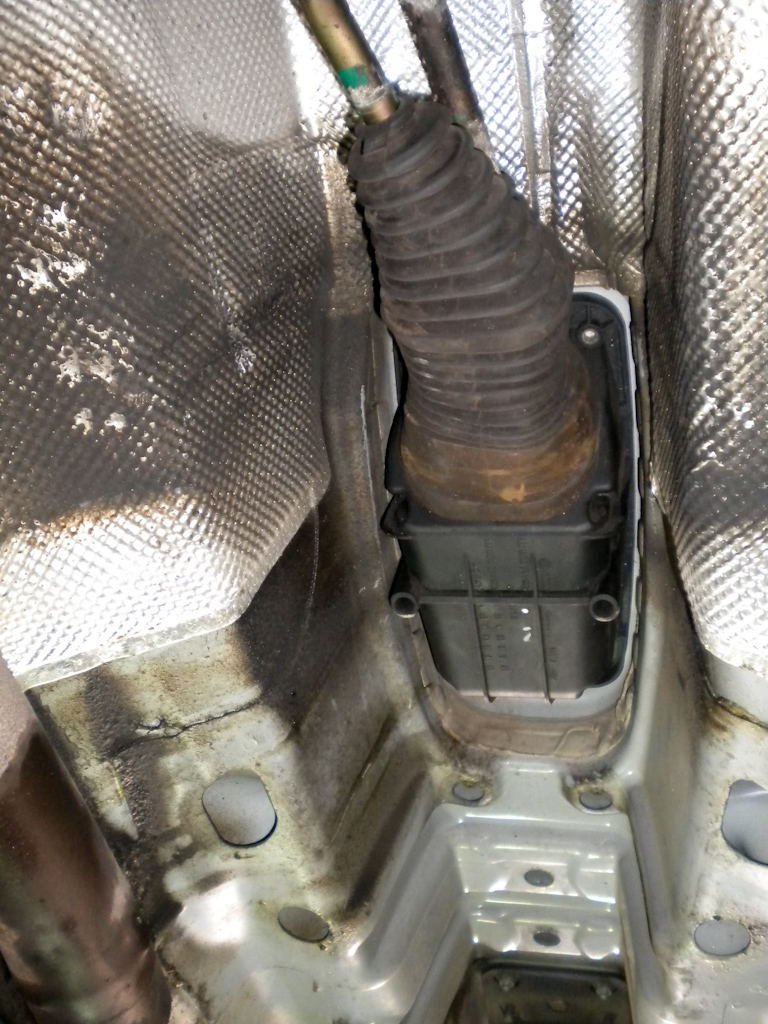

A view of the empty driveline tunnel so far:

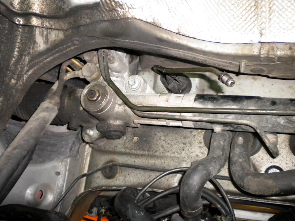

Today I ran the master/slave cylinder hardline and reservoir soft line through the firewall. Luckily there are already grommets there, just needed to be punched through. The top line is the line that runs from the brake res. down to the master cylinder, which feeds it with fluid. The bottom is the hard line that runs from the master to the slave cylinder, via through the bottom of the firewall:
Looking up at the firewall, the hardline:
