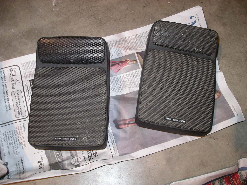

PO took the speakers and stereo from the car. Must have liked the BMW Premium sound package :screwy: Having never heard it, I can't say if I'm being for real or sarcastic. :)

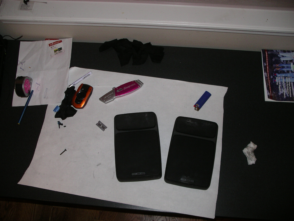

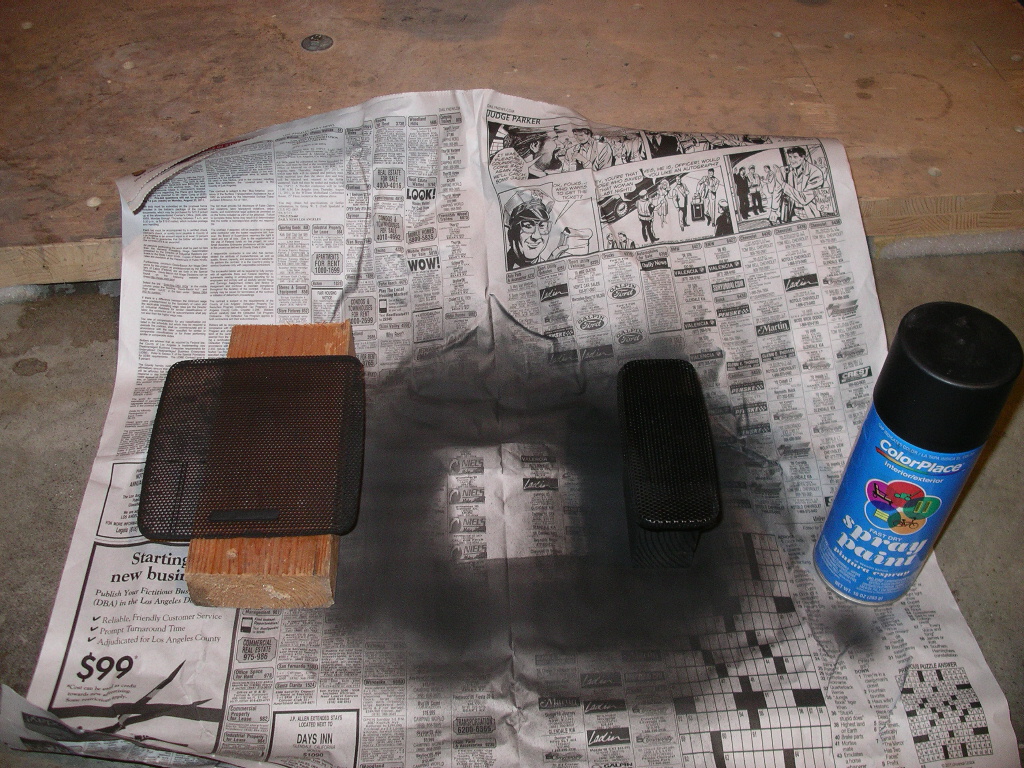

Got some speakers off the forums but they're dirty and such so a little freshing up was in order.
Before picture

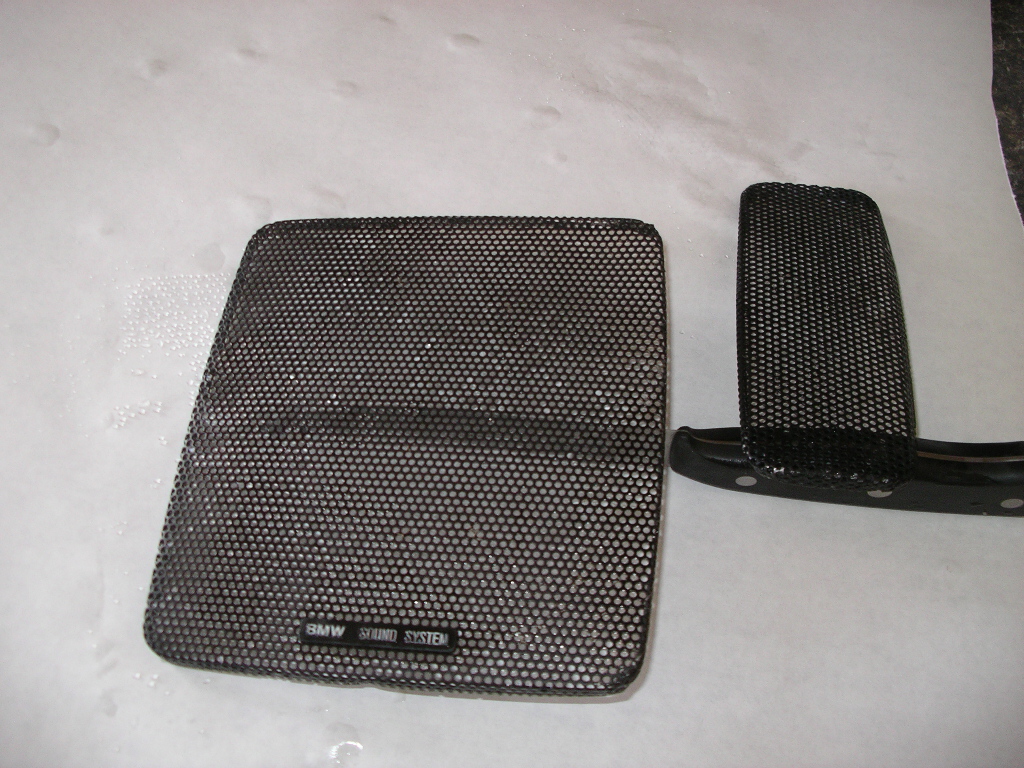

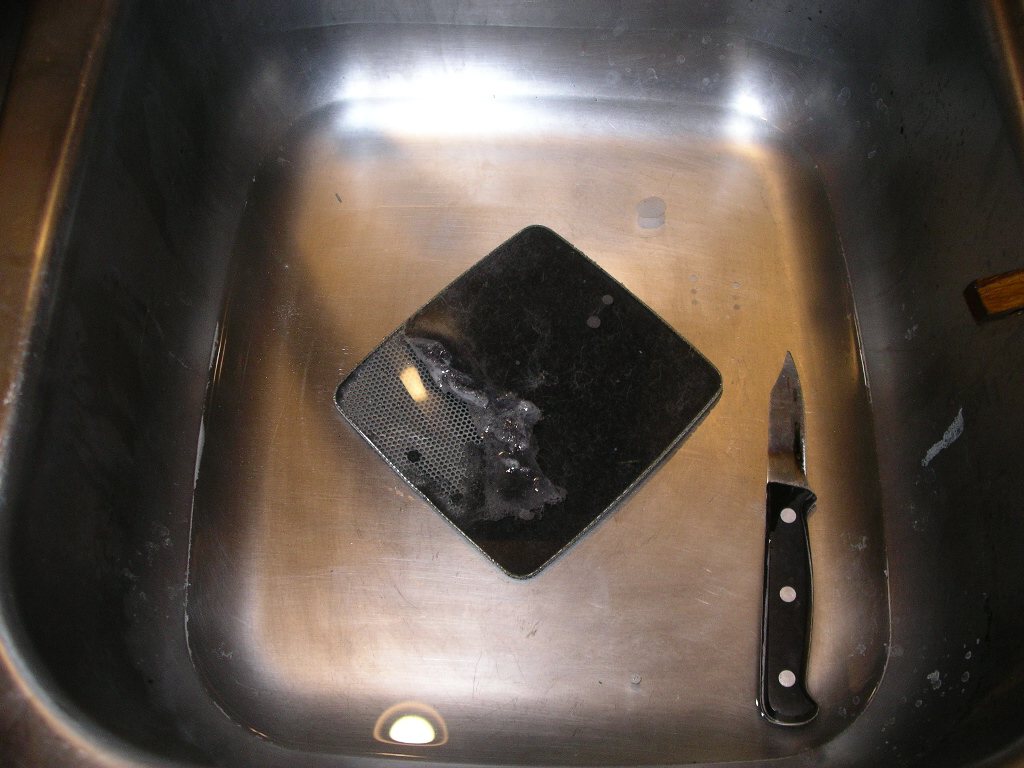

Had to soak over night to get the cloth off. It's stuck on good.
Scrubbed with small wire brush
Painted with high quality flat black. Ha. figured these wouldn't see high impact, so just the cheap stuff

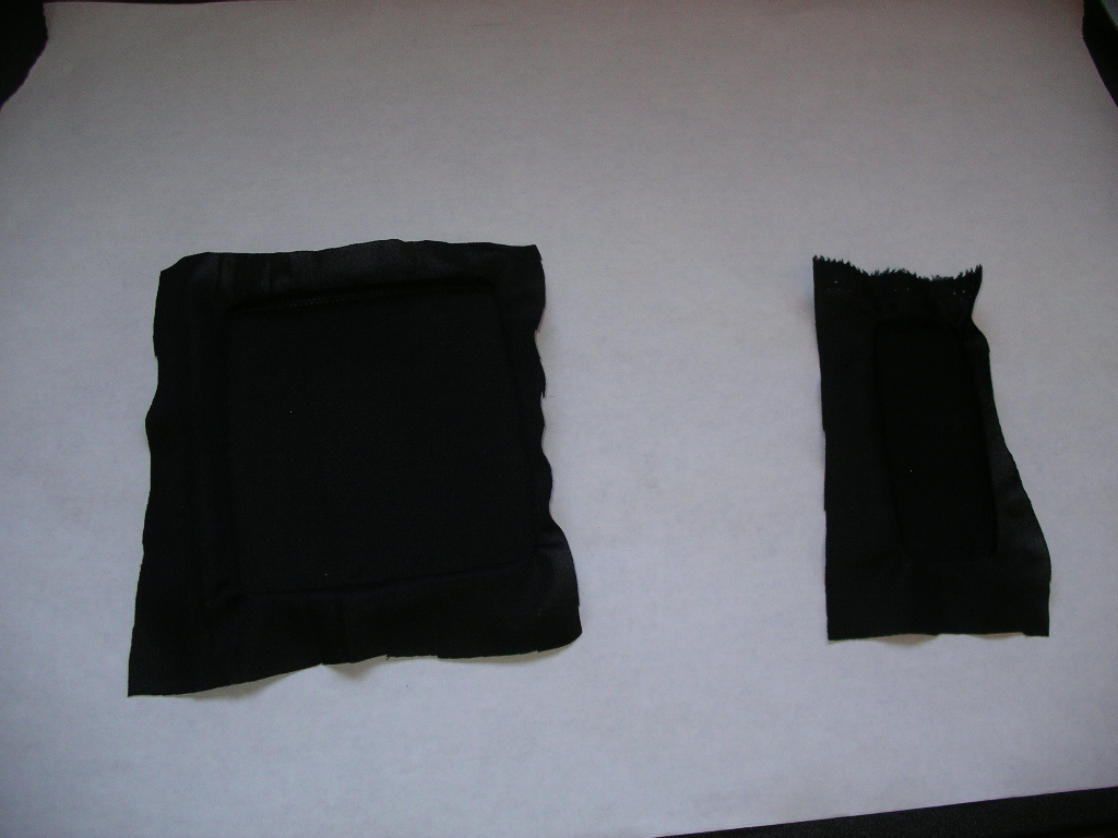

Got some new speaker cloth from JoAnn. It's the type that you'd use on the grill of your home theater, not like the real thin stuff I took off but I think it's going to work.
I melted the edges after trimming to give it a clean look. (meh, it's covered anyways)

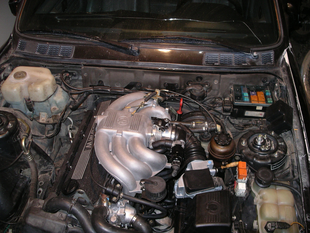

Also fiddled around with my high idle. I'd taken the airbox out again to track down and fix a small coolant leak yesterday, so put that back in.

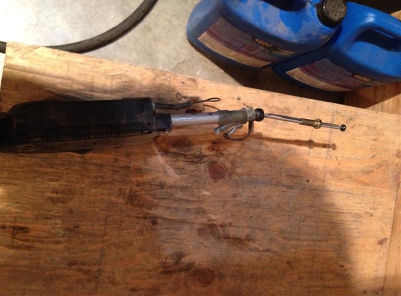

Then after making absolutely (ha, never say that) sure I didn't have a vacuum leak like ghetto mentioned, I played around adjusting my ICV. BMW says this is a non adjustable part but whatever, you just un-crimp it and turn it like you would adjusting the beam on a maglight. This got my idle down under control though it does.. lope?/fluctuate a little. Maybe that's normal or a symptom of my dry A/C system?

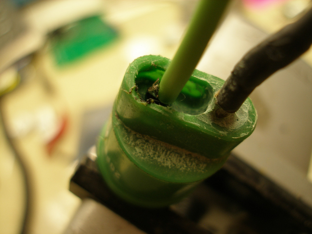

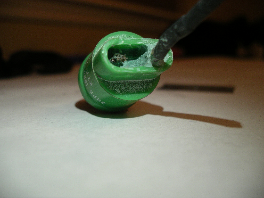

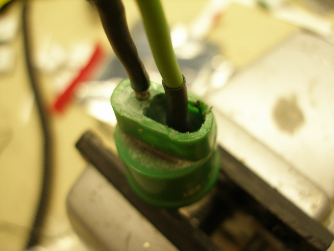

Lastly, I had a sensor or presure switch of some type on the A/C system that had a wire broke off right where the wire meets the potting. So I carved it out with my dremel. I'll solder on new leads tomorrow at work.

Fixed up the sensor.

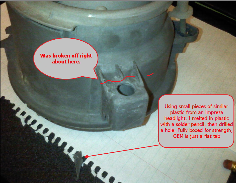

This is out of order. I had a loose headlight. Since these puppies are glass lens, replaceable bulb, projector type (how cool is that in 1988?) replacement new OEM is like 255 dollars, with used going for upwards 100 online.
Turns out one of the housings had a broken adjuster tab so I thought I'd try welding in some new plastic.
Don's repair hooked me up with a broken headlight from an Impreza. All I did was cut off pieces from the Impreza housing and use my solder pencil to weld them in place on my housing. Very similar to what you'd do with a tig torch but much slower as your actually heating your puddle with the tip of the solder pencil.
So far it seems pretty strong.

Finished these up tonight. Turned out okay, not great in my mind. Anyone know how to paint the raised letters on the speaker grills? They are really fine, I thought I might try smearing whiteout on a large pink eraser or something and putting it on like a stamp. :screwy:

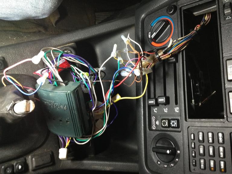

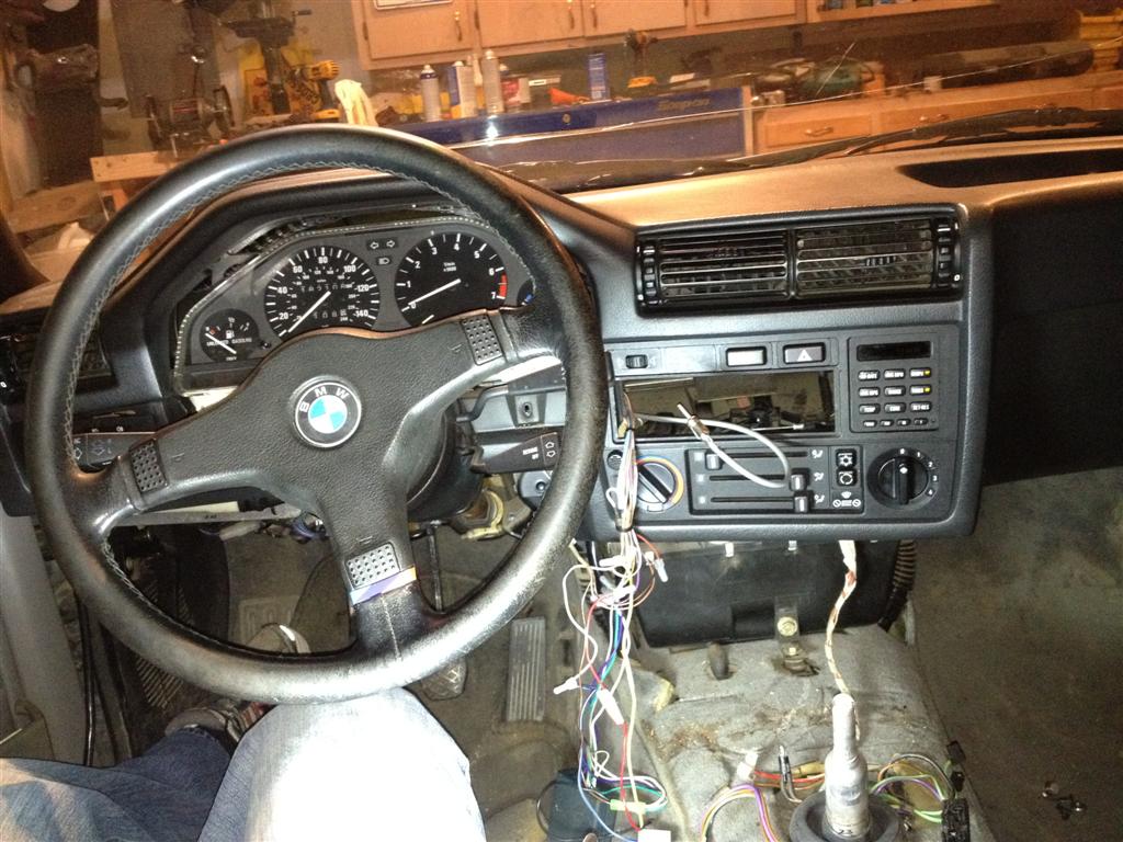

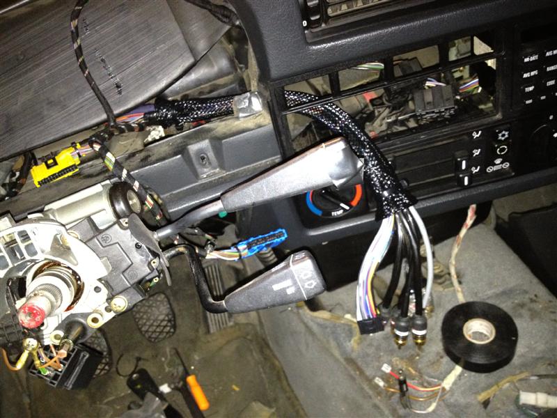

I'm pretty sure my idle wonkyness is my ICV valve so while I'm waiting for a different one to show up I thought I'd tackle the radio that's missing.
Here's the goal. Seems like a cheapy but reviewed really well on r3v so I'm going to give it a go.

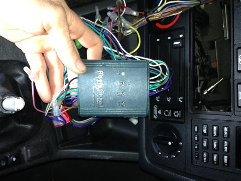

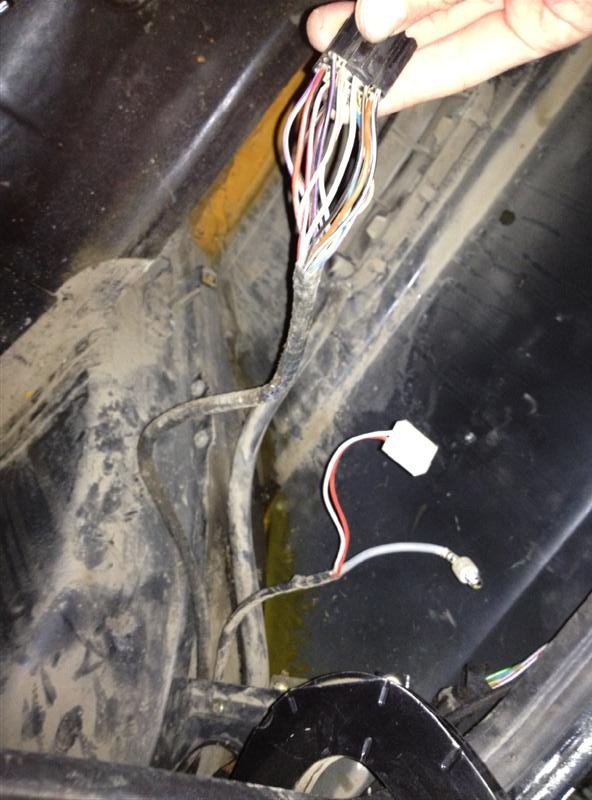

Must have been an aftermarket job in there before. Somewhat of a mess.
This thing was stuffed in there. Near as I can tell it's some sort of fader? :question:

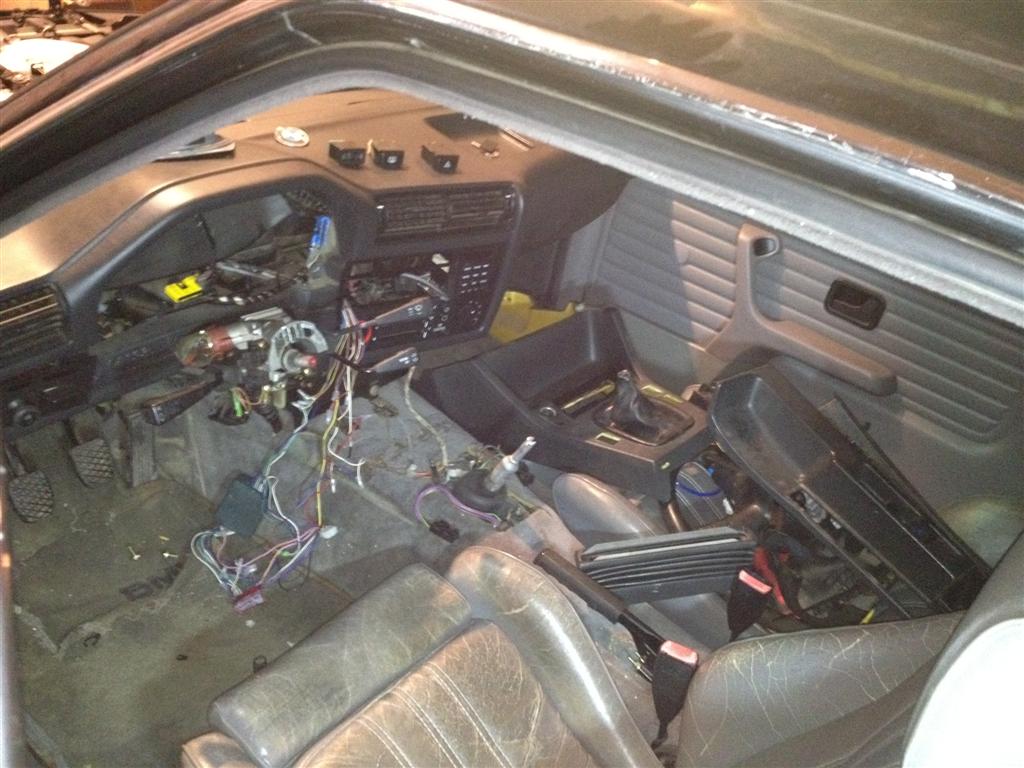

Just plugging away taking pieces out to get to things

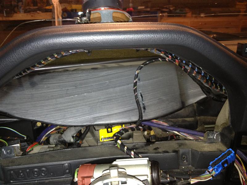

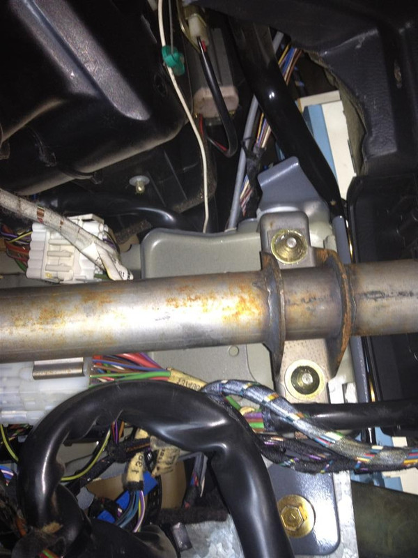

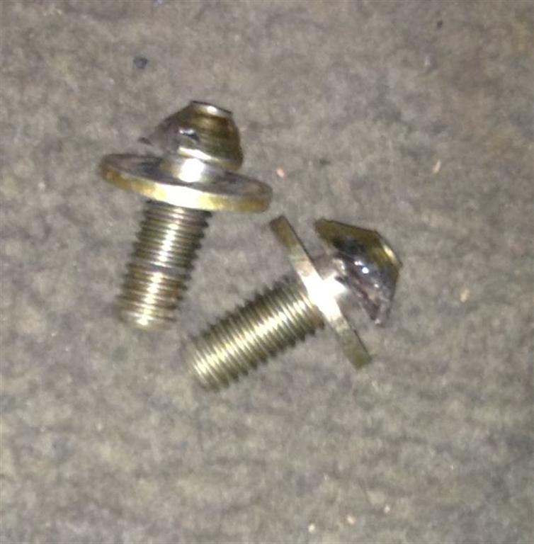

Steering column needed to move down so I could remove the instrument cluster. Silly tamper resistant bolts.
Are no match for my dremel
With my car/year/model not all the wires run to the HU, so hunting down what wire to what. There's an OEM amp in the truck so needed to remove the back seat and door sill
Left my meter at work so.. I'll leave it here for the night
:beer:

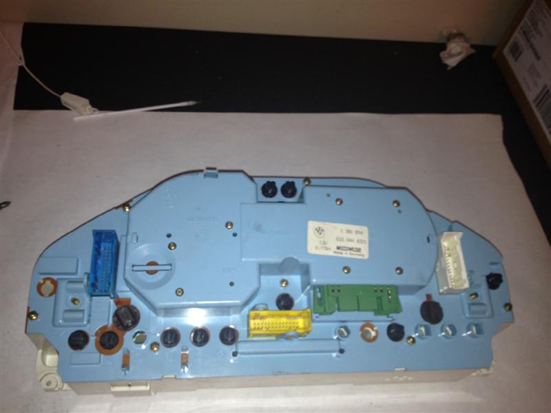

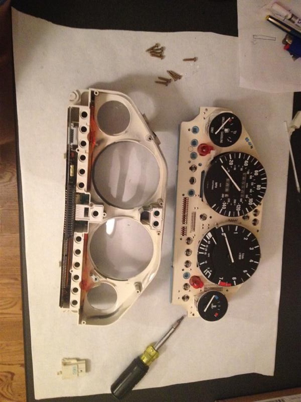

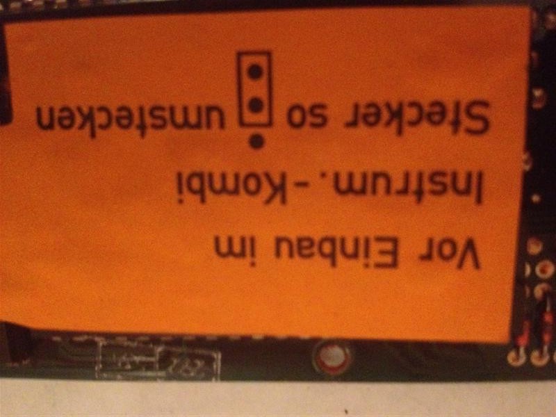

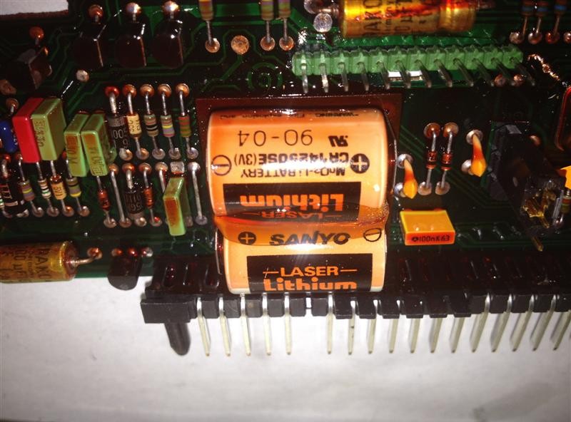

Since I had the cluster out, I wanted to replace the SI board batteries. These control the memory of the check engine and service indicator lights EG if they go dead, you reset the light, then they come back on :( .
9 screws, not that bad

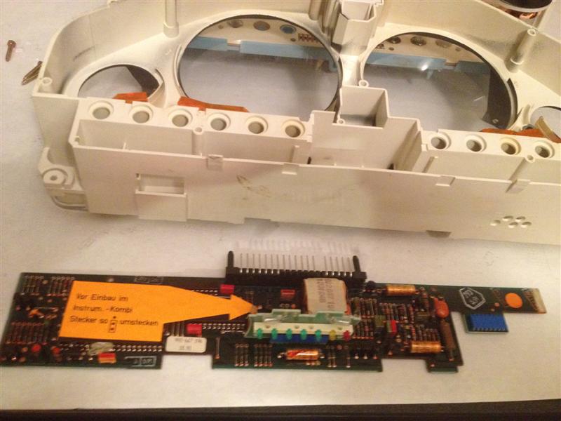

here's the board I'm after
Please, anyone fluent in German? I tried translating and it's something about before installation, but I think there's some shorthand or something. It's pointing to a 3 pin male header with a jumper between 2 pins.
These cute little guys are what I'm after. Some years had rechargeable nickle metal hydrides, these are just regular ol magnanes dioxide :\ meh, hope I can find some at radio shack, else I'll have to get them from digikey.

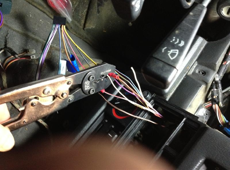

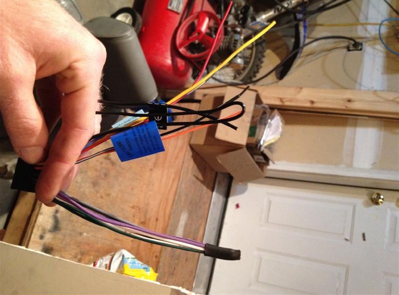

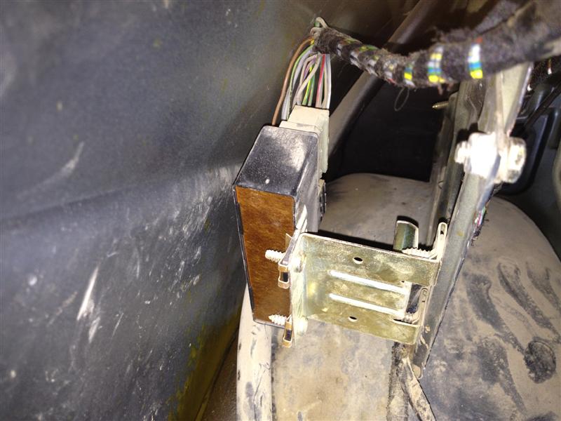

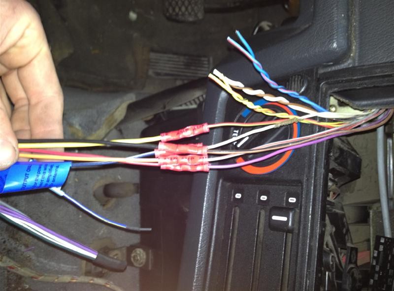

Capped off the head unit speaker wires & then connected the battery power, ignition power, dash lights fade wire, ground and capped off the fader control wires (mine was the 6 wire version)

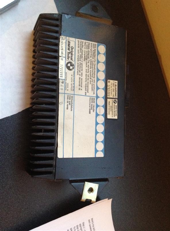

Removed the OEM Amp. Put the diode pack back with the little bracket. Also removed my non functioning power antenna.

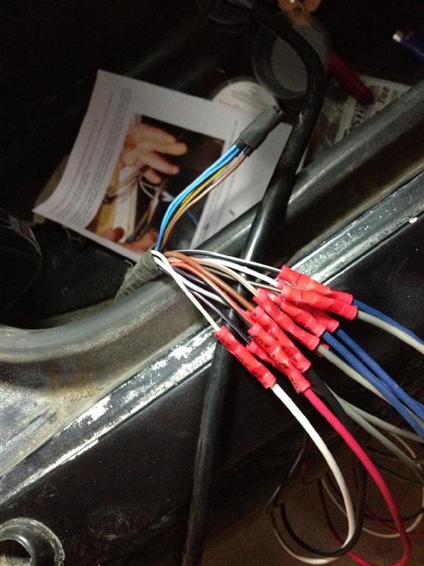

This is the plug for the amp. What I'm going to splice extension wires into in order to connect to the amp.

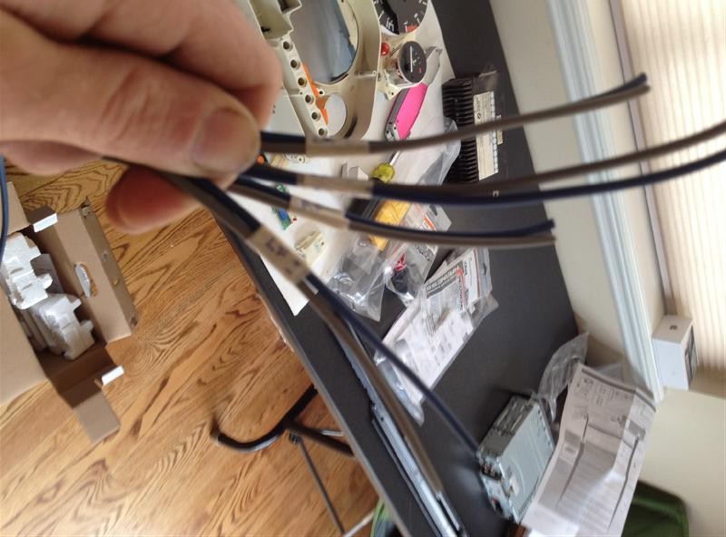

Next up I cut 4 pairs of 1 blue and 1 gray wires about 3' long each and labeled them. These are to splice onto the wires that were plugged into the OEM amp and are now going to be connected to the new more better amp.

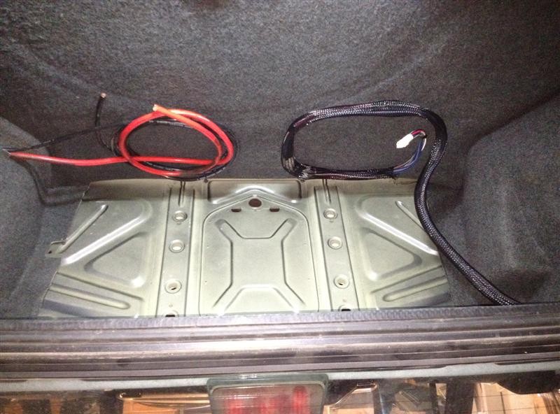

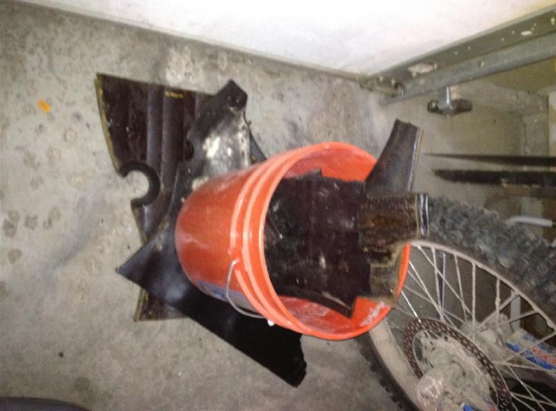

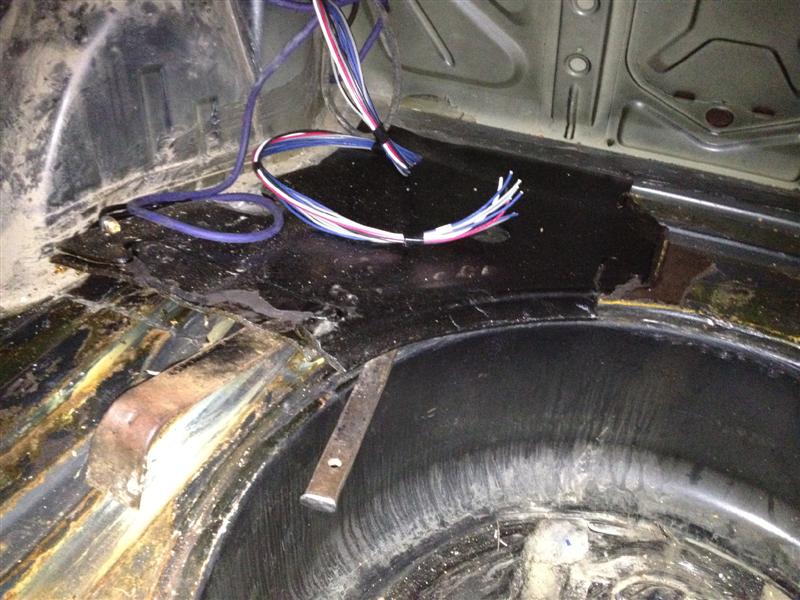

Next up was the trunk tar. I'd really been not wanting to do this after hearing all the bad stories. I used a couple of flat pry bars and it came up in mostly large pieces. :nice: Holy cr** though, (yeah I'd read it) but dang this stuff is heavy. I weighed it with a fish scale, 60 lbs.
With that out, I began routing RCA cables. I started at the front. I know the bible says to start in the rear, but I thought it'd be easier to hide extra wire near the rear of the car, so that's what I did.

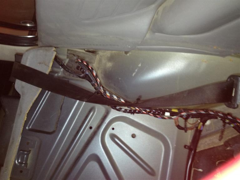

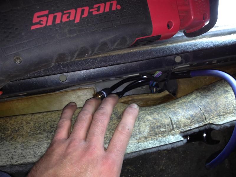

I removed the door sill thing and the seats and loosened the top bolt and removed the bottom bolt on the lower seat belt slider thing.

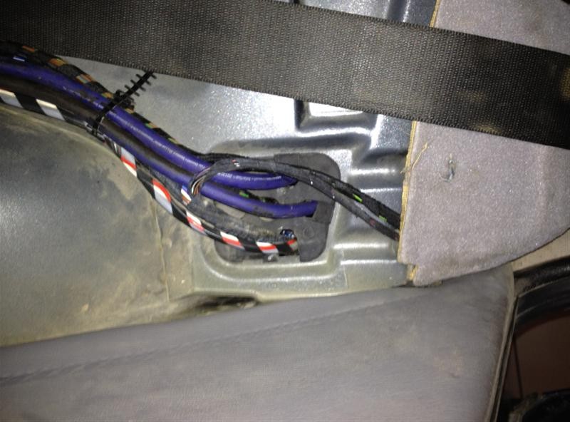

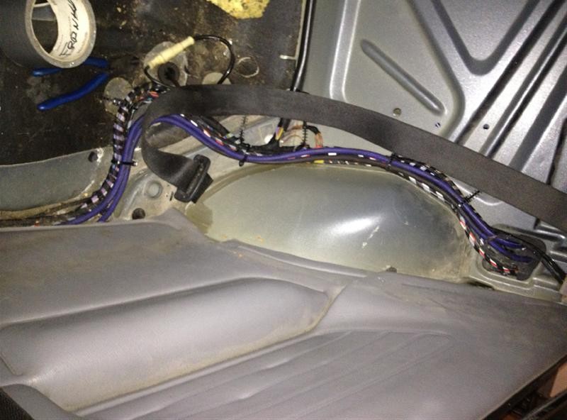

This is along the sill, I went under these wires.
Cut out the oval blanks (two, one for each RCA).
Zip tied in a few places, kept them not too tight per suggestions in other threads.

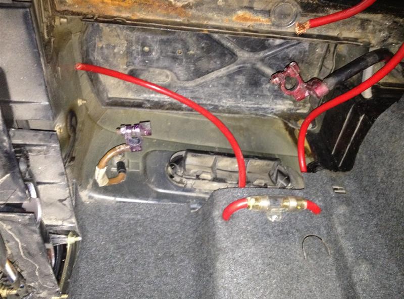

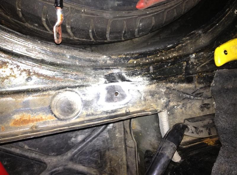

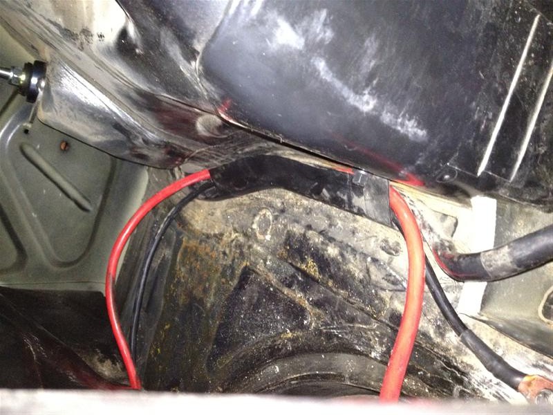

Then I made a ground connection. I sanded down to bare metal then used a 1/4" SS sheet metal screw to attach my cable with. For the cable I used 4ga with a solder on solid copper battery lug.
Installed the fuse holder.
Then ran them both in the OEM loom toward the front of the car.

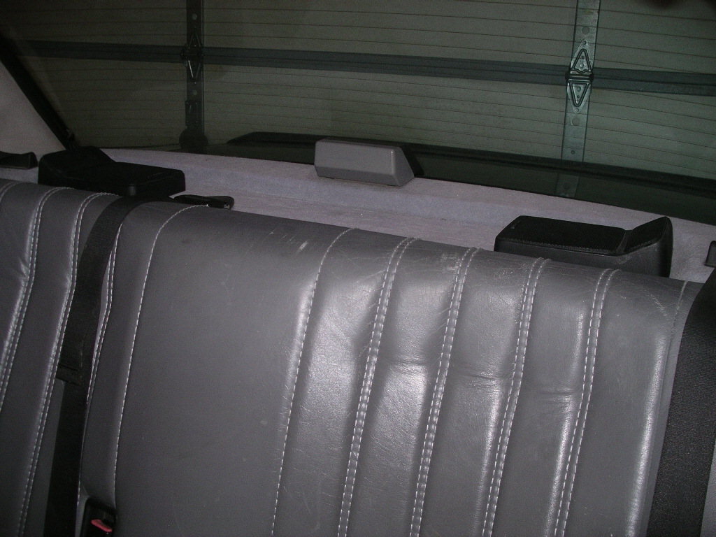

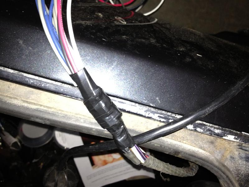

Poked the power and ground cables out of the trunk liner about 10" rear of the firewall per directions in the bible. Hung my RCA and my amp extension wires for the speakers over the top of the other side trunk liner.

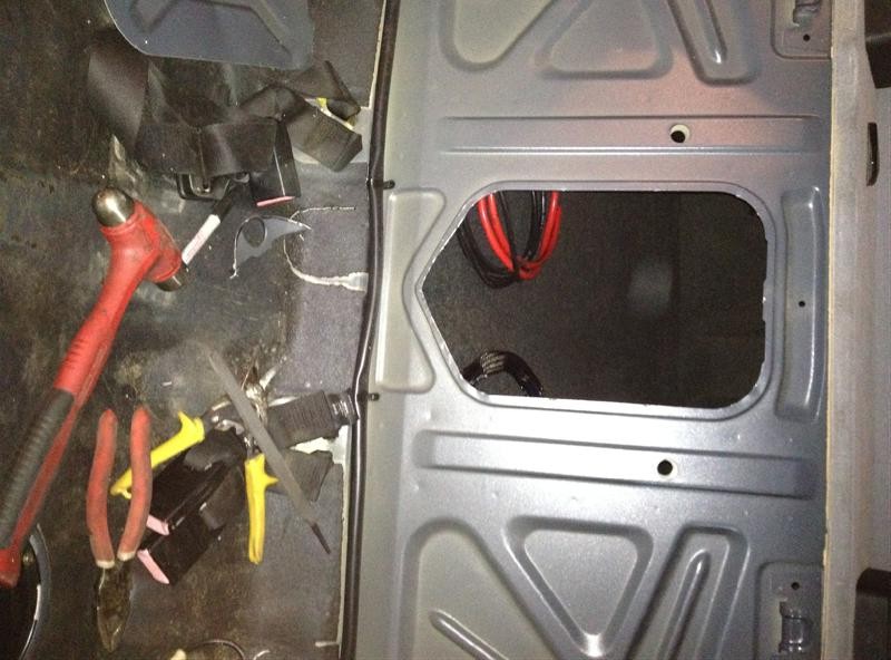

Next up the ski pass through hole. I just whacked it with a hammer and it came right out. Then I cut a little bit out of the bottom of it like Luke suggests with a tin snip and filed off the edges so I wouldn't cut myself later.
Lastly I tiddy'd up the wires in the dash. A keen eye will note 3 pairs of RCA. I had the RCA cables so I ran an extra pair in case I upgrade my deck in the future to one that has a dedicated sub output. For this install though, I will only be using 2 pair.
