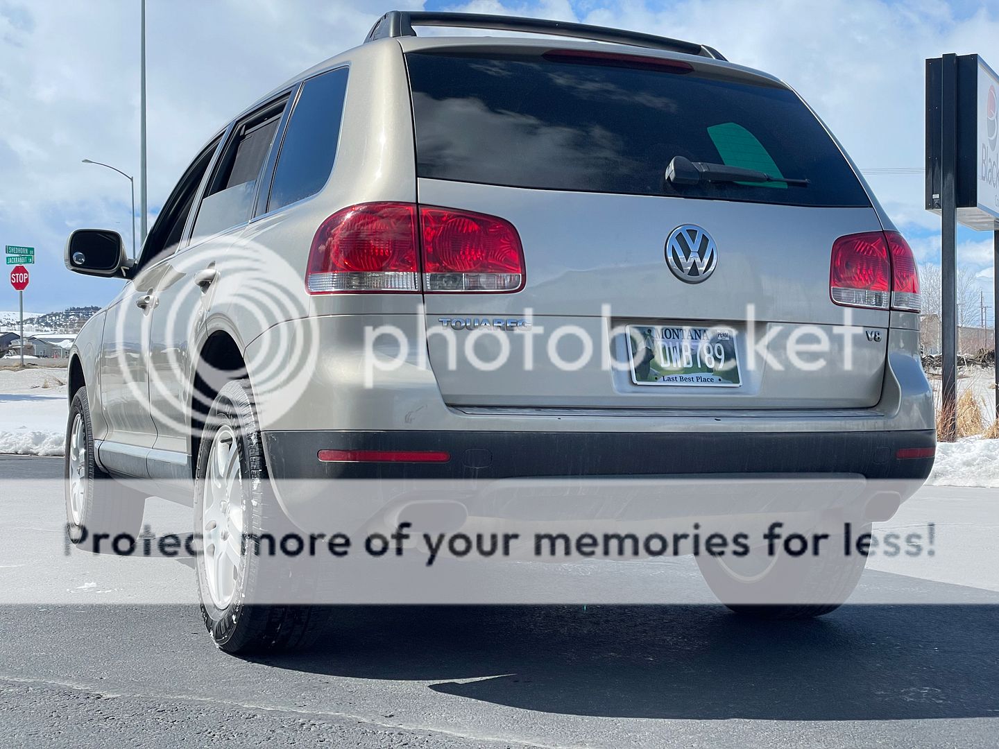

Took this guy home.

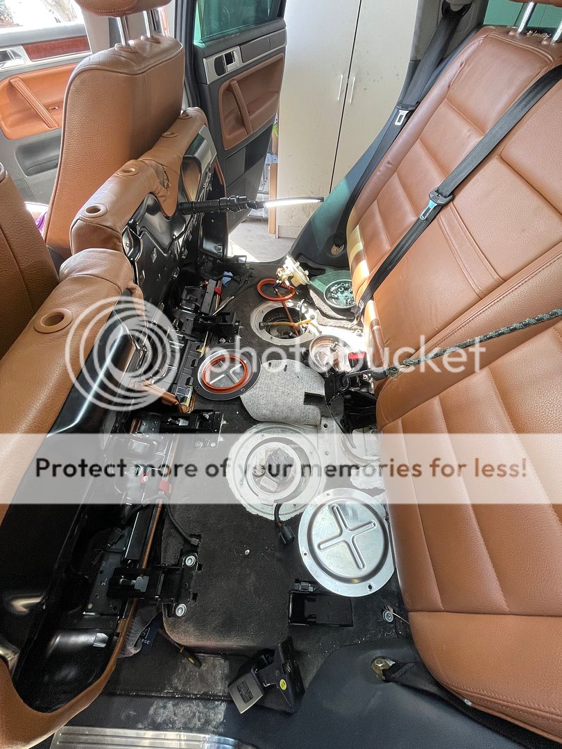

Got it from someone that was unable to finish replacing the fuel pumps.

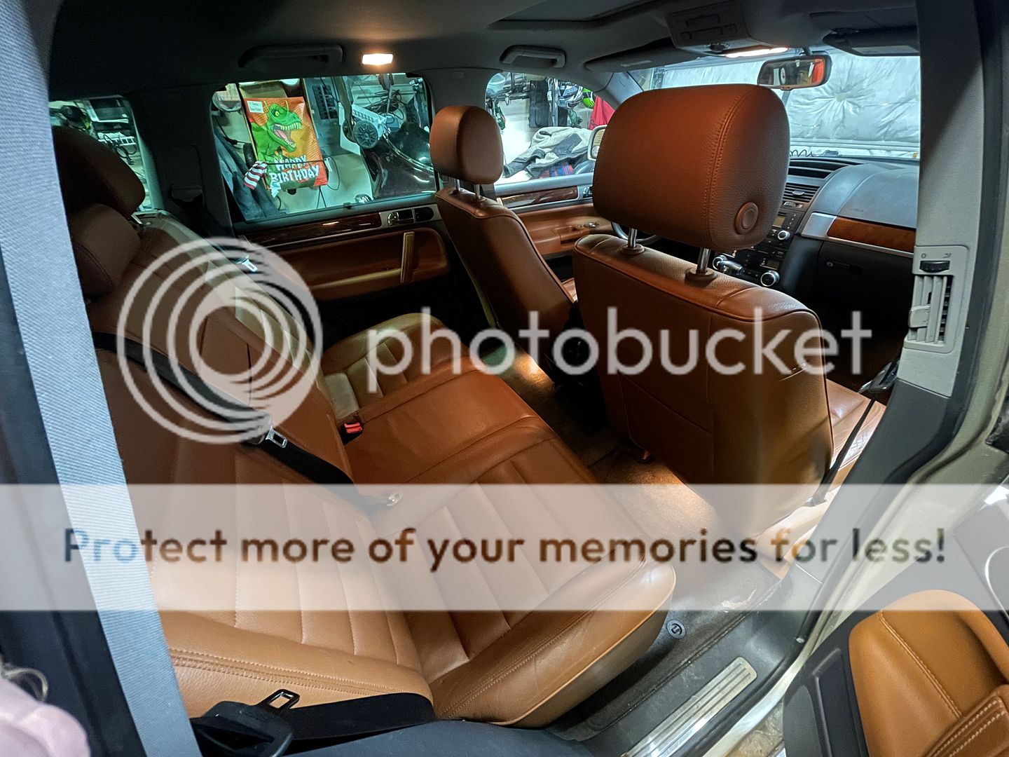

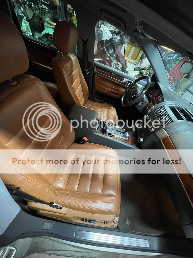

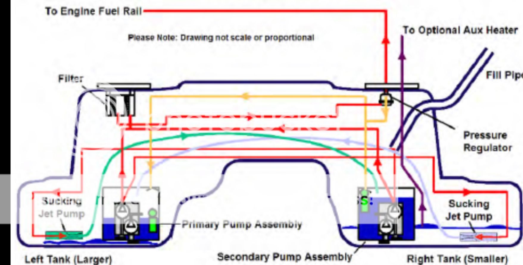

Managed to get everything reassembled and gave the car a good cleaning. Inside was gross.... That fuel pump system is a nightmare.

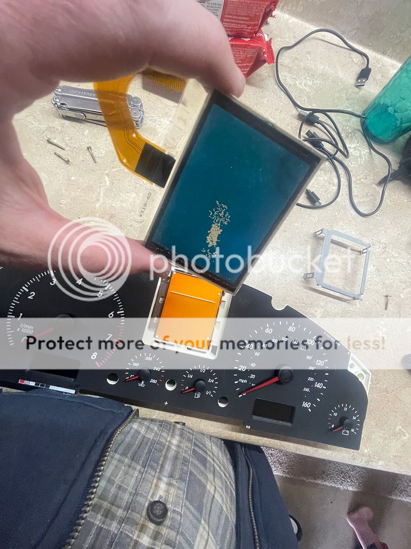

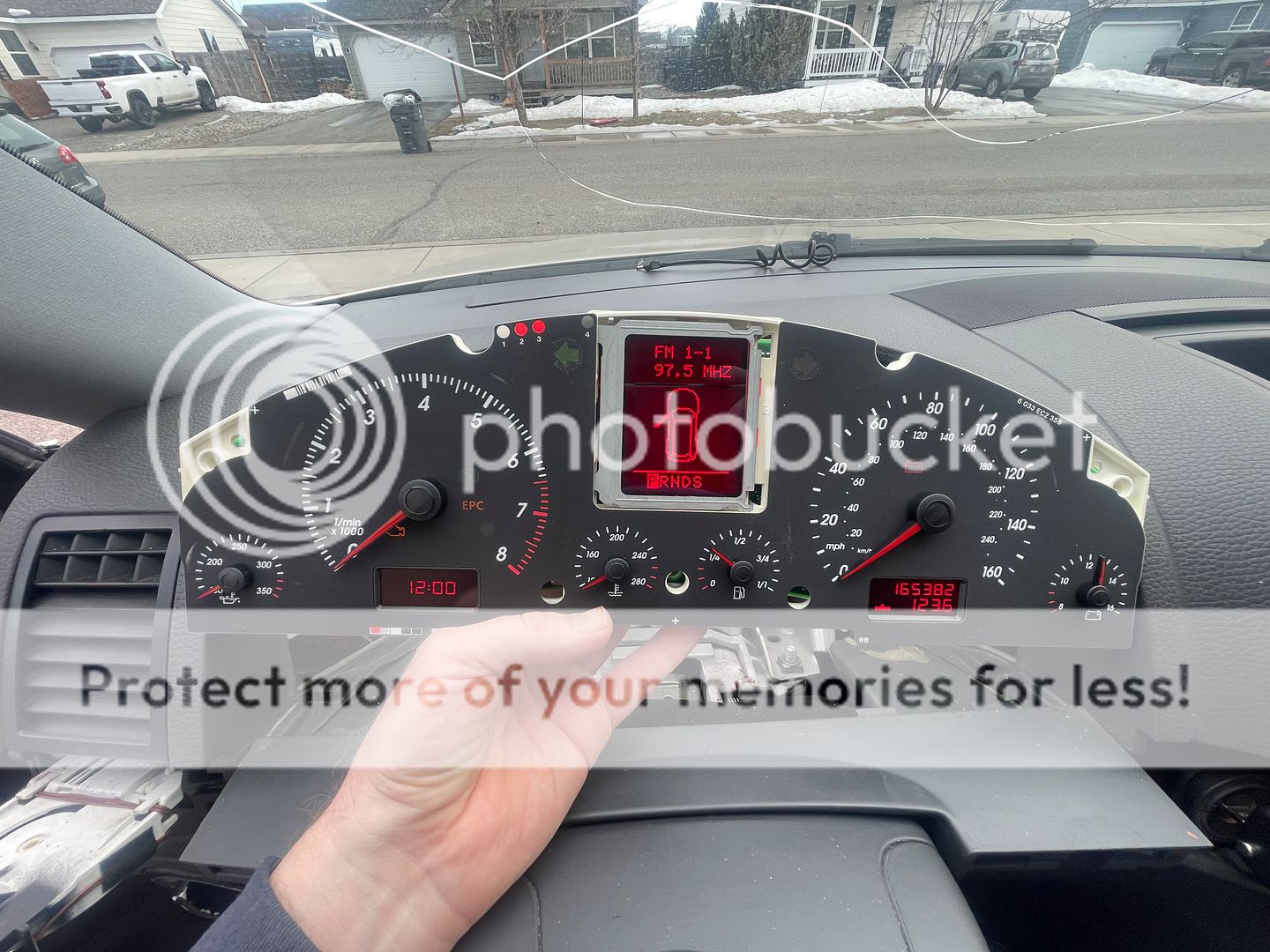

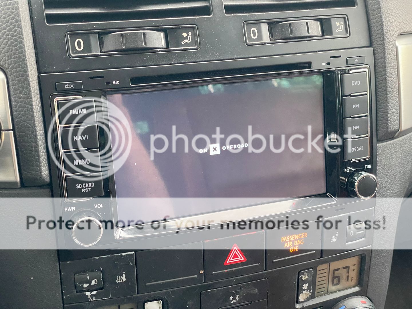

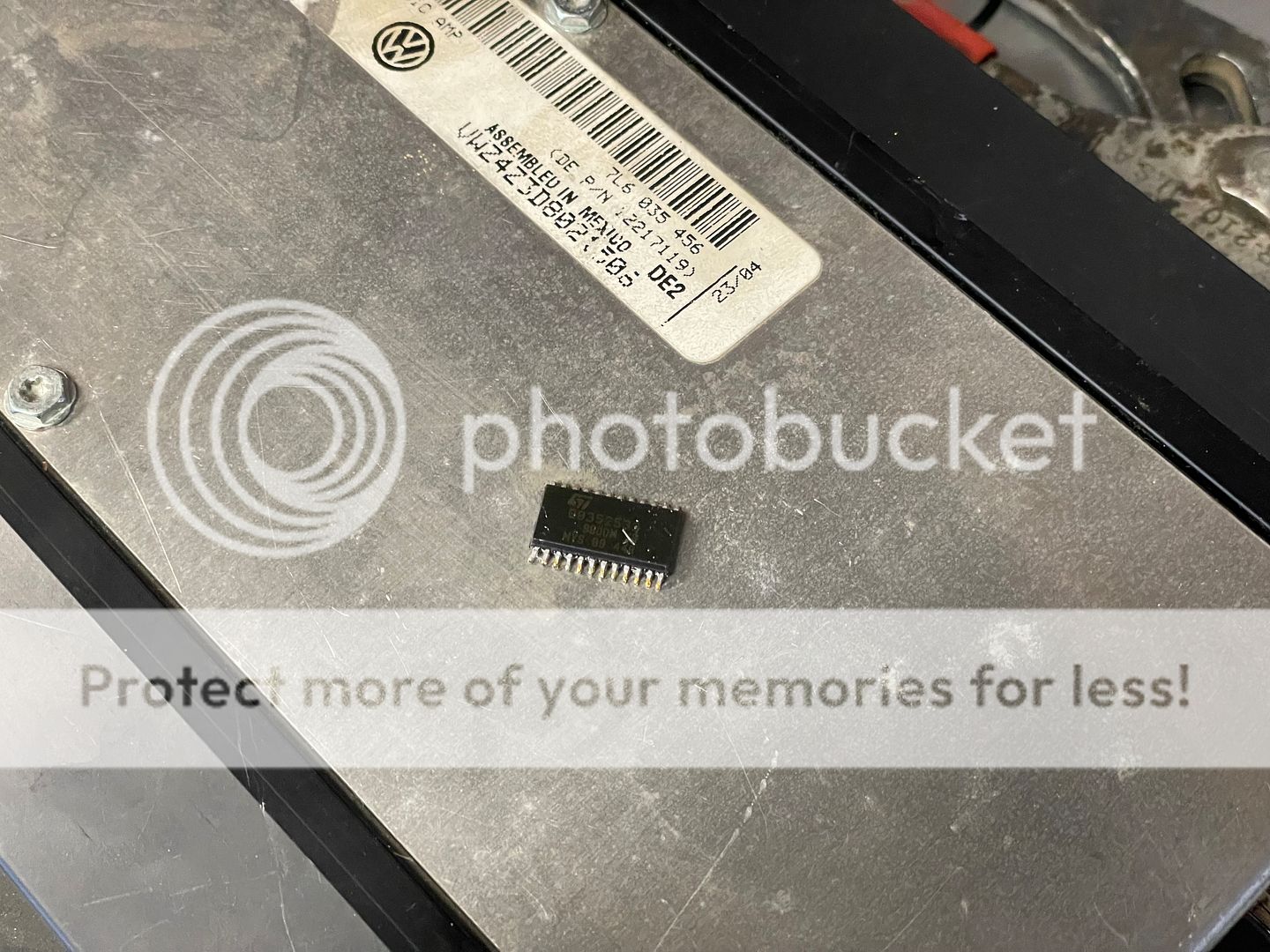

Fixed bad LCD.

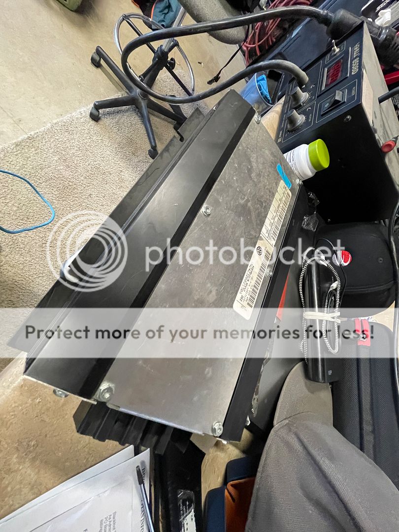

3 amplifiers later, I learnt that by removing the CANBUS chip, you cannot login via VAGCOM anymore but the unit puts out sound again.

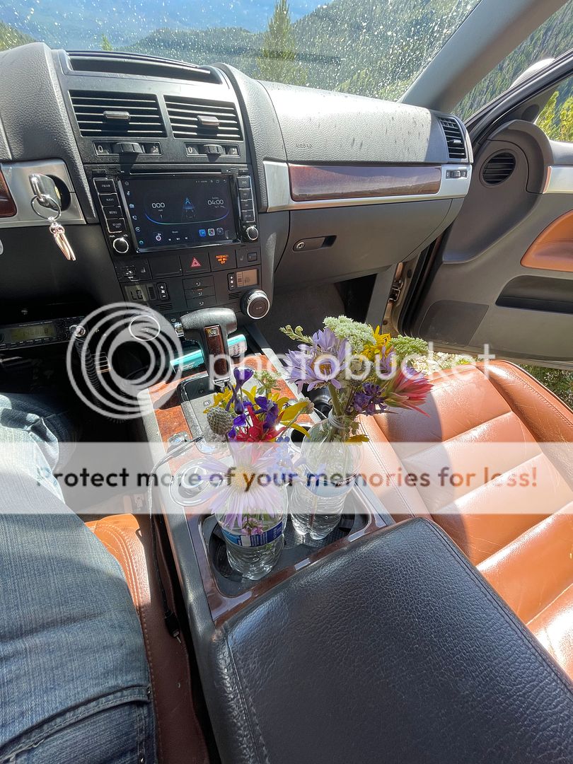

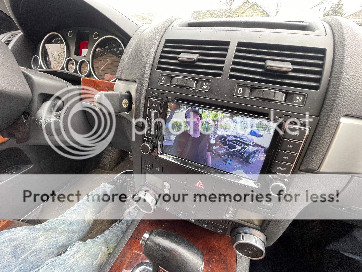

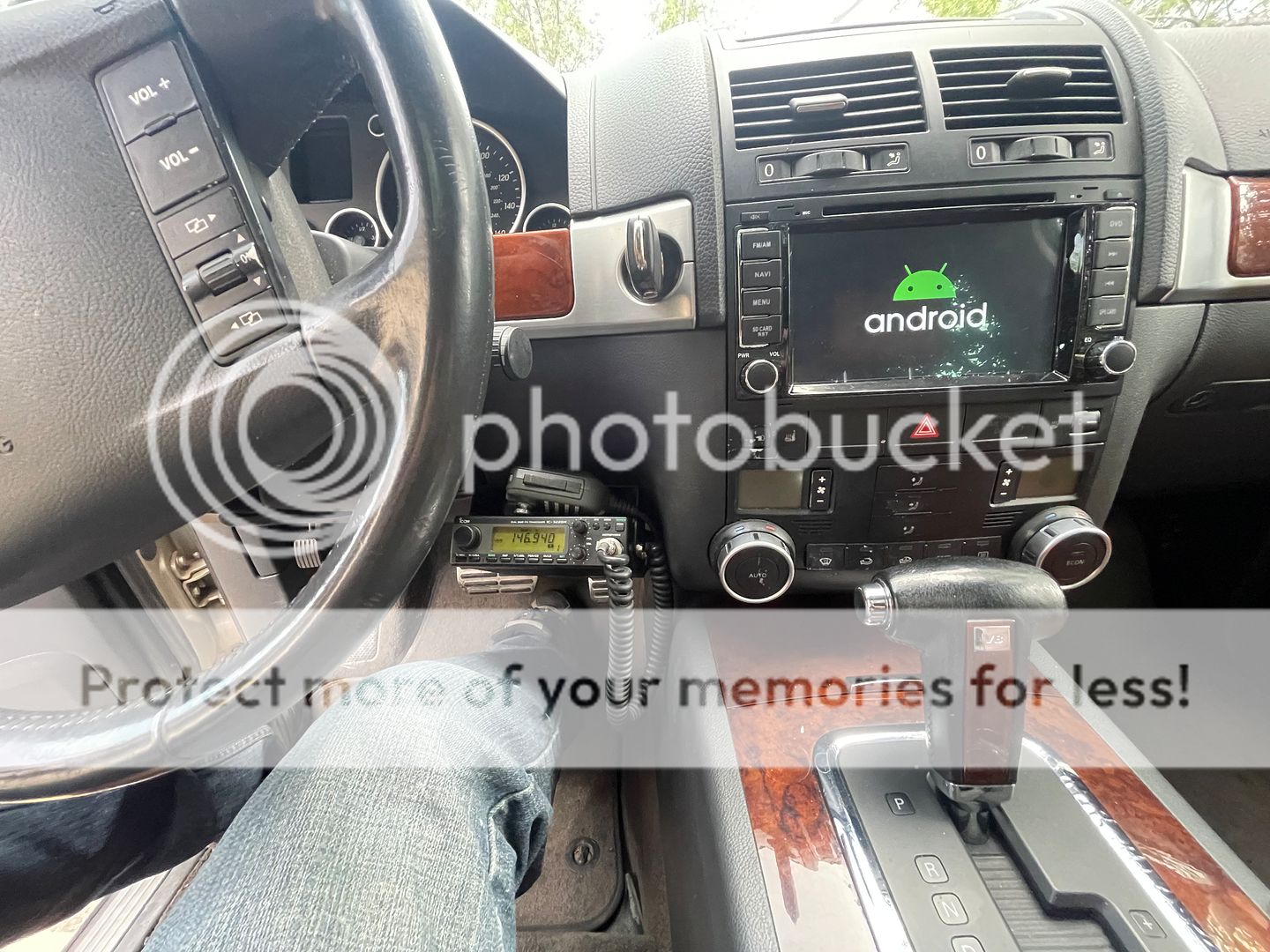

Installed New Xtrons Android headunit and ham radio.

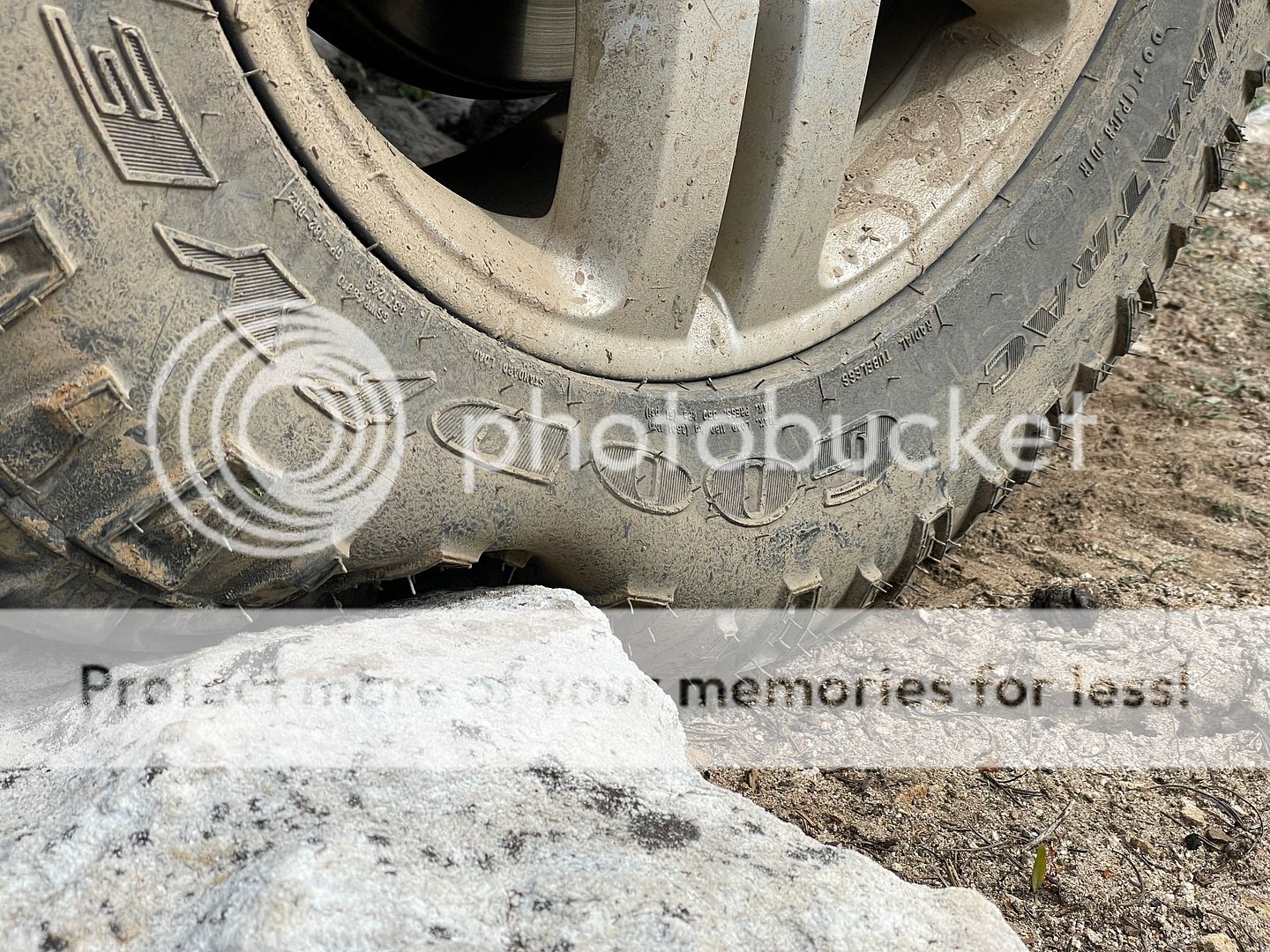

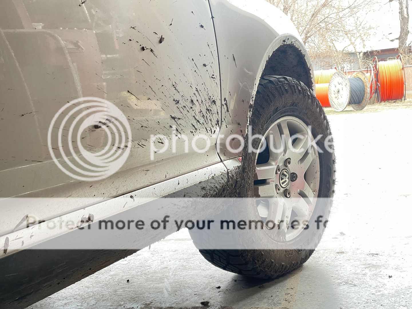

New 32" Duratracs

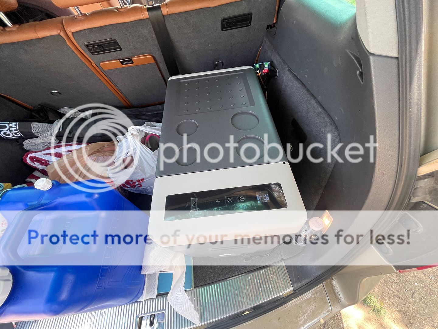

Refrigerator

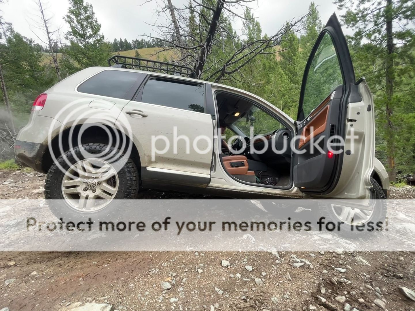

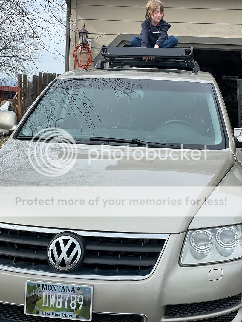

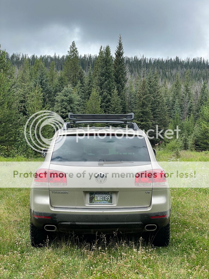

Roof rack, new windshield and polished headlights.

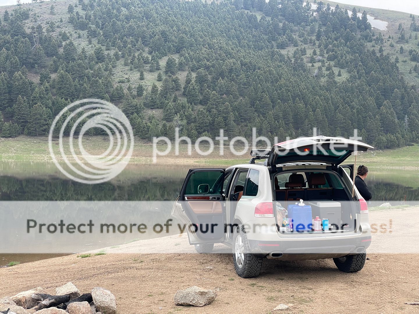

We have been having a blast with this thing.

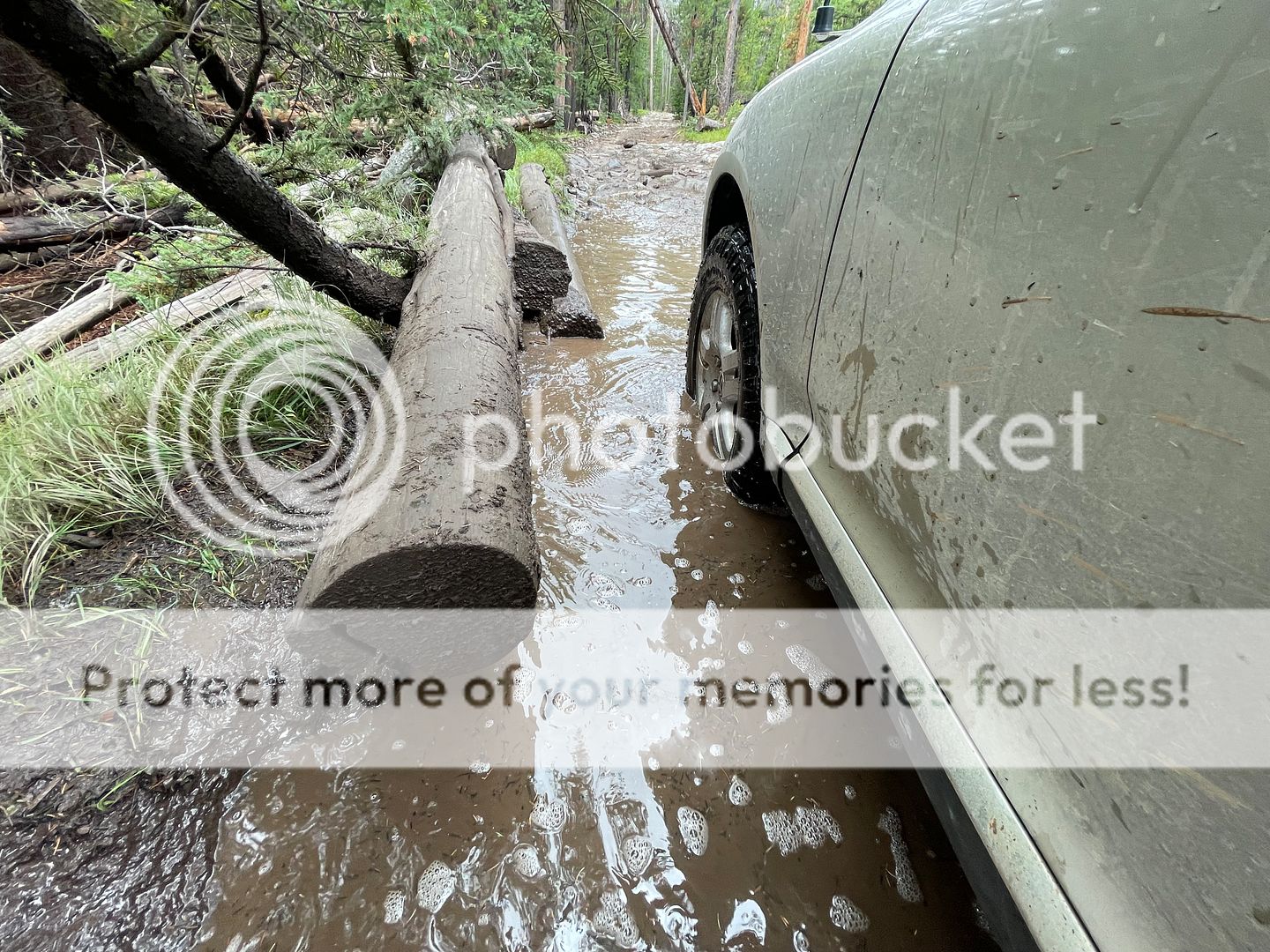

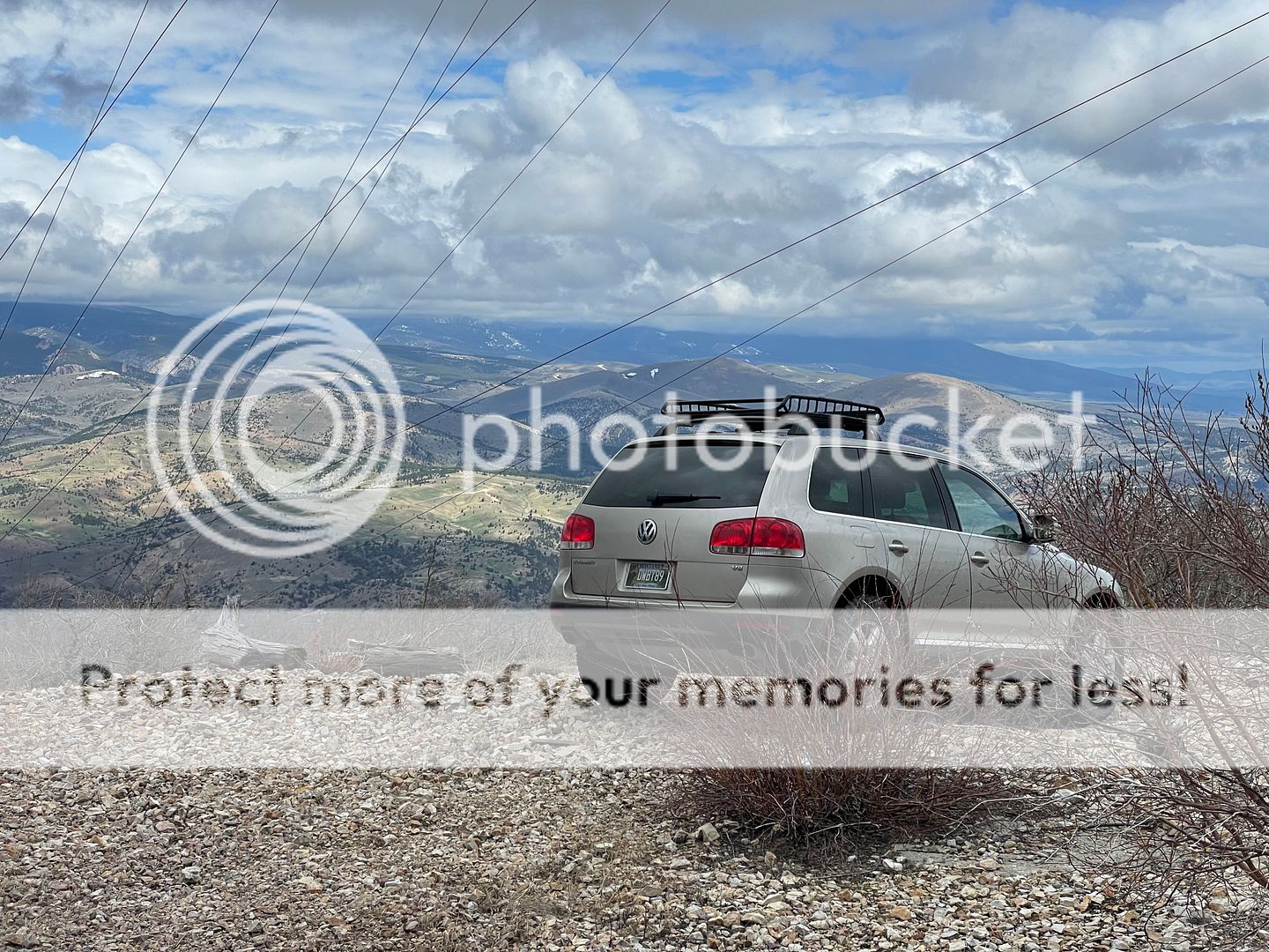

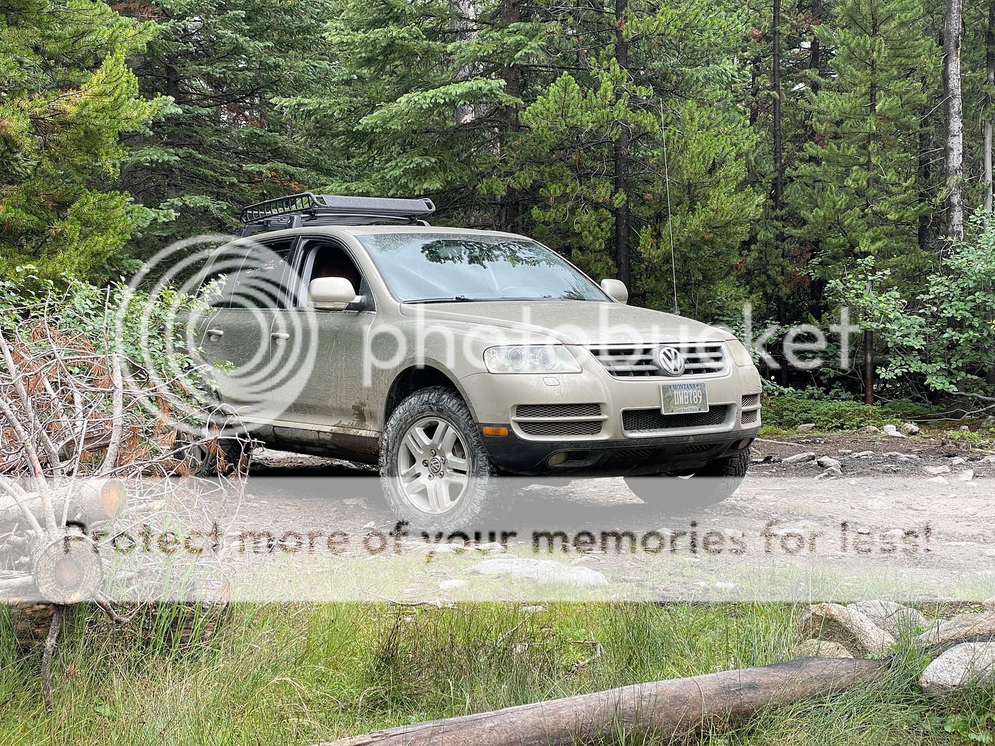

I've been calling this a luxury Side-by-Side. We have been out on a pile of trails now, and it just keeps surprising me.

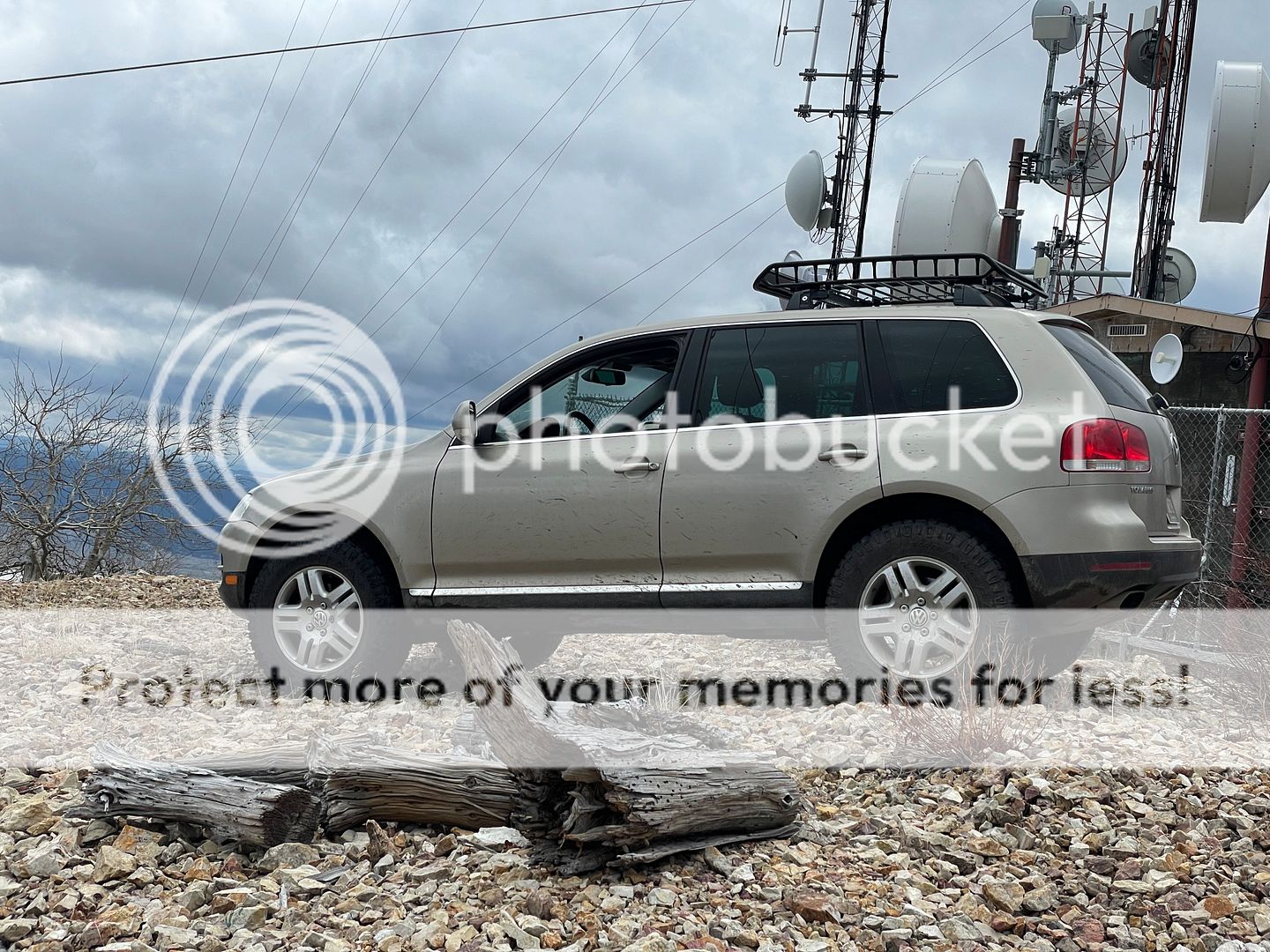

The stuff it will crawl up and through is amazing. The traction system in 4low is incredible. When encountering an obstacle or lifting a wheel, I just keep steady throttle and it figures out which wheels to brake and it just keeps going. It goes up super steep loose junk like a boss.
Assembling parts for a lift, and should have that done sometime this winter.

Good one Trev! I saw Deboss on the screen there too :)
