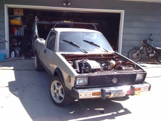

I have a 1995 2.0l ABA engine with OBD I (not OBD II.)

Glad the Caddy is running again........ Getting ready to do something drastic
