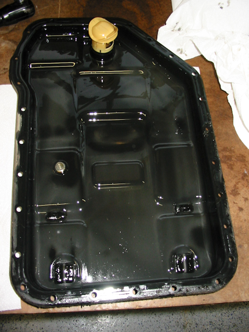

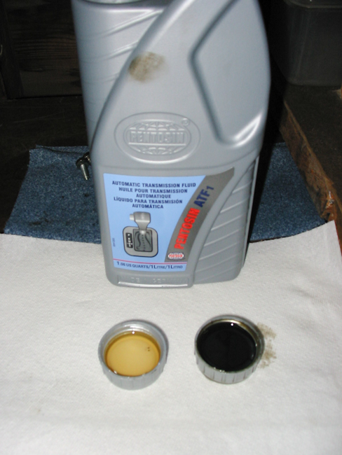

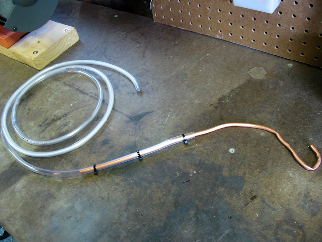

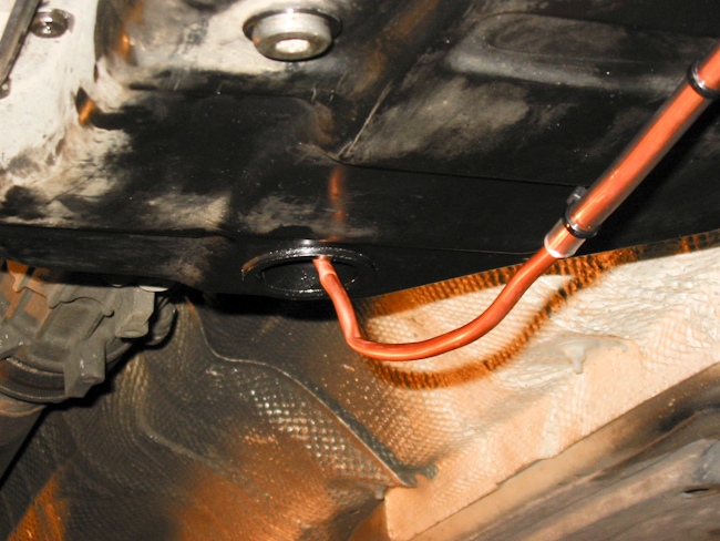

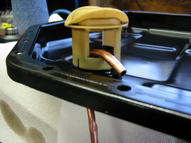

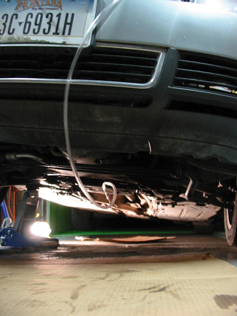

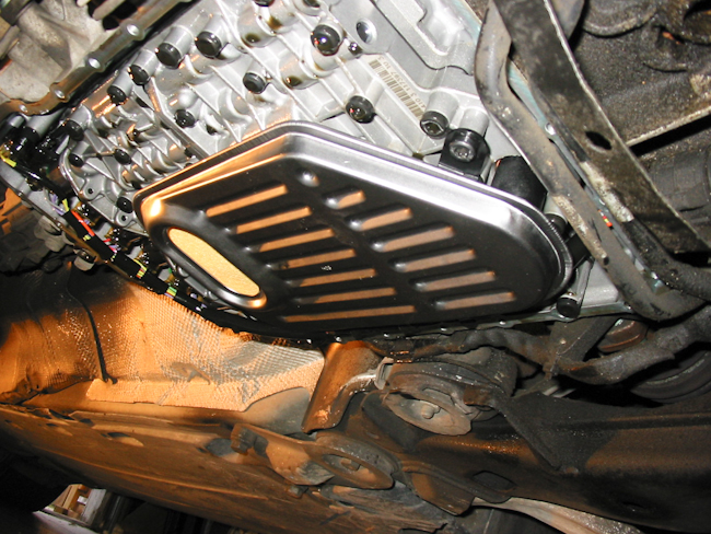

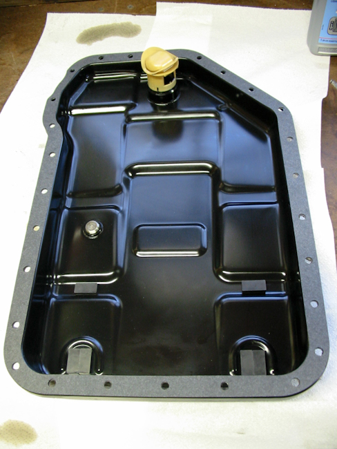

This weekend I changed my 01V auto Tip transmission filter and fluid and took a few pics while I was in there:
New vs. old fluid:
New vs. old filter:
New filter installed:
Dirty trans pan:
Clean trans pan & clean magnets and gasket:
Copper + vinyl tubing = easy trans fill:
Here's how it hooks in the pan:
Filling up:
Add fluid (about 5 quarts in my case) until the temp is 35 degrees C, and it the fluid overflows and it's done.

Very Nice :thumbsup: shift any smoother?
Re: Change your trans fluid...ew
Yeah a little bit, I think the TC is a little smoother when it locks up and the shifts are a little quicker and smoother.
