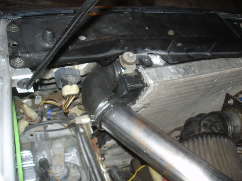

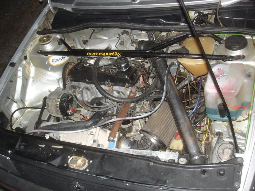

today i installed the FMIC... took more time to do that then swap trannys..
NO MOAR UGLY BOOST TUBES!!

Re: MY FIRST MK2 EVAR! my very own kompressor build
wheres co-pot? K-pot
haha its there.. i put it on the underside of the tube to kinda hide it
since i used steel as boost tubes i was able to chop the co-pot bung off the old euro-sport tube.

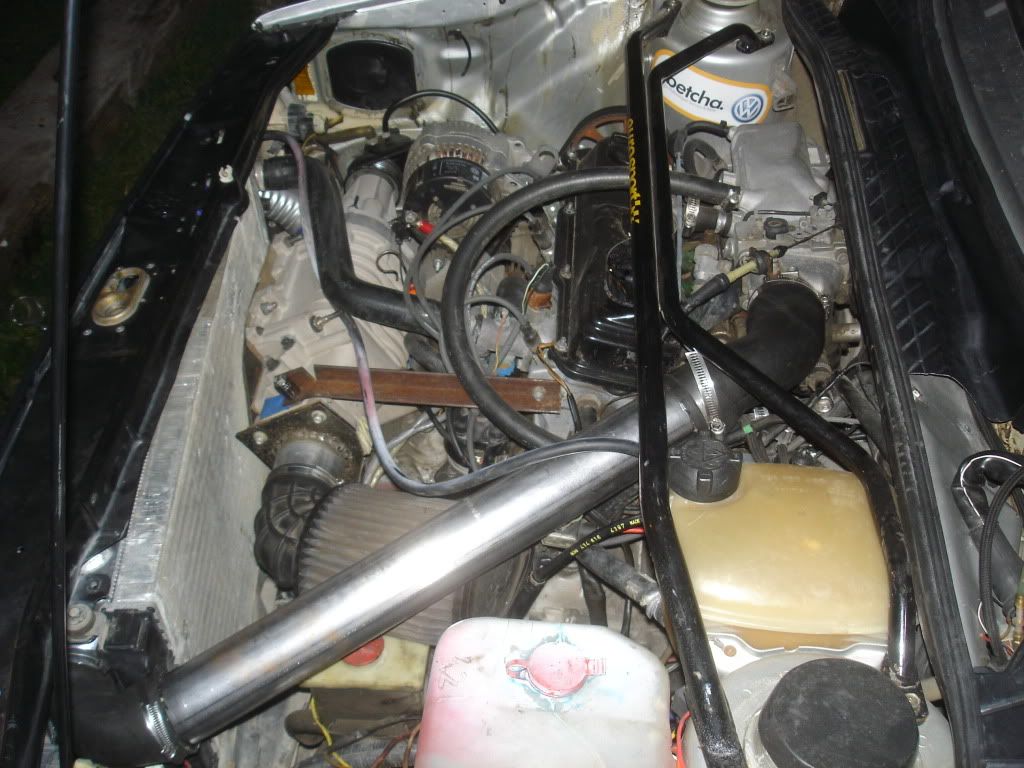

missing a socket?

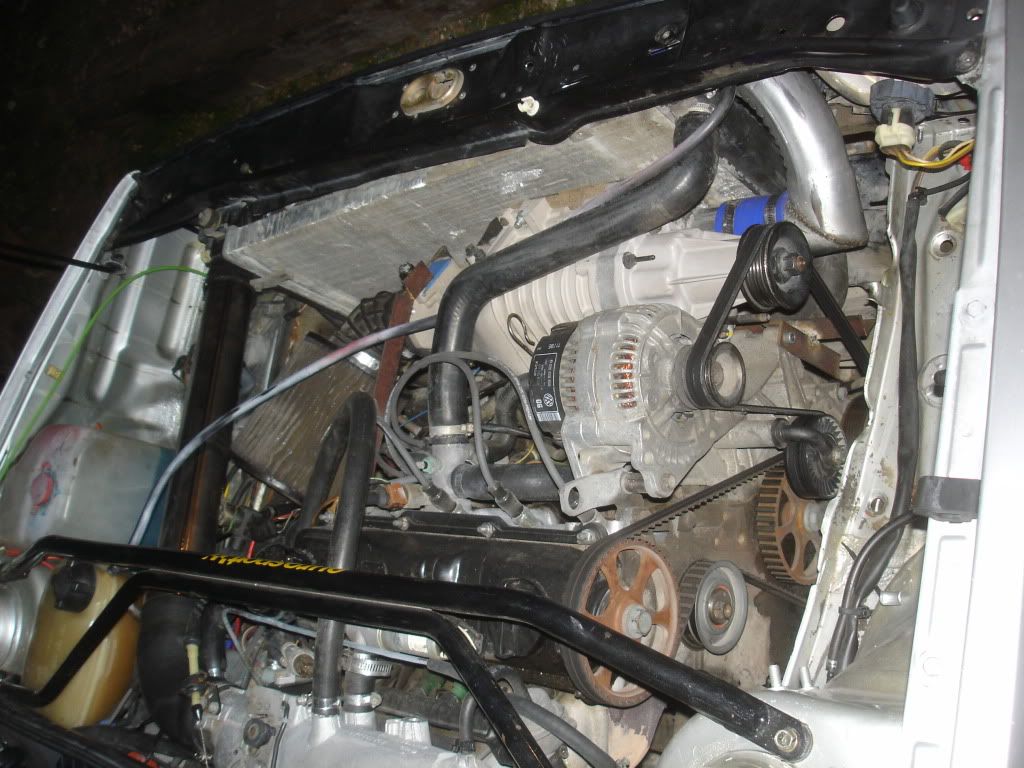

yes... actually 2
today i did a little tinkering and got it to run way better.. now it no longer does it freeky super high idle when i start it up.. and it quit kicking and bucking... also got the air cleaner moved into the old battery tray, so its not sucking super heated air directly behind the radiator
