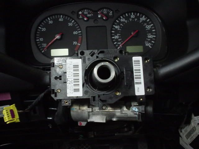

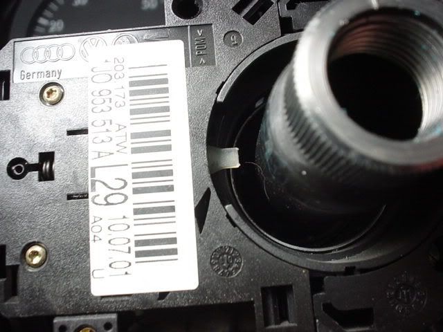

This is the column with the steering wheel and column shrounds removed.

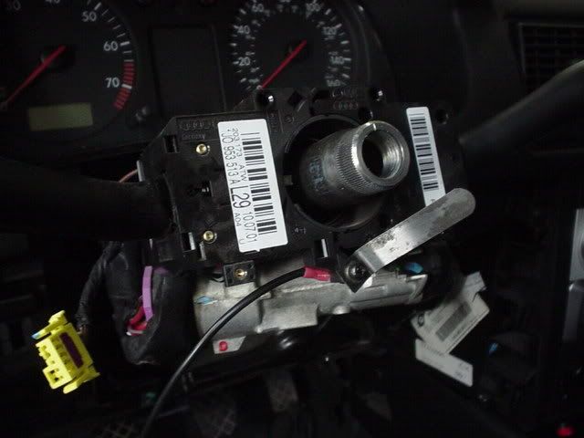

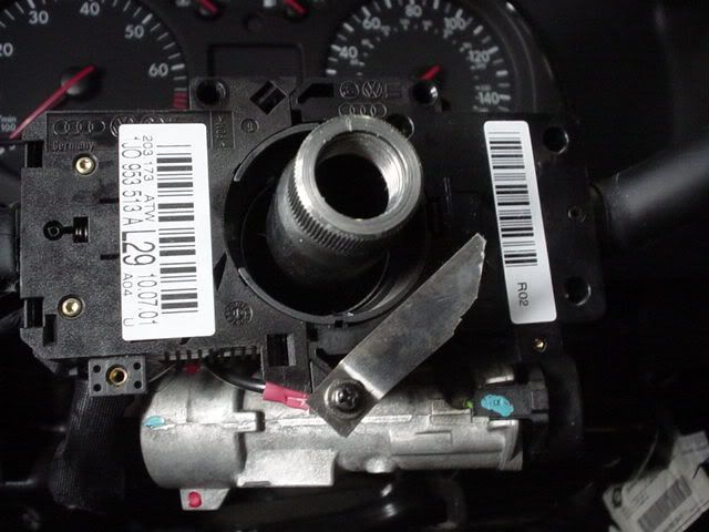

When the turn signals are activated, this small tab sticks out toward the steering wheel.

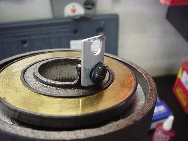

There is a tab on the factory wheel that will push it back into place and thus, shut off the signal. The MOMO hub adapter does not do this, so it must be modified. I drilled and tapped (M4 x .7)the tab sticking out of the hub adapter and extended it. It must not only be extended out, but you must also bend it slightly towards the signal tab. I loc-tited the bolt to make sure that it doesn't go anywhere. The bolt must not stick out farther than the other side of the tab, or the hub will not slide onto the steering colum. I would suggest using one that is about 1-2mm too long and grinding it flush with a dremel tool. That is what I did. This will now cause the wheel to cancel the turn signal like the original wheel.

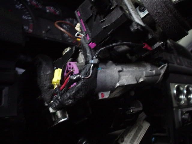

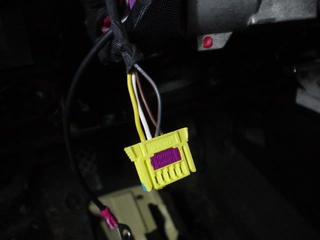

The second problem is that the MOMO/Sparco setup's horn does not work the same way. You must create some way to connect the wiring from the steering wheel to the horn honk wire. I used an old feeler guage and cut off one of the feelers to use as the contact between the column and the brass ring on the adapter hub. There is a small hole at the bottom of the column that I put a small bolt though with the feeler on the front and a ring terminal with a wire pigtail on the back.
The feeler needed to be trimmed somewhat so that it would contact the hub correctly. The feeler is pretty brittle, so it looks a bit choppy.

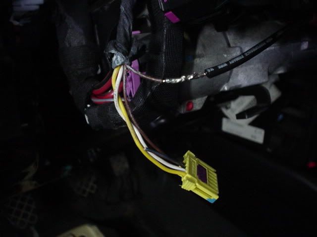

Onto the wiring, the pigtail must be connected to the Brown/blue wire in the airbag harness. When this wire is grounded, the horn will sound.
Pigtail soldered to the brown/blue wire.
Harness taped up and secured to the factory harness out of the way.

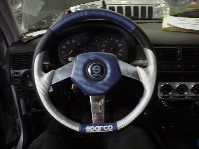

Wheel bolted to adapter hub with center and horn button installed. Steering wheel is done!

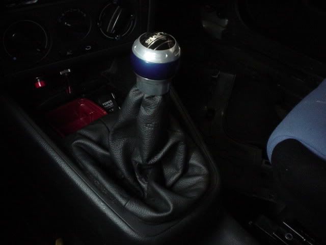

I also installed a Sparco Globe-X shift knob and MOMO leather shift boot.

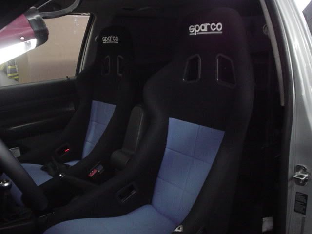

Sparco Speed seats complete the blue/black Sparco theme in the car. Blue Sparco 4 point harnesses are in the back of the car, I haven't gotten to the yet. Soon to come.
