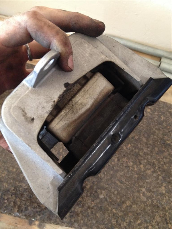

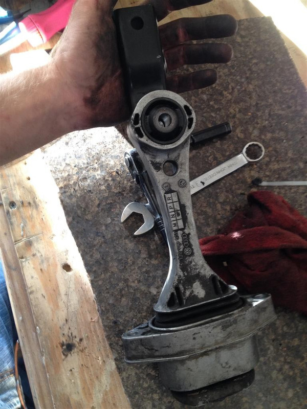

Recently I went digging for the random rattle. Checked the motor/transmission and dogbone/pendulem mount
Look good

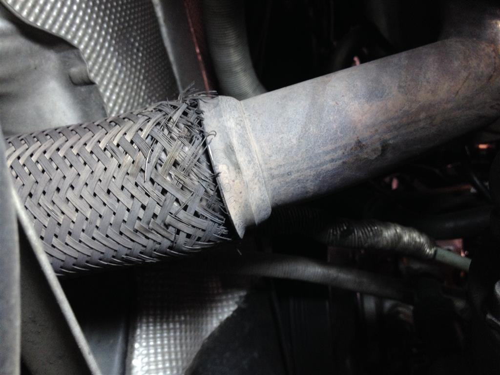

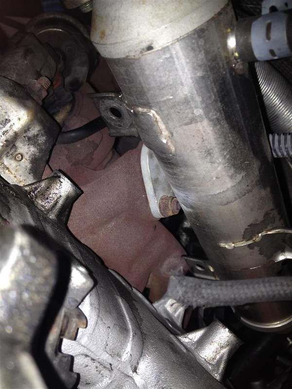

Found the flex coupling off the down pipe is wearing out and will need replacing at some point. Had a thought that this may be the rattle, but started the car and pushed the motor forward while running with a jack and rattle did not present. :\

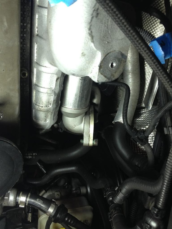

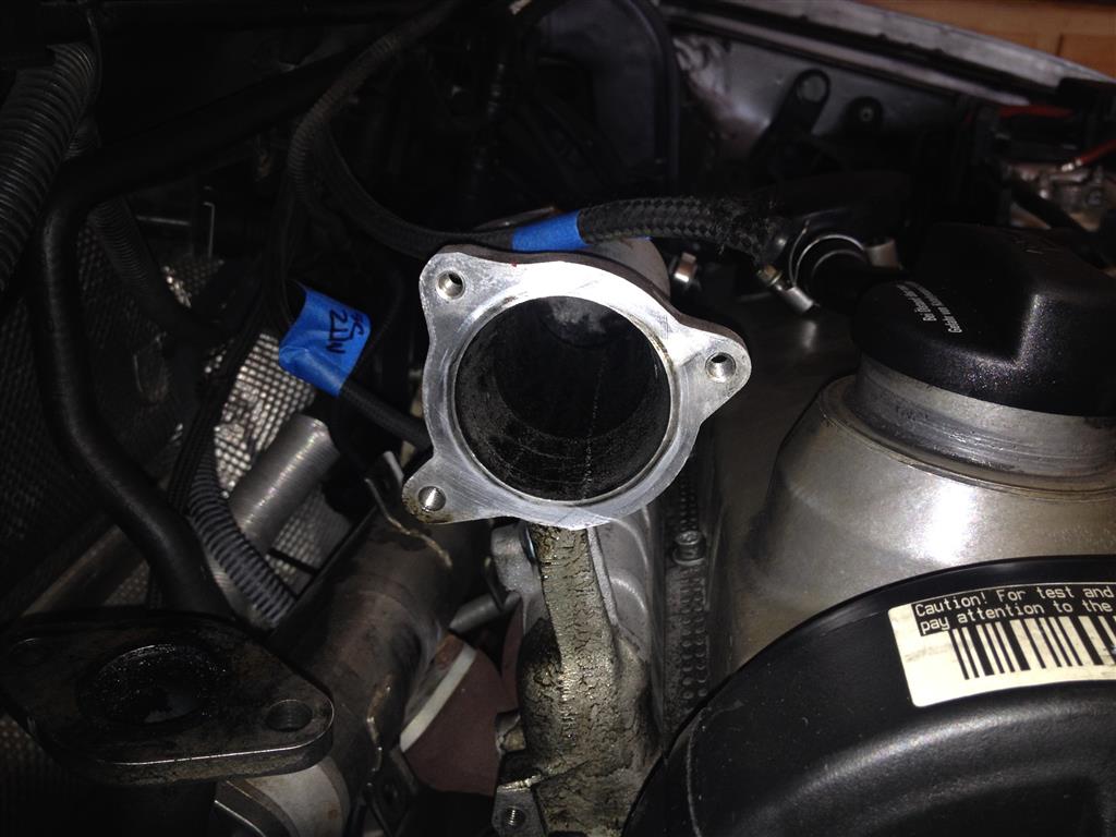

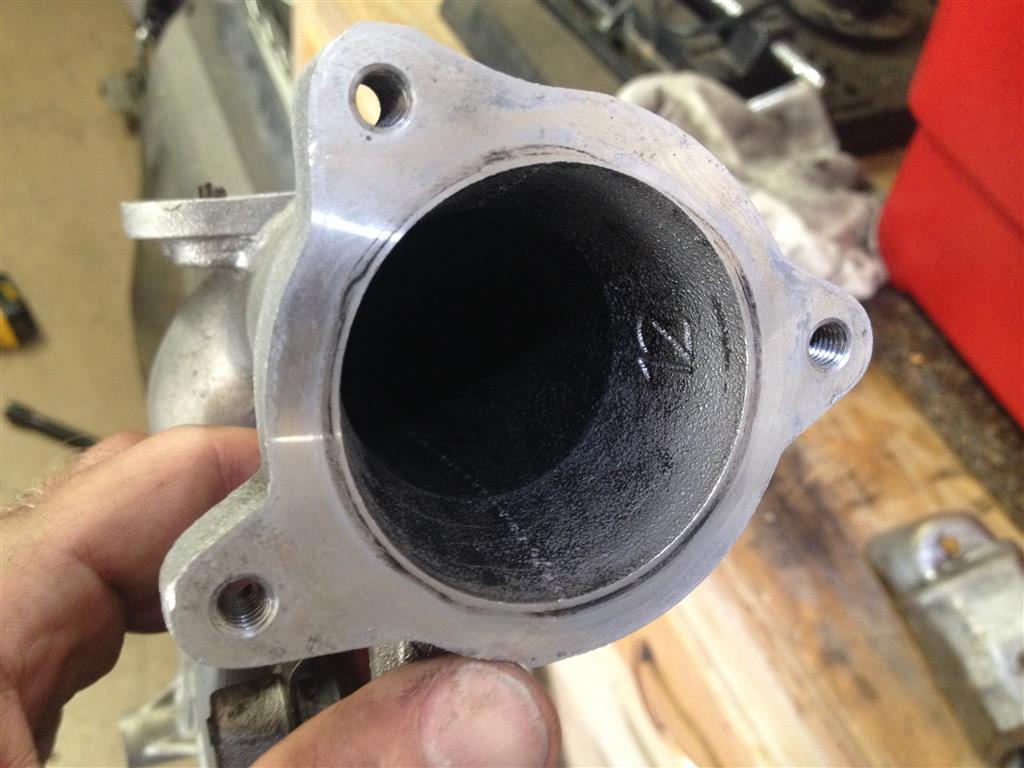

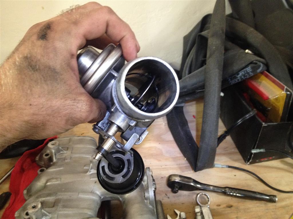

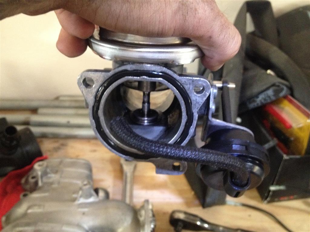

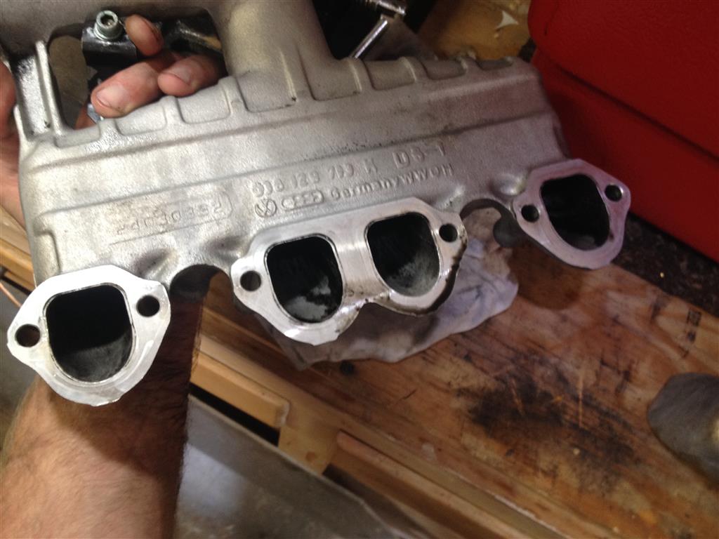

While I was waiting for those to show up, I thought I'd check the intake manifold since this is common to clog up with carbon from the EGR.
Oh, looky there what I found.
These are block offs for the EGR at the exhaust manifold and also at the entrance to the EGR cooler. Sweet!
Decided to continue anyways with the dissemble and it looked good, but I touched it up a tiny bit.

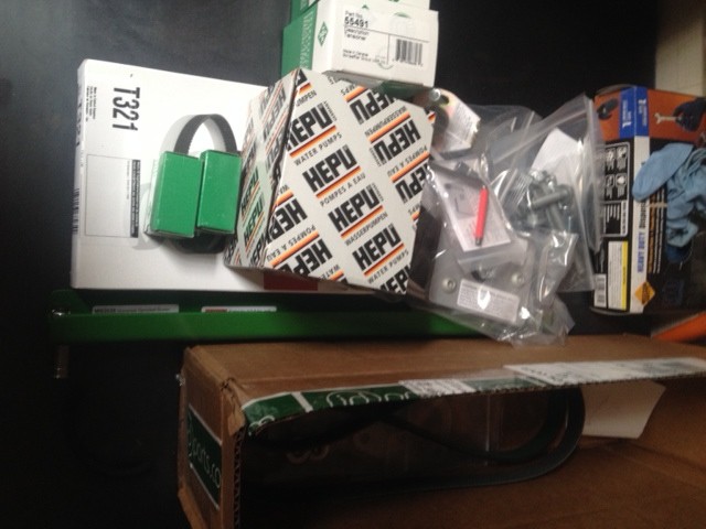

Since I don't know the history, I ordered the DieselGeek timing belt kit and the tools to do it. Just waiting to save some more $$$ so that I can get the software to tune it before doing the timing belt change. I suspect given that the car look well maintained that the TB has been done already, but for peace of mind :nod:

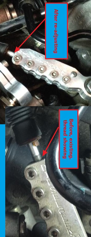

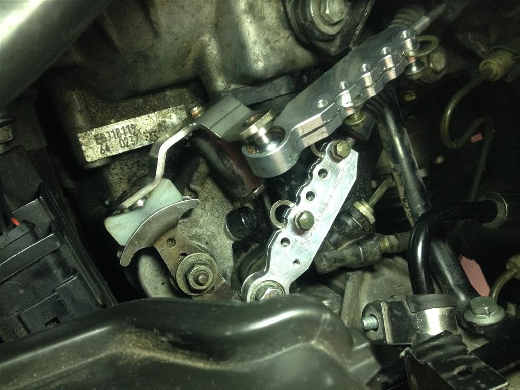

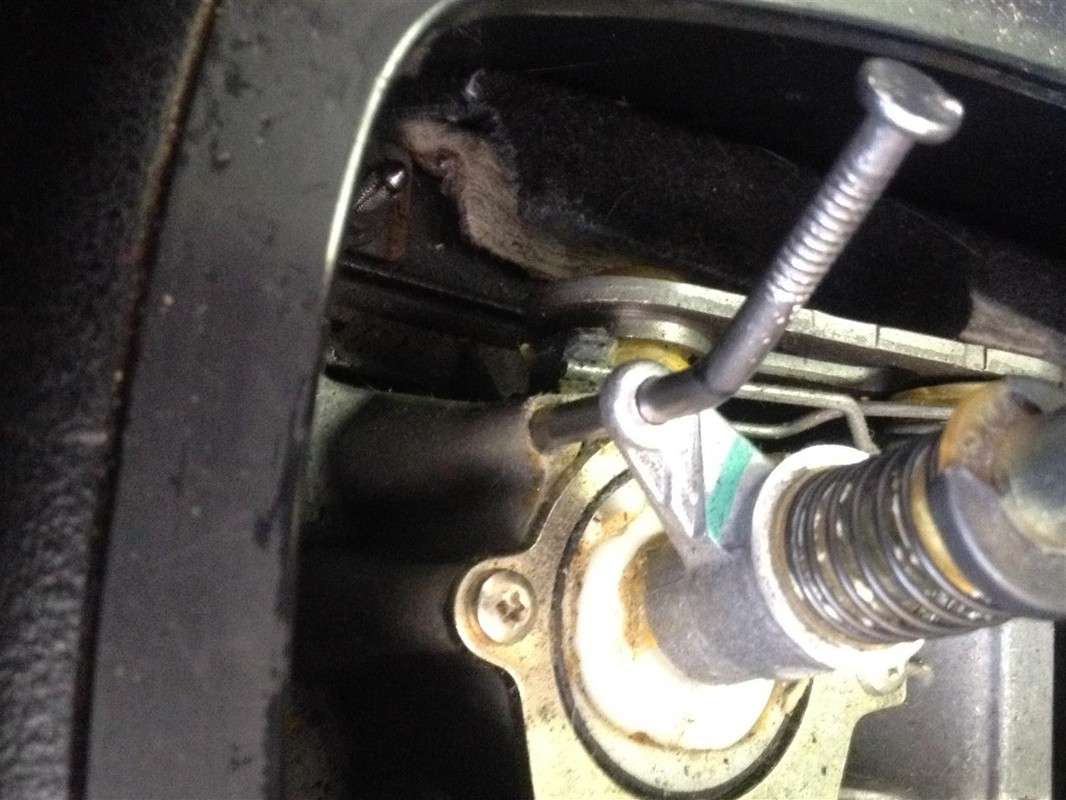

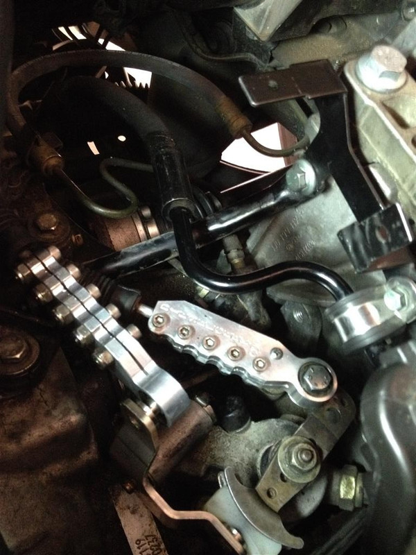

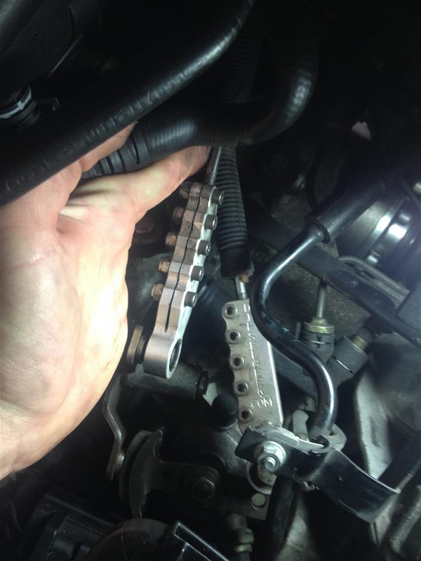

Because of the DG shortshift kit, my first item to check is that shift linkage is adjusted correctly.
DG has a good document on installing. Followed that plus pimped my older cable ends like the new ones come.
First, most important, is get setup with instructions and beverage. Its AM so coffee :thumbsup:

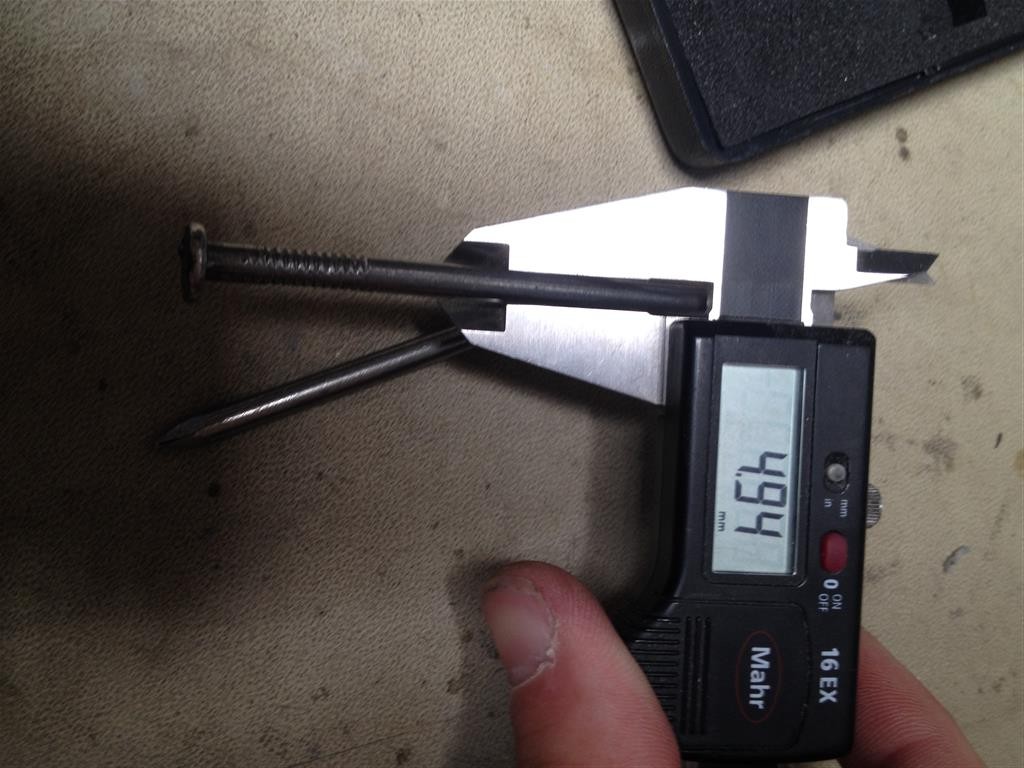

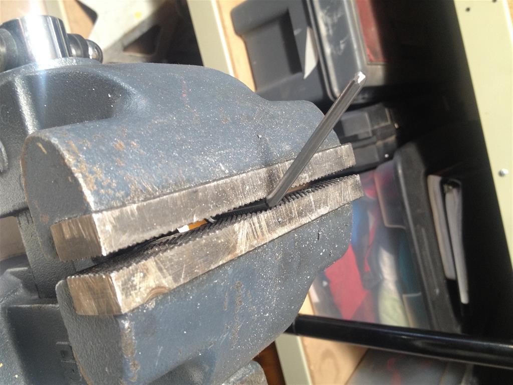

Make a shifter lockout tool. DG sells one, but also says that a 20 penny nail works. Sure enough, darn near 5mm.
Next, document how it looks currently, just in case I f it up and have to put it back like it was

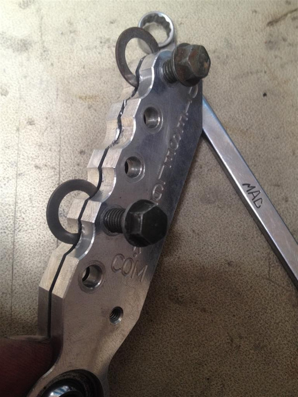

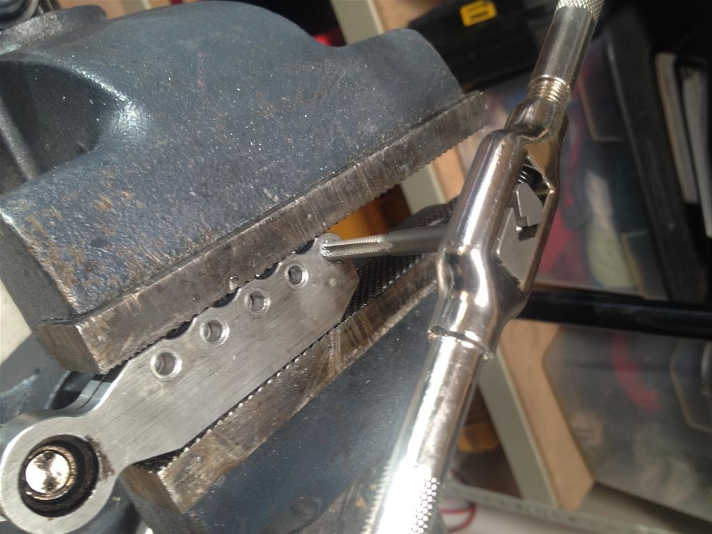

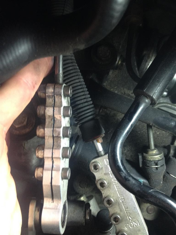

Then removed the billion, okay only 5 screws per cable end. I had some difficulty getting the cable ends off so I tapped two of the holes to accept a 6mm bolt to use as spreaders. The new kits come like this. Makes getting them on, and having them the critical "must freely slide" as per manual
Installed them and double, triple, quadruple checked that they slide free
Locked out the shifter with the sweet 5mm locking pin
Then tightened them down
Going through the adjustment like this, I did notice that one cable is seated further into the cable end. This makes sense, as now, the small phillips screw will thread all the way into the cable end. I think it was out of adjustment a small (1/8") amount.
Took it for a test drive. Shifts through the gears fine, I can't tell any difference honestly.
Still hard to go from 3rd to 2nd.

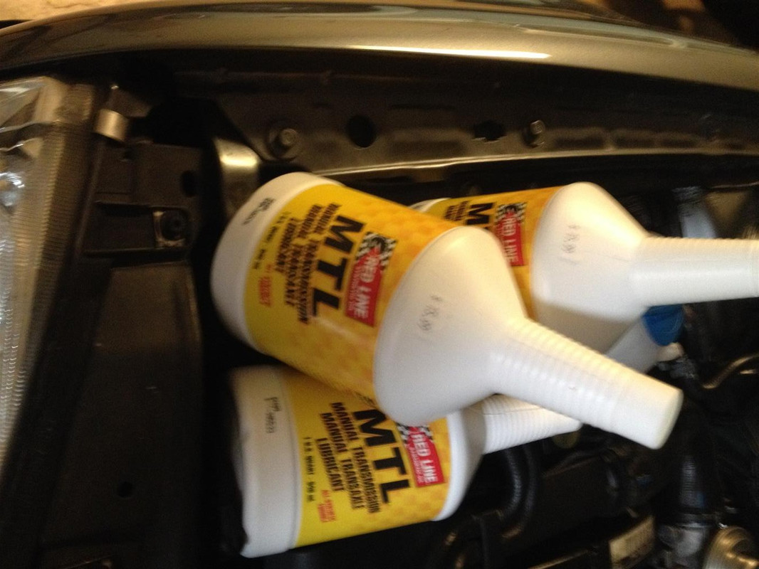

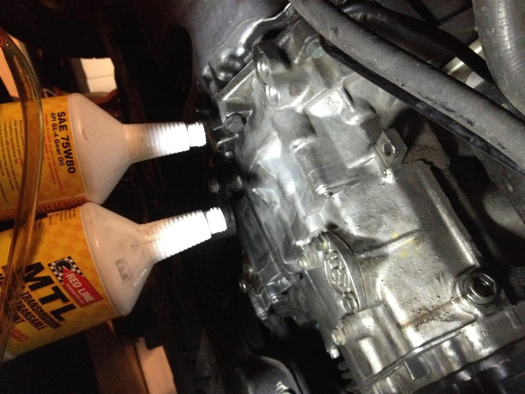

Time to change to a GL-4 oil. I've had very positive results using Redline before in my Toyota crawler & 325IX. More $$$ but worth it IMHO.
Need 2 L to complete this, so have to buy 3 Q :\ :\ :\

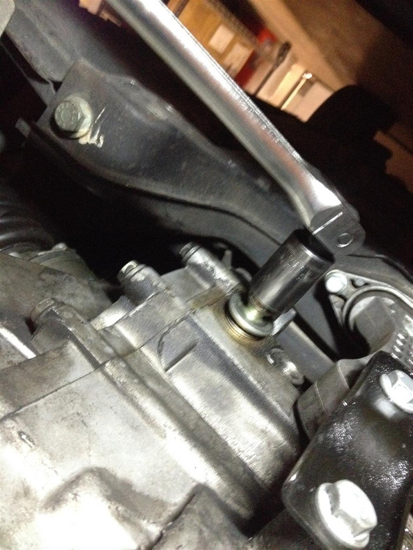

Got my super special tool for this. 17mm inside hex on the plugs.
First make sure I can loosen the fill plug (check) and remove prior to removing drain. Little pro tip there :finger:

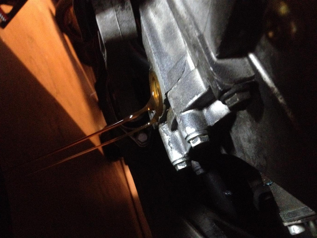

Next loosen the drain plug

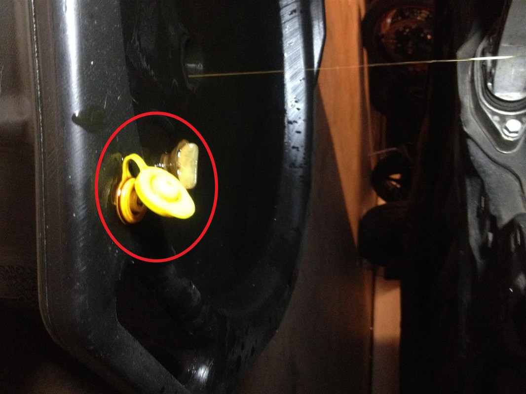

Get pan in place and big important pro tip, pop the vent on the drain pan. Don't ask how I know this :laughing:
Let oil drain. Go do something productive, or not and just update stuff on the internet :rolleyes:

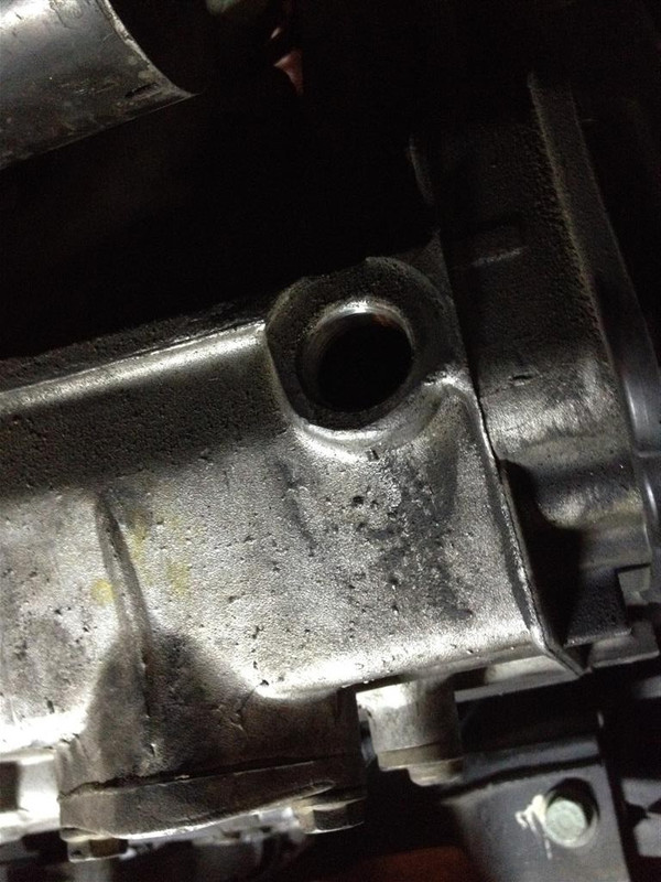

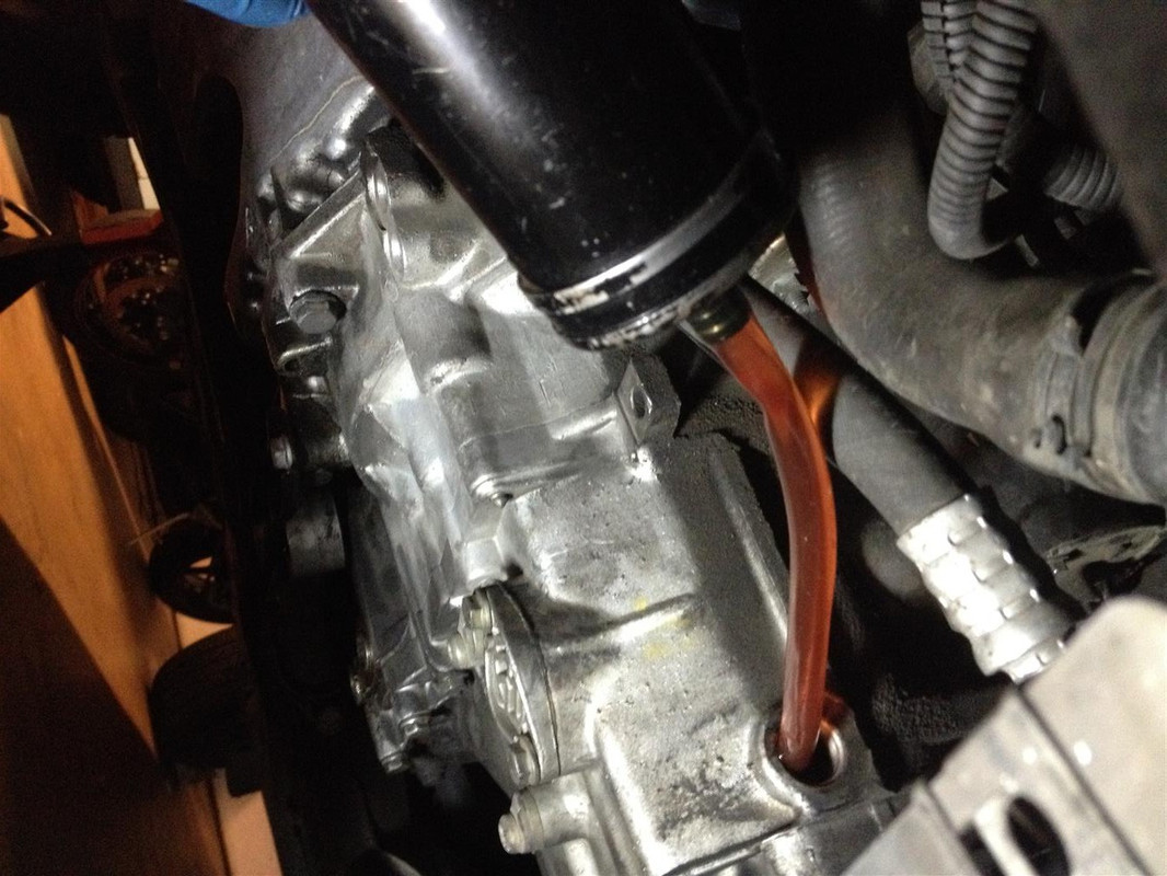

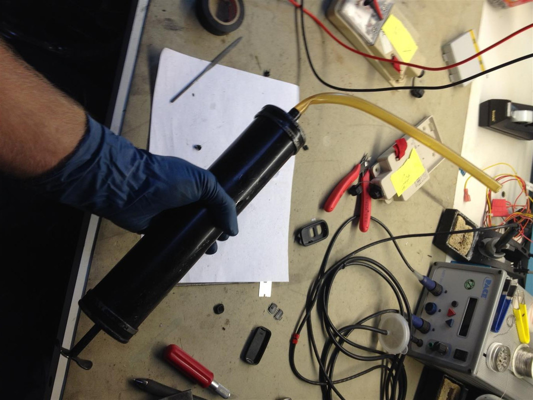

The best tool I've found so far for refilling diffs, transmissions, etc. Old errr, mature man called this a rosebud or rose gun? chime in if you know the official name, big giant syringe type deal.
Fill'er'up
Till it's dripping or running out

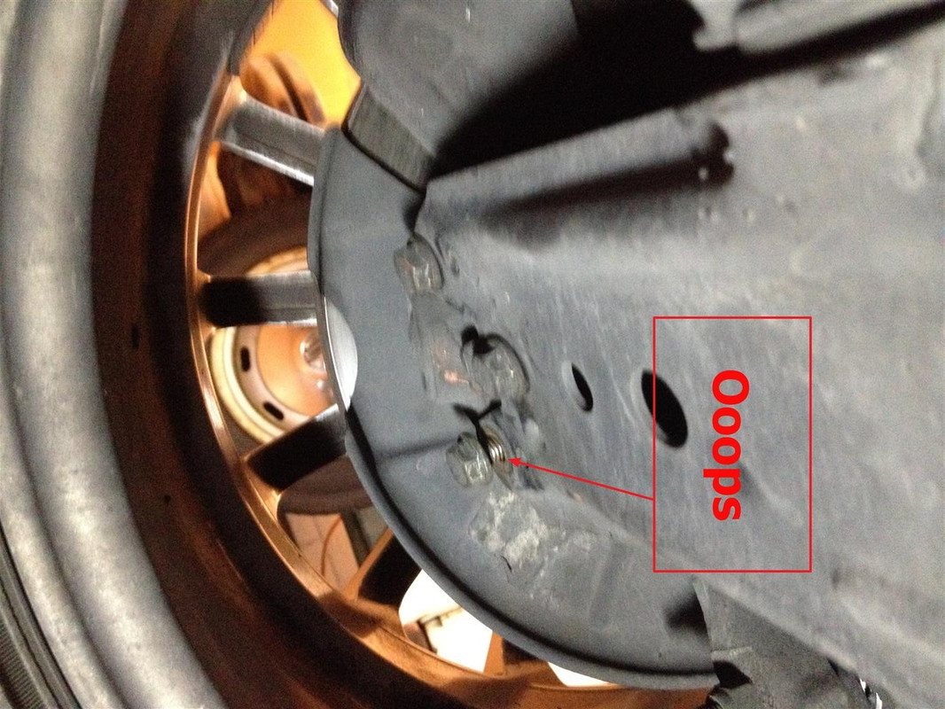

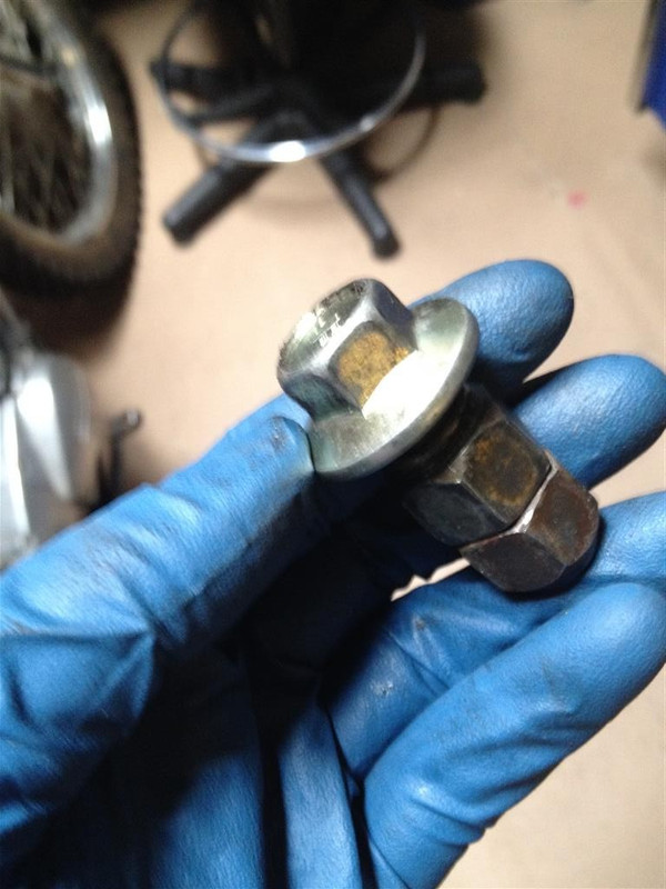

And while you're under there, go ahead and tighten those bolts that hold the wheel on. My dumb ass forgot to tighten those I guess when I was doing the CV axles

I love your 17mm 'Allen' socket!! Great idea

Scooby crank bolt to the rescue

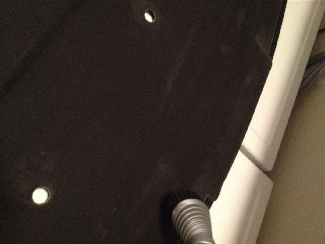

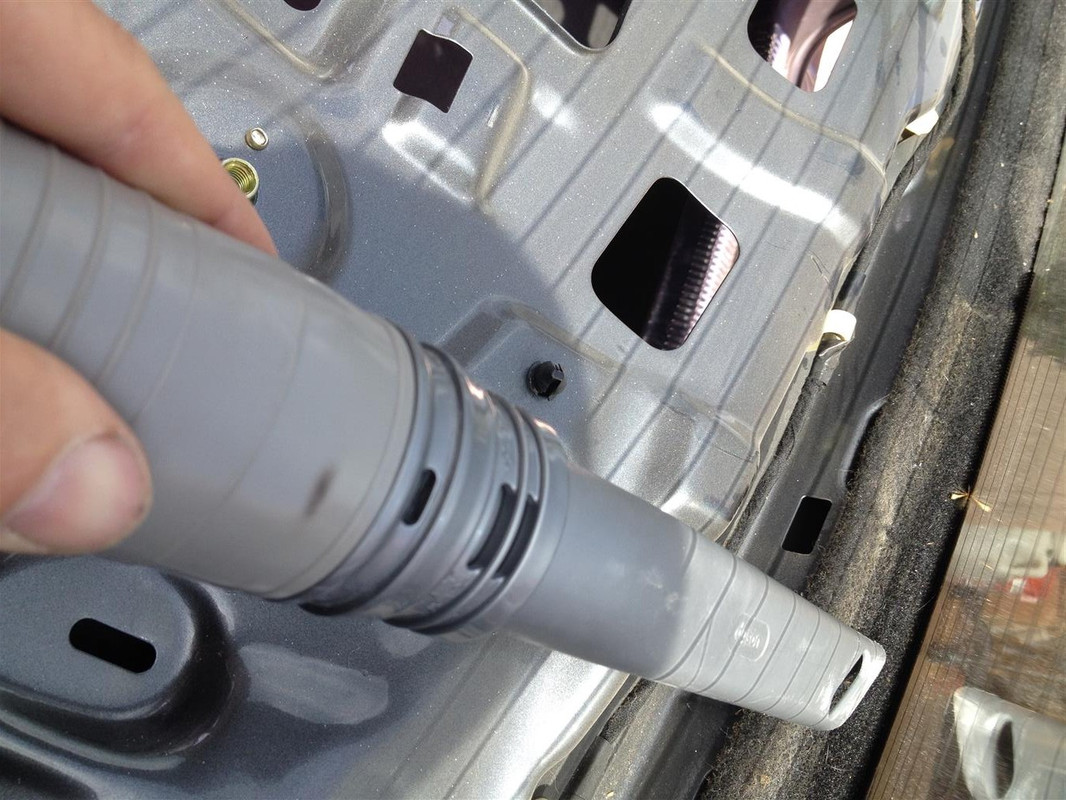

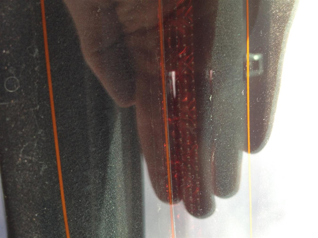

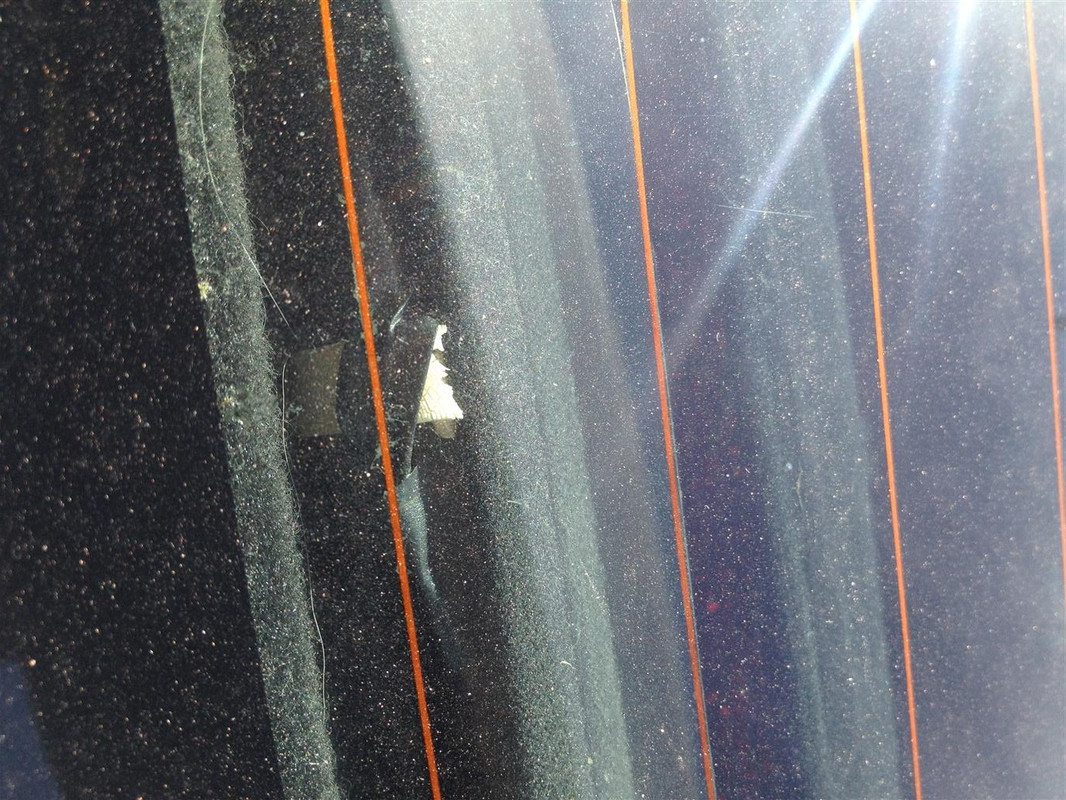

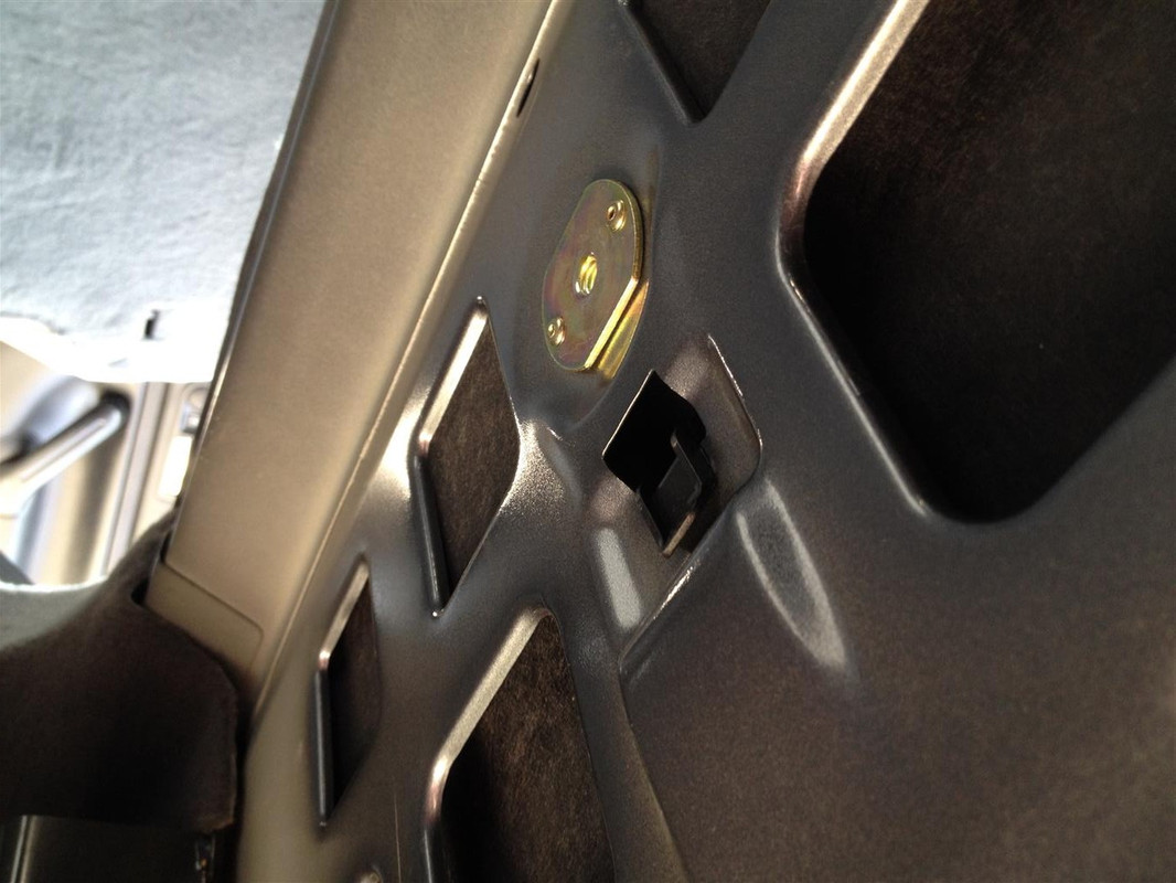

My third brake light was loose from the parcel tray. Like this the light was lifted up and kinda showing the wires underneath.
Hard to see since it's in the sun but...
folded the rear seats down lifted up, a few button clips holding the front down. Then slide forward.
Once out it was clear that the brake light was just not clipped into place in the tray. Nothing broke, so just clipped it back in.

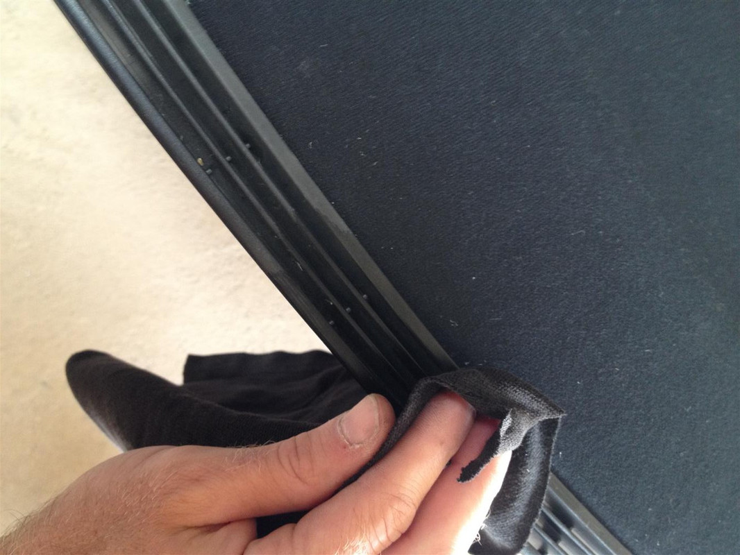

While I had the tray out, I vacuumed it off, vacuumed the carpet strip and applied some 301 to the grills.
Installing was pretty straight forward, just had to pay attention to make sure the j hook clip things on the underside of the parcel tray slid into the slots in the truck metal roof
fixed. meh. it's the little things though :cool:
