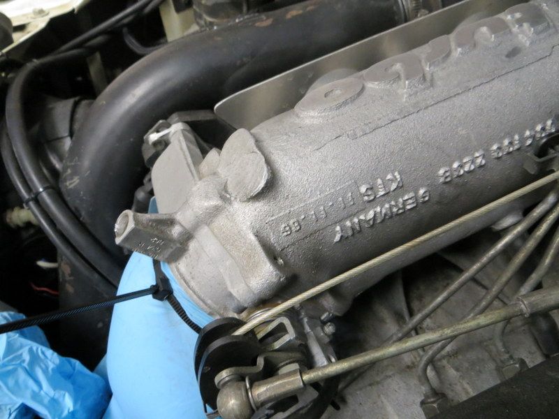

Post by uberaudi »
But do you have the same smoke machine? I tried it out today and it worked great! I have a pretty good sized leak coming from my throttle shaft on both sides so it looks like it's time for a rebuild. It turns out smoke is hard to take a picture of but if you look real close, you can see it on the left side of the TB:
