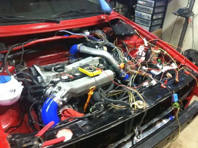

This part sucks. I'm getting frustrated. I have spark but no bang. Not sure a good way to test for injector fire minus pulling the intake off and looking for spray.
Re: 20VTMK2GLI
diode tester will show if injector is firing, how much fuel pressure? pump priming? I know your a guru too, just sayin
Re: 20VTMK2GLI
Wiring looks good. They click pretty loud when I trigger them via Vag-Com "Output Tests", but not while cranking. Triggering Fuel Pump manually. Getting RPM signal and spark still.
Re: 20VTMK2GLI
Well...... not exactly sure what the deal is. Manual-Trans ECU did not want to do squat earlier, so I had been messing with the Auto ECU. Plugged in the Manual and started fondling wires when she started making TB noises. Keyed the fuel pump and there ya go.

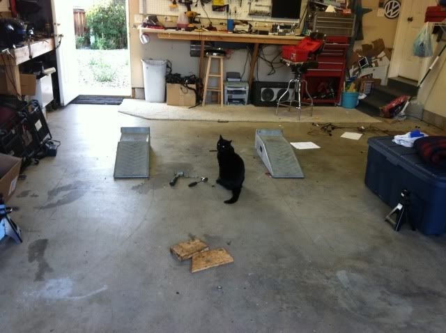

CatButt is confused. "Wheres the GLI?"
