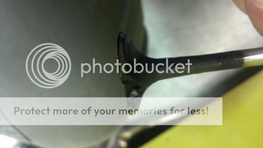

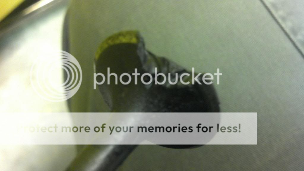

Could have been much worse, though pulling the head on that motor is far from an easy project. Looks like you should be able to reseat a new valve and you'll be good. All the new seals are a bit spendy though.

the way the carbon is missing from the valves looks like you have some nice detonation going on.
Re: Jonathons B5 project
you on the ball ramrod lol. an yes seals arnt cheap. but thats what has to be done. i think i am goin to order a kit. since thats the cheaper rought. but dont konw yet all i realy need is a exhaust manaflod, head,and exhast head to exhast piping gaskets. valve cover gasket is easyly reuseable. the valve is pretty cheap for the most part. i did find a whole assembled head of a A6 with a 2.8l here in GF but i dont konw if they will match up... pondering time....

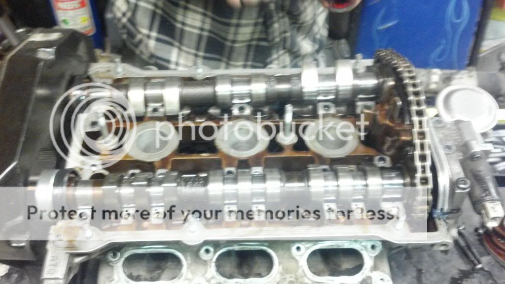

some parts are in so back to some work. still have a bit to go tho
well the fun begins lol

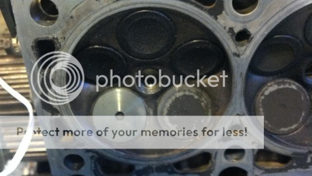

well the problem is out. the blac that is on the valve where the brake is is from driving it around or going though diag procces before i took off the head.
an the new one is in an seated

So what did that do to the cylinder wall?
nothing the cylinder wall is just fine. not even the top of the pistion got touched. thankfully

ill get a pic for you more close up on the cylinder
yeah things dont rattle when they are molten....
