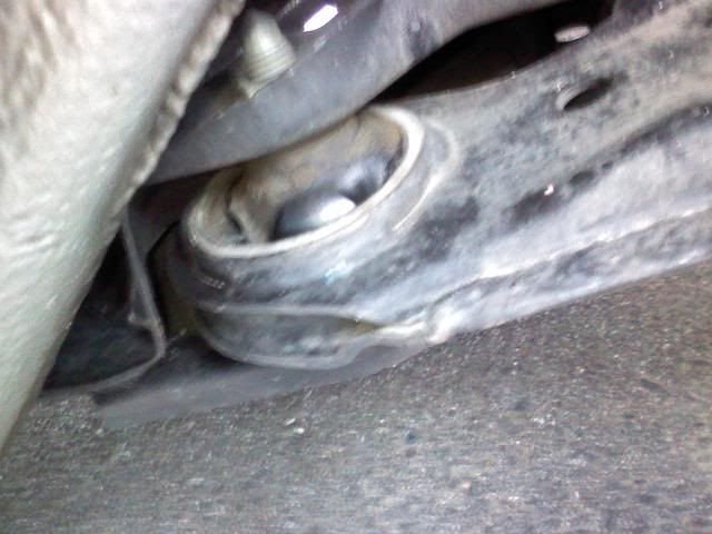

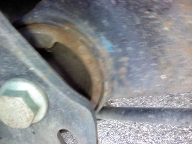

I changed my wheels for winter - while i did that, i saw these two things that look ripped..
Lower control arm bushing??
front and rear?
any other bushings i should replace while im in there??
Should i maybe just get this kit if its needed??
http://www.mjmautohaus.com/catalog/prod ... ts_id=2935
front and rear?
Re: Low BoOst - Black Smoke under full throttle
the rear ones are fine, the front lower control arm ones are REALLY REALLY BAD. Replace them asap.
and yeah, that kit is good.
