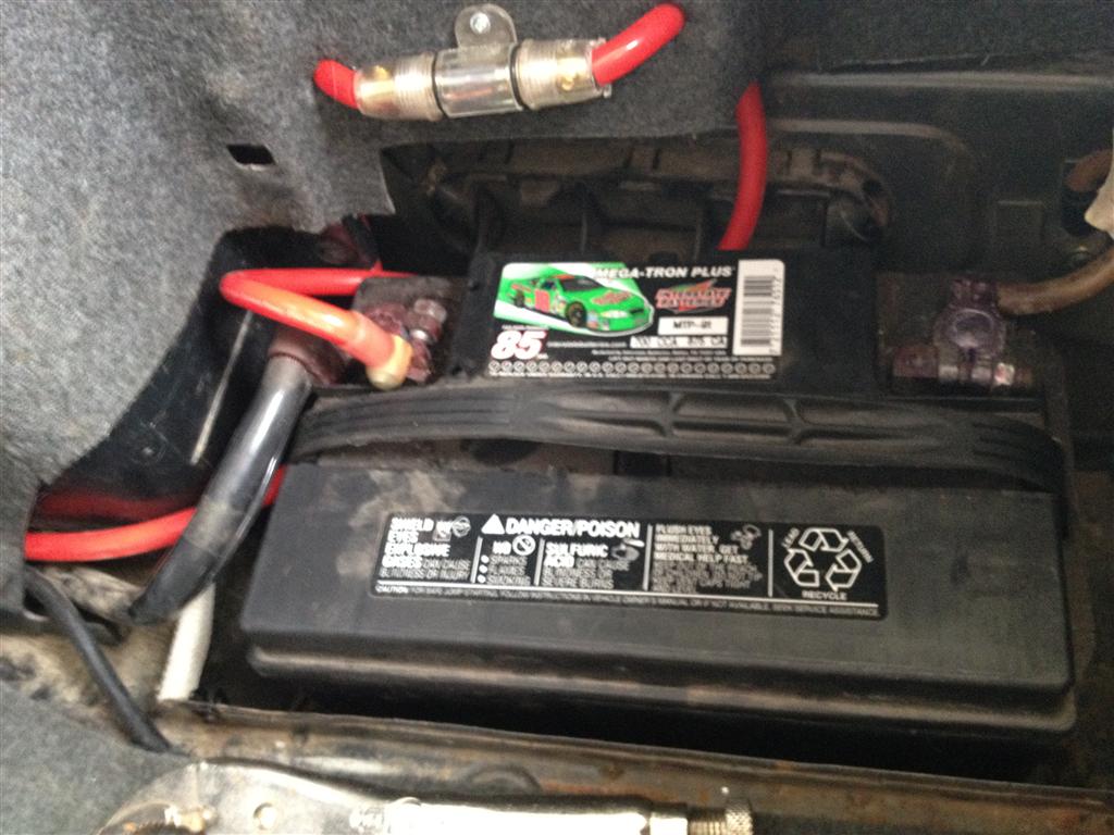

Hooked up the amp.

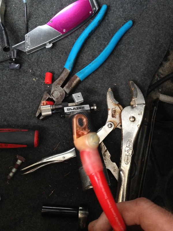

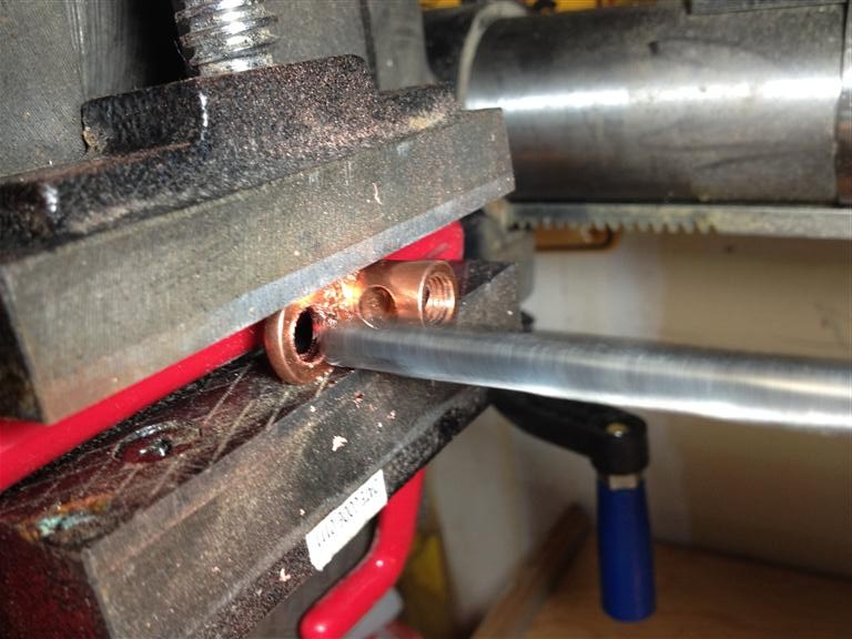

Found these terminals at home depot. They're not uber cool audio deals, but those uber cool audio terminals would mean I have to cut my primary wire which I'm not keen on. Anyways, these were cheap.
I did have to enlarge the hole just a scoche.
Put some heat shrink on it just cause
Hooked er up

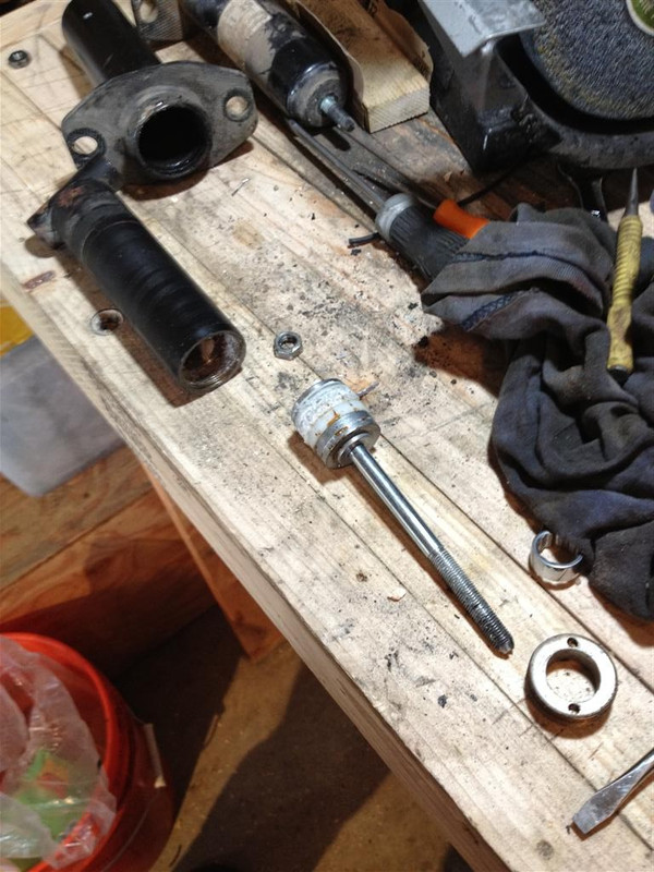

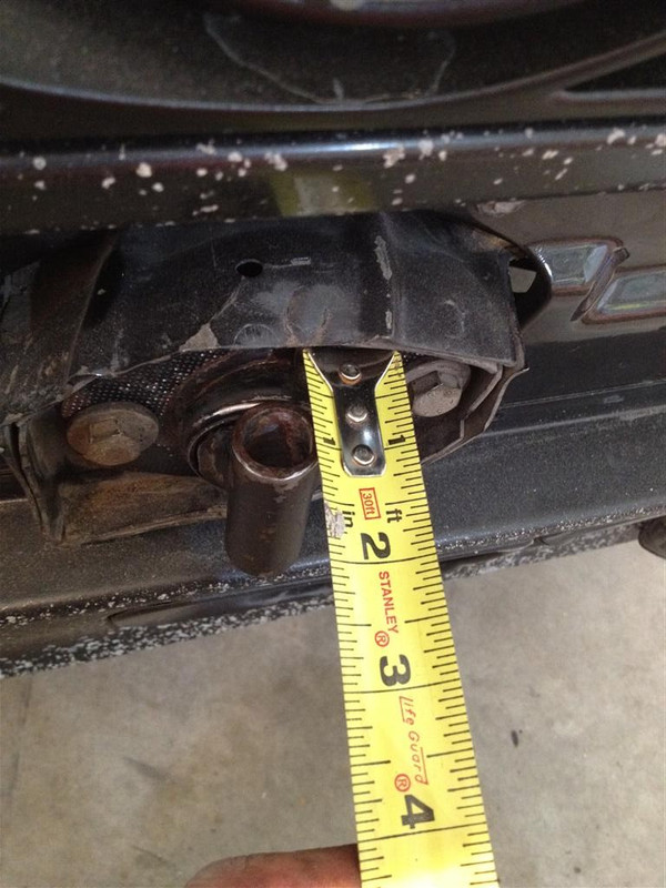

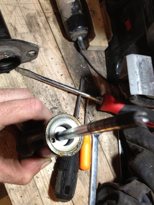

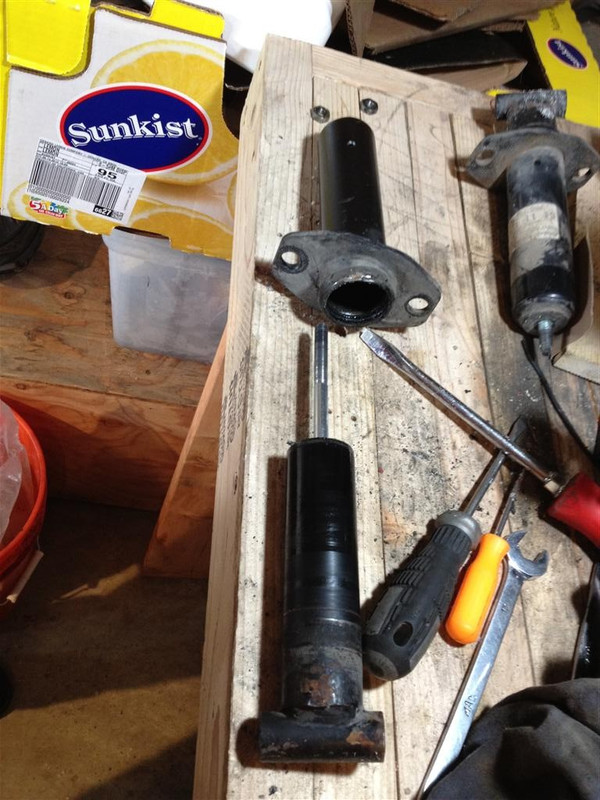

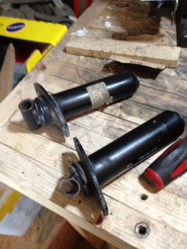

Worked on the bumper tuck. This is a common modification for those who don't have plastic bumpers. Basically you modify the bumper shocks to tuck the bumper more in resulting in less of a diving board look.
Before

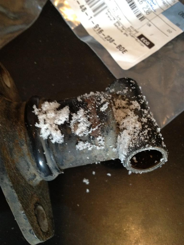

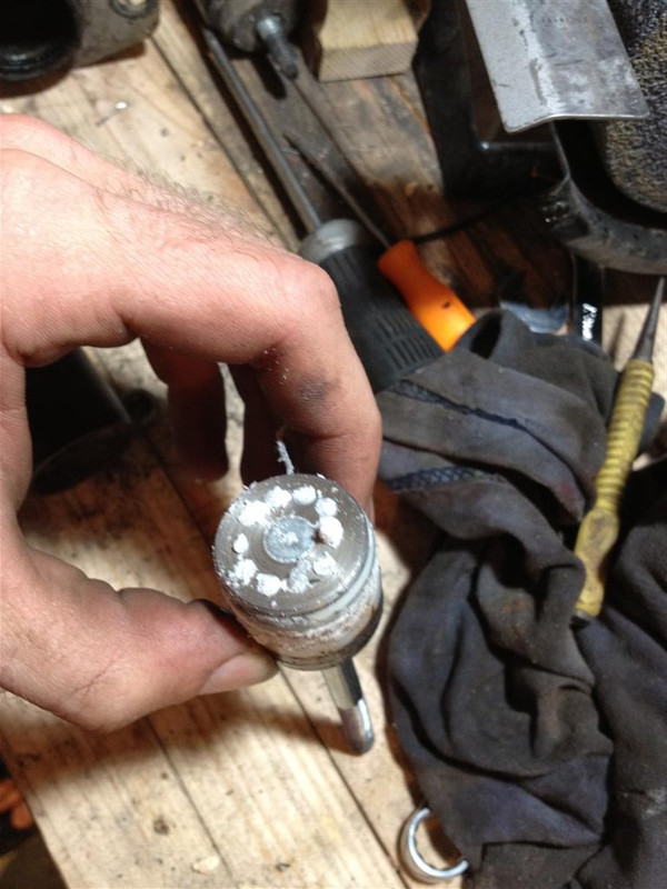

Drilled a small hole to release pressure. There's various reports of internal stuff. I lucked out and got the non-biohazard melt your skin off stuff.

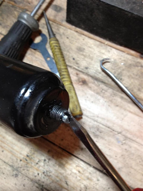

Once the pressure was off, I put a slot in the end of the threaded shaft and turned it out of the housing.
This allows the shock part to be removed from the housing

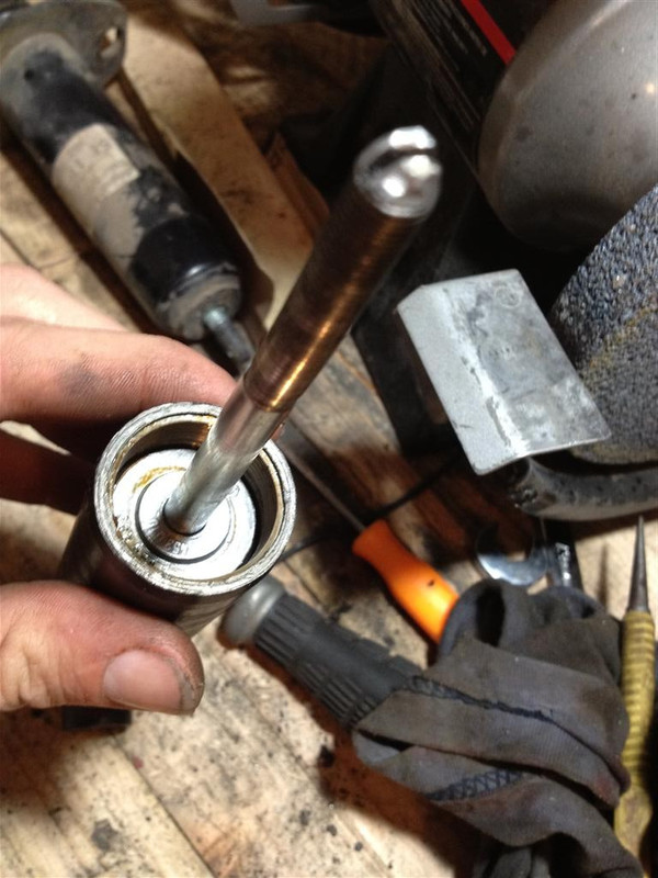

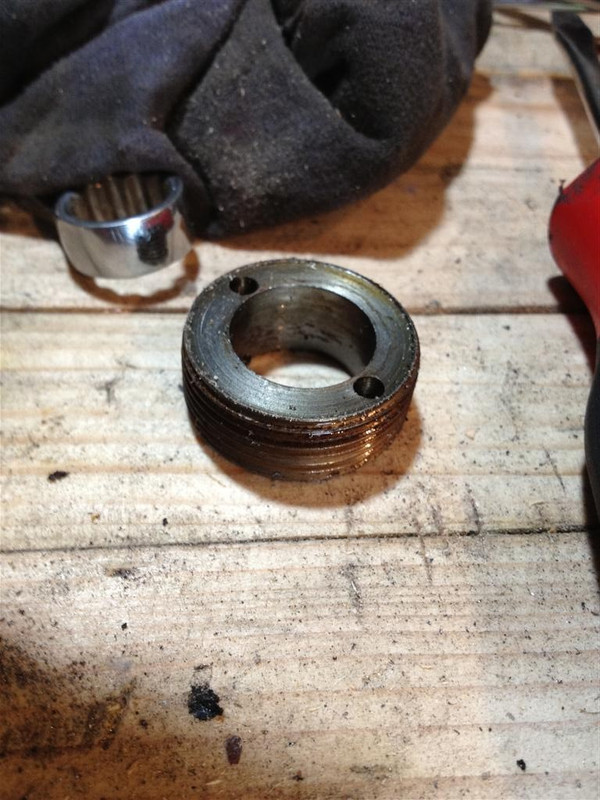

There's a retaining nut, typical shock type deal here
Removed it

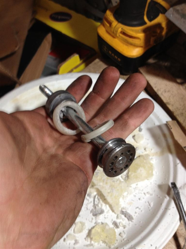

With that off I could pull the piston out
Piston

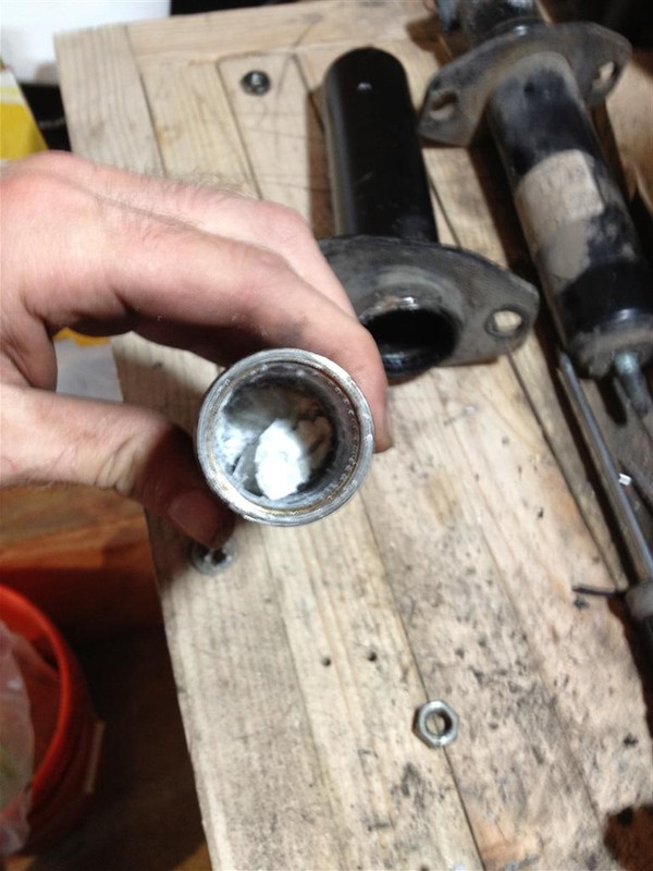

Looking into the tube

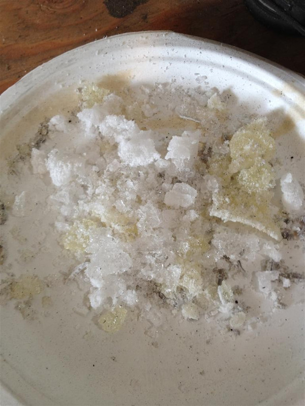

Cleaned the piston and scraped out the stuff (seems like dry silicon)
Reassembled and ready for install

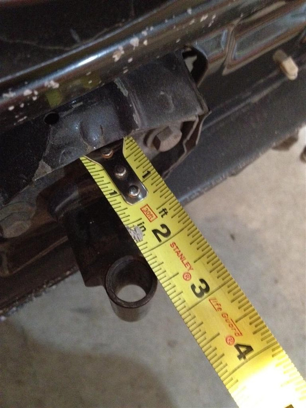

And the difference in extension

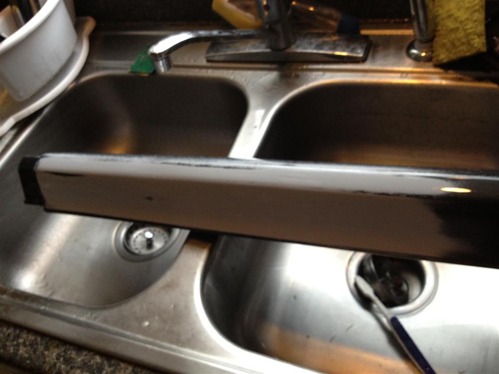

I got the time to spray the skirt.
After the spray I wet sanded with 1000. It's not perfect, the paint doesn't match but it's close enough. (at this point I already know the whole car needs a repaint)

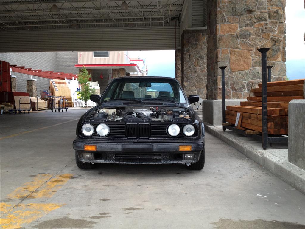

And a random shot at lowes (yes it goes voom now)

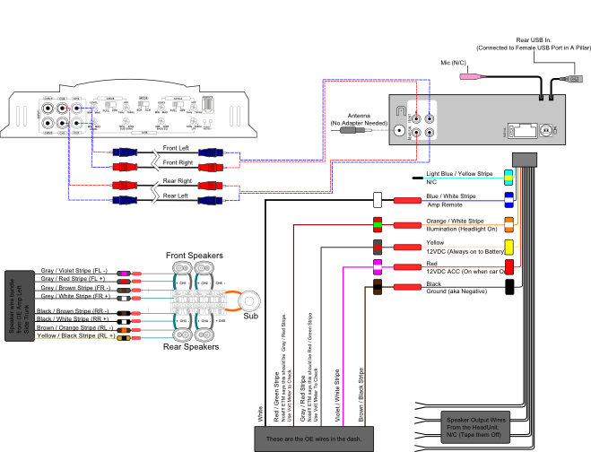

When I first connected the radio a couple weeks ago, I noticed that the radio would not power up unless I turned on my headlights and then it wouldn't remember it's memory. Also I had over an amp quiescent current draw. Soo.. I figured I'd first do the whole check for corrosion thing, so I cleaned all my taillight bulb sockets and the rotating plug thing with electrical contact cleaner and also my diode pack plugs and the 3rd brake light connections.
Still had too much draw so a buddy helped me monitor a meter while I pulled fuses. 21 was the ticket.
I pulled the radio and inspected the wires to make sure I'd wired it correctly. While I did, I remember reading one guy say his OE wires were not to spec with the ETM. Checked mine and sure enough, gray/red was NOT illumination, it was ignition hot and red/green was illumination (on when headlights) No idea why, but hey, I'm the retard who didn't check this when I was hooking it up in the first place.
I corrected this and it took care of my quiescent draw issue so now I'm mostly happy. I have no idea about tuning, so I think I'll take advantage of my phone call to Luke that comes with purchase of Lukebox and give him a buzz.
It does sound pretty good, but it seems to me I need to adjust the LPF ( so I get rid of some of the drone? and get it just to punch in for the beat portion of the music )
So, I worked up a little wire diagram of how I've hooked everything up. (Clicky it gets bigger)
