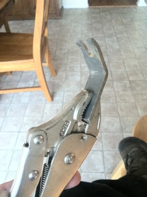

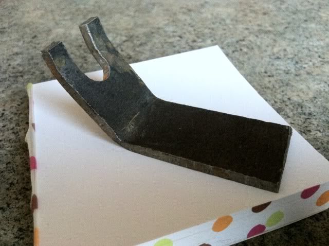

i always used a large flathead screwdriver against the valve cover for leverage, use your hand to make sure it pulls out straight careful with those injector cups, they are sure to be brittle maybe use a little silicone lube to soften the injector seals first, should come out easily.
Re: 1980 Caddy project - updated
This tool was born by saw, drill, vise, and hammer. A vise grip on the long end and you can pull em straight out. Made to get injectors out of valvers without taking the manifold off.

I love how spencer comes out of the woodwork (or is that Pinesdale?) with awesome shit like that! I also enjoy the OEM VW part number.
