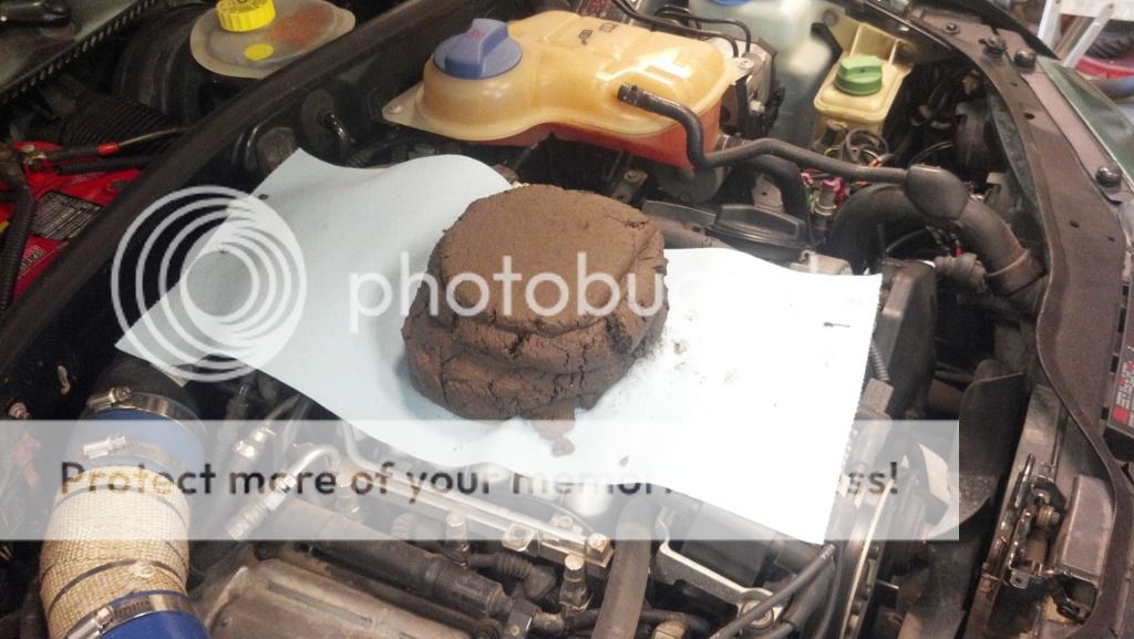

good way to measure clearance with the hood i have to day lol
get things set in an how deep we want to put them in

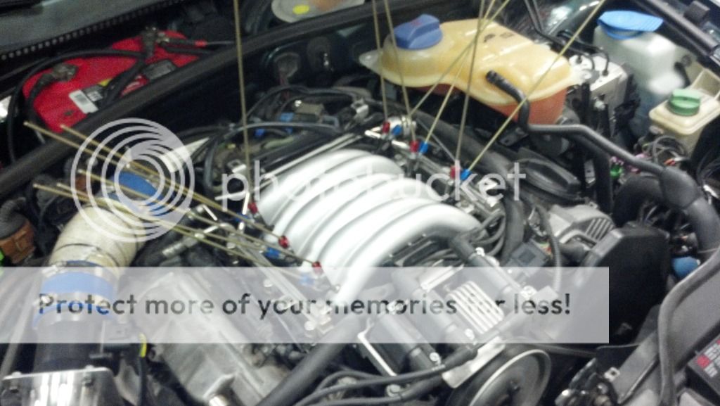

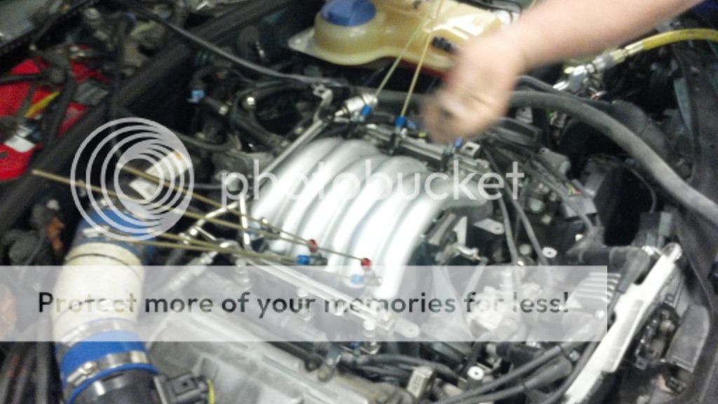

kinda remeinds me of chuckys hair due.....

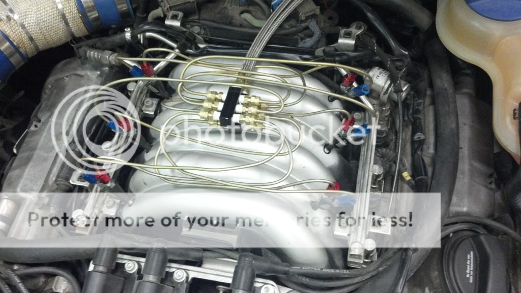

all set in. going to message them out. an make it look neater.

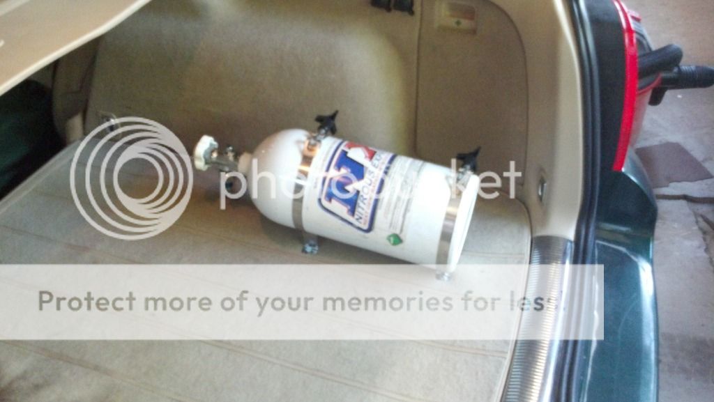

later in the time we did one test with the bottle on at ideal to see how the motor restponded an it seem to like it so far!
baby bottle mounted lol :laughing: :laughing: :laughing:

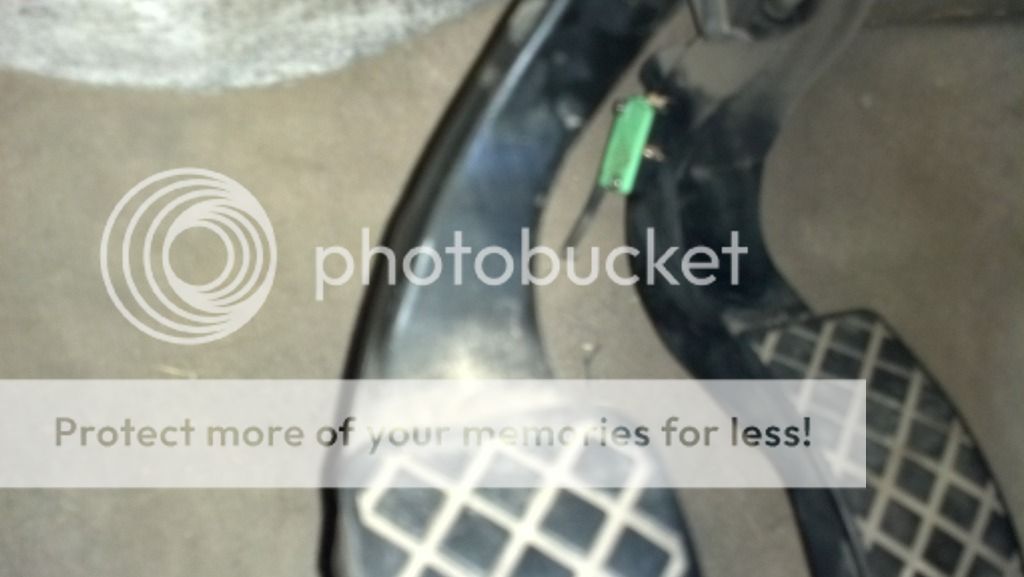

activation switch no buttons on the steering wheel hell no stelth better. an its not a honda hahahaha :laughing:

you're going to blow it up.
What are you using for engine management?
Re: Jonathons B5 project
im running a pretty low shot in it so nothing needs to change at the moment just a fuel pressure regualtor. but when or if i go up in the process i will crack the ECM an retard the timeing if need be. the pesron i have helping has been playing with nos. for 17 years now an realy knows what hes doing. so we shall see as long as i dont hit rev limitor nothing bad will happin. i will have it done for the billings euro show hahaha.
