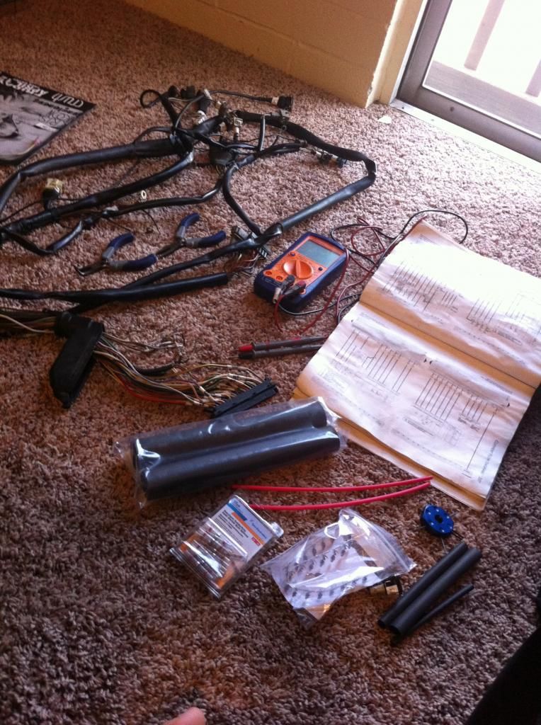

Factory or not looking at the diagram it appears to be necessary, only this time the wire are being terminated with a solder splice. I'm working on it right now

WEll installed the harness today… and nothings changed. Actually the car won't even run now, just starts for a second then dies
