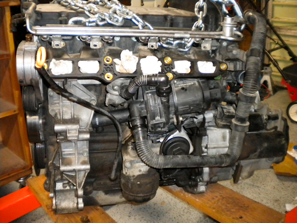

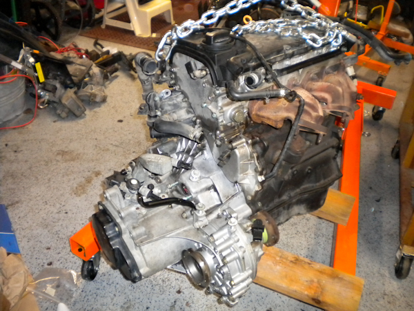

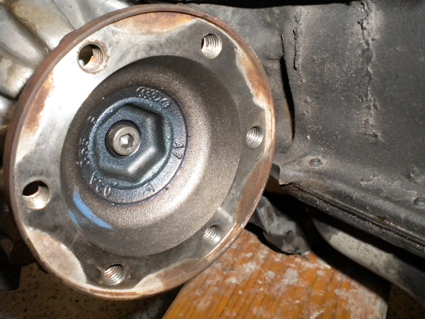

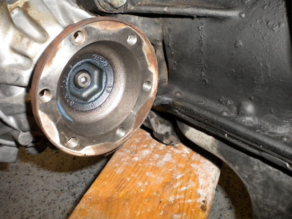

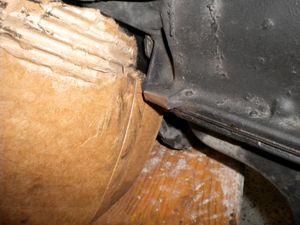

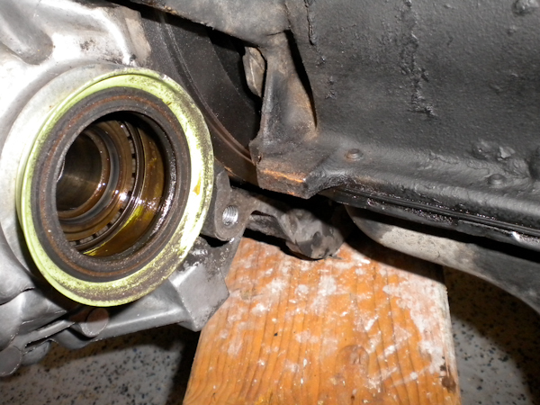

Mated the motor and transmission and found a small clearance issue with a tab on the block and the ouput CV flange:
Pulled the flange off and ground it down with a flap disk:
Ready to drop in:

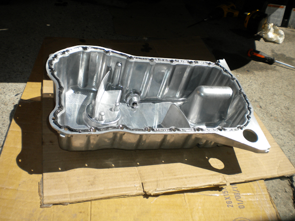

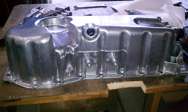

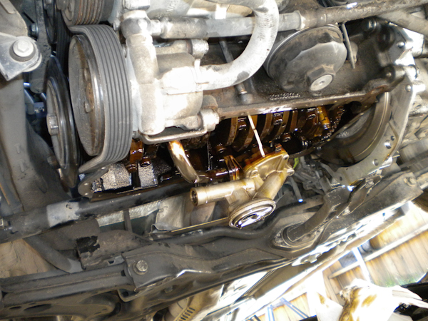

Now that it was back together, I needed to replace the MKIII oil pan with the MKIV oil pan. The main difference is that the MKIII is steel, and doesn't have any protection for the back of the flywheel. The MKIV is made of a zinc aluminum alloy and has full protection for the flywheel.
MKIII pan:
MKIV ready to bolt back up:
And an oil change with Mobil1 and I added the magnetic oil pan bolt for good measure.

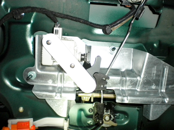

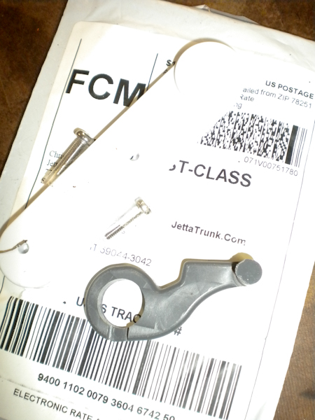

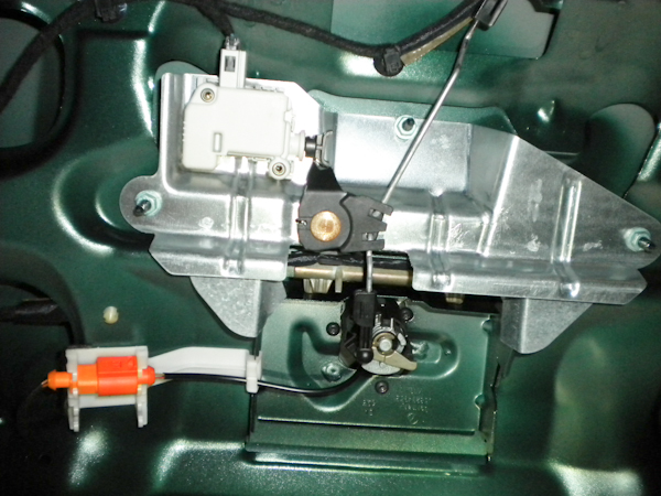

Also done was the Jetta trunk fix - the plastic arm on the latch lever breaks off over time and then you can't open the trunk anymore.
The fix is a $40 kit from some forward thinking guys who came up with a simple fix:
This CNC plastic part replaces the original latch arm, and is a permanent fix.

You should really go back to the steel pan. The aluminum ones like to crack with the slightest bump. Also, change that trans fluid.

Roadhog wrote:You should really go back to the steel pan. The aluminum ones like to crack with the slightest bump. Also, change that trans fluid.
Nice work though! You should come do my Corrado next. :D
Lol, yeah but without the wafer thin oil pans, I wouldn't have been able to buy this car so cheaply :p
I would run the steel pan, but I don't like the flywheel exposed, and I don't have a welder to fab up a plate. The steel would just bend, but the alloy pans are actually very stout...unless you plow over boulders and keep driving like the PO did. Also, being that my Audi is low, and my 2.0 was also fairly low and had no problems, this stock height daily should be ok.
