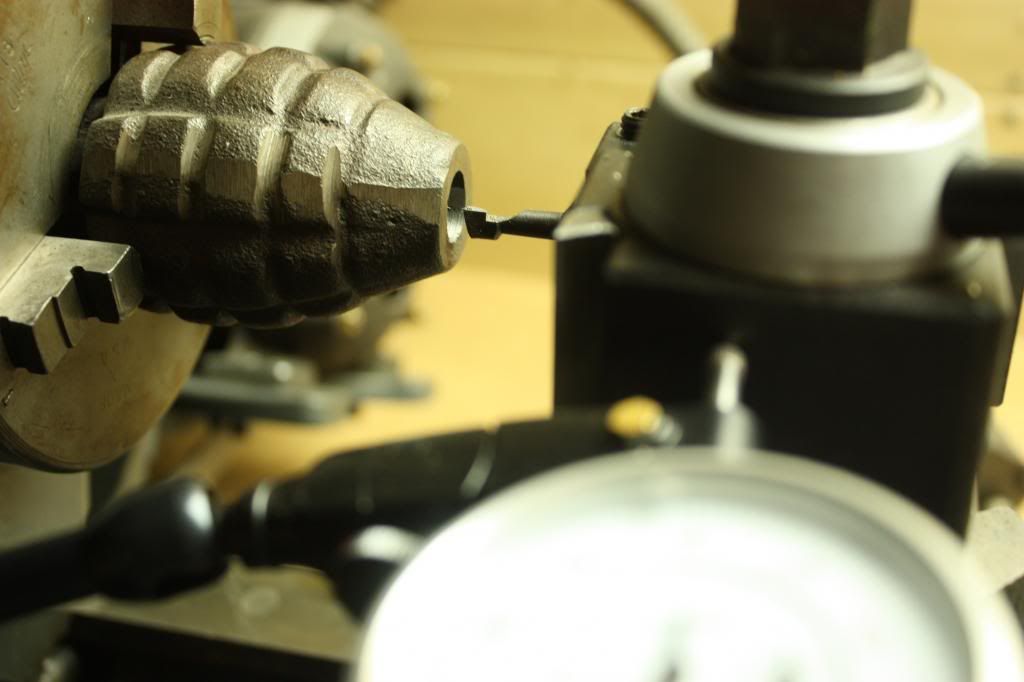

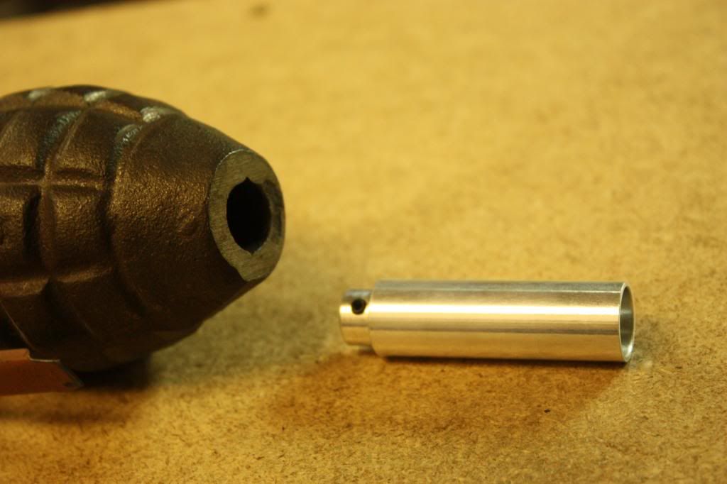

Well i got bored of computer work in the shop, so I decided to play for a min. Had a grenade and SPP tip mod laying on the desk...

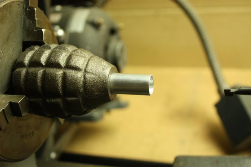

To the lathe. Bore to .600.
Fits.

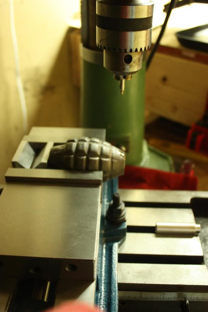

To the Mill/drill. Center drill and drill with #29 drill bit for 8-32 thread.

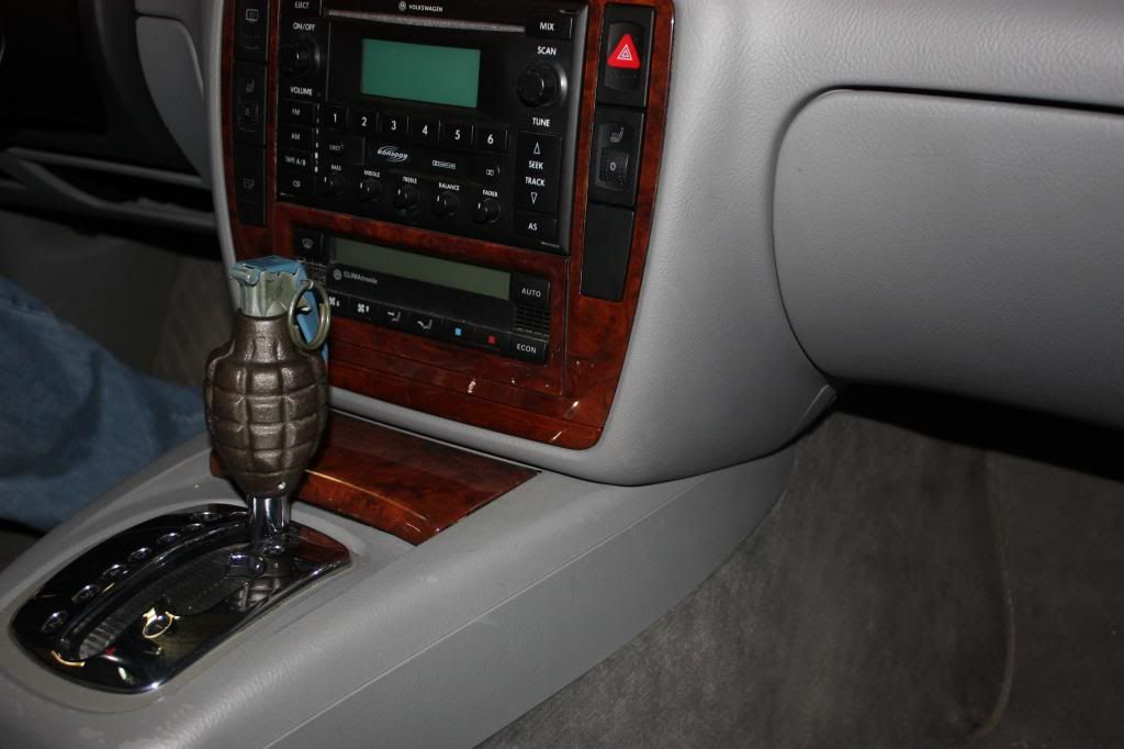

To the P-sat.
Anyone see the irony with a grenade shifter on tiptronic? Really I prob won't keep it that way, well maybe just so i can get a major wtf look from the wife when she tries to drive it..
