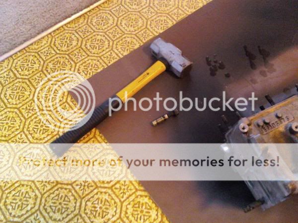

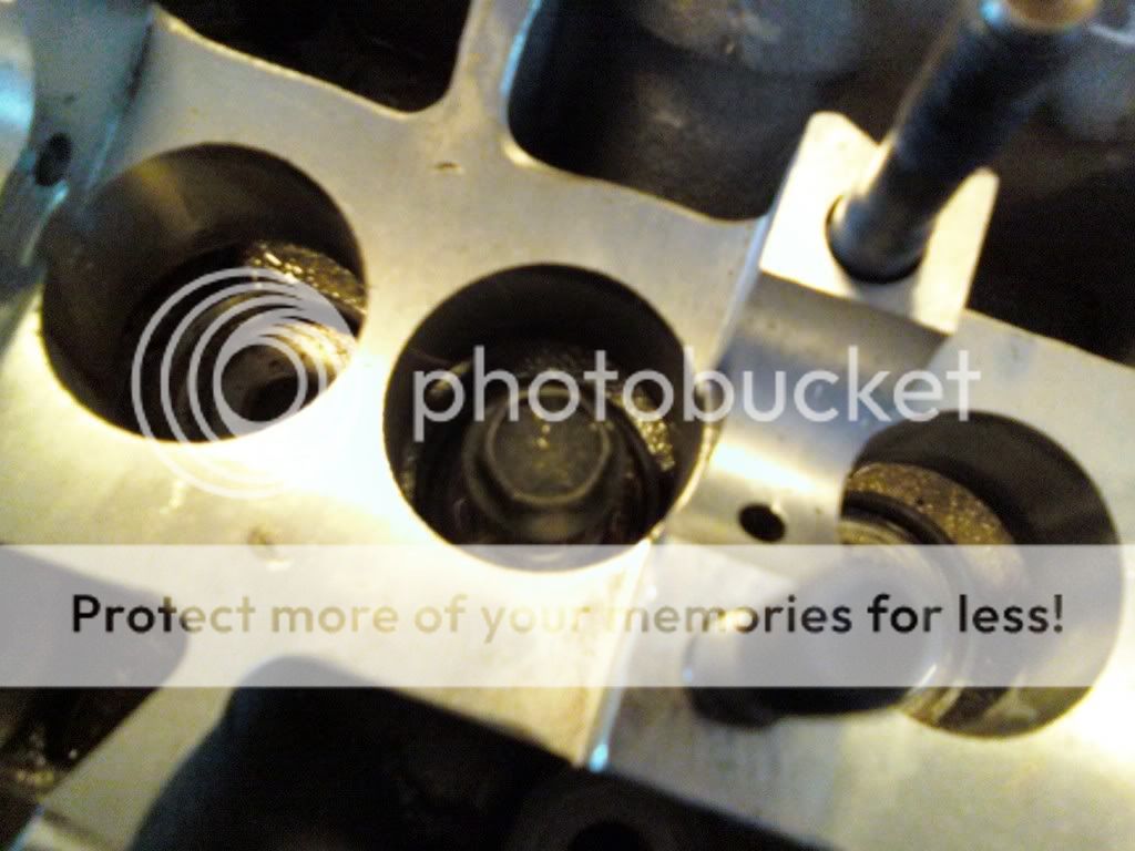

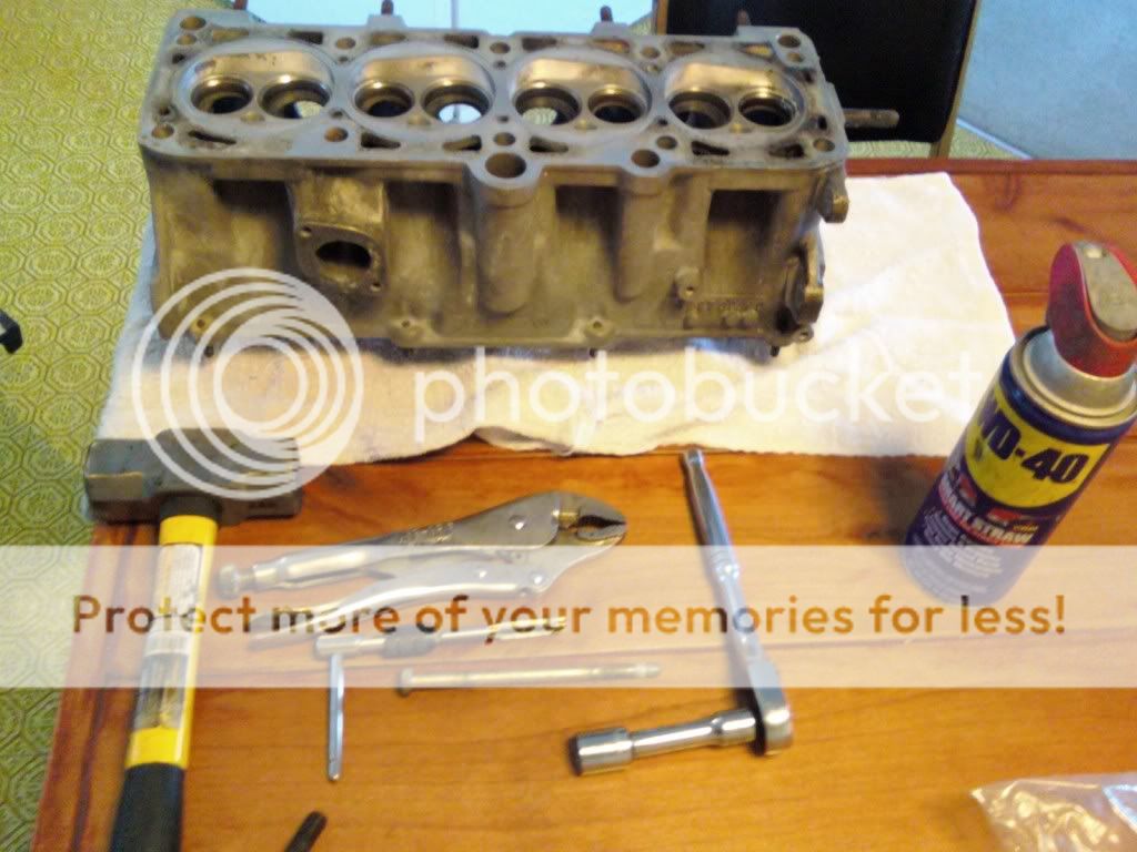

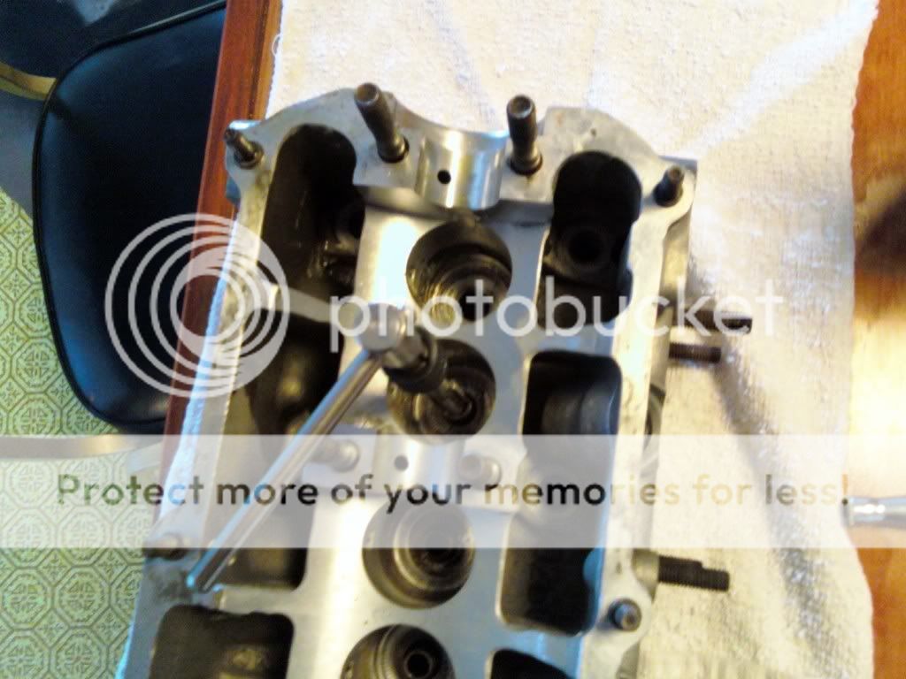

That's cool. How about those stock GLI springs? The underside is refinished, might start putting stuff back together this week. Going to start porting and polishing as soon as i build myself a crude flow bench. Found a neat way to get the guides out easily. From the valve spring side, use a 10mm tap and go in about to the level of the casting(little tricky getting it started. Screw in a bolt. Flipthe head over, insert a bolt into the valve guide. Then hit that bolt with a hammer( I found one good wack will break it free then just tap it ou the rest of the way). There was no need to heat the heat. they all came out super easy.
I'm sure it will work on a 16v just using smaller tap and bolts.

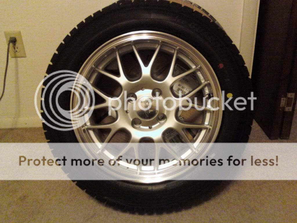

Re: My MK2 Jetta daily driver project.
Here are the wheels with winter tires on them(Yokoham Ice Guard)
NICE!
Dude! Those are your winter wheels???????? Might be willing to part with the GLI springs
