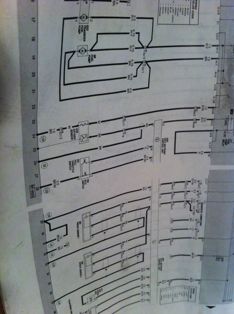

I know right
The wires on the right (there are 10 of them) were all soldered onto the single brown wire on the left (#35 on the ecu plug).
Can one of you guys tell me what that grey strip is (on the left side of the photo) were the wire terminate to?
My guess is an engine ground but i'm not sure.
Re: Idle Issue/Ignition Timing Sensor
The circled number is a reference to ground location. Should say at beginning or end of section. And the left(bottom) is always ground on these "current flow" diagrams.

Wow, the diagram is showing 10 wires that ground in motronic harness. So does that mean that the demon inside of mine is from the factory
I'm not sure what current flow is all about
Current flow is basically where the wires connect and flow. Voltage drops as it hits each device, but current stays the same. And I'm on my way to an electrical engineering rant... anyways, don't over think it. Another human figured it out, you can too. Story of my life.

You probably figured out that the top grey is the fuse box (built like a multilayer circuit board).
The first chapter in the electrical section usually has a decent explanation of reading these. I often refer back to it. The diagrams change slightly from Bentley to Bentley but are mostly the same.

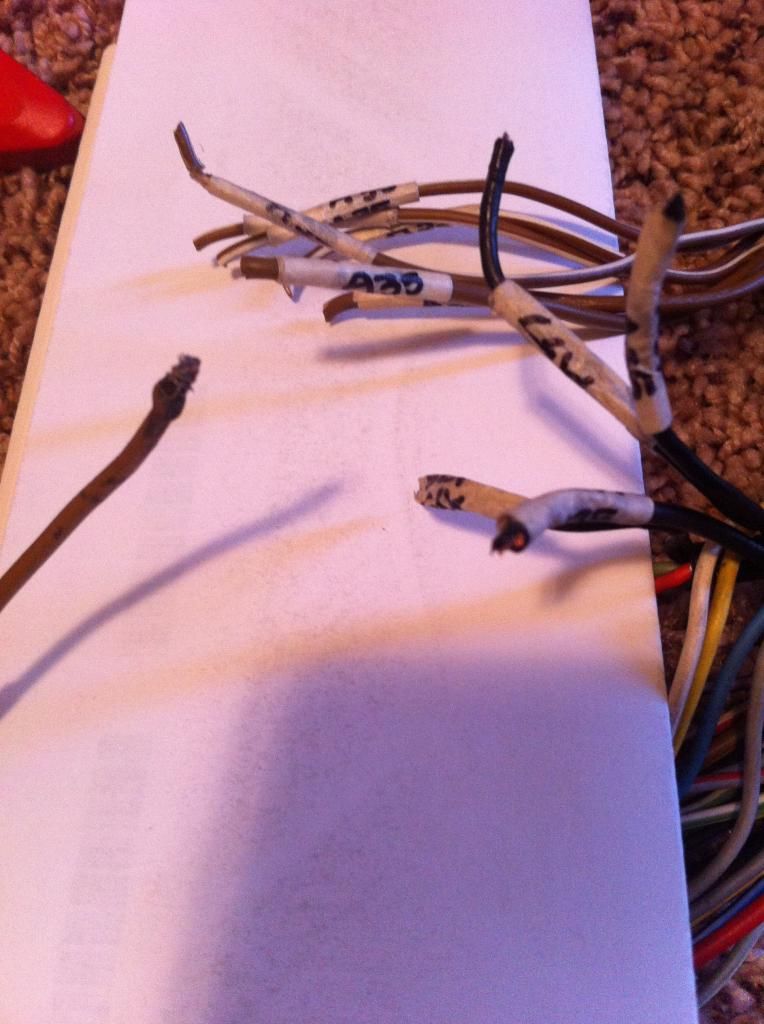

I hate to say........... but, the more I look at this, the more I think it may be a stock splice. Was there nice fuzzy coroplast tape on it?idubse7en wrote:Look what I found under the edu connector boot wrapped in electrical tape, seven wires spiced into one brown wire![]()

The splice was wrapped in a couple layers of electrical tape.

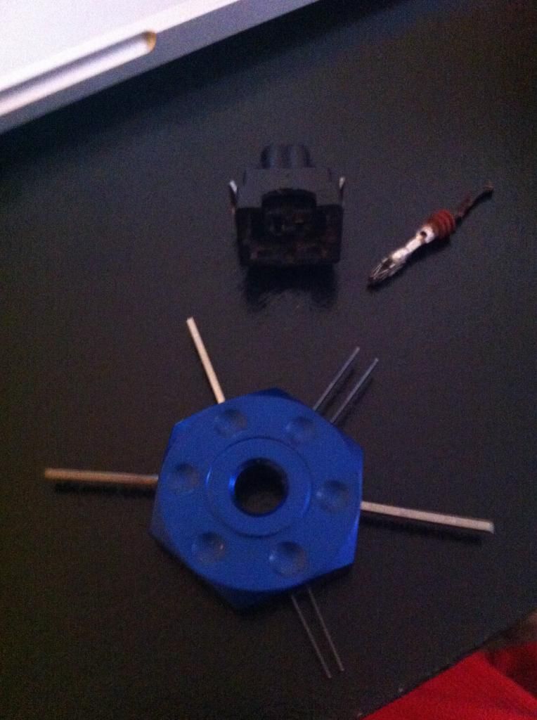

Got the terminal tool and it works with a little effort.

I had quite a few grounds like that in my vr6 harness. Wouldn't surprise me if that's stock
