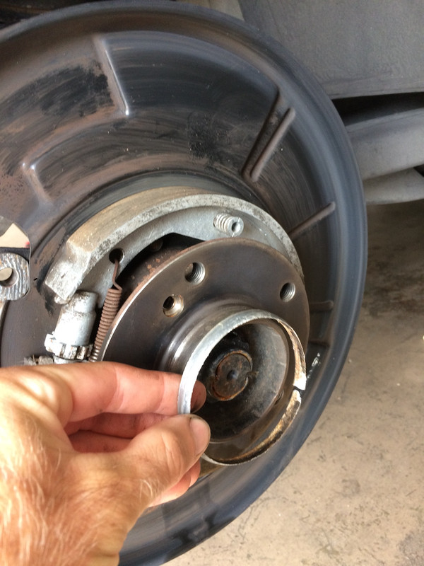

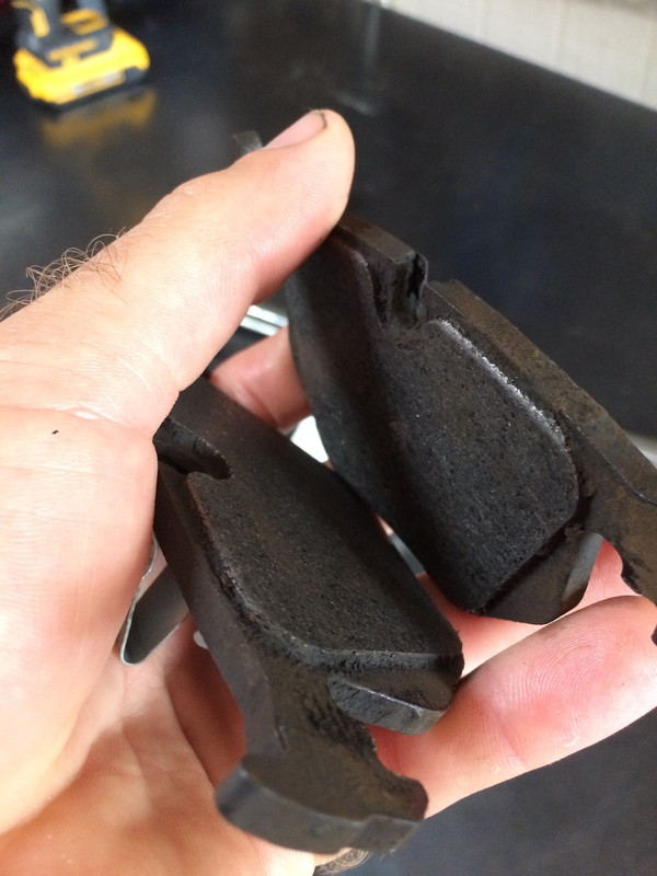

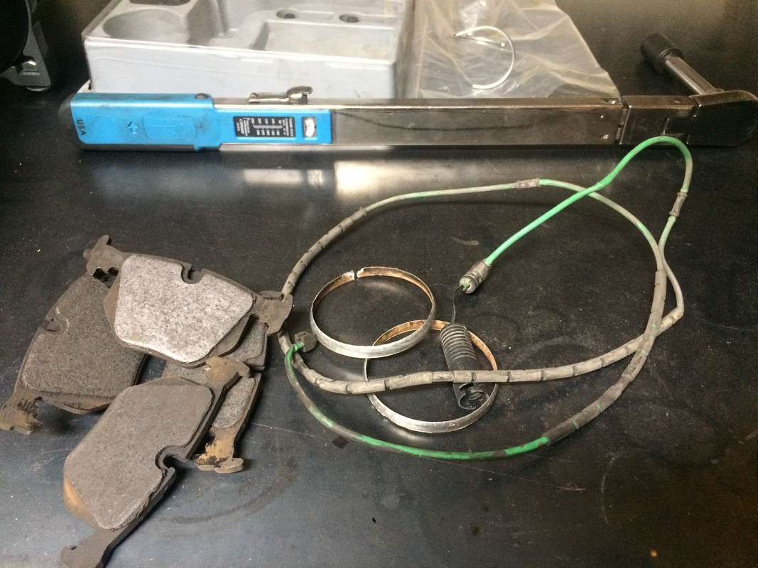

Here's the problem. Yup time to replace. Thank you little light on the dash.

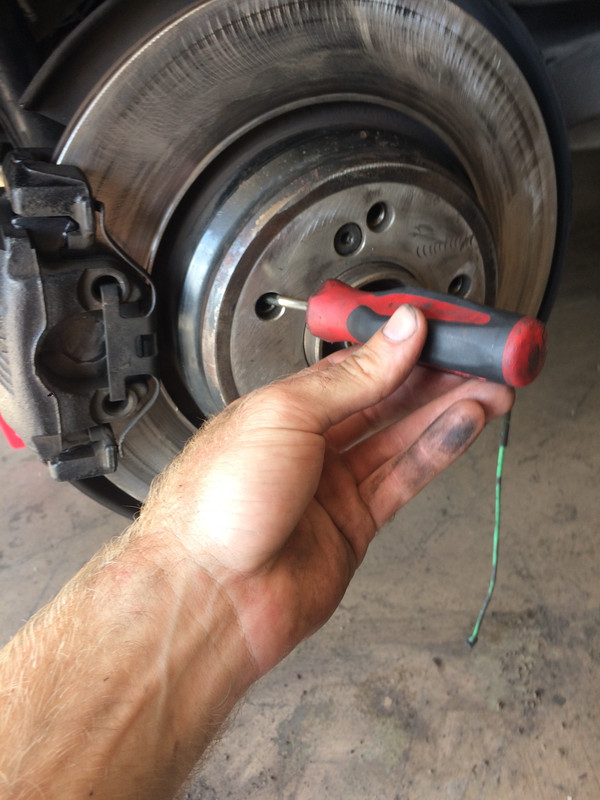

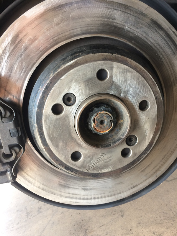

To get the rotors off, removed this ring. I think this is a hubcentric spacer ring left over from the aftermarket wheels it had on it previously and they never got removed when the factory wheels went on. They were kinda froze in place.

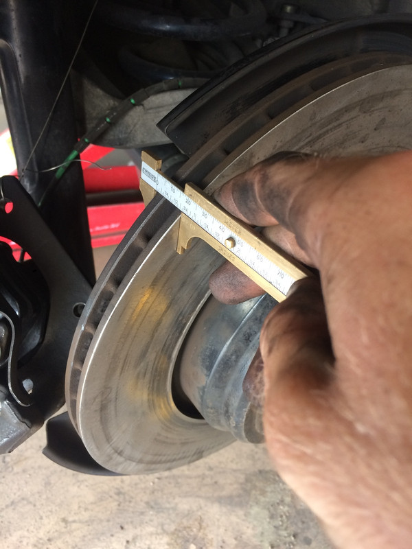

Cleaned the rotors up, yes I sanded them to get the lip off to measure the width. #gotnomicrometerproblems Got a full 1.5mm left of wear left on these. Not sure what that translates into miles
meh

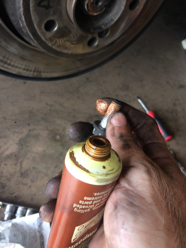

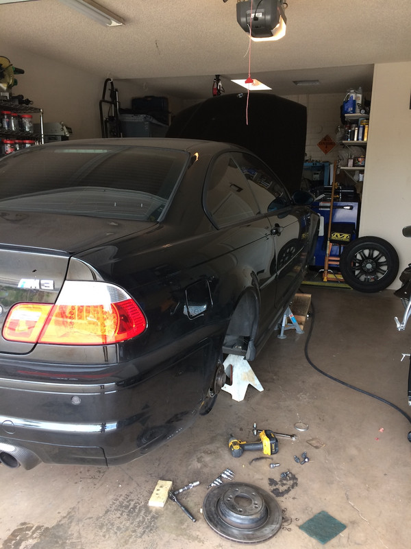

Putting it back together, everything gets anti-seize
Hehe, who can spot the problem here

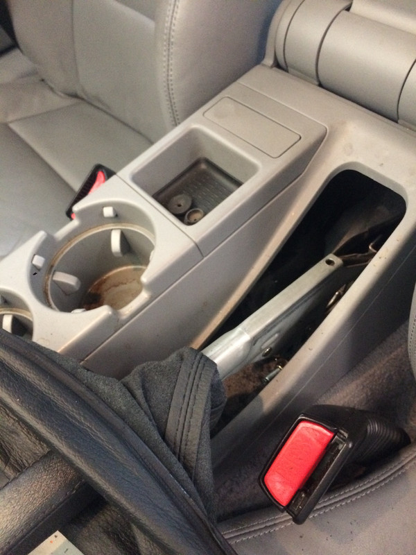

Adjusting the emergency brake. Had never worked. Works now
The carnage

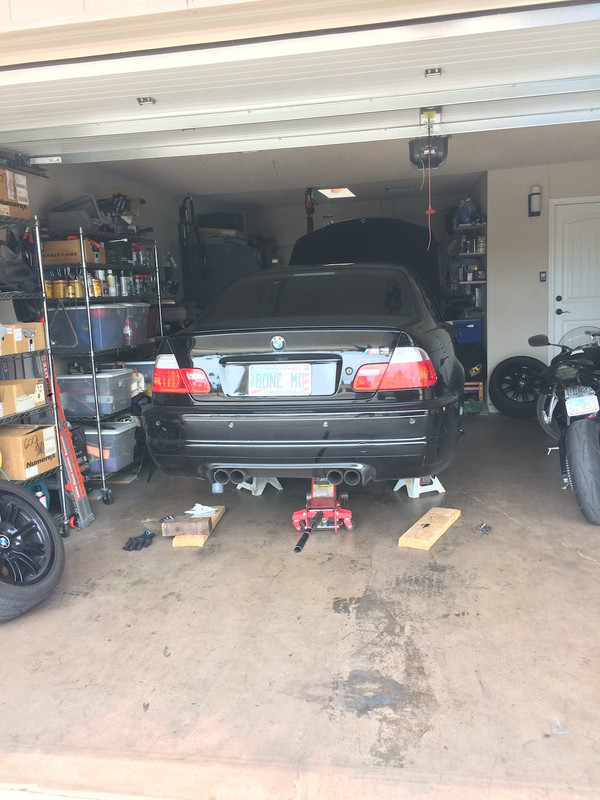

Funny story. So I finished, put the wheels on, gently tightened the lugs, set her down off the jack stands and drove off to an appointment I had somewhat in a hurry. 2 blocks down the neighborhood, I hear clunk clunk in sync with wheel rotation. < light bulb moment > drive slowly back to the house get torque wrench and tighten the lugs.

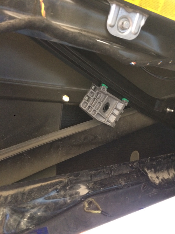

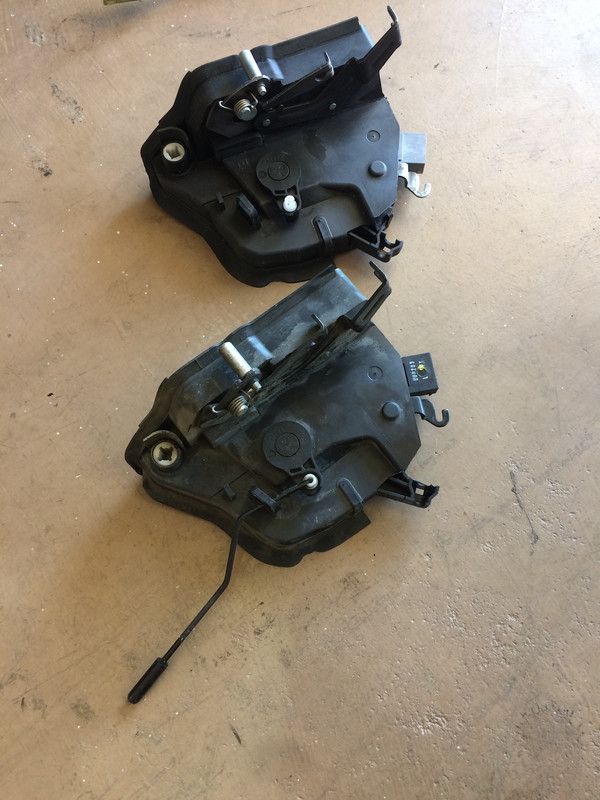

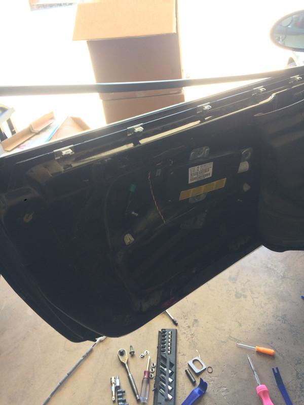

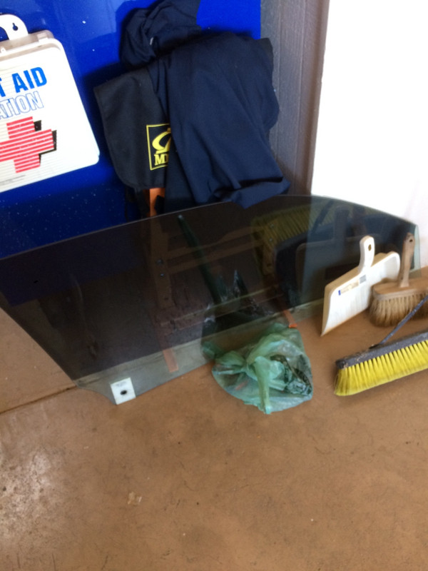

Randomly the driver side door quick unlocking with the key or button. Lock AOK, but just this one wouldn't unlock electronically. Could be either the actuator or the little computer that controls the locks. So, I partially disassembled the door, and could hear the actuator actuating when "unlocking" but it wasn't doing anything so took an educated guess that that was it. O'reilly wanted like 170$ and of course OE was more. Surfed ebay though and scored a new OEM one from a guy who's problem turned out to be the computer not the actuator for 90$.
Well door has to come apart
Glass has to come out
Track has to come out
Just to replace the actuator.

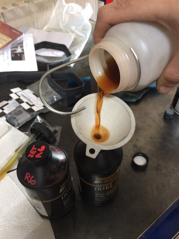

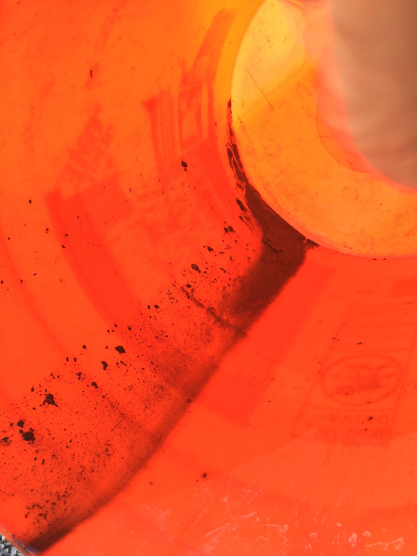

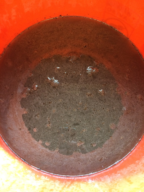

Started out the morning with bleeding the brakes.
I don't think it's supposed to be this dark. I bled it till it was much lighter (2 of the small bottles worth)

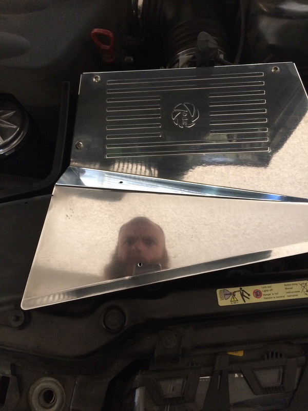

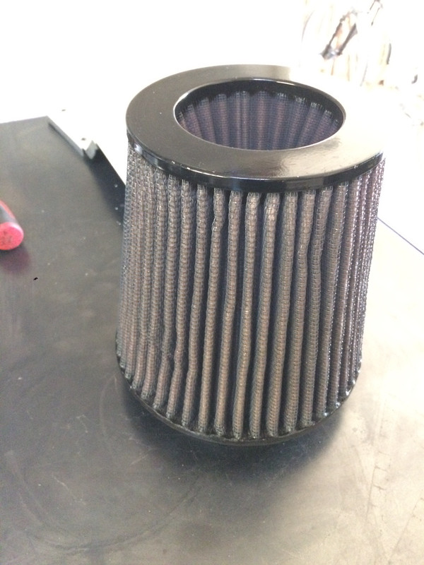

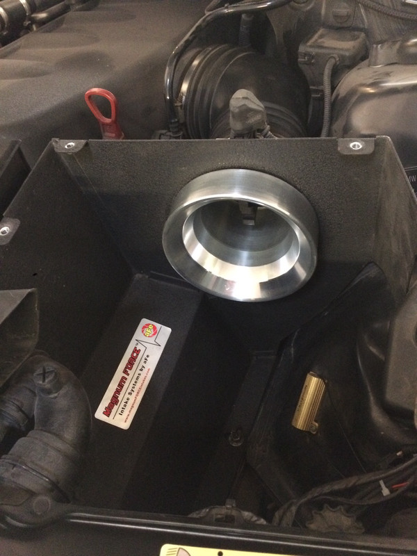

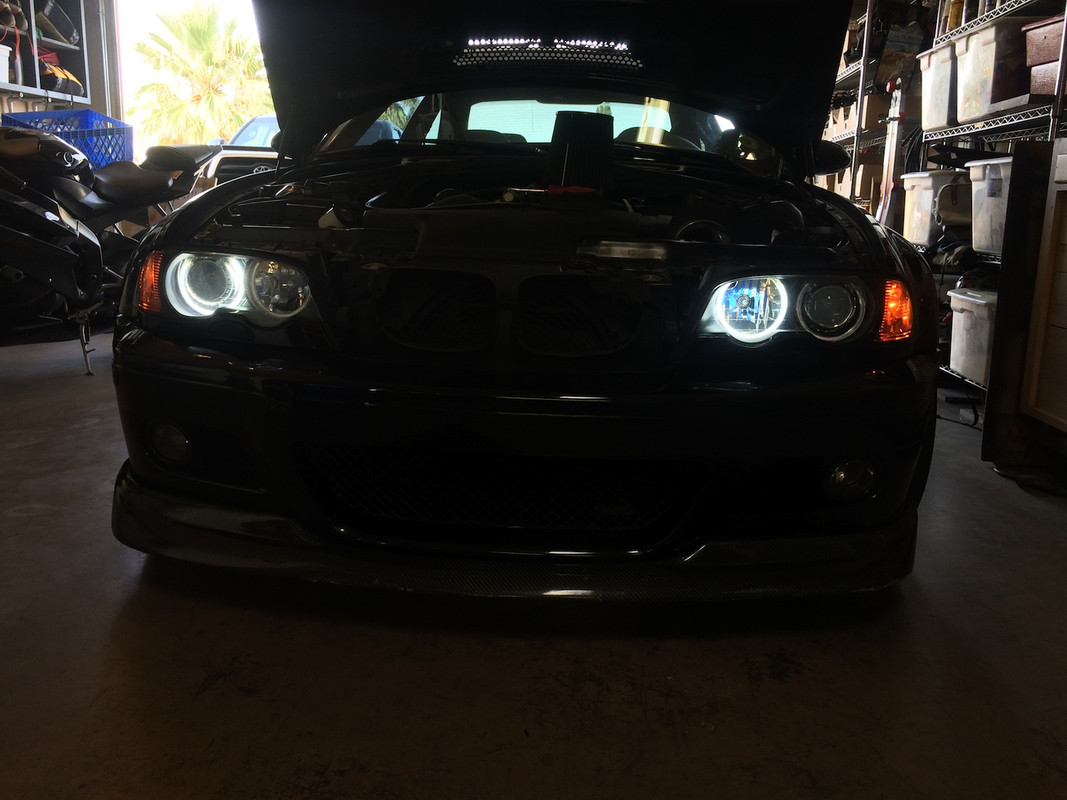

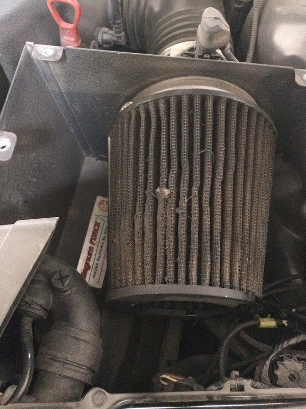

While I was out aiming my headlights the other night I noticed that it looked like I have angel eyes but they weren't coming on. Had the car for more than a year now and now I notice this... what can I say. Anyways in investigating this I removed the CAI cover and eww
So lets get after that

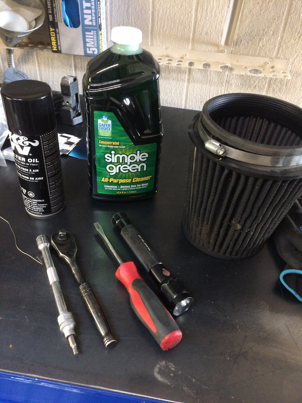

Soaked it in a bucket (not over the rim of the filter) for an hour or so
More better
Polished the cover 600/1000/1500/2000 and then some mothers to clean up a spot where it'd rubbed on the underhood sound deadening
Washed them both

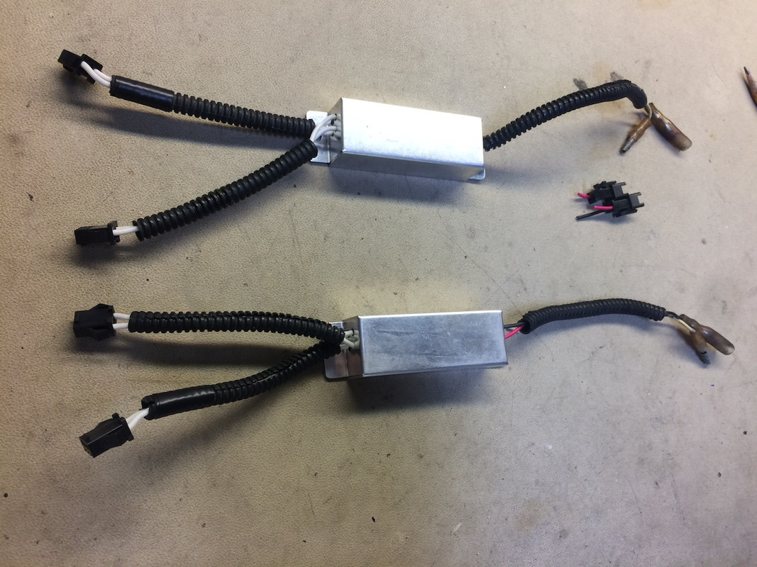

About the angel eyes... From what I can tell they're CCFL? type. Ballasts are getting power but nothing on the outputs so ordered up some new ballasts for 13$ and we'll try that.

Well this is obnoxious.
One of the halo rings must be burnt out. Just one. Of course you can buy just one for 9$... not bad. But then I run the risk of having one be a different color then the others since I have no idea what brand or temperature the existing are. Grumble.
Well new ballasts installed and some progress I suppose.
