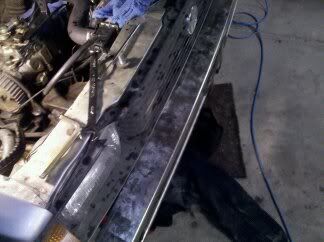

First: remove the bumper (4 18mm bolts on the front frame horns)
Second: Pull bumper from car

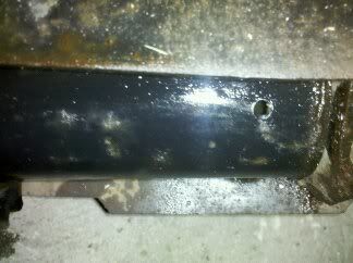

Third: Punch a drill bit guide on the big part of the shock (oil side)
Fourth: Punch a drill bit guide on the small part of the shock (gas side)
Fifth: Drill where you punched
Repeat on other shock

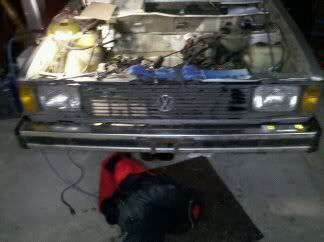

Sixth: Hammer down both sides to where you want the bumper to sit
Seventh: Put bumper back on.
Pretty easy, here are some pics.
Sorry, not much for pictures tonight. I just wanted to get it done.

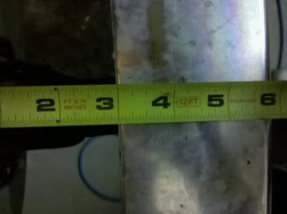

Looks sort of uneven for some reason.. must of been camera angle. Both sides measured out identical.
