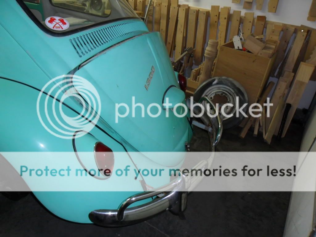

Re: The 66
Reassembled the bumper today and reinstalled. I had to clearance the bumper so that the deck lid could open. The back is a little squished in. It works now though.
