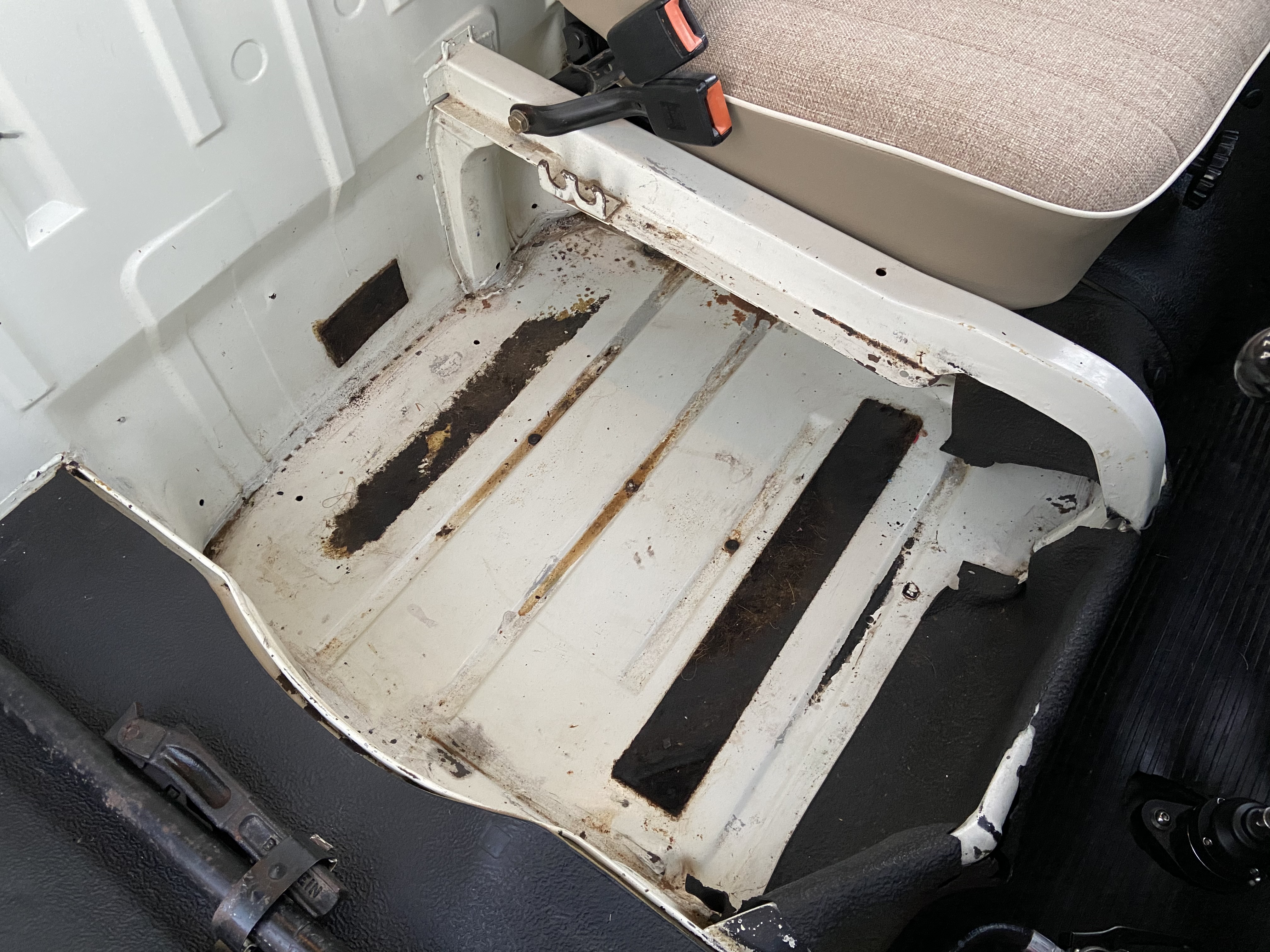

Going back a few months ago, I replaced the rubber seats stand mats with now ones from Bus Depot, which I think are produced by Wolfsburg West (?). Still wanting a solution for the middle area, I'll have to figure something out there, but both the left and right sides look awesome!
Went ahead an ordered the seat cushions and covers from Sewfine. It was a bit of an expense but I needed to replace my OEM seat covers something terrible. I disassembled the seats down to the frames, cleaned and painted them with some black primer/paint and reassembled. First put a layer of burlap down with hog rings, them the cushion with a bit of spray adhesive and few more hog rings, then slid the covers over the frames. I ended up using just a bit of wire (it's the type of wire used when installing drop ceilings) in the end channels to reinforce and shape the edges where they lock into the tabs around the frame of the seats, especially on the drivers side seat. Again, this was a really nice update, and it really makes the Bus much more fun to drive and looks fantastic. Here's a few pictures from the install:

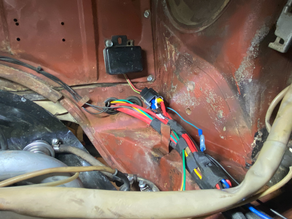

The horn has never worked since I have owned it, so I started looking into the horn circuit and found that the tab at the bottom of the steering column had been bent in and out of the way. Probably from the PO that didn't want to deal with it, or didn't want to fix the horn...because it would be on constant blast if the circuit isn't correctly wired. Anyway, I picked up a new horn, pulled the column and fixed the tab, reattached the wire, and made sure the outside of the column was not grounded to the vehicle. Picked up new horn springs, horn bar, and and the circuit is now correct and the horn button works fine with a nice little 'beep'!

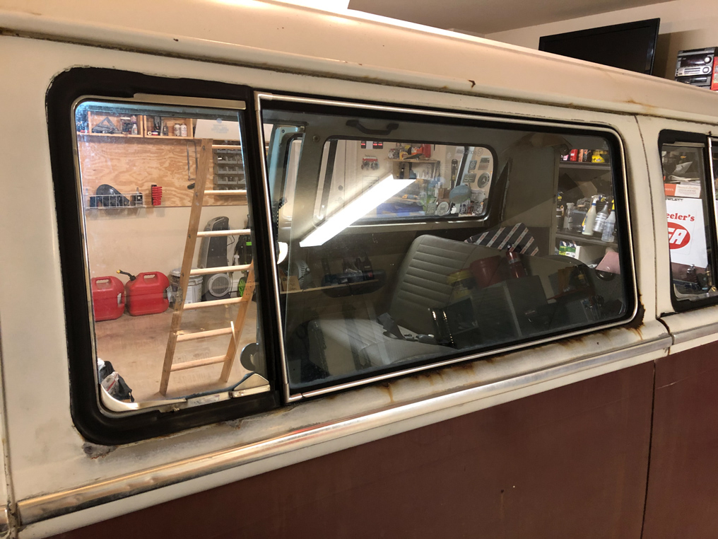

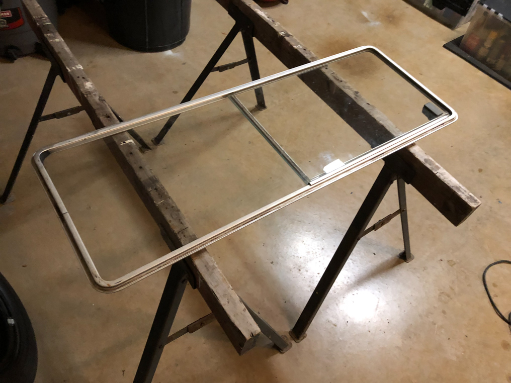

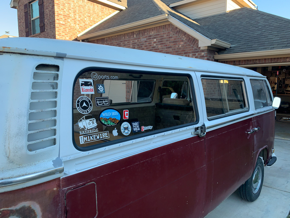

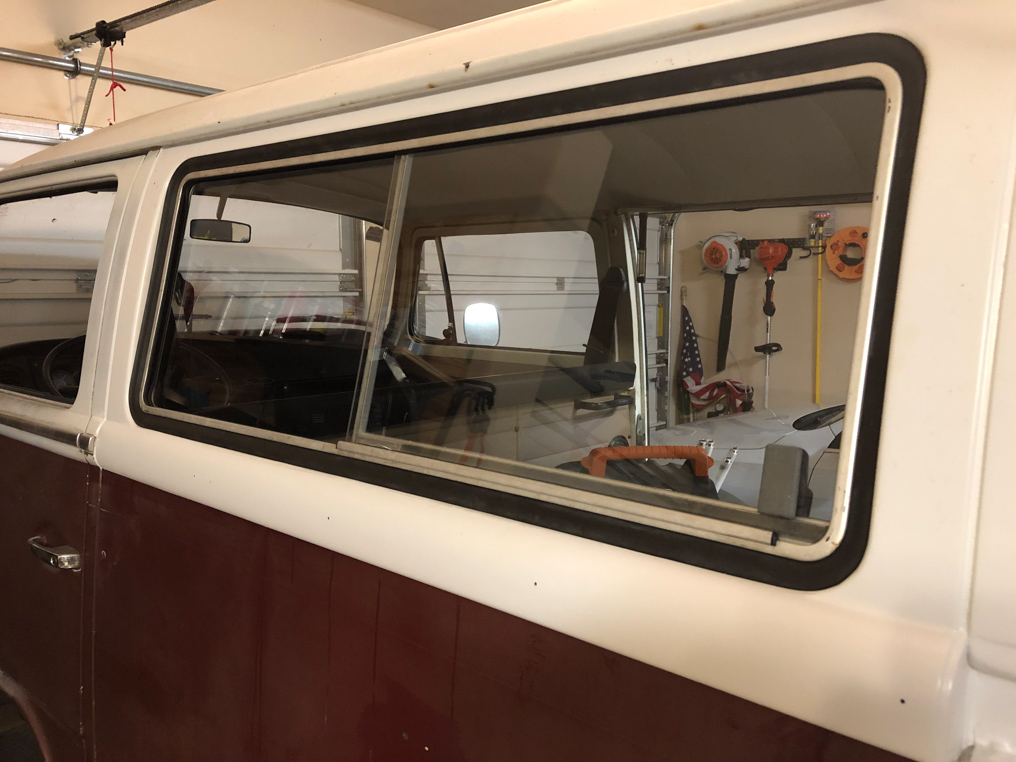

  1. Slider windows on both driver and passengers side middle windows. These were somewhat hard to find, but I was able to track a set down. I ordered individual parts to rebuild each one, all with new rubber seals and felt sliders, even the plastic guides were replaced.
    I also installed all solid glass in the rear side windows, removing the vent style windows. All windows have new window rubber, and while the windows were removed, I cleaned up and did rust mitigation, painted with primer and painted the upper white trim area. Looks pretty fresh!

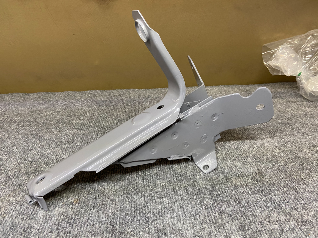

  4. Painted air box support
    F.I. airbox support I had fabricated was an item I had never painted. It is bolted in, so I unbolted it, prepped it and painted with classic Grey Pro paint. Much better! Before and after...

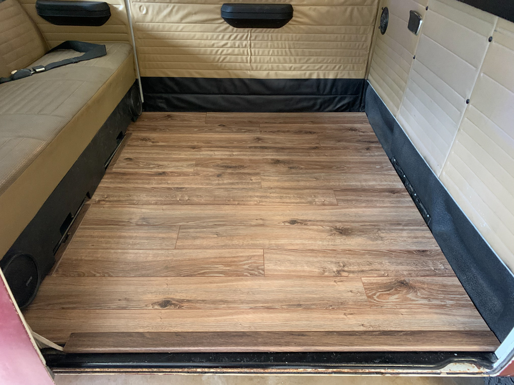

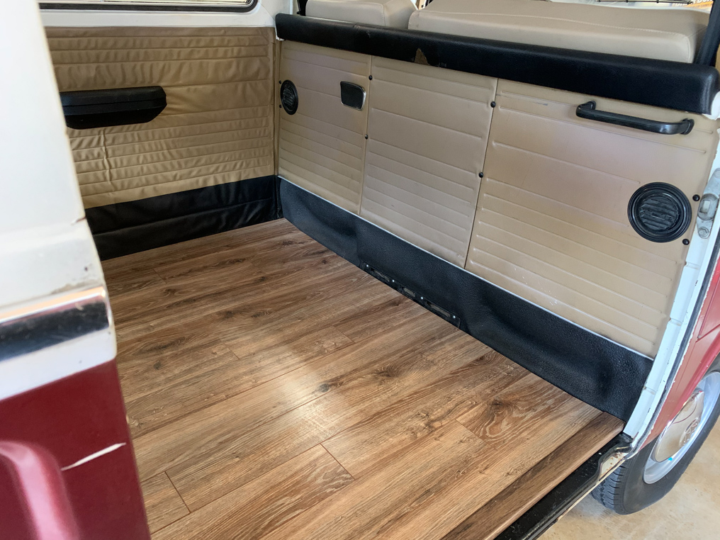

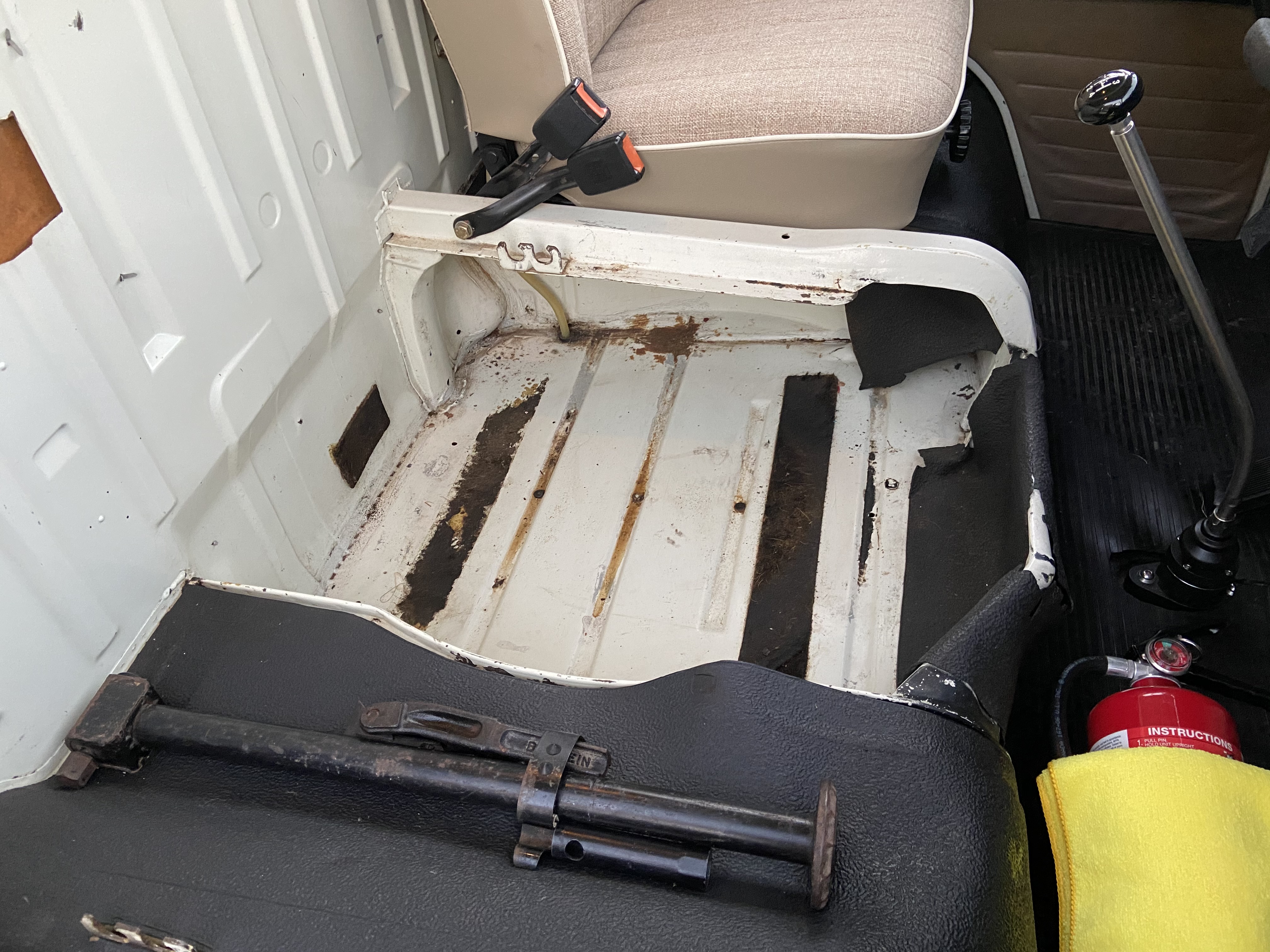

  5. Subfloor and laminate flooring
    Was at Lowe's one day and found some laminate flooring for $10 a box, which is super cheap! Picked up some plywood for a subfloor and installed the laminate on top. It works with the theme and looks great!

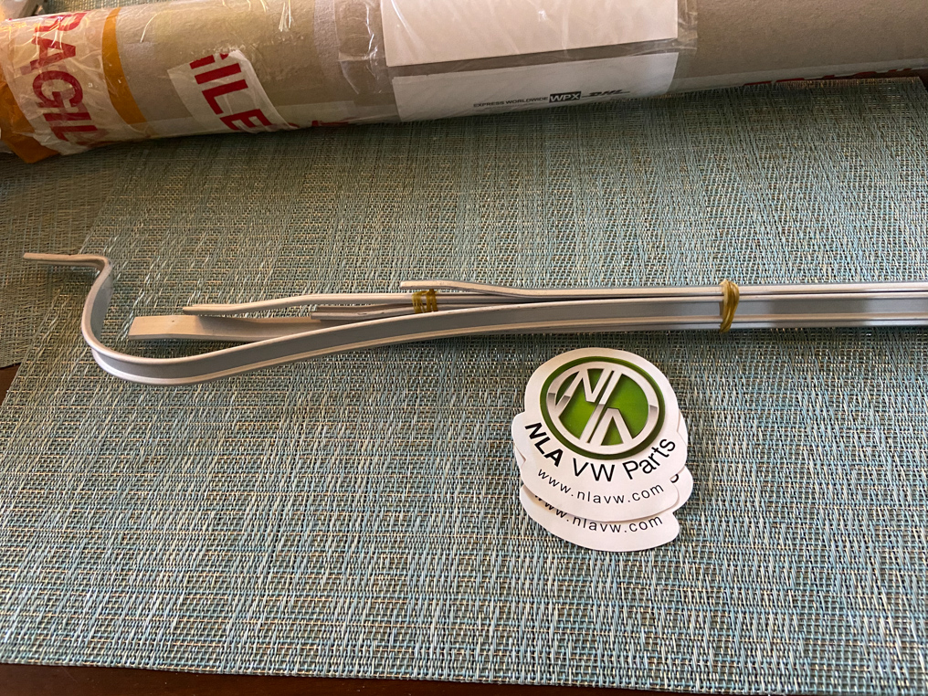

    Not a camper, but I wanted some curtains. Maybe one day I'll put in a rock-n-roll bed or something so I can camp or overnight in it. Anyway, it was easy to make the curtains, but took some time there, and found OEM style curtain rails from NLA parts across the pond

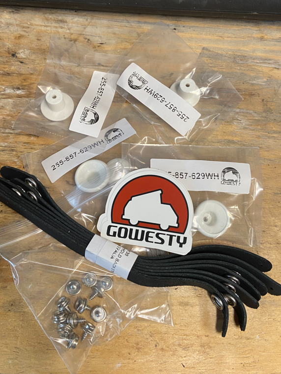

  7. Interior bits and pieces, curtain straps and coat hangers, knob icon inserts
    Little bits and bobs, sourced from Bus Depot and GoWesty made the little things happen and complete the look

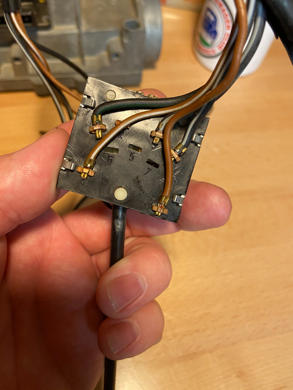

  8. Turn signal rebuild
    Rebuilt the OEM 1972 only-type switch with some internal parts from a very smart Gent who is 3d printing reproduction peices in ABS. It was a bit of a puzzle to get to fit and work, but it worked great and now I have the original 5-pin turn selector which is much nicer than the newer/crappy generic 7-pin replacement

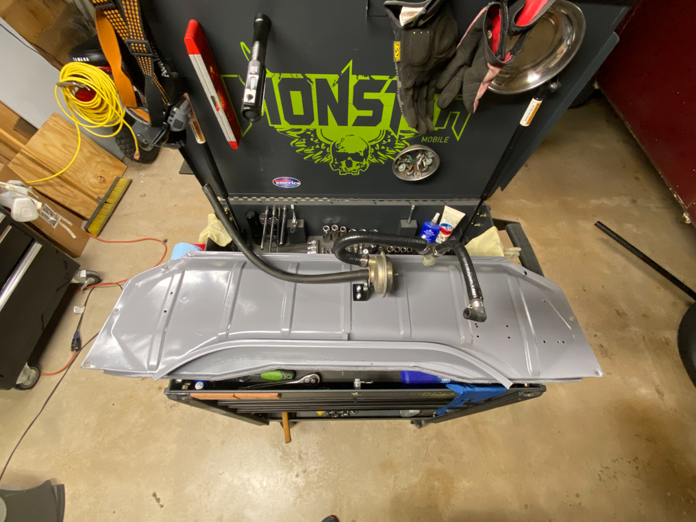

  10. Painted firewall and added support for the decel valve
    Painted the rear firewall while it was out for the fuel access hole activity, and also created a 90 degree mounting bracket for the decel valve

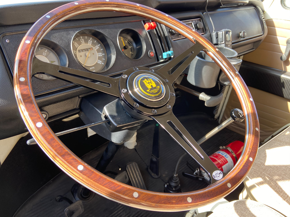

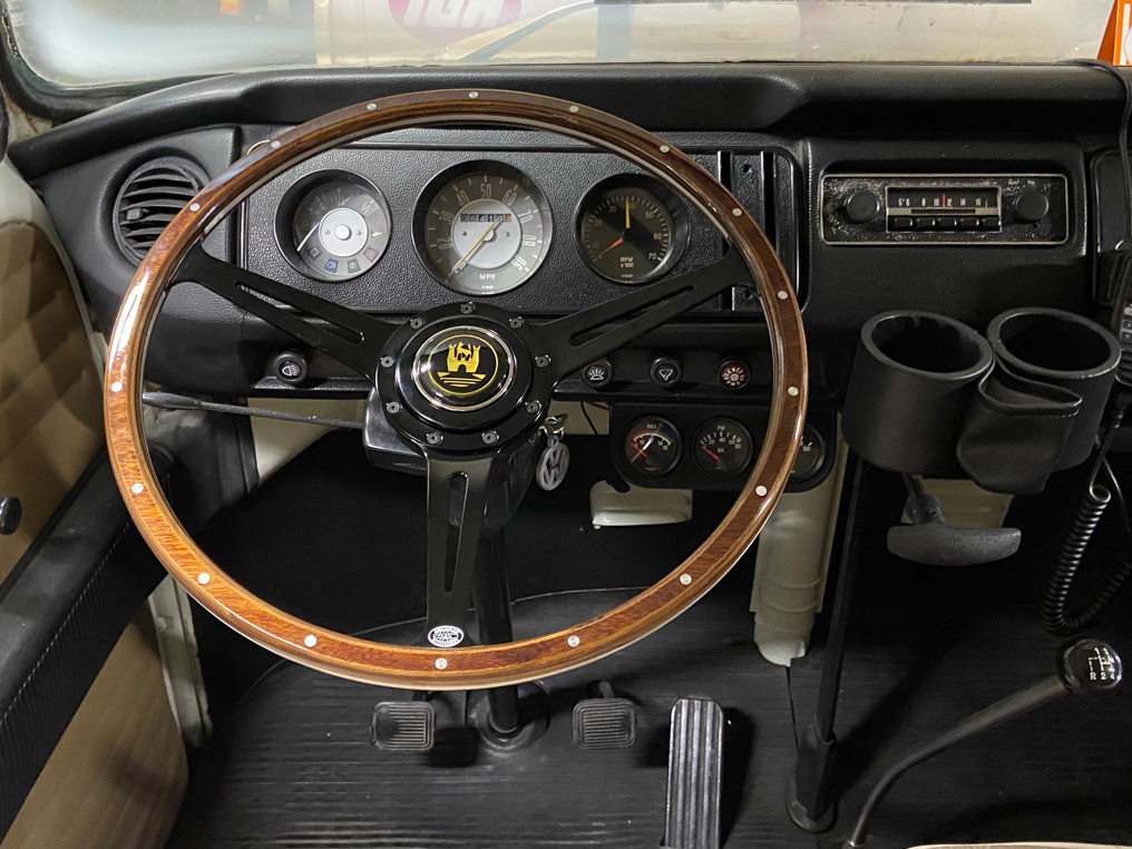

  11. New AAC steering wheel
    One of the best functional and aesthetic upgrades I've done so far, a new AAC steering wheel procured from The Bus Barn in Arkansas. Thanks to Sam (the owner) for being awesome and bringing these super high quality parts from the UK

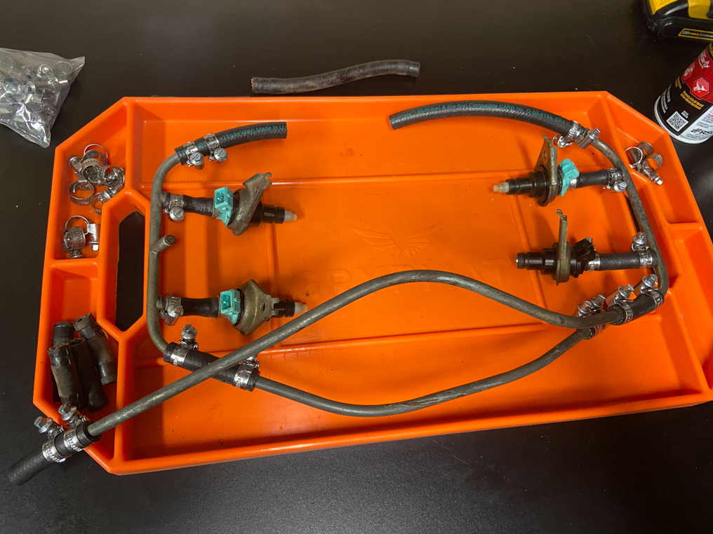

    Pulled and replaced all the fuel lines with Gates Barricade FI rated fuel hose, needed to be done even though my older hose was doing OK, this makes me feel better about potentially having to fill up with an ethanol fuel blend

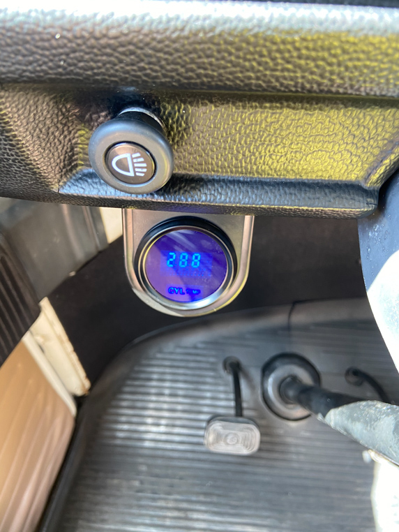

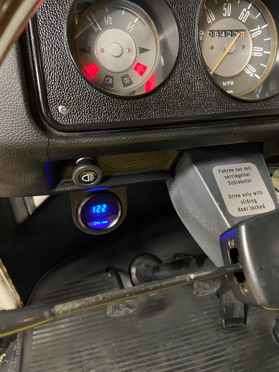

  13. Dakota Digital CHT gauge
    Added a very cool piece that will help let me know and be proactive if my air/oil head temp and cooling system is compromised or has an issue. Been wanting one of these for a while, and while the sender install wasn't easy it was easier to do while I had the fuel system disconnected while rebuilding and changing fuel lines

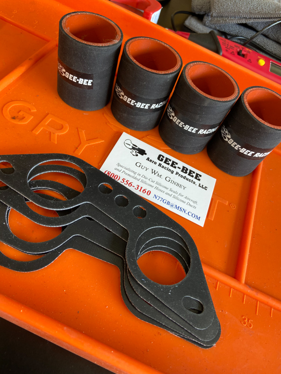

  15. GeeBee Silicone intake gasket and intake tube seals
    Found this new product when cruising The Samba, pretty cheap seals and better than the OEM style

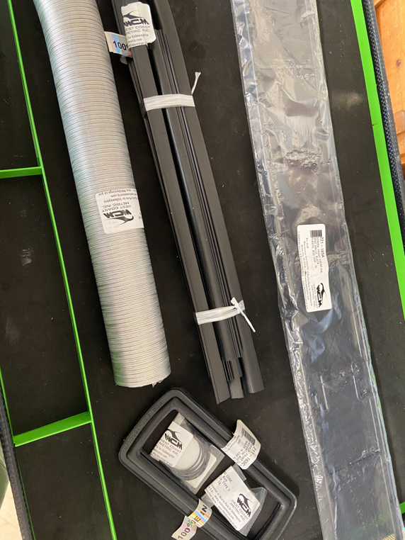

  16. All new German door seals
    Replaced all door seals with new German WCM seals. Wasn't tough, and used just a few dabs of 3M yellow weatherstrip glue. Doors shut pretty well, but the best bit is that they don't leak anymore!

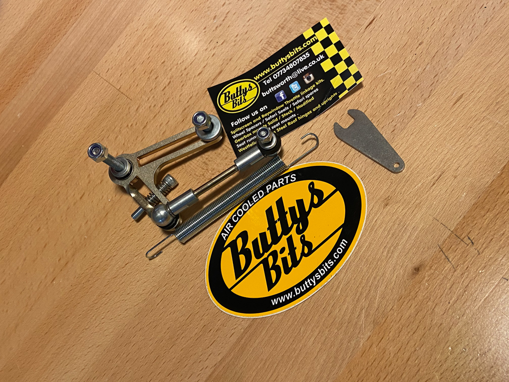

  18. Butty's Bits accel upgrade
    Really great upgrade...this kit gives a smoother pedal action and a spring return on the throttle pedal itself - easy to install and makes the pedal much more responsive

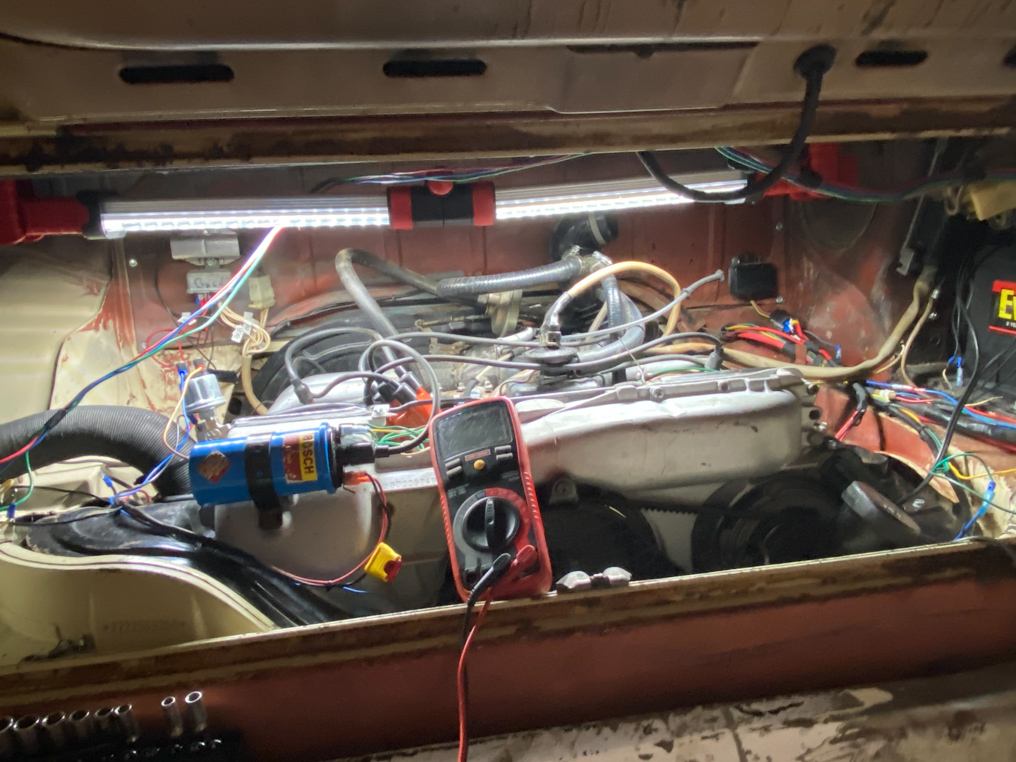

  19. Cleaned up wiring and engine bay wiring bundling
    Pretty self explanatory, just cleaned up the bundle, added some weatherproof connectors and made sure it's all tucked in nice and cleaner than it was before
  20. Engine hatch seals, front turn signal seals
    All seals from WCM, really nice and glued in for the back hatch. The front turn signals fit well and look much better than the old crusty ones

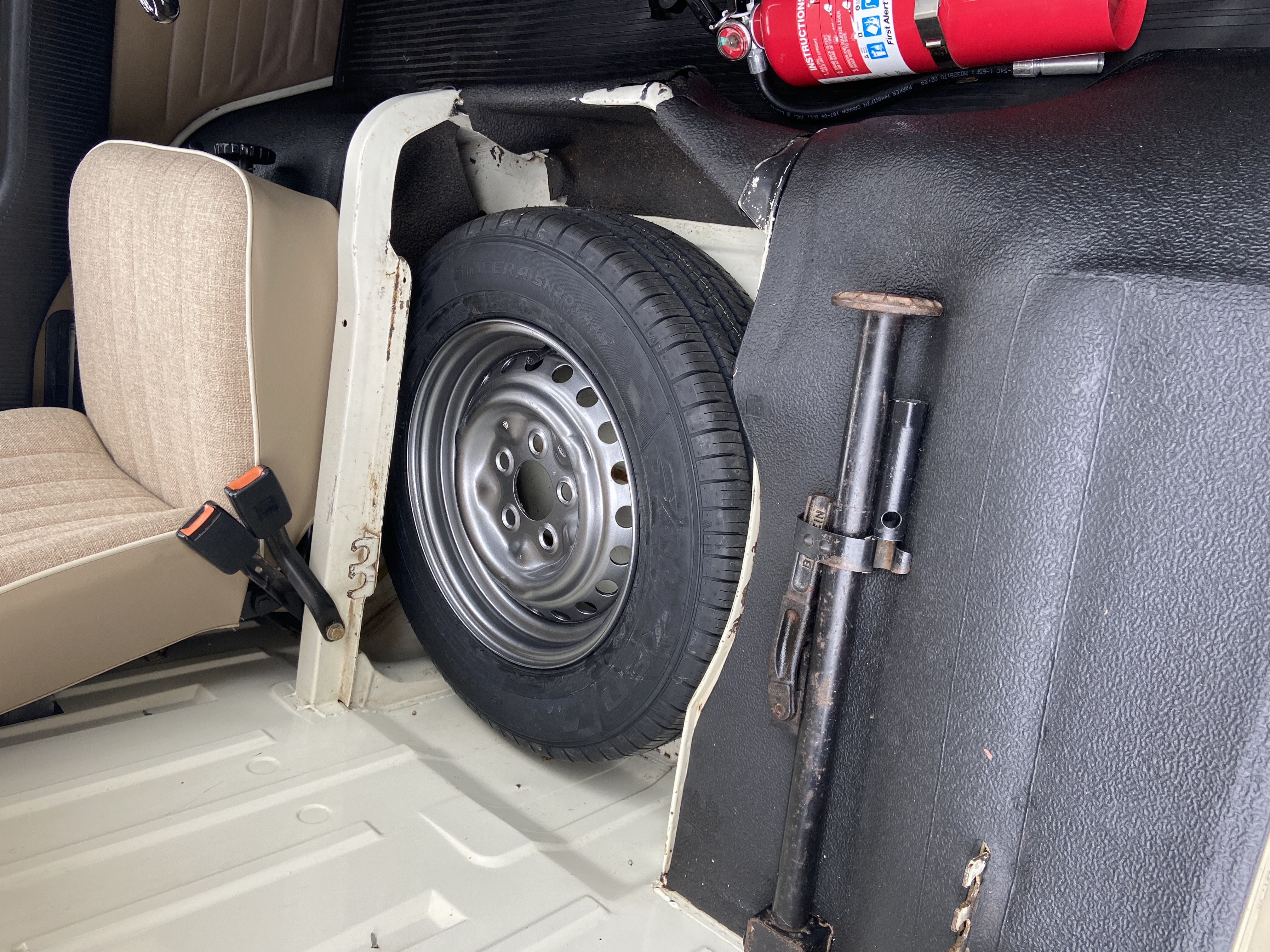

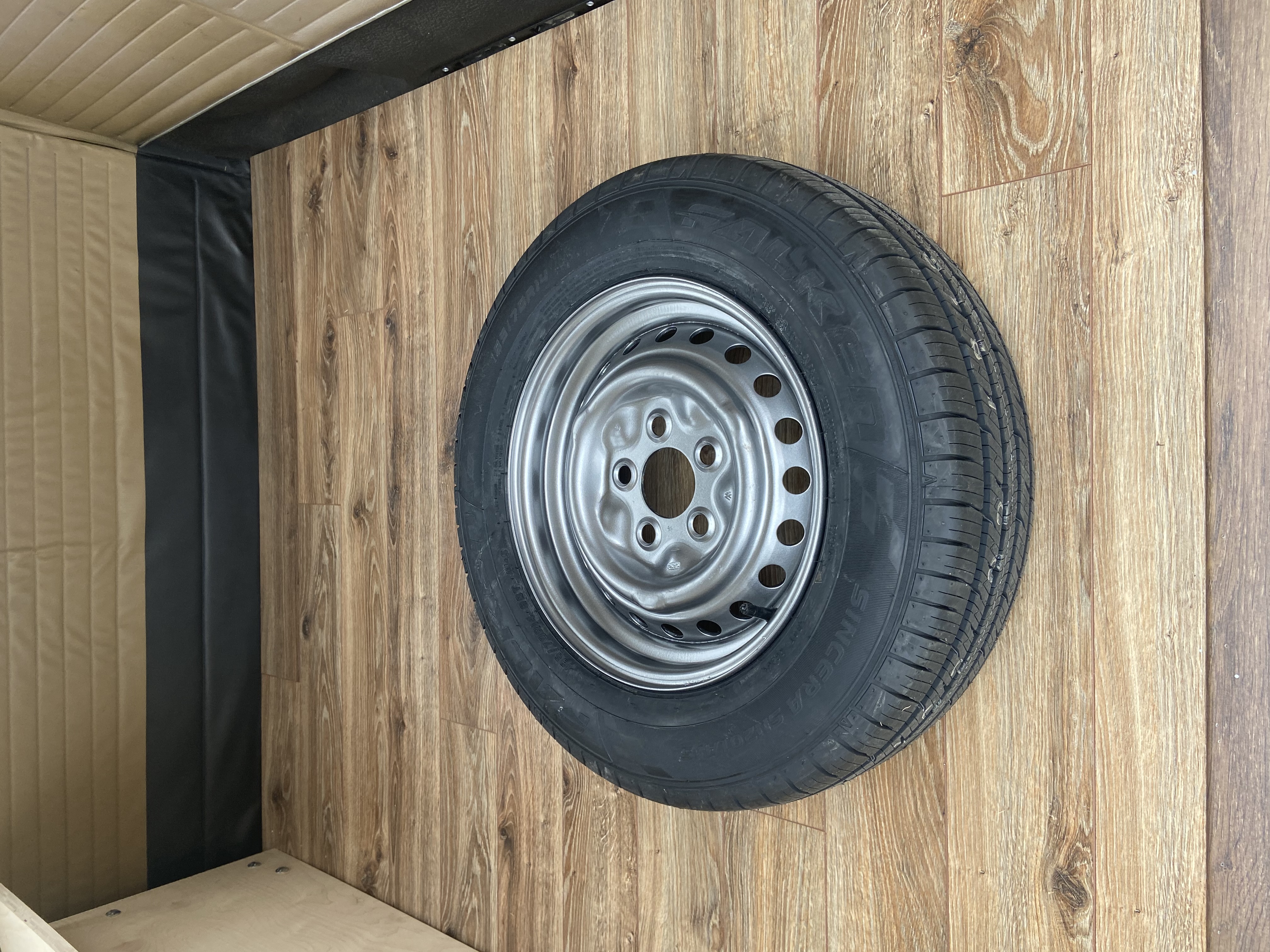

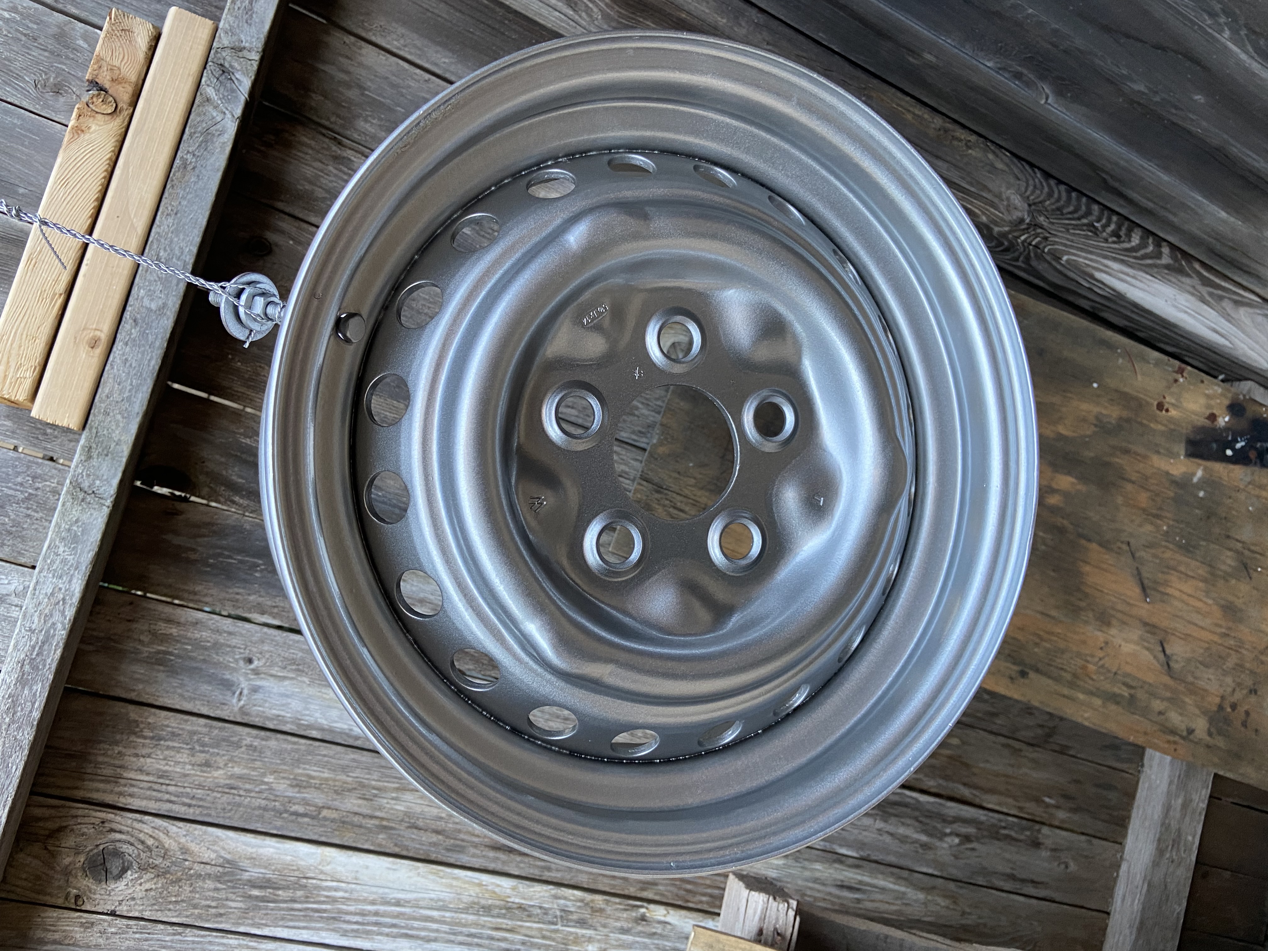

I needed to replace the old busted spare tire. While it was out I had the tire removed and I gave it a good 3 coats of silver paint:
Here's the old setup, from a while ago before other updates...
A shot of the new painted wheel:
Open spot for the spare, I need to go back in and do some additional detailing and cleanup in that area:
Wheel back from the tire shop, installed a decent Falken tire - because it's a spare I didn't spend a ton on it, but it will get me out of a jam if I need it:
Looks comfy tucked into the spare area:

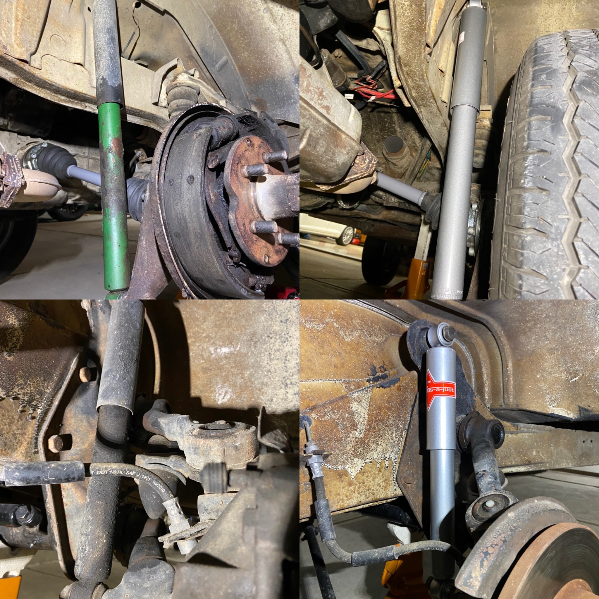

Replaced F&R shocks. The old ones were Boge OEM and had zero rebound, and the rear drivers was completely frozen, and wouldn't budge at all. Much better ride on these new KYB's!

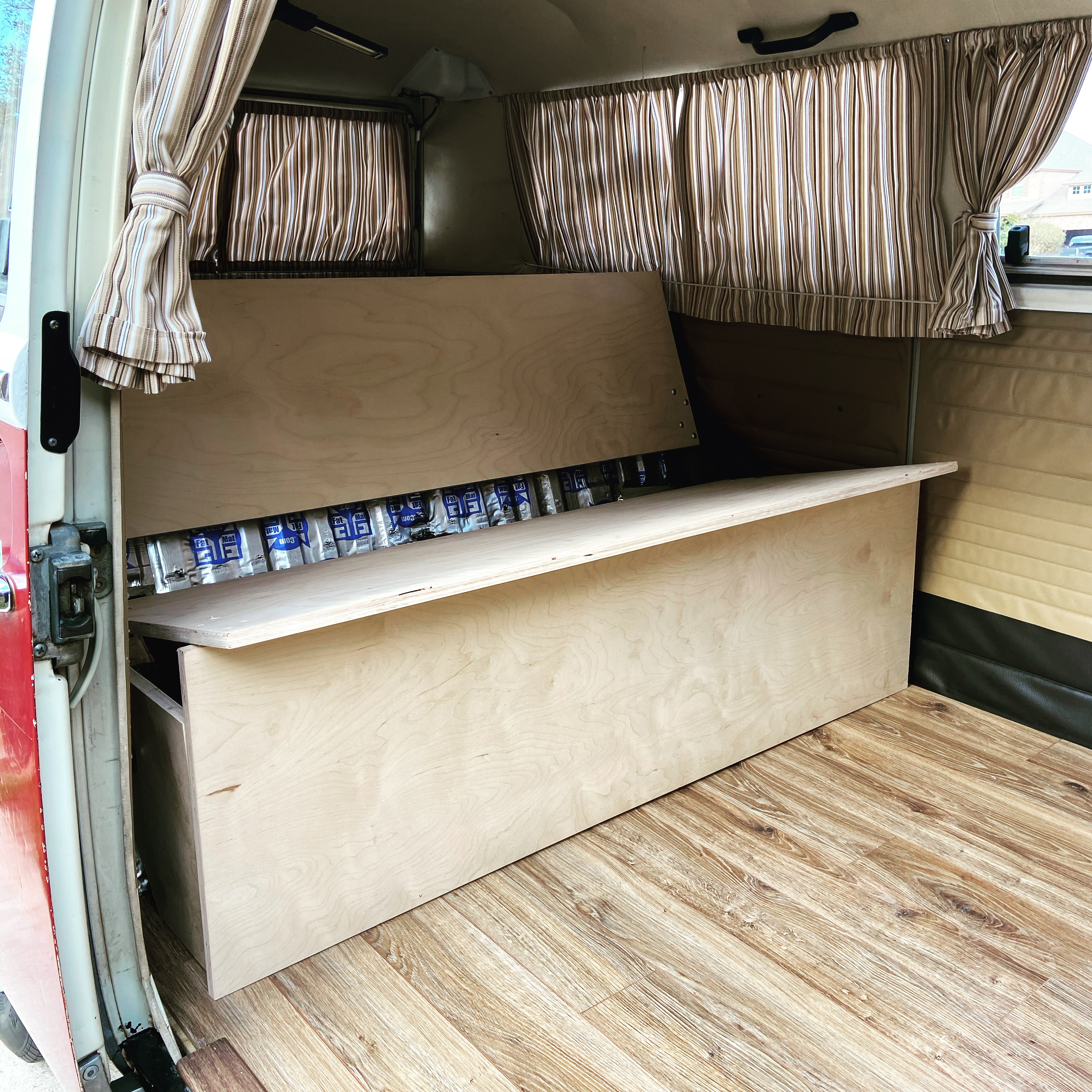

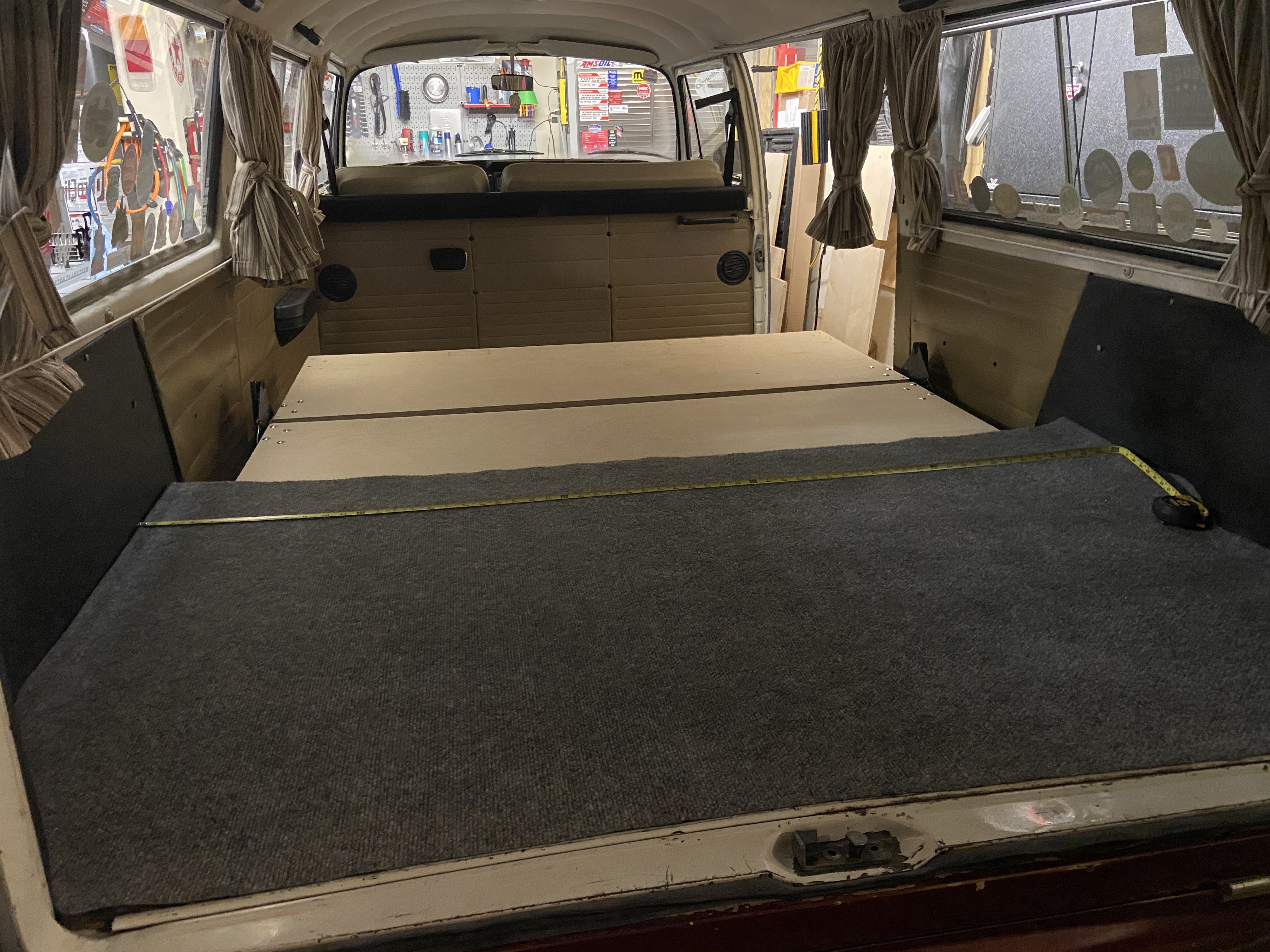

Started working on a full width Westy style rock n' roll bed. I picked up a set of Westy style hinges from NLAVW and then got 2 sheets of 3/4" Birch plywood. Found some basic plans on the Samba and cut them down to size. Picked up some hardware from Lowe's and bolted it up. Used some rivnuts on the back hatch to secure the rear and a couple of lag bolts through the base of the bed to secure in the front. This is a mock up, I have more to do to make it fit and function properly:
Here it is laid flat. Plan is to get a 4" foam cushion and sew some covers. Still working on that part - need to find a good fabric that will work for the cushions:
