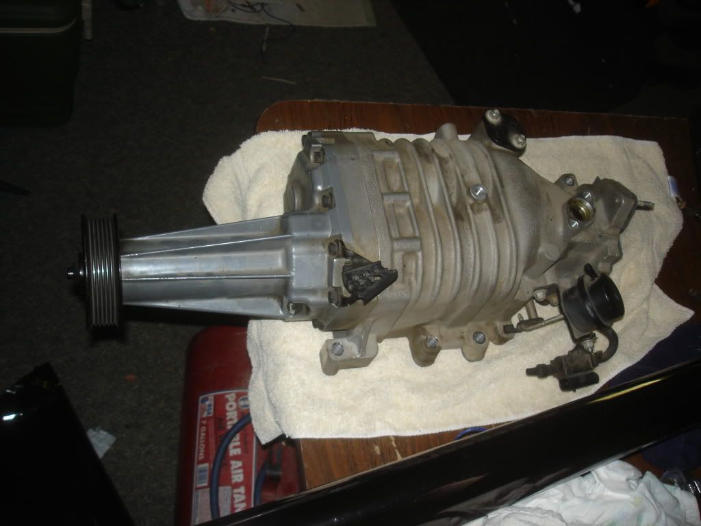

^its harder than it looks^ but i like where this is going
this will make incredible torque down low but will flaten out up top. start researching small pullies, or take it off and have a smaller one machined.
edit* what did that come out of? looks like one of the GM ones? grand prix GTP?
- Spoolin!
- Posts: 954
- Vehicles: subi's and vdubs
- Location: Helena
yep its from a gtp. 3.8l v6

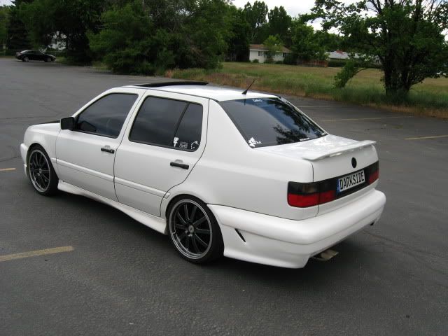

Jetta got hit in the rear corner, while parked
Not too bad. anyone know is Golden Nugget a good paint and body shop?
aaw that sucks man
the best ive heard in billings is big sky collision, chat with Todd!
