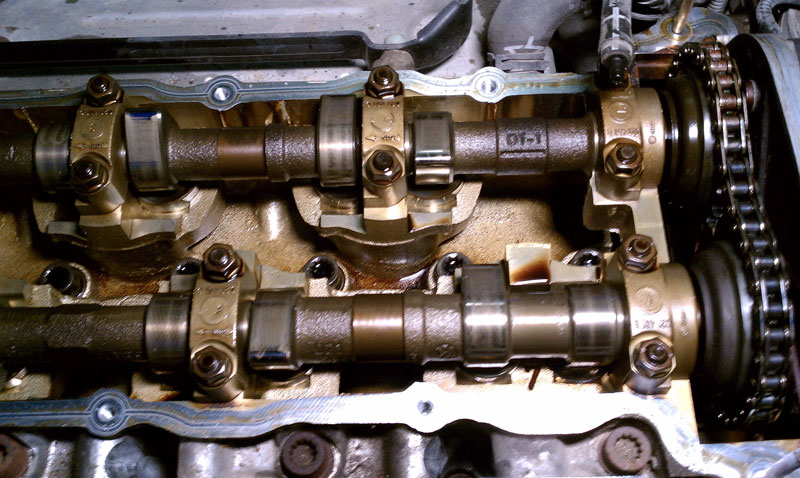

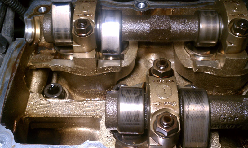

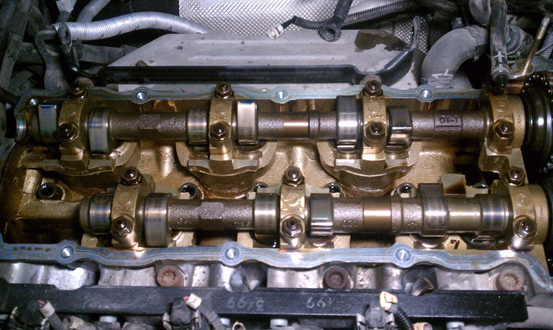

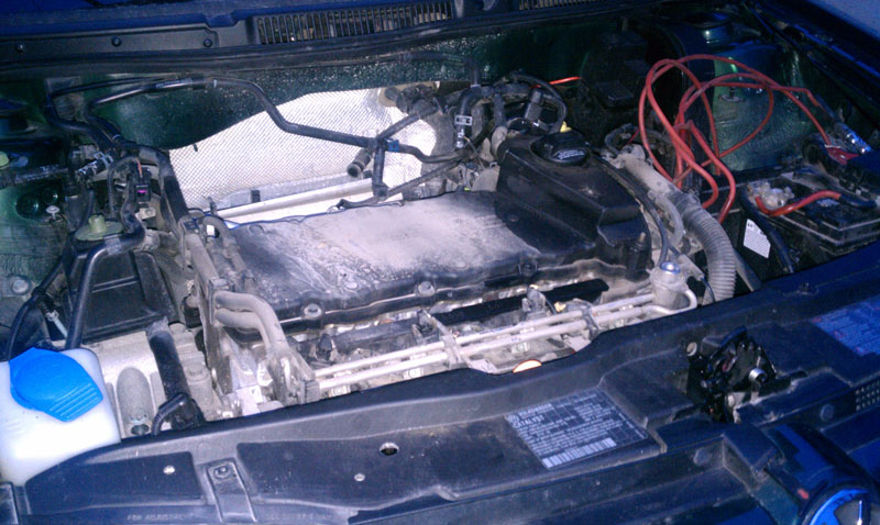

Got to the intake tonight. Had to unbolt the passengers motor mount and jack up the motor to reach the intake bolts on the upper intake runners. Anyway...
I don't think it looks too bad, for a motor that has 125K and was run dry until seized. Seems like too much slack in the cam chain.
What do you guys think?
Re: Project Alaska 2K
Looks like the chain is broke.

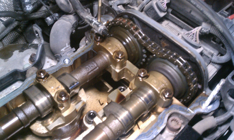

Possible, I could see how that could happen. I'll have to dig into it when I pull the motor.

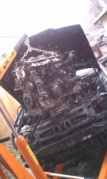

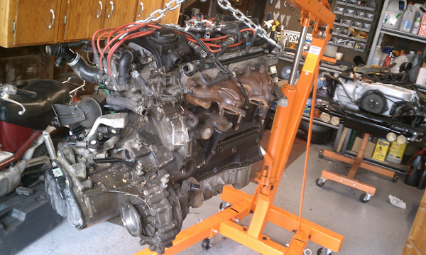

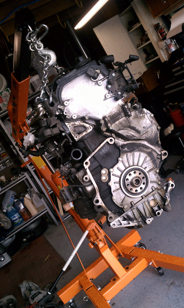

Purchased the AAA block today. Also made a deal to throw in a few extra parts from another MKIV with the motor. Time to get that dead weight pulled out and on a stand.
deads a understatemant lol

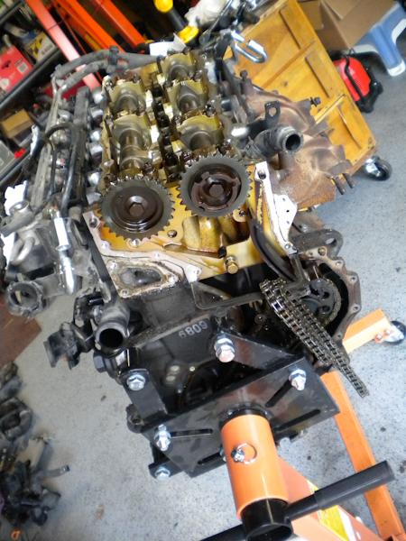

My VR6 seems to like loose/broken timing chains! Not really.

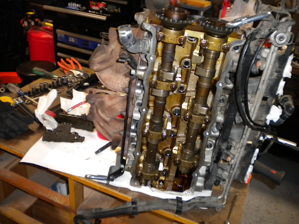

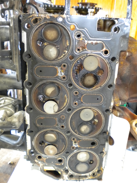

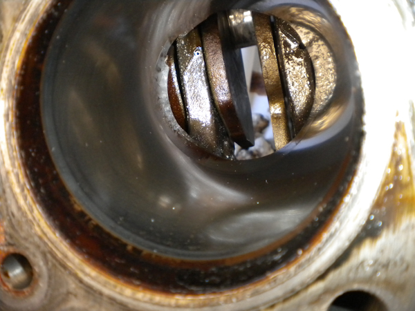

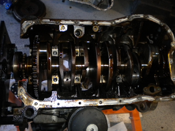

Not broken, just some slack. Well, a lot of slack now.

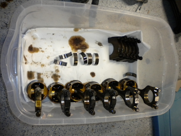

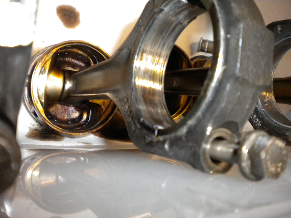

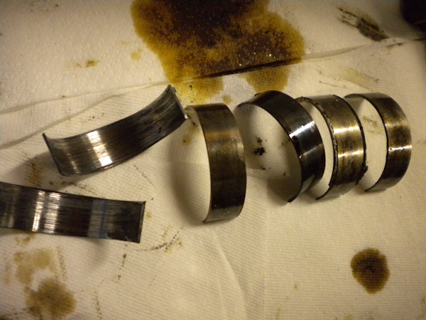

Some melted bearings
Block is still solid and the crank is OK, but the rod journals would need machined and polished, or just get a new crank. Mains look great. Oil pump turns smoothly. This may be a great donor block is someone wants to bore it over :unibrow:
