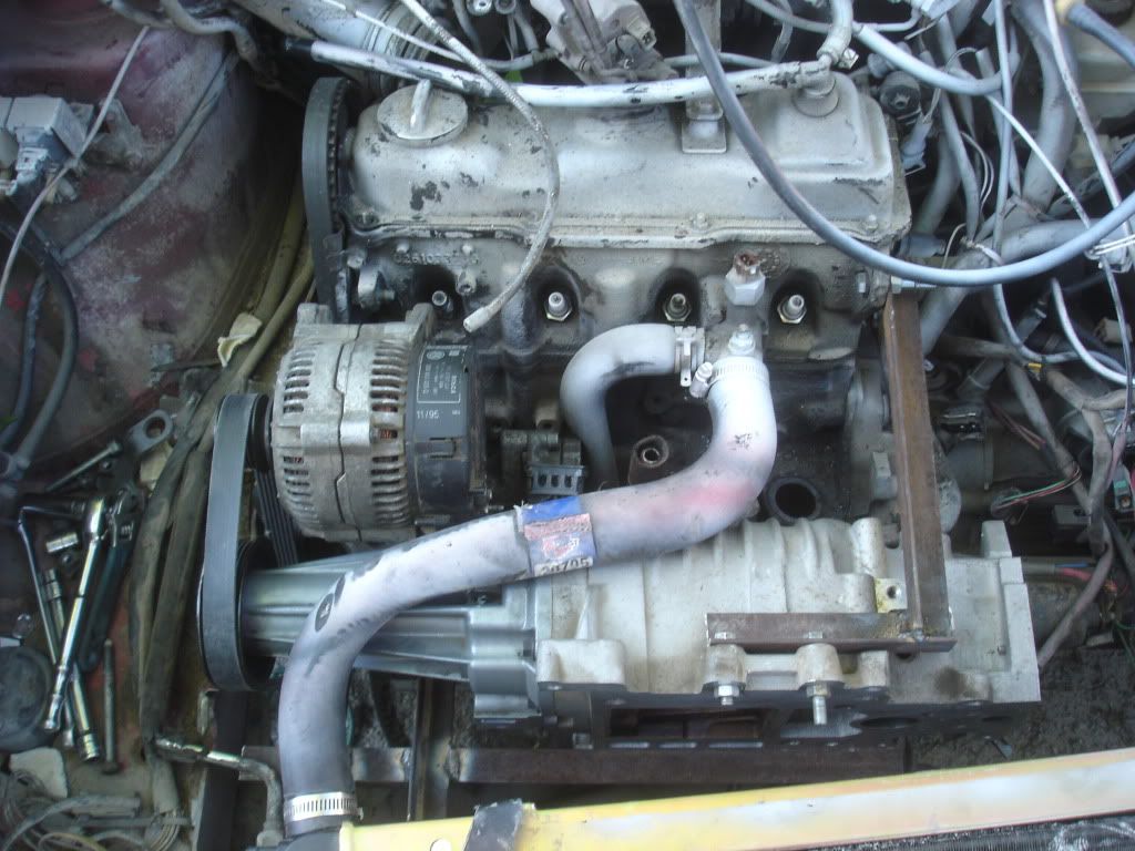

no room in back especially with that big of charger. this one recircs in the bottom. whew! i would at least double stack headgaskets or this will just pop. youll also need one hella strong tensioner or itll slip like mad. i dont know how well stock digi 1 will handle that, remember stock digi 1 only has a 1 bar map sensor so 14.5 ish lbs before the fuel stops. i would toss in them 440cc's too.

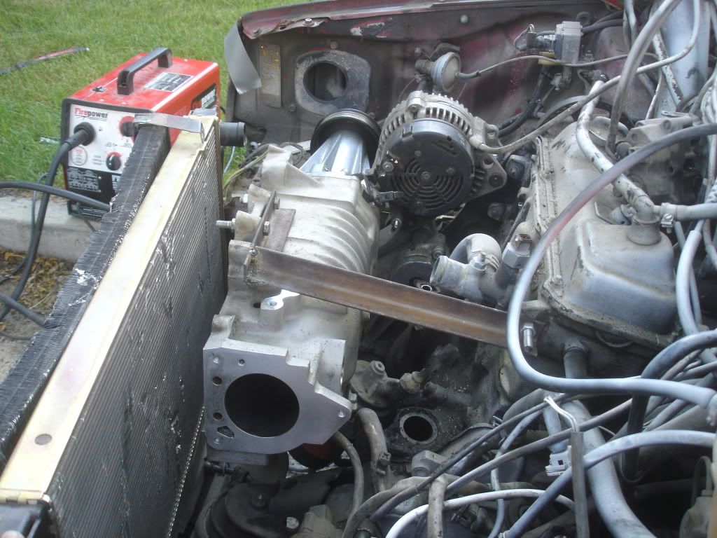

i got about 90% of my charger brackets built today, i gotta add some support to the rear bracket to get the charger to be rock solid with the motor.
list of what is still needed:
3/16" plate steel for adapter for boost tubes off the charger
some exhaust tube to weld to the 3/16" plate for boost tubes
serpentine style water pump pully
FMIC / more boost tubes
once im done with all the mockup on the parts jetta, ill simply swap it all to the GLi, and then I CAN HAZ BOOSTS!
i dont plan on running alot of boosts till i know the motor is gonna take it.. on the gtp this charger came out of it was pushing 14.5lbs, but im not sure his crank pully is the same size as the one i will be using. eather way in very very very very very very excited about this build

But shouldn't the belt be ran around the pulley more to reduce slip? like in a U shape around it...

it will slip in the rain regardless. it does take some effort to run those chargers, how will you regulate the boost? BOV? i know the tony has an intercooler FS should be perfect!

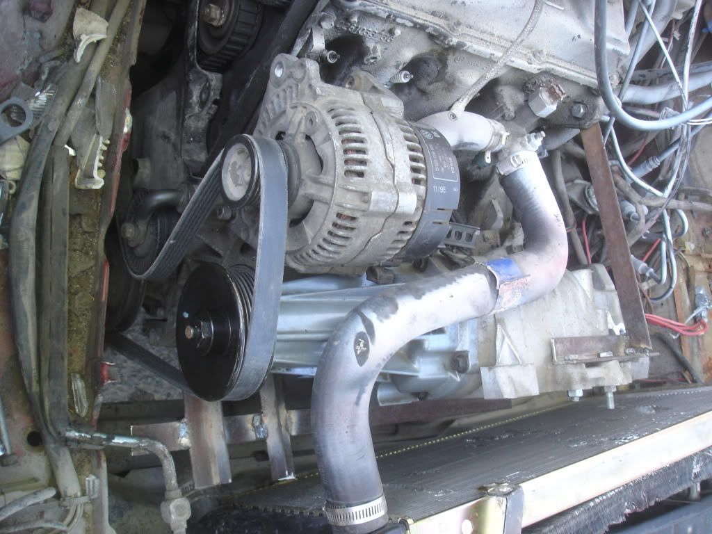

p.s. they make the funniest noises when the belt slips
sounds like a baby crying/cooing (while trippin on LSD)

im gonna let my stock g60 throttle body regulate boost/blow off. i know they suck but really i dont really expect this to last very long
and it will help me keep my foot outta the throttle.

well i machined/ gave my brackets some more adjustment. I also got some plate steel for my boost tube adapter, also some exhaust tube.
now all i need is a vr6/aba serpentine water pump pulley. and a little more time for assembly
ill give it 2 more weeks and ill be rollin roots style
