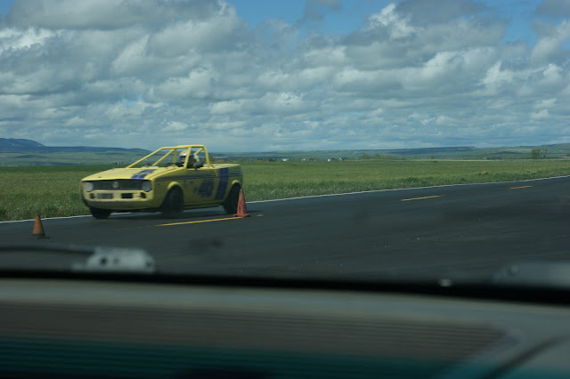

Re: Project Racecar Resurrection
that looks like a big yellow bathtub.
76scirocco
- Back seat driver...
- Posts: 245
- Joined: May Sun 04, 2008 9:23 pm
- Location: Billings
It finally made a track debut at Lewistown on Saturday and ran at an autocross on Sunday. The suspension worked really well on the big track, but us a little too twitchy for an autocross. I think for next time I will try it without the rear sway bar, it was just too easy to have the tail hang out on the tight track. I also need to work on the brake bias, but the car was a blast to drive. At lewistown it was down on power on the back stretch, but did the slalom and tight stuff very well. It snuck into the triple digits on the backstretch before the headwind, but that's about all it's got. I'm gonna try swapping on my big valve head and seeing if that makes much difference. I will probably end up having to go with more displacement, but the balanced, knife edged crank on the 1.6 is just too cool not to use at the moment.
