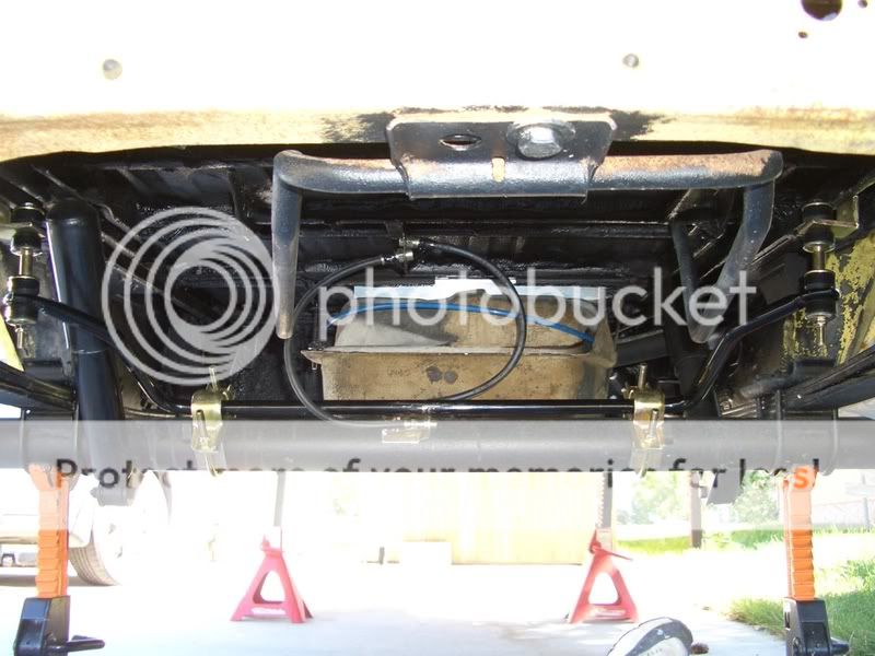

Rear Axel Brake lines & Sway Bar
Found some time this weekend to install the new rear brake lines that loop down from the body to the center of the rear axle.
Then I put in an aftermarket rear sway bar made for the VW pickup.
Looks like it should work pretty good.
I will make the final bolt-up to the body after I get some more weight on the vehicle and get it leveled.
But, I wanted to get it in place before I run the hard lines for the rear brakes.
Next, I will fabricate the mount and adjustment for the mk3 rear biasing valve.
Once I have that in place I can run all the hard brake lines for the rear end.
Then I can put the rear wheels on it and start on the front.[/img]
