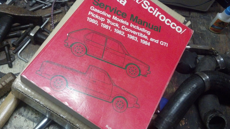

Finally picked one of these up. Man are they getting expensive! Thanks to eBay I got this for about $30:

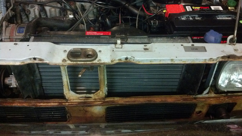

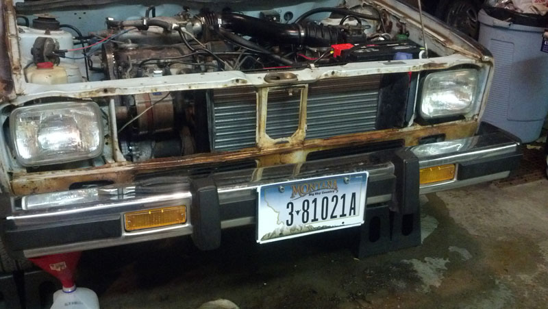

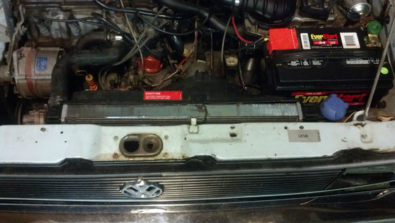

Finally a new radiator showed up. Went with the '83-'84 Rabbit with no reservoir option from GAP. Instead of the rubber isolators, this one has pins in the bottom, so I drilled a couple of holes and it slid right in place. New cap, lower hose and a thermal fan switch too.
I have solid heat from the vents and the coolant circulates nicely. But, even after a new sensor and new wiring, my dummy coolant light still continues to light up, so I have no idea what's going on there, but it really bugs me. I'm positive it's not over heating, but still need to take it on a solid drive instead of just idling in the garage.
Any ideas on that light?
Getting it all installed and the plastic cooling fins installed, bled the system and made sure it was topped off with a good mix of distilled 50/50:
Everything bolted back up and ready to drive:
