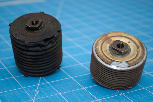

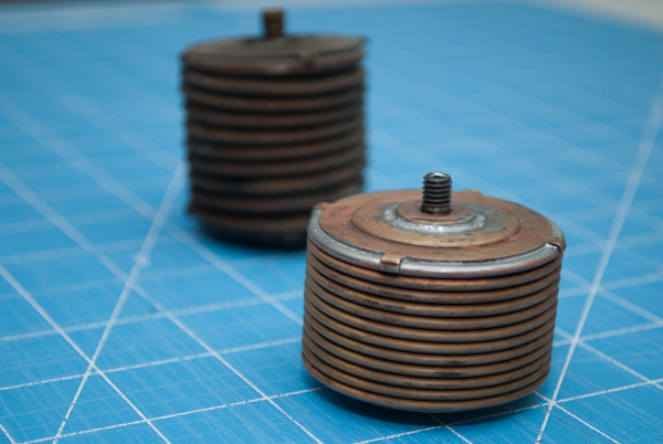

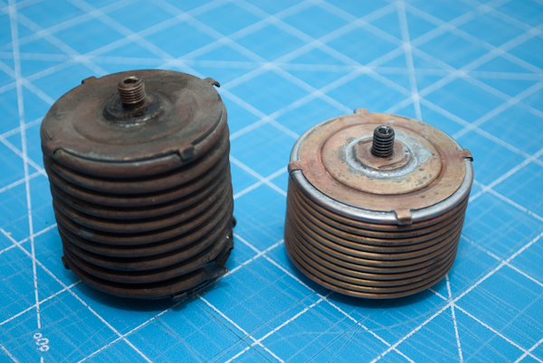

Got my thermostat from Samba member Volkaholic (thread http://www.thesamba.com/vw/forum/viewtopic.php?t=446423):
Looks like a solid unit, much better than my busted one.

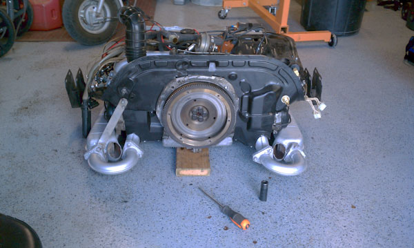

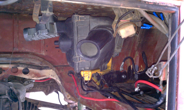

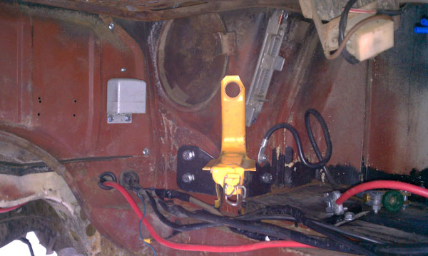

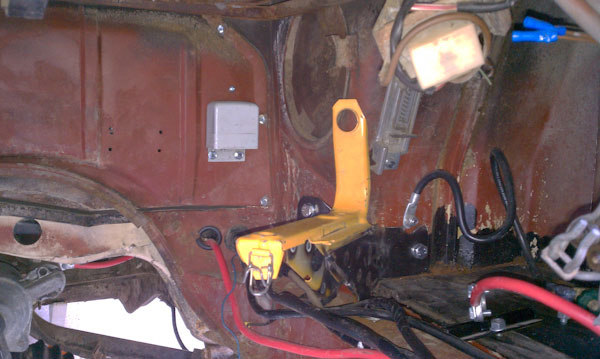

Finally got some time to work on the bus - I was able to get the air box mount I had fab'd bolted in to the engine bay:
Bolted up my 210mm flywheel:

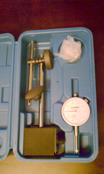

Picked up a new tool, a dial indicator - measured endplay at around .003 - shims are all good!

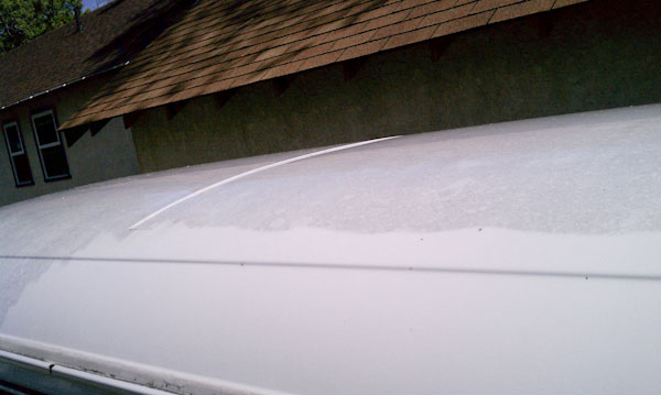

Power washed the top of the bus, shiny!

i dig the airbox support, that turned out nice! Ready to drop that sucker in eh?
