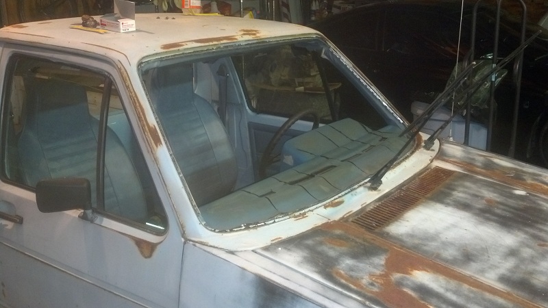

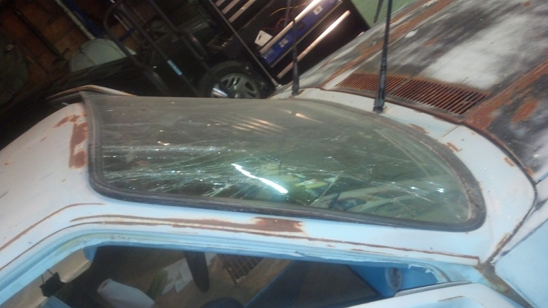

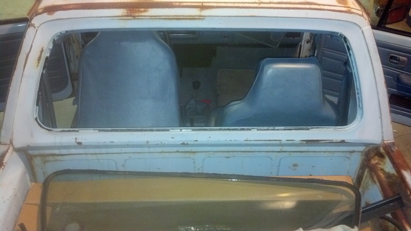

After all the interior work, the damn headliner was bugging the shit out of me, it was saggy and needed repaired. So I said screw it, and pulled the rear and front glass, just to get to the headliner
Rear glass and seal is good, but the front glass just crumbled when I pressed on it. Fair enough, it's OEM (that was a tough decision) but it had to be done and was going to be replaced anyhow. I think the seal can be saved.
But now I have no front glass, and am stuck on a headliner repair that there is virtually no replacement on. I think I will be reusing the original cardboard headliner and vinyl material, but I will have to scrape off the old foam and re-glue. I tried super 90 on a section, and it was terrible and didn't work. Anyone have any experience on the MK1 headliners? What to do?

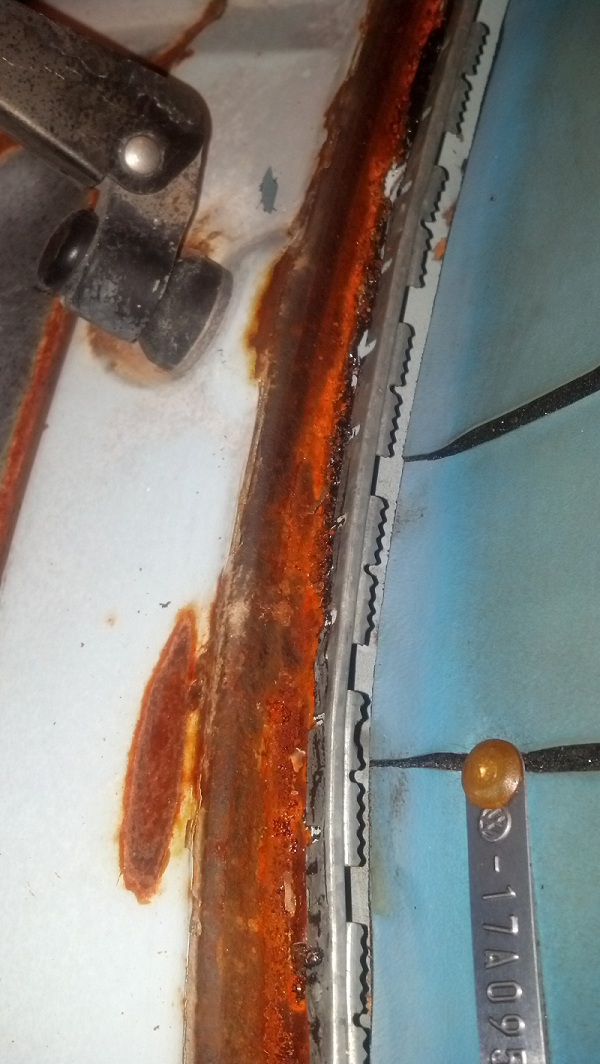

Little bit of surface rust to remove, nothing too bad. POR-15 after it's cleaned up.

Those caddy headliners suck. Without it the truck will be cold and noisy.

In the past we have just used spray on adhesive on original cardboard liner with your favorite fabric. I've done a few I my old cars using that method with no problems.
I don't recall brand of spray adhesive but it was something recommended by a local upholstery shop.
