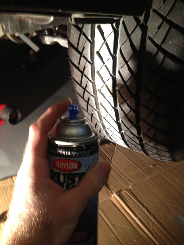

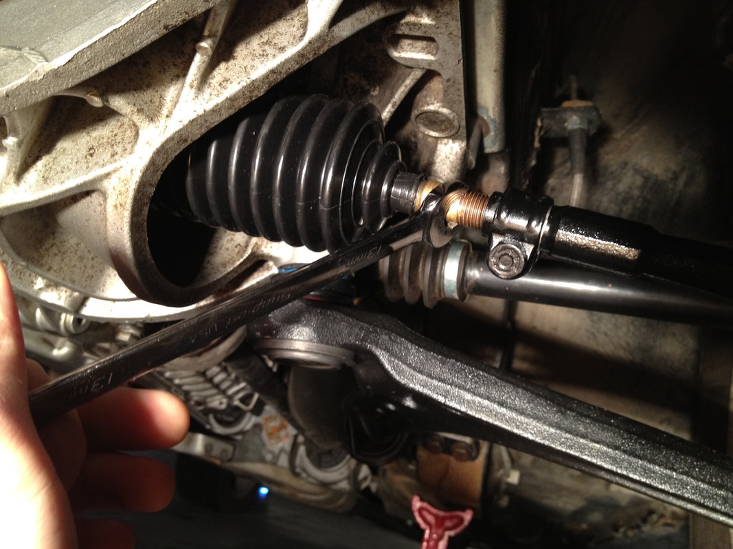

When driving the car around the block cycling the power steering fluid, it was pretty evident that it was mis-aligned. The left wheel wanted to push the front end to the right and the right to the left. Kinda got sketchy when one wheel had less traction than the other :nod:
I needed to get the alignment close enough to drive around.

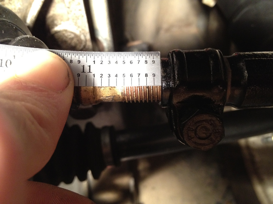

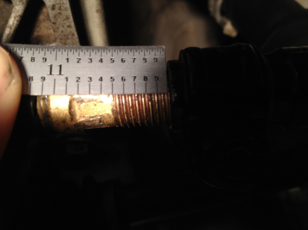

First, I got both wheels set from center as even as I could. I measured off the inner end of the outer tie rod to the start of the inner tie rod threads.
Left
Right

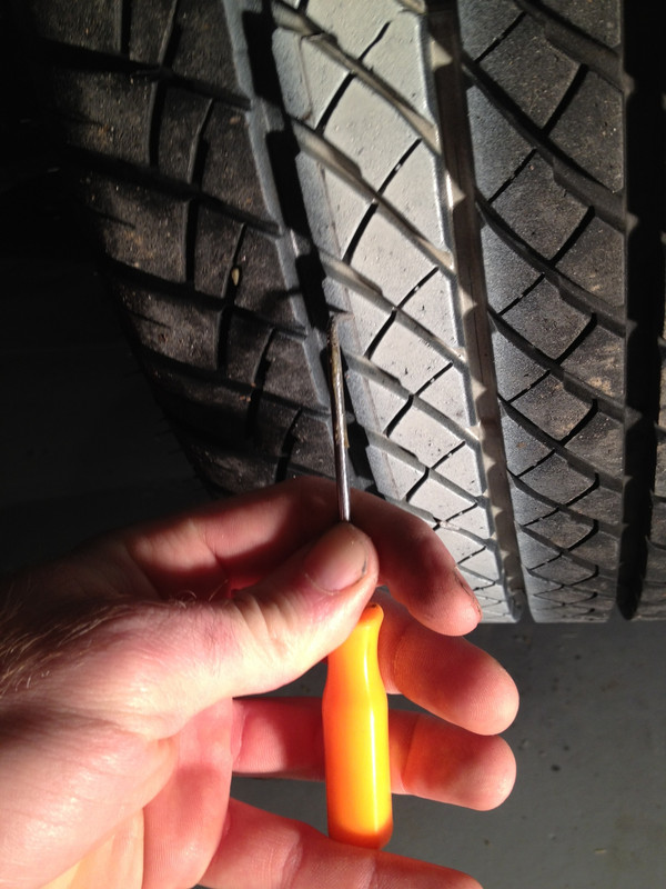

Painted a line around the wheel, Just holding the can in one spot while a helper spun the wheel.
Wait till the paint dried, the scribed a line in the white paint. This gives a nice fine line to measure off of. Same deal, hold the sharp point in one spot while someone spins the wheel

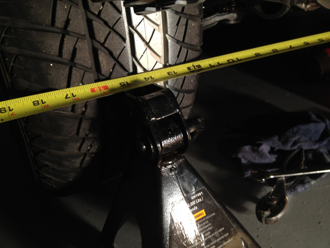

Next measure the front and rear. Need to make sure you measure at the same height on the wheel, So I measured off jackstands.
Adjust as needed, then measure both the exposed thread and also wheel front and back again. Repeat
When I was done, the rear of the tire measured 1/8" wider in the back then the front. I admit I haven't done the math to figure out what this is in degrees yet. :( Drives straight though. Will do a proper alignment after I replace the rear control arm and subframe bushings.

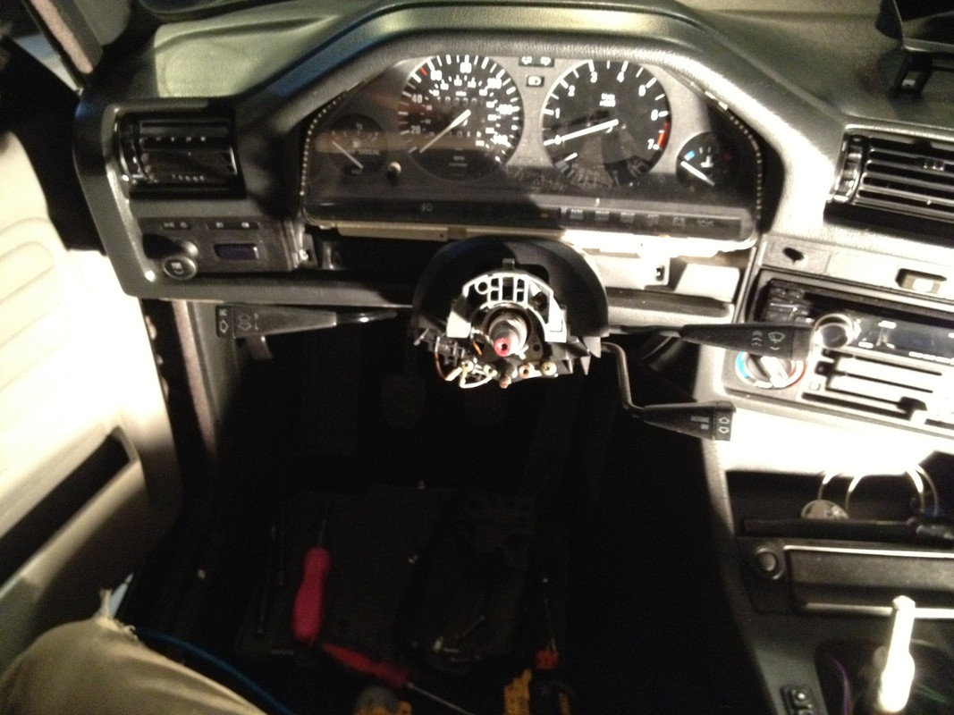

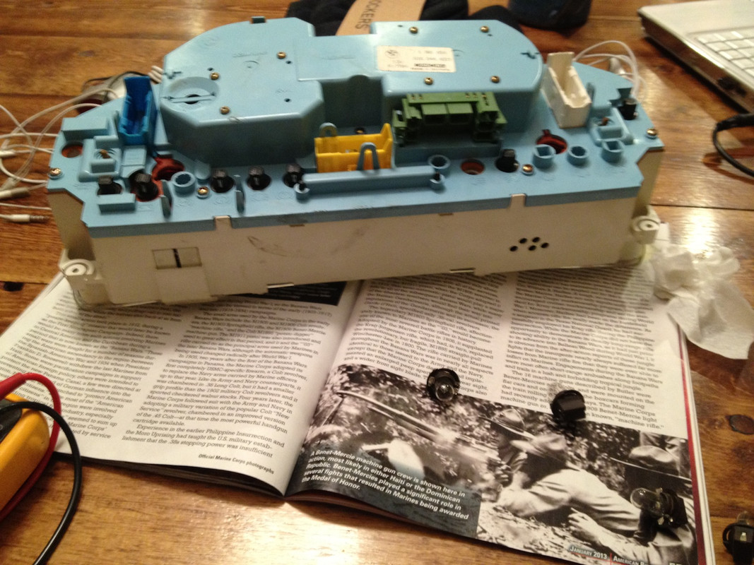

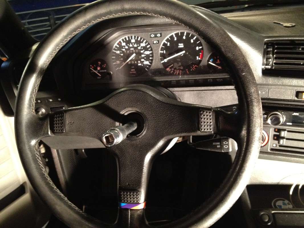

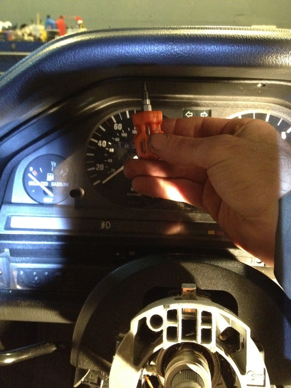

Next my instrument cluster had some burnt out bulbs and my wheel was 80 or so degrees off from straight so.. Must remove the steering wheel, just one nut, no big deal.
A friend of mine gave me this cool little screwdriver which is just tits for getting at the instrument cluster surround screws.
Put a meter on all the bulbs and replaced the burnt out ones. Standard 1/4 twist stuff here

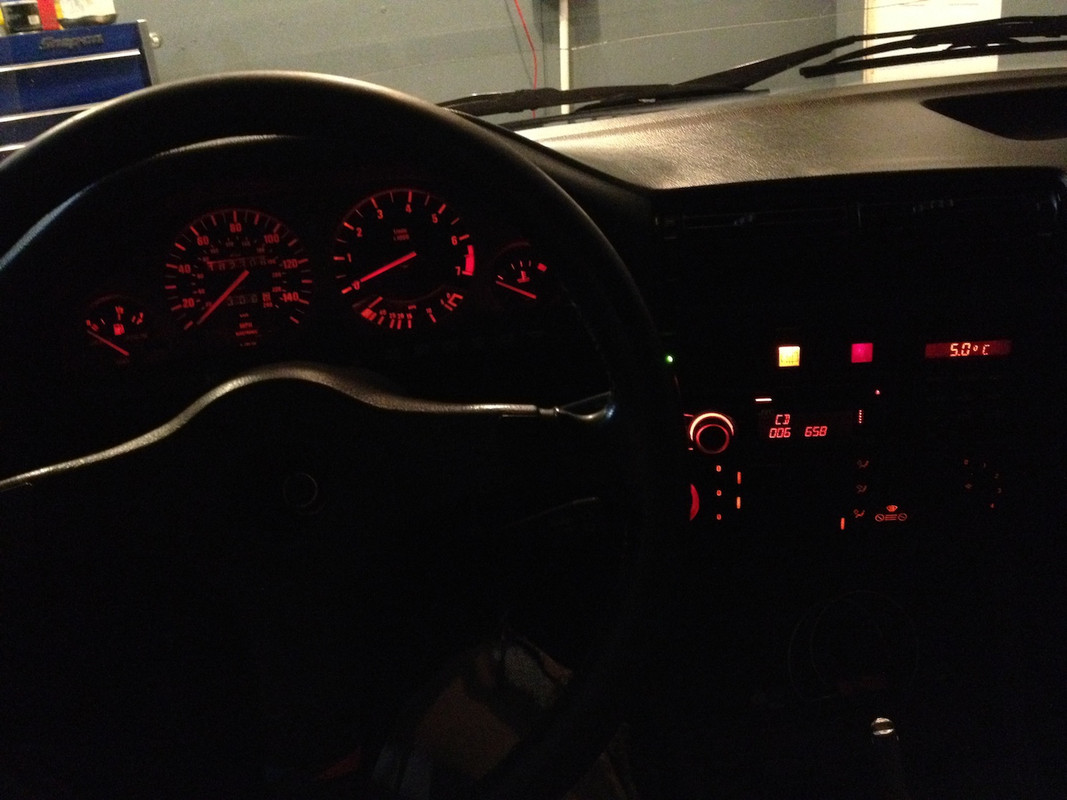

Reassemble, this time with the steering wheel straight. One of the reasons I chose the head unit I did is because you can set the hue of the buttons and display. Matching dash lights; OEM look FTW.
Next up, the OBC button lights. (Below the temperature display the buttons are supposed to be backlit as well)
:beer:

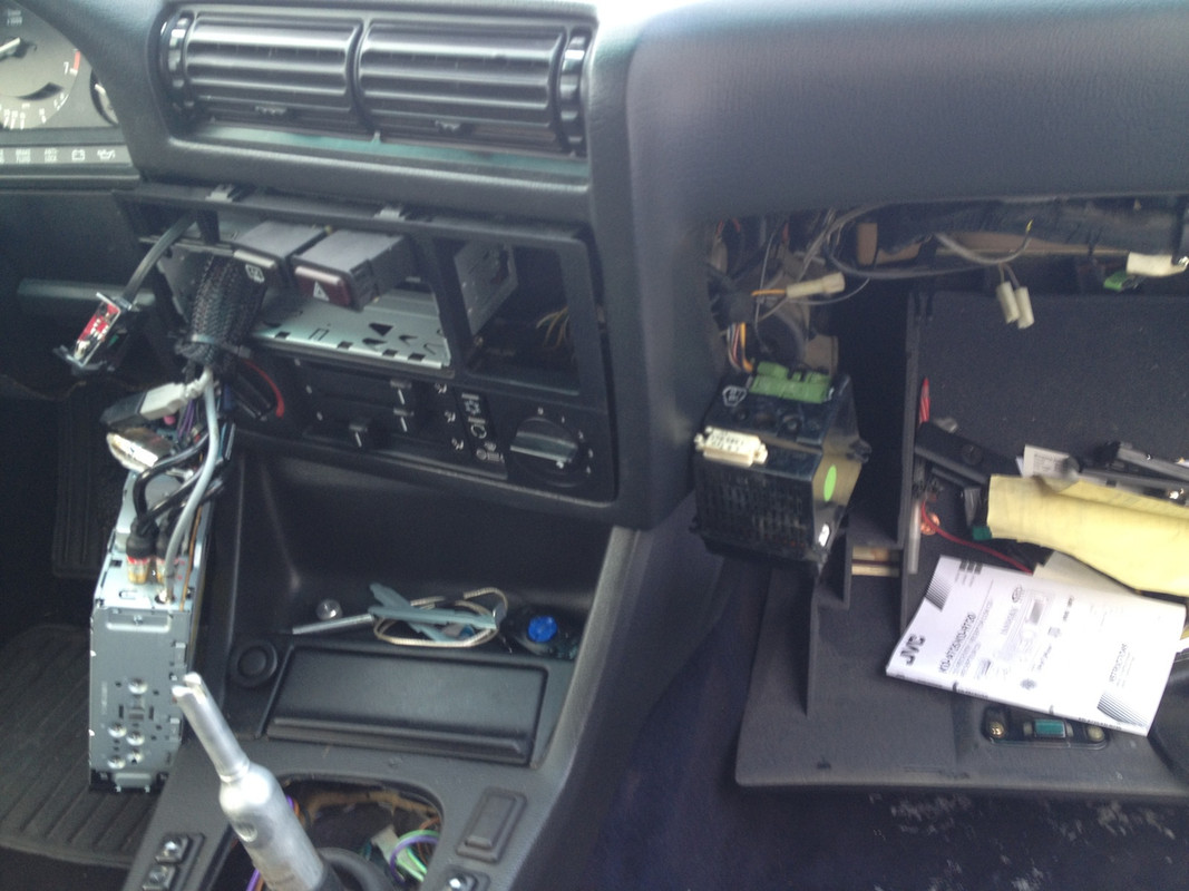

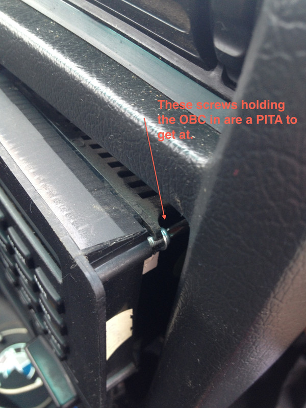

Started on fixing the OBC (On Board Computer) backlights.

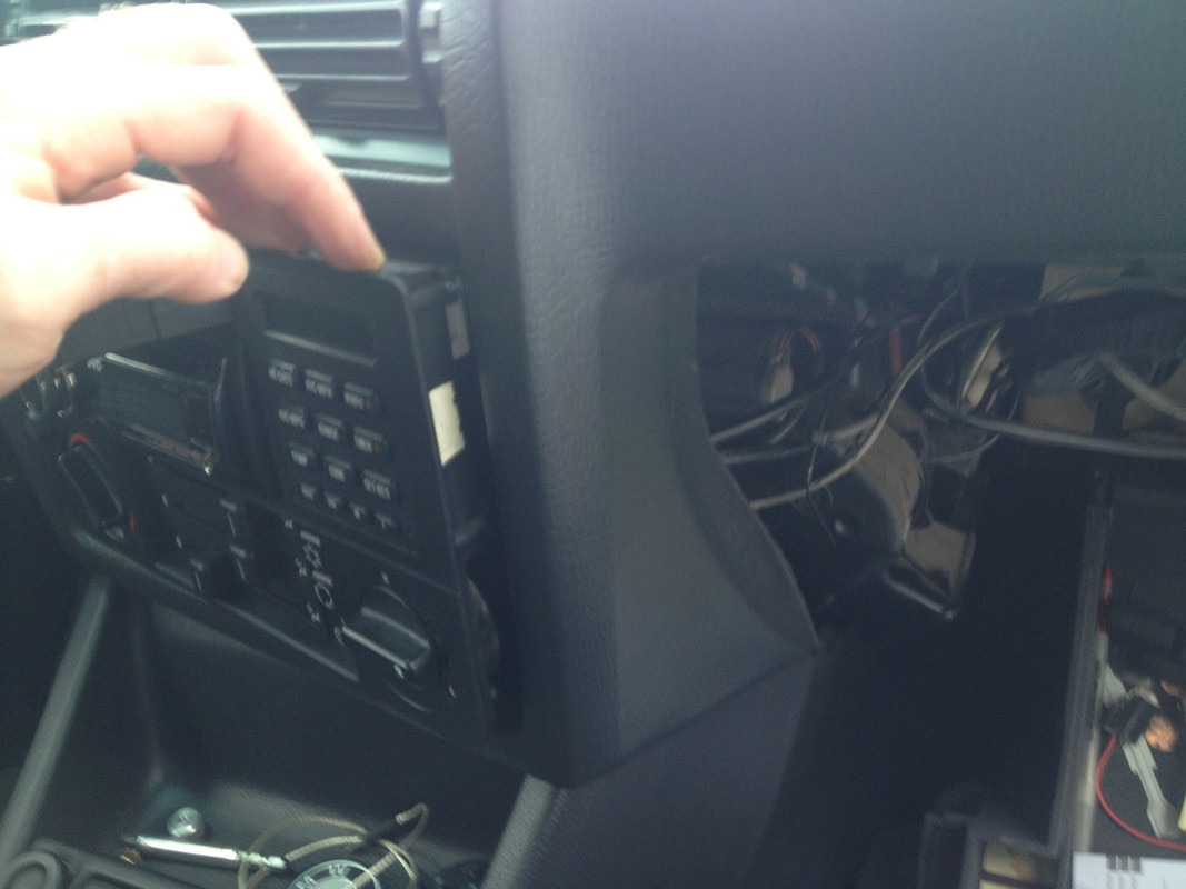

Standard HVAC panel removing here. PITA
Once you have the panel loose, you can pull on it to show where the screws are on the OBC, then reach around from the glovebox area and get at them with a little philips

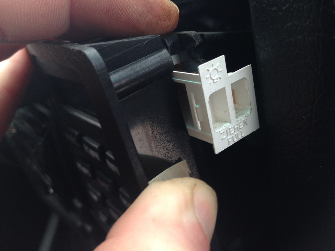

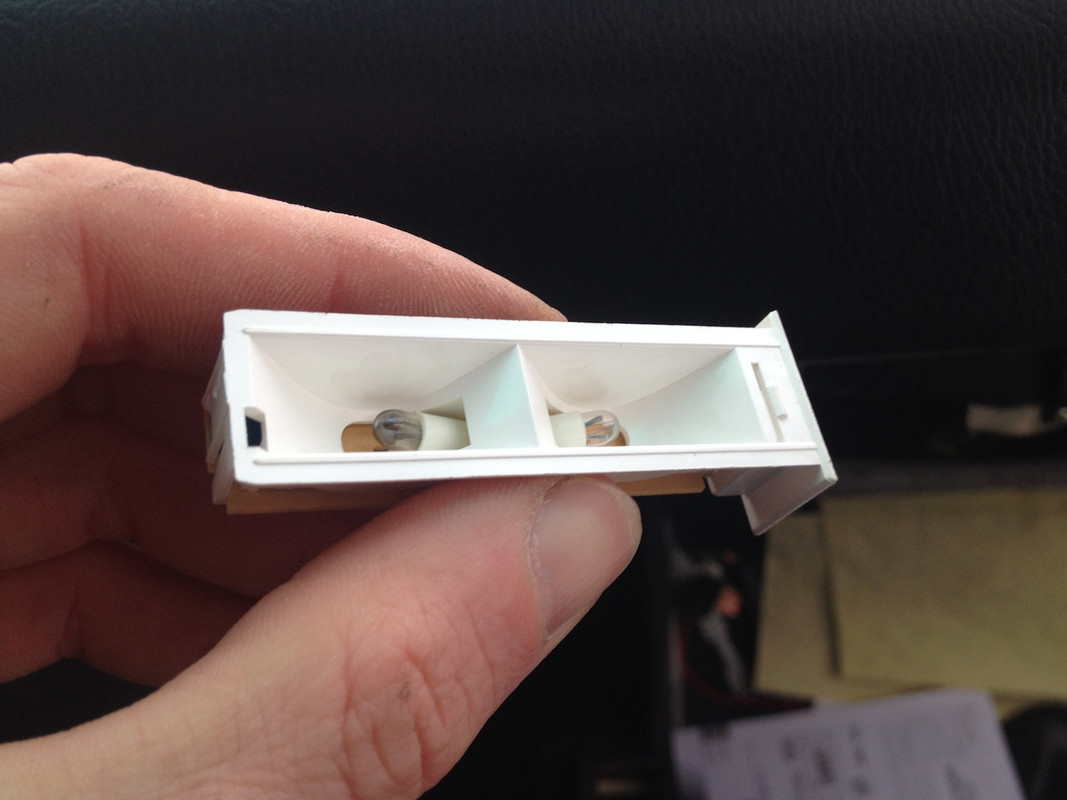

Now that you can access the OBC, the clock light bar is easy to remove; it just slides out as a little module

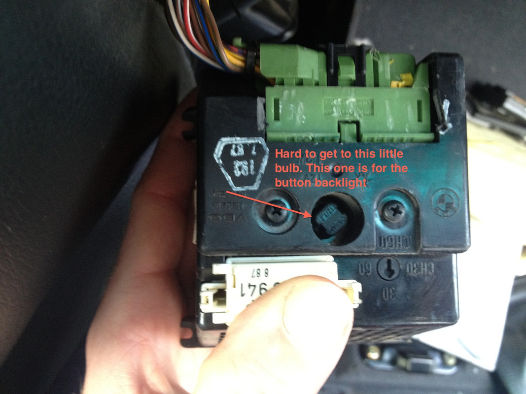

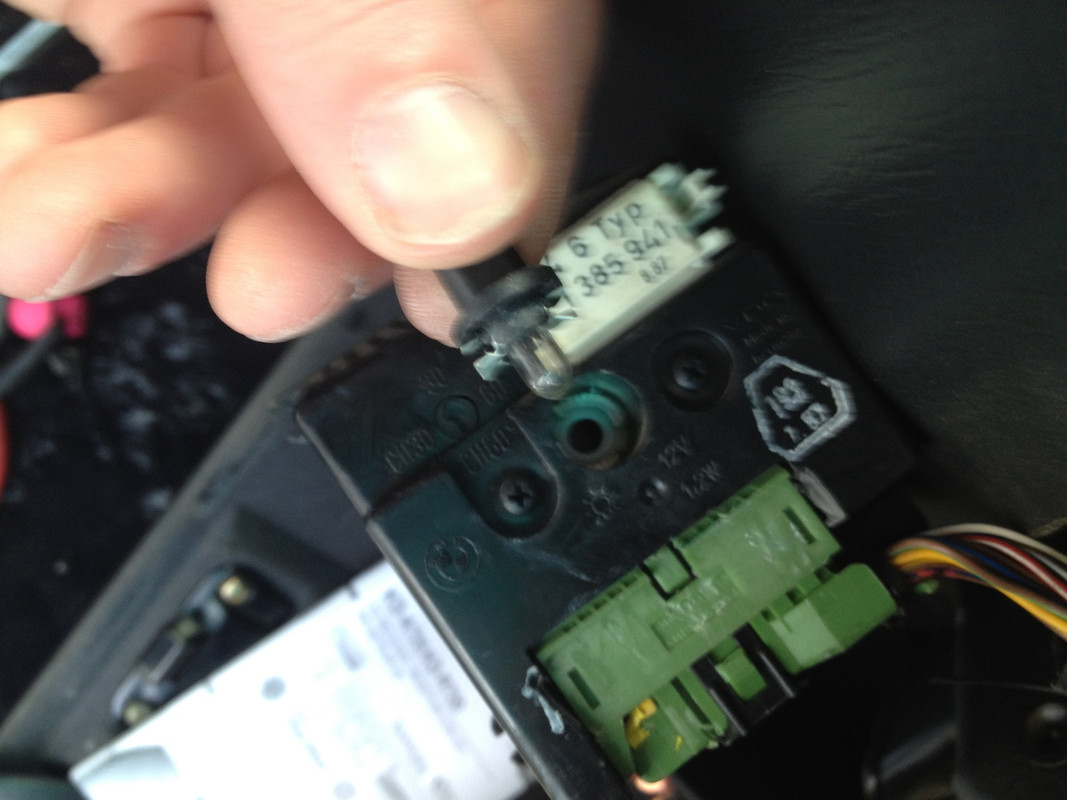

The button lightbulb is more difficult because it's recessed into the OBC. :banghead:
On the plus side, it is just a standard instrument cluster bulb

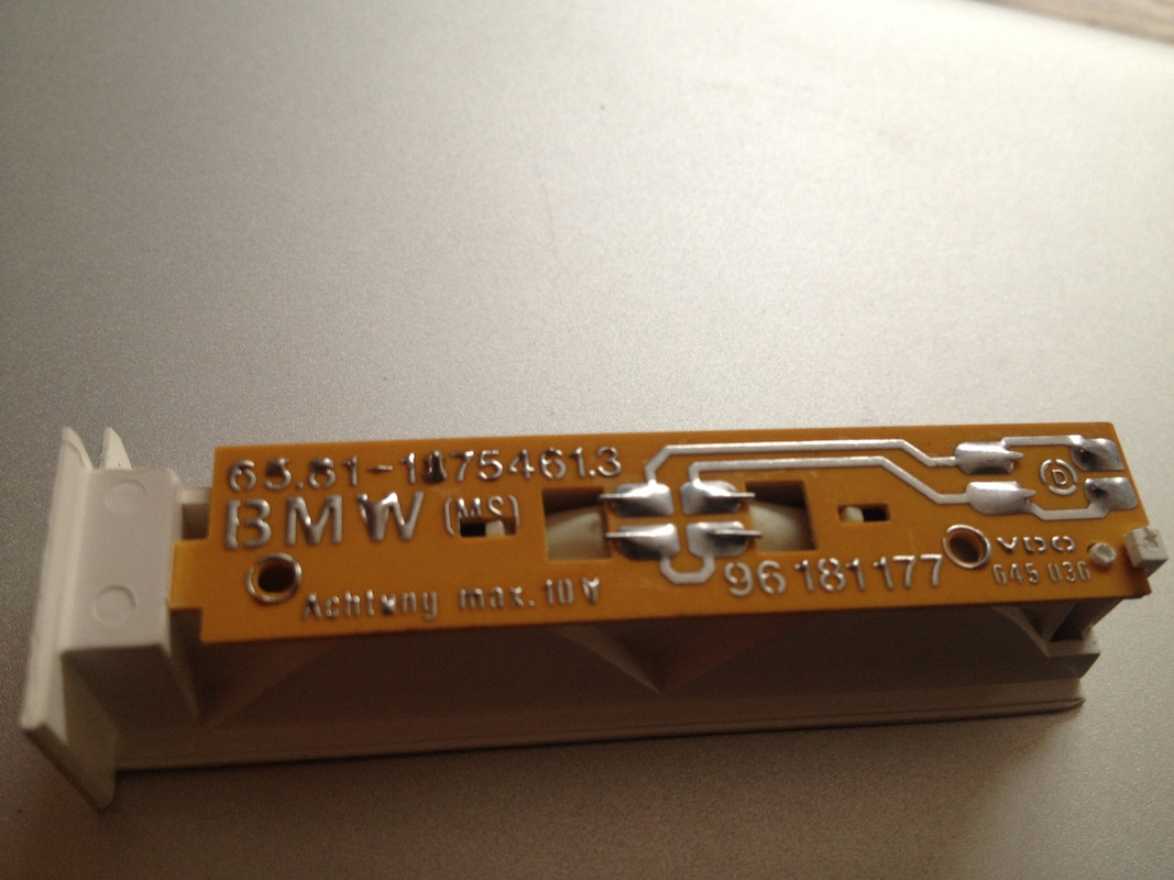

The light bar has two bulbs wired in series. I guess that'll be 6volt each then
I found this website that sells automotive replacements in the LED variety. Measured up the existing to make sure they'd fit, and they will. (might order some to keep as replacements for the future)

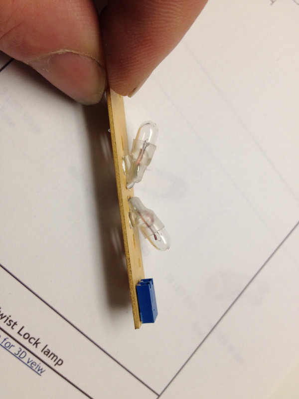

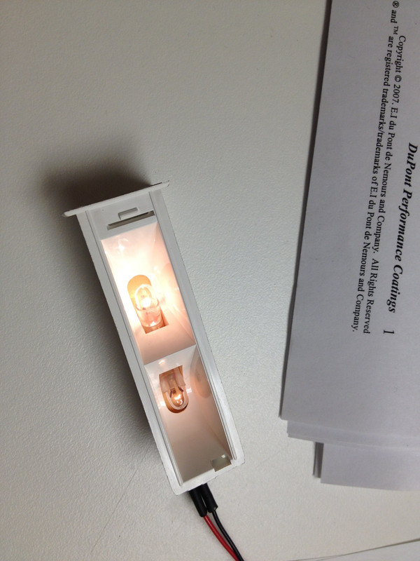

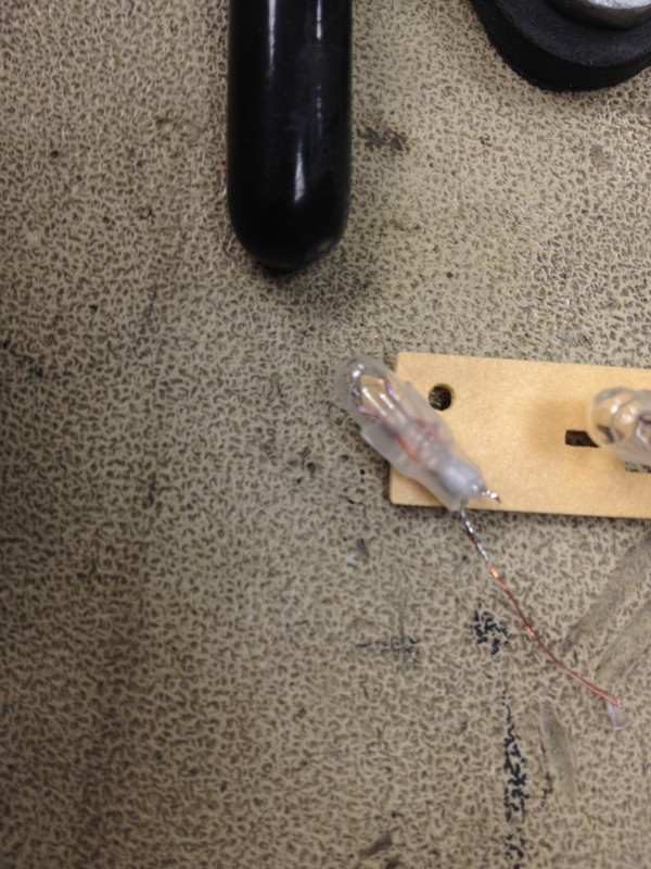

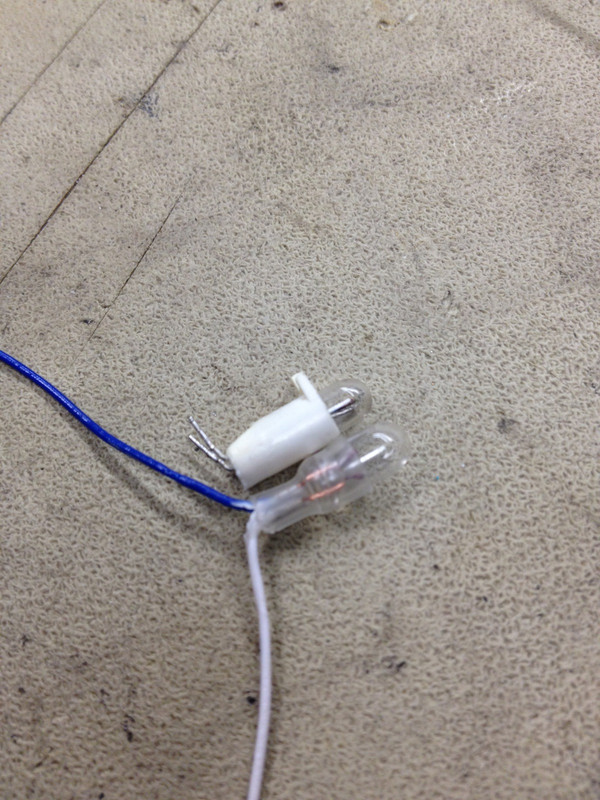

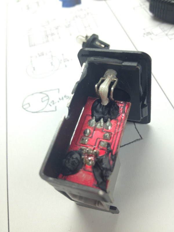

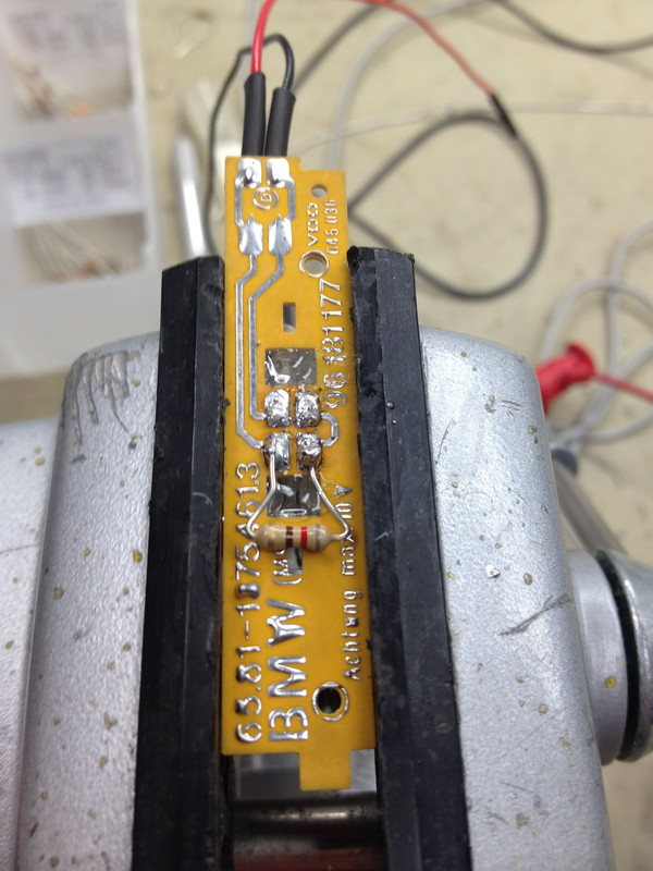

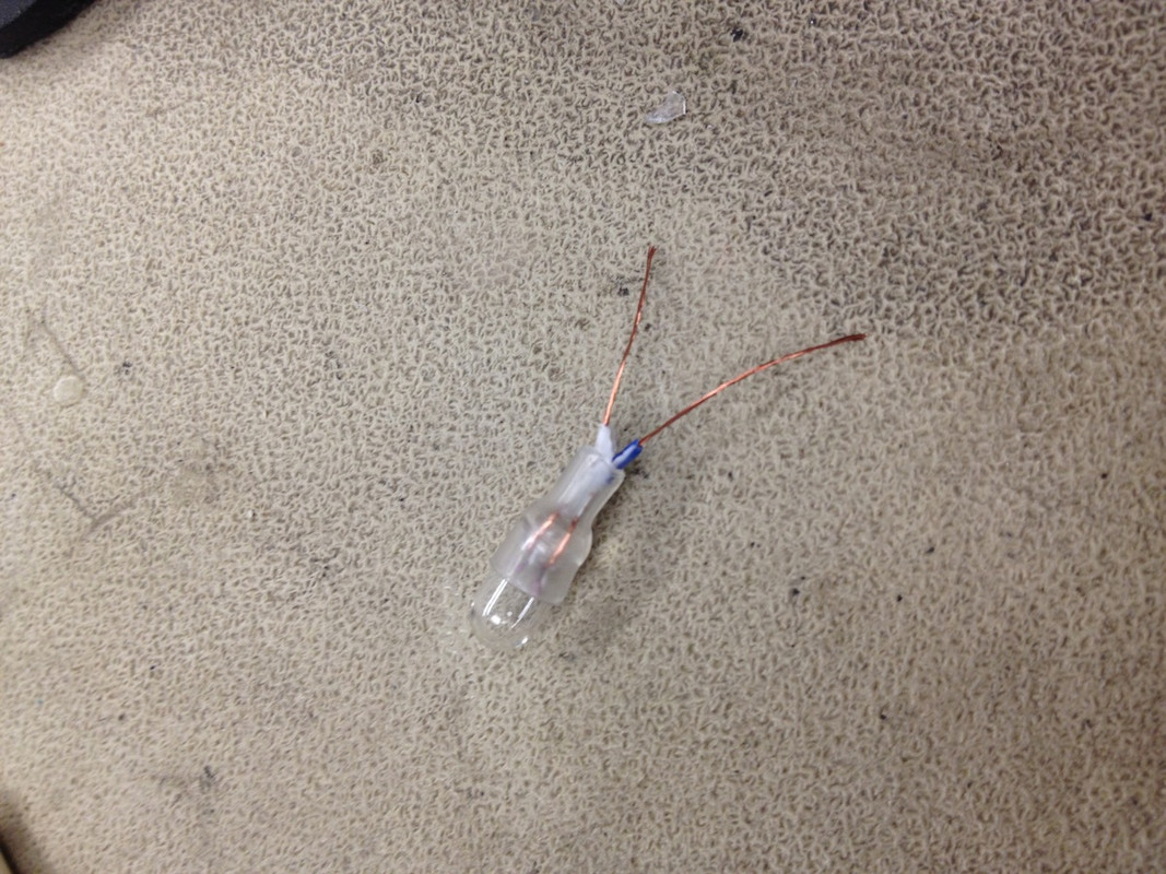

Picked up some bulbs from RadioShack. These are 6VOLT not 12 because they're wired in series not parallel. Bought all two they had so don't go back for more :laughing:

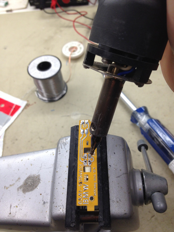

Use solder sucker to remove the old bulbs. You could do this with a manual sucker, or even solder wick, but hey, if you've got the tools use em.
Old vs New

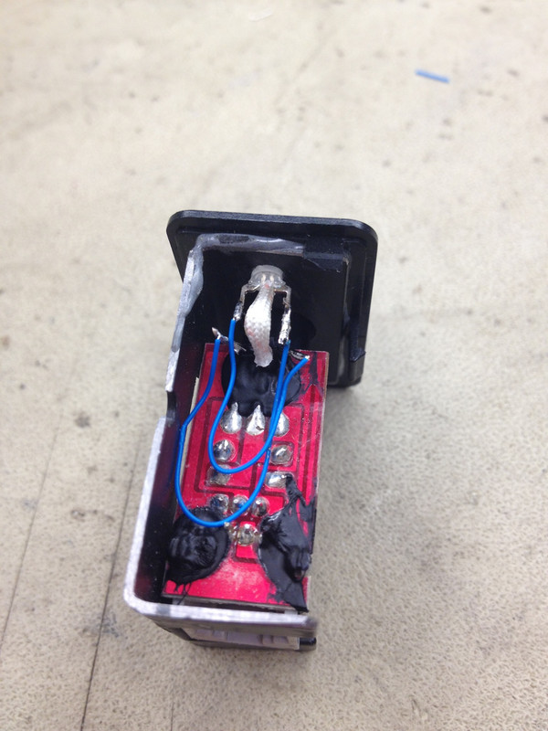

Strip leads and cut to length
Oops, I used the wrong gauge on the stripper and cut it a little short
It's okay; I got them in and soldered no problem.

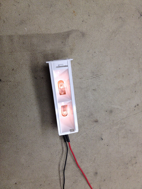

Hooked it up to 12vdc on the bench to test it and... oh no; one's less bright then the other. I measured the resistance of the bulbs and found one was 2Ohms different. Doh, need more quality control on these suckers. This meant that I was getting 4vdc to one bulb and 6 to the other.
Did the calculations for resistors addition but in trying it didn't seem to work out right. So I just did the old trial and error thing and found that 820 Ohms was the ticket. Soldered that junks in place.
And now, when hooked up both bulbs are even.
:beer:
